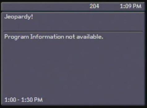

For me, the guide had no detail program info until the software level went to 0114.

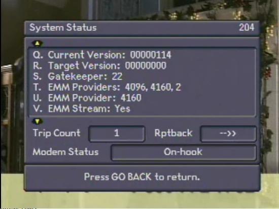

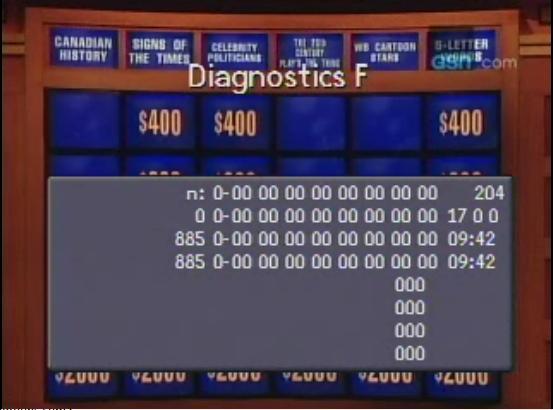

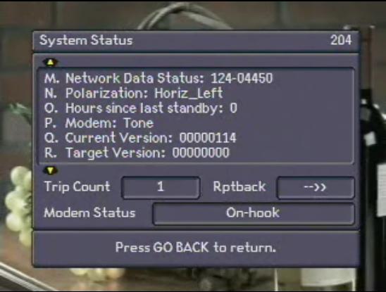

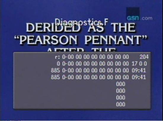

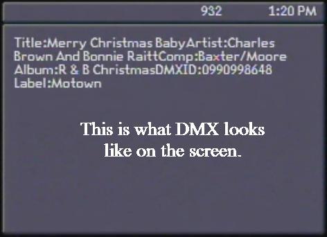

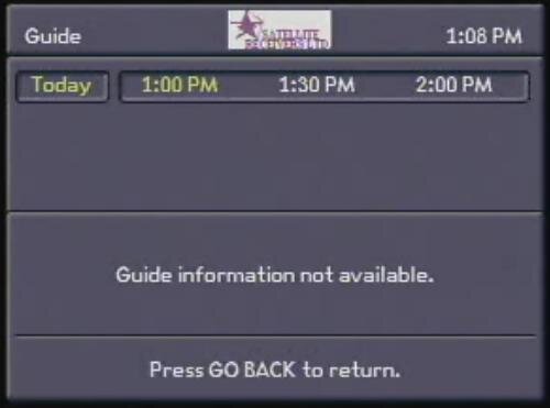

Here are my screen shots. Note no guide. Also notice Diagnostic Screen F, lines N and R, I am not scheduled for any guide data.

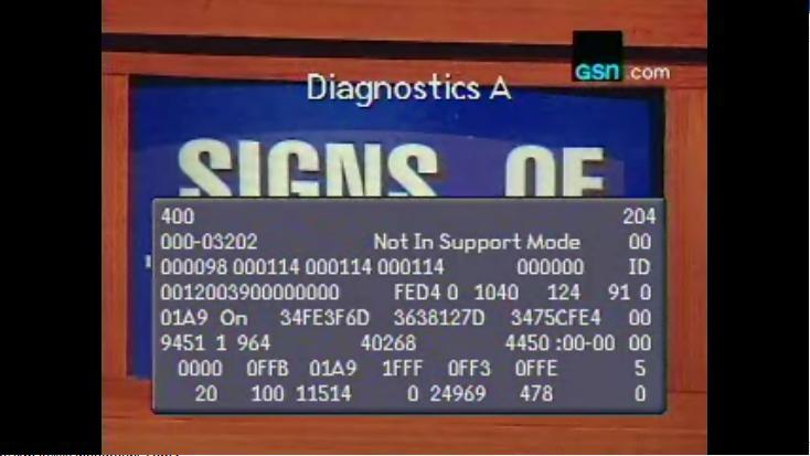

In addition I gave a screen shot of what DMX looks like. :)

Scott, I don't think I've ever seen a Target Version on my 920 or 922? If I did it must have been so long ago I can't remember, like when Motorola actually did give updates? Before they got...... well never mind.

The DMX info is the same as my 4dtv.
Can you do a forced programming download with the 410? The way it works with a 920 or 922, you go to the Diagnostic F screen and push "Info Button" on remote. It will go the the "Guide Screen" and say "Searching For Information". Go back to the Diagnostic F screen and watch it loading/changing, if it's working. If not, it will look like the 2 Diagnostic F screens in your pictures.
Al
Edit: if it works, when the memory gets below 50, it should be done? And it shouldn't take but 10 minutes or so? The memory number would be the "885" number in your pictures. The top number is the one that will change to around 50 when finished.

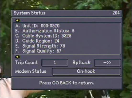

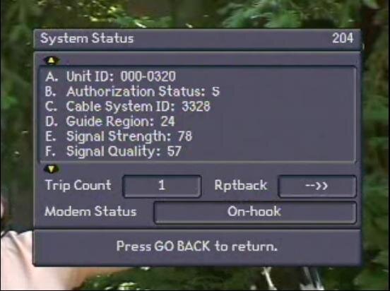

I notice Scott's background in his screen shots are gray, mine are blue. I'm in NY and we have the same guide region and cable ID. Which I expect as he is in Conn. a neighboring state. I notice his unit ID # is 9 digits shorter than mine. My picture appears sharper in my opinion as compared to the screen shots I posted.
