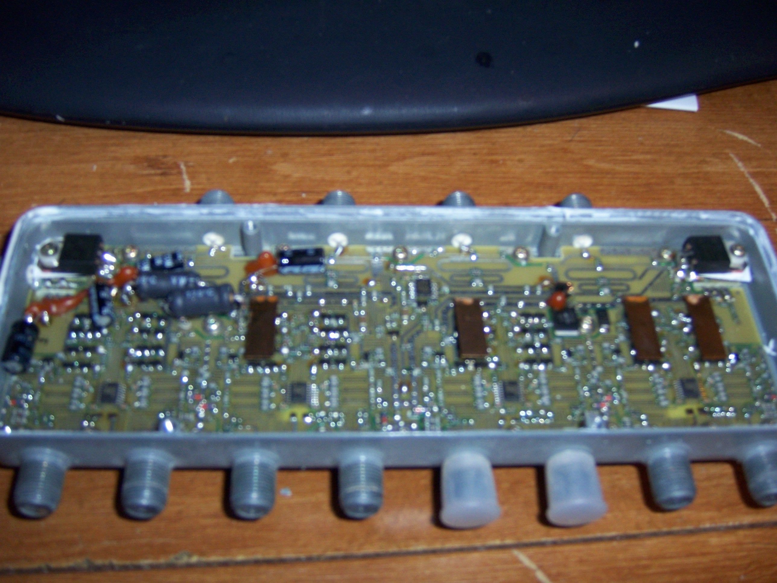

100_0480.jpgThis the Eagle Aspen, I tried soldering the 560 ohm resistor on each one of the regulators at different times, i still got 18 v and 13v on the ports. Any one know what I should to get the 18v on the other ports. Thank you

Does the Eagle Aspen even use the same type of regulators that are in the other switches?
If not, the resistor mod might have no effect.
Any chance you could post the info from each regulator?
Whatever is printed on 'em is fine.
And/or, probe the pins of each and give us voltage readings.
What about a sharp photo of the board so we can read the part numbers?
I know that's very difficult.
Try setting the camera to macro-focus if it has that ability, or move the camera away in small increments and shoot again.
Search the forum for the mod Linuxman did on a multi-switch.
I think his had a 13v and an 18v regulator, so he cut a trace and ran a wire (?)
Oh, and also...
I'm talking about switches (the WNC) with an external 24v power supply.
Does your Eagle Aspen take external power?
The picture shows 4-input and 8-output connectors, but is cut off and doesn't show an extra connector for power.
yes the LM317t, with an external 24vdc power supply, I will search for that mod, I will order a zinwell switch so if I screw this one up no big deal it a learning process. i appreciate the help.
