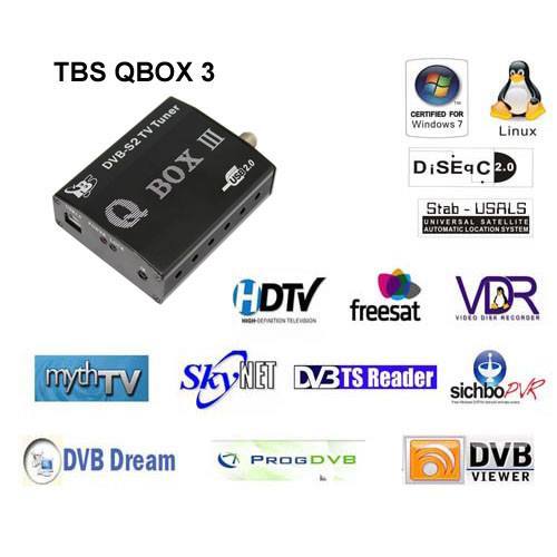

Hi guys
Definitely, still no usb or pci dvb-s + dvb-s2 receiver with hardware blind scan? Also nothing about hardware blind scan on, for example qbox_3_1.jpg ?
