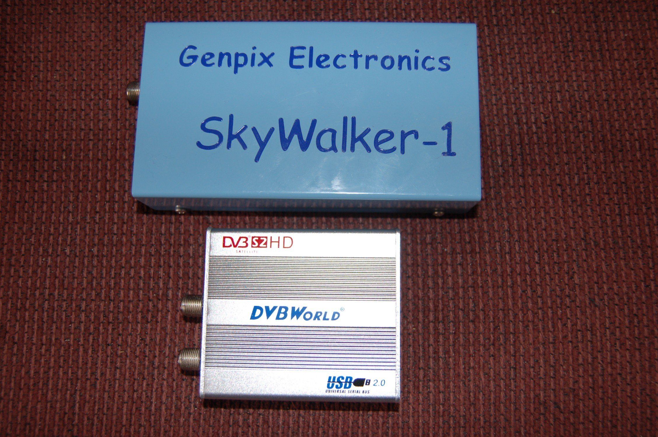

I'm not sure what you mean by 30Ms/s? The specs online say it supports symbol rates 2 to 45 Msps, is that what you are asking? It is a LOT smaller than my Genpix Skywalker I
wow that is small, Ive also got the skywalker-1 and thought it was small !

Yea,its very tiny, when I first opened the package I thought, this is so small its gotta overheat. But it seems to run cool. I wasn't aware of that symbol rate limitation on the TT device, something to watch out for. I looked at the DVBworld online site for info on modulation techniques but there is basically nothing about it so I can't say about DSS. Tsreader support is my main objective with it. I sent another note this morning and suggested they send one of their devices to Rod. Perhaps he could find it in his heart to write a source module for it?
