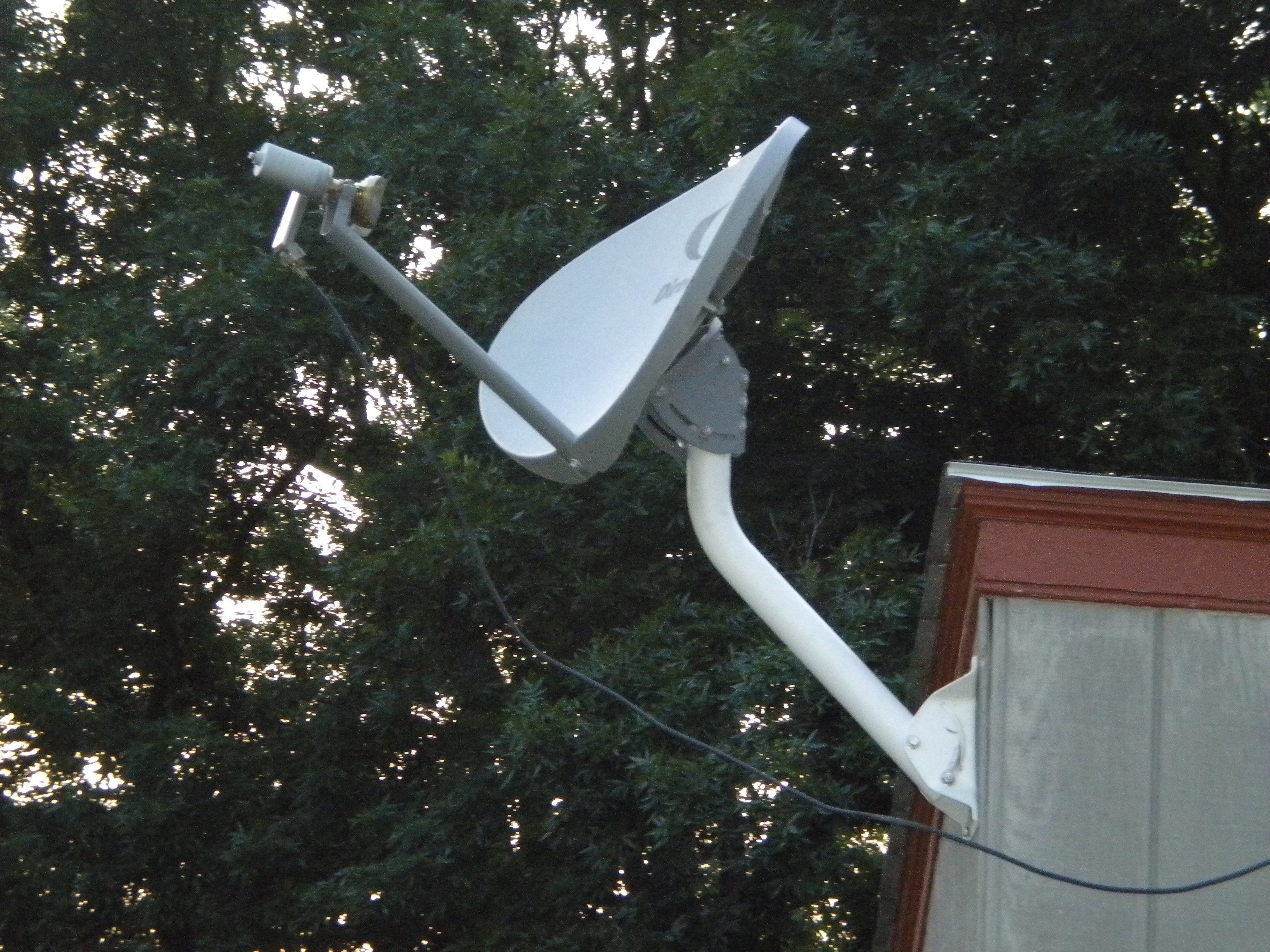

I moved one of my dishes to a place where I should be able to motorize it.
It is a DirecPC dish and the mount is 2 3/8" in diameter. I looked at these motors but 55 mm is smaller than 2 3/8".
Sadoun Powertech HH Mount Motor DG380 DG-380 DiSEqC 1.2 Compatible
I'm sure someone here has motorized one of these dishes but I want to have a plan before I order parts.

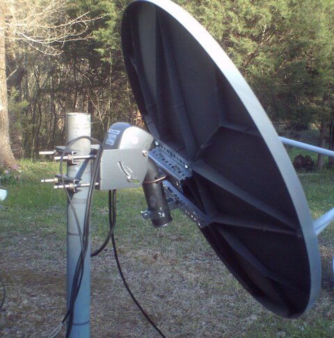

You could find lots of threads here if you do a search for 'motorized primestar dish' or similar terms. I have a dg380 that I stuck a .90primestar dish on, similar dish. With the DPC dish, I think it has a skew plate on the backside of the dish, you won't need that. You could prob turn the mount upside down and stick the motorshaft inside it, except that 380 motor has a flange on the bottom end of it, and I couldnt get that part to go inside the dish mount. So I just took the mount off, attached some brackets to the back of the dish, and used muffler clamps to hold it to the motor shaft. I'll try to attach my pics.
oops here's the pic
That bottom part is a 2 1/2" conduit hanger, you'll need a way to adjust the dish's elevation once you get the dish attached to the motor shaft.

cruzin the pvc was what I tried at first, but I never could get it to hold tight enough, but that was without the primestar mount on it. I just tried to use the pvc with the muffler clamp but it kept slipping. You might be able to drill a hole in the shaft but I was afraid to try that, as this was my first HH motor and didn't want to tear up anything. The flange around the end of the shaft wouldn't allow me to slip the primestar mount over it. There's prob ways to do it, but losing the extra weight was another factor in doing it the way I did.
