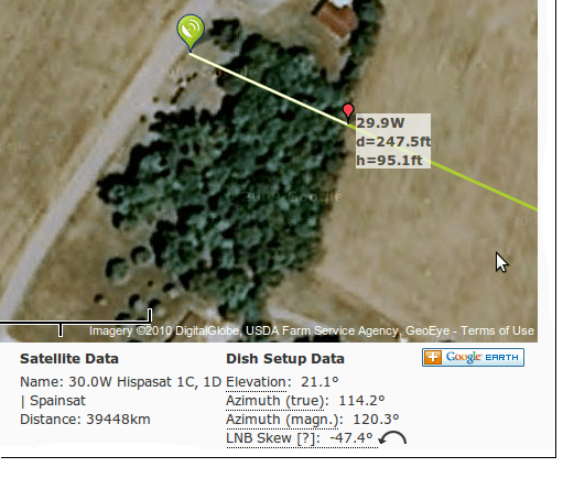

my line of sight in my yard is limited to 72w - 127w due to woods behind my house, but my landlord owns the woods, so i am going to try to hide a camouflage dish at the other side of the woods for hispasat 1c/1d at 30w:D
(see attached screenshot of dishpointer.com)
my question is, is there any other satellites east of 72w that have good english programing that you guys would recommend that i add an lnb for?
