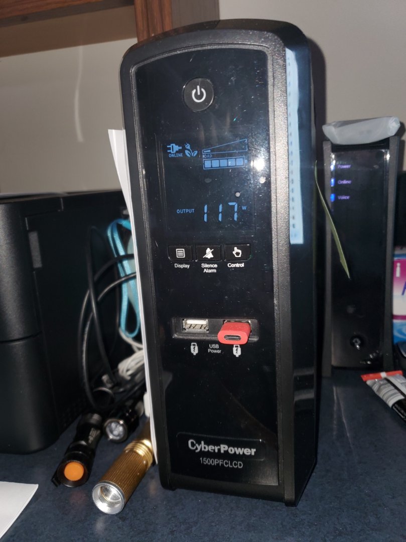

My issue is the Dish H3. When I unplug the UPS and plug it into the power station a notice pops up "satellite signal has been lost and receiver has switched to internet streaming". If the receiver is still on why is it losing signal? My UPS will keep everything plugged into it for about five minutes. The channel I am on works until I change channels. A blank screen comes up then. I also checked my Roku and everything works.

A bit fuzzy. You mentioned plugging your UPS into the station. That's a bit strange. A UPS (what brand/model?) may have a switchover time. The Ecoflow will also. So in reality the receiver detected a power loss. Perhaps not long enough to make it look like is shut down.
Like the internal power supply to it "dipped" in the transition period the UPS switched.
Or the UPS batteries could be degraded and the inverter voltage compensation time increased.
What is the power draw with UPS on it only and batteries supposedly fully charged? Good UPS batteries should show low mains power draw.
SMPS convert AC to DC immediately then "make" regulated DC output. So "dirty" AC input voltages, not so pure sine waves. Should not matter. The sat receiver and Sony both use SMPS.

My test was for a shtf event. I have the Dish receiver, Cox Modem, SimpliSafe brain, Roku Ultra, Samsung soundbar and a weather station plugged into the UPS.. It is easier to plug in the UPS cord instead of individual items.
I don't remember what brand or model UPS I have, but I suspect it is a Cyberpower. I can't get to it to see. I have had it about two years, I believe it is this ST900U.
On the next test I will plug in the individual items which will be the Dish H3 receiver, Roku Ultra and soundbar. The H3 will have to reboot being I will be completely unplugging it. I may run the Sony TV that is plugged into another UPS in it also.
Ahh. Two years on a continuously used UPS battery. And a baby one at that. About par.
With no wattage indicator on the UPS. Time for a Kill A Watt.
