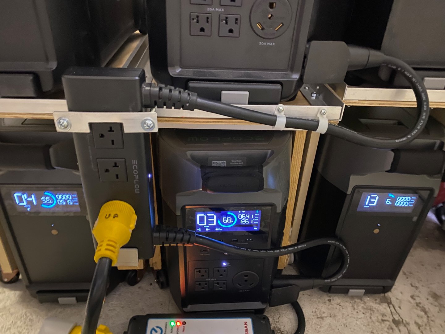

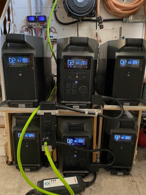

I think @TheForce ran into something similar with his Nissan or Tesla EVSE when he first started his charging experience. He had to "fool" the EVSE into thinking it was plugged into a normal outlet by shorting the Neutral and Ground together.
Good Memory! Yes, the EcoFlow Delta Pro Double Voltage Hub that supplies 240V AC is designed to connect to a normal US Home split phase panel with neutral and ground bonded only at the panel.
However, My system is isolated from the home panel for Tesla charging. The Double Voltage hub does not bond neutral and ground so when an EVSE is connected to the 240v outlet it will fault. I made a special adapter with the ground and neutral bonded to fix that. This is never used when I do connect the EcoFlow system to my home panel through a generator switch panel.
This is what happens when there is no bonded N-G wire in the adapter: Red fault light.
Testing both Nissan and Tesla Mobile connector with the modified adapter:
When I want to use the solar system as a power outage backup, I use a different normal NEMA 14-50 adapter extension cable to my home generator switch:
When this green adapter is connected all grounds are isolated from the main house panel. In all cases my solar panel side of the system is earth grounded with a 10ft rod that grounds the solar panels as well as the DC feeds with special static discharge devices for lightning storm protection.
The solar DC feeds are circuit protected as well as static protected as seen in the upper left corner of the photo.
