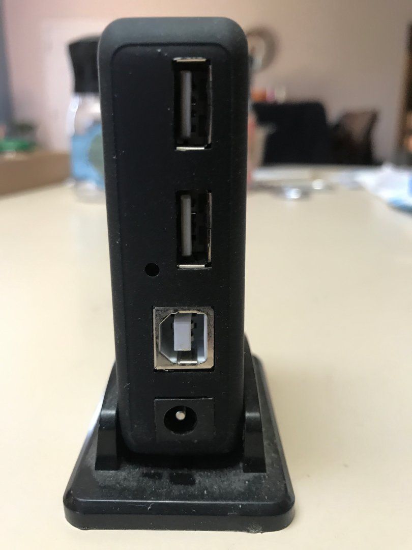

This is a pic of an inexpensive powered hub I used in the past. It has a total of 7 USB ports. A FireWire connector, and a DC connector. The FireWire cable has male usb on the other end to connect to a pc or to a receiver USB port.
A powered USB hub has a cable for data to your device (receiver), a power cable usually to a wall wart for power and multiple USB in ports to connect devices.
It is sort of a version of a network hub but it has USB connections instead of RJ-45 connectors on it.
I believe what you are calling powered hubs are really just USB power ports used for charging cell phones and the like. They pass no data and are not hubs.
