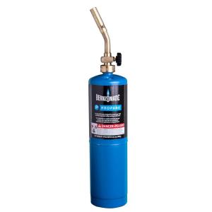

A torch is not doable since I don't have one nor access to one.
It's not hard to do. You can get a torch like this one at hardware stores, for $10-20:
