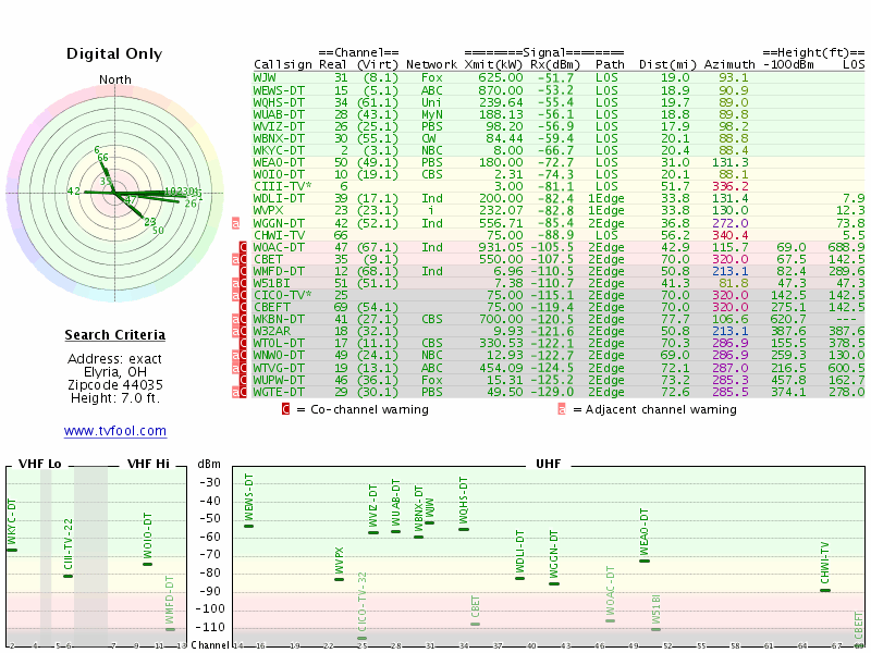

Okay here we go
I live in Elyria, Ohio (around 20 miles west from the Cleveland antenna farm) and i need an antenna since dish network dosen't have hd locals. I need an antenna $50 or under that will pick up 3,5,8,19, and 43 in hd. I will list both antennaweb and tvfool info for you guys. Also do you think if the RS DA-5200 will do any good for me. Any help? Thanks, bd8494
P.S. - I am a total newb at this

tvfool attached below:

Stay away from anything that looks like the 5200, It will not work well on VHF
Looks like your NBC is VHF, you would have better luck with the VU-90
All your Digitals will be UHF in 2009 except WJW-DT going back to Ch 8 and WOIO-DT which is jumping to channel 10.
My recommendation is for two antennas one Uhf, one VHF joined with a CM7777 pre-amplifier. Probably a CM 4228 for UHF and a Winegard YA-1713 for your high band VHF channels. The 4228 is probably overkill and a 4221 would probably work.
This setup will cost about $150 and there may be an indoor amplified rabbit ears type that would get you service, but no guarantees.
