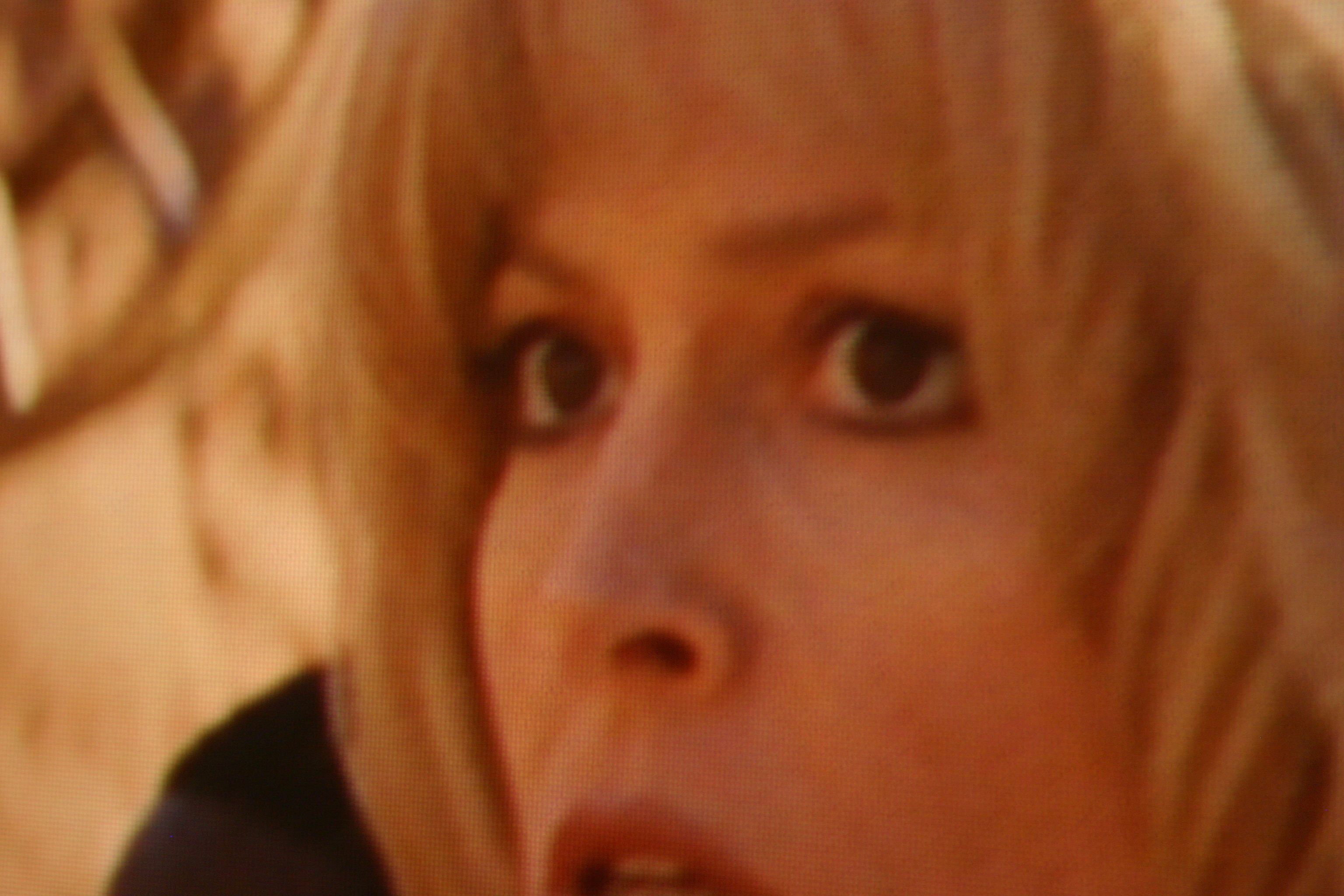

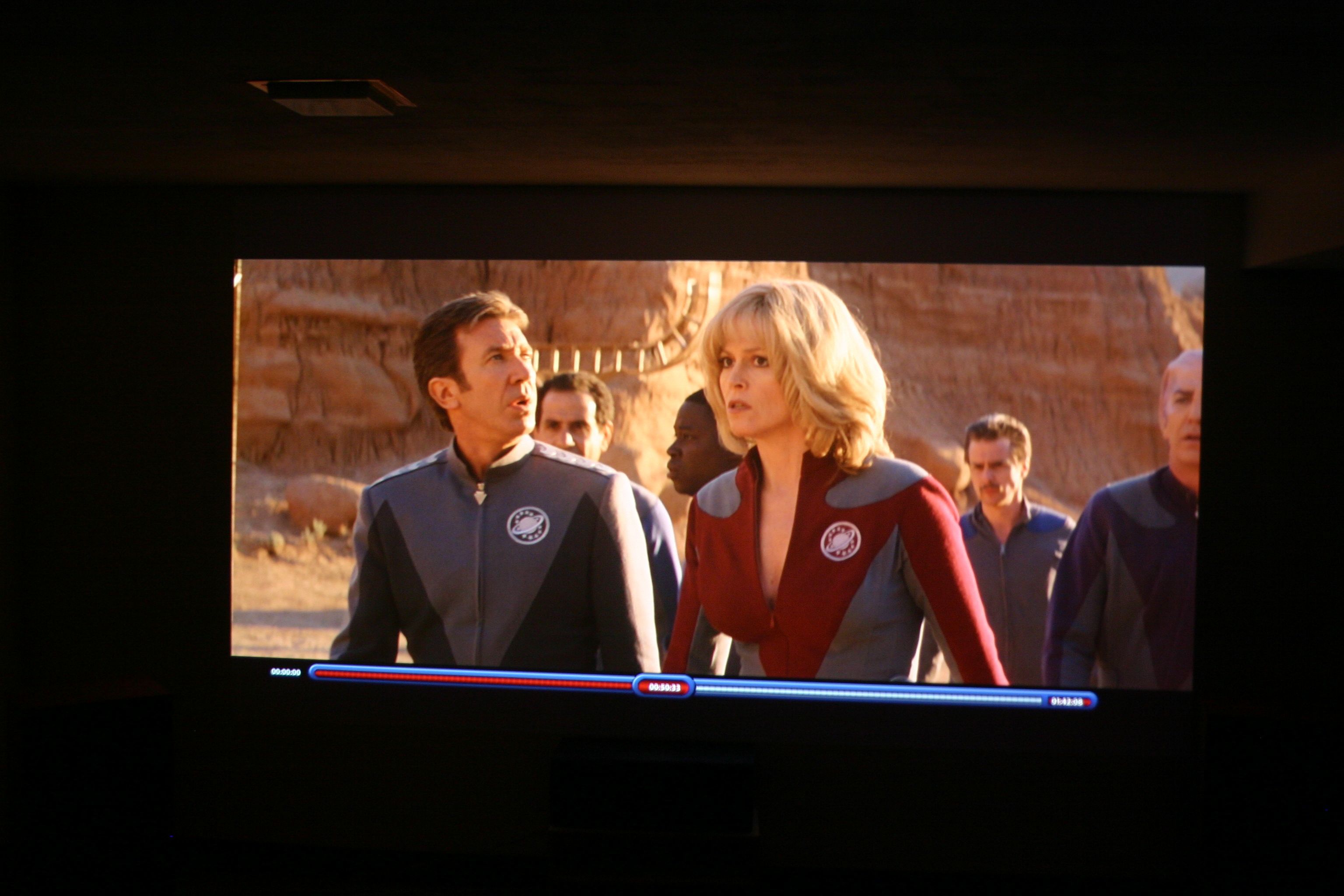

I moved the Panasonic down there tonight and went through the same sequences. It looks like the problem is solved as the Panasonic seems to upconvert, or at least doesn't drop the signal in the middle.
There would still be a problem with the projector, but most probably wouldn't see it in normal operation. I am happy for now. For those that are curious, I posted some pictures of the overall setup in the general Home Theater forum. I am also attaching a pair of photos here that show the degree of screen door on this projector. Since it is LCD, it will have some, but it is not noticeable in normal viewing conditions. Also, please forgive the slight out of focus. I seem to be having trouble getting the camera to focus properly on the image. Finally, I am still projecting on the wall.
