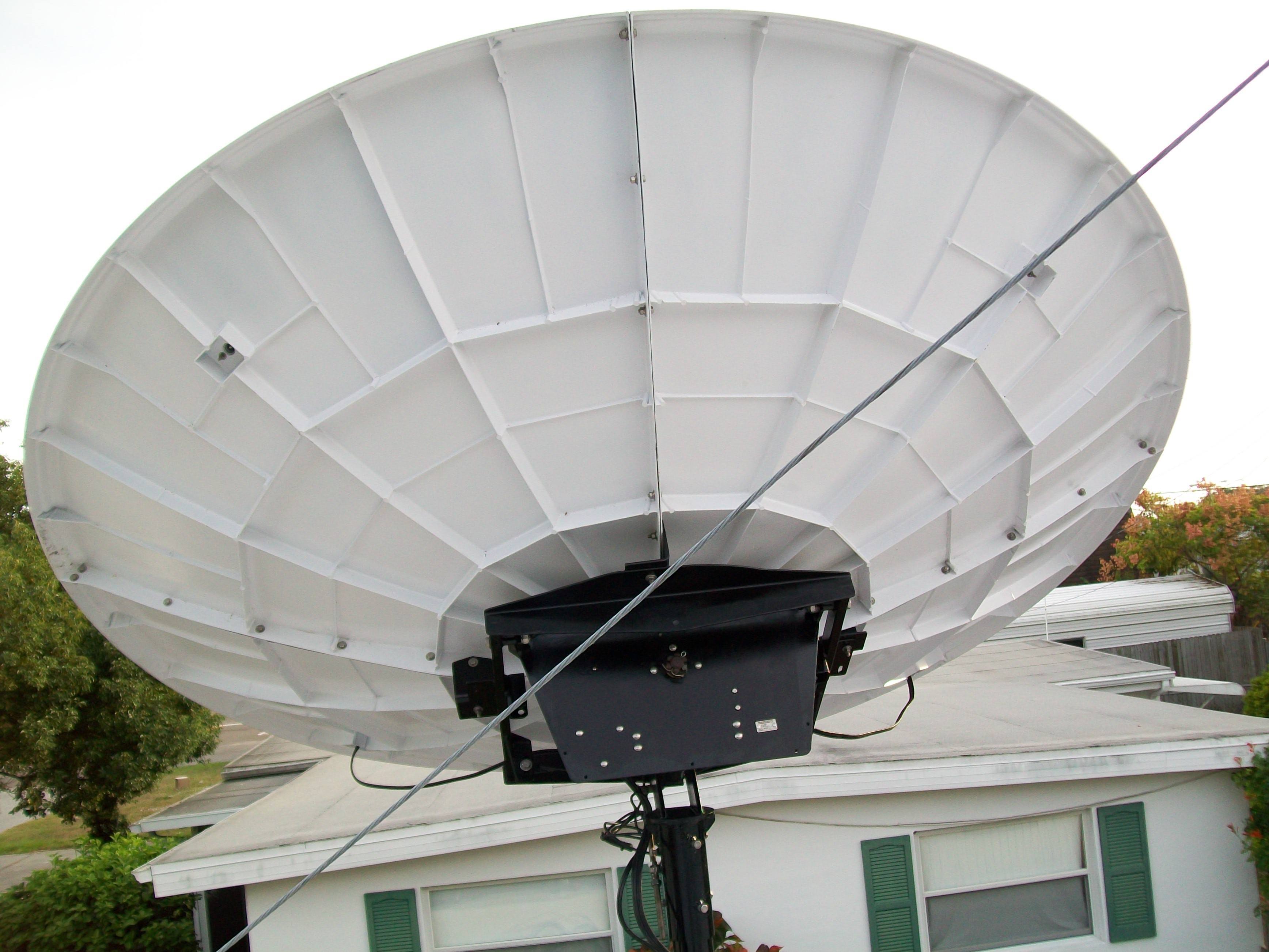

yes I can say Anole "you hit the nail on the head" yes they are built very strong an well built. really they are over built for a 8 1/2 foot dish, I even fab a mount on to a 12-foot Paraclispe an it ran it fine too, but here is a picture of my 10-foot ChannelView on a Birdview mount.
