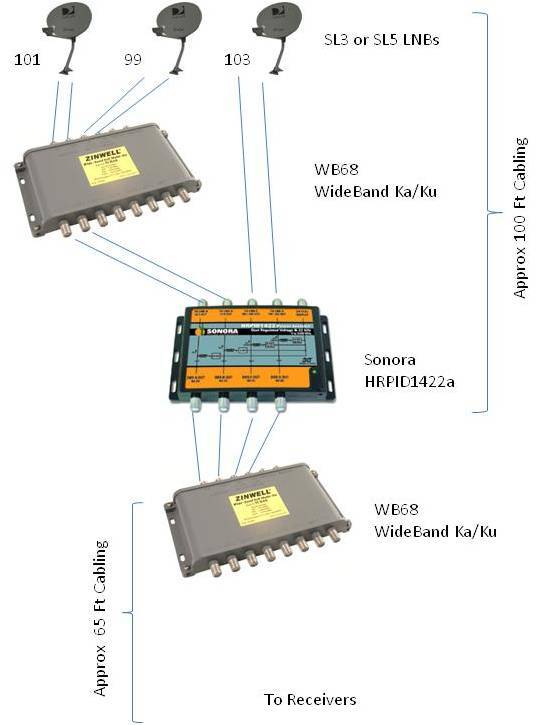

Would the attached diagram work ?

I don't think there is any way to combine feeds from different dishes like that. Do you have line of sight issues?
Edit: I just checked your other posts where you say you are in Mexico, so I assume you need the larger dishes. Anyway, I don't think your setup in the diagram will work.
I would have thought that by using the wide band multiswitch to join 99 & 101 would have worked....since there never will be a 22khz tone for the 2nd WB and the Sonora hrpid1422a will only send the 13 & 18V needed to the 2nd WB68. The sonora should also take care of any cascading problems of the wb68....
I am experimenting on to be able to combine 101 and 99 signals using 2 SL3 or 2 SL5 without having to use a DTVHAKAKUKIT LNB. These are expensive. I have seen of a diplexor solution in other site but seems incomplete since it chops out the KA higher frequencies on the 99.
Thanks anyway. Any suggestion would be great.
