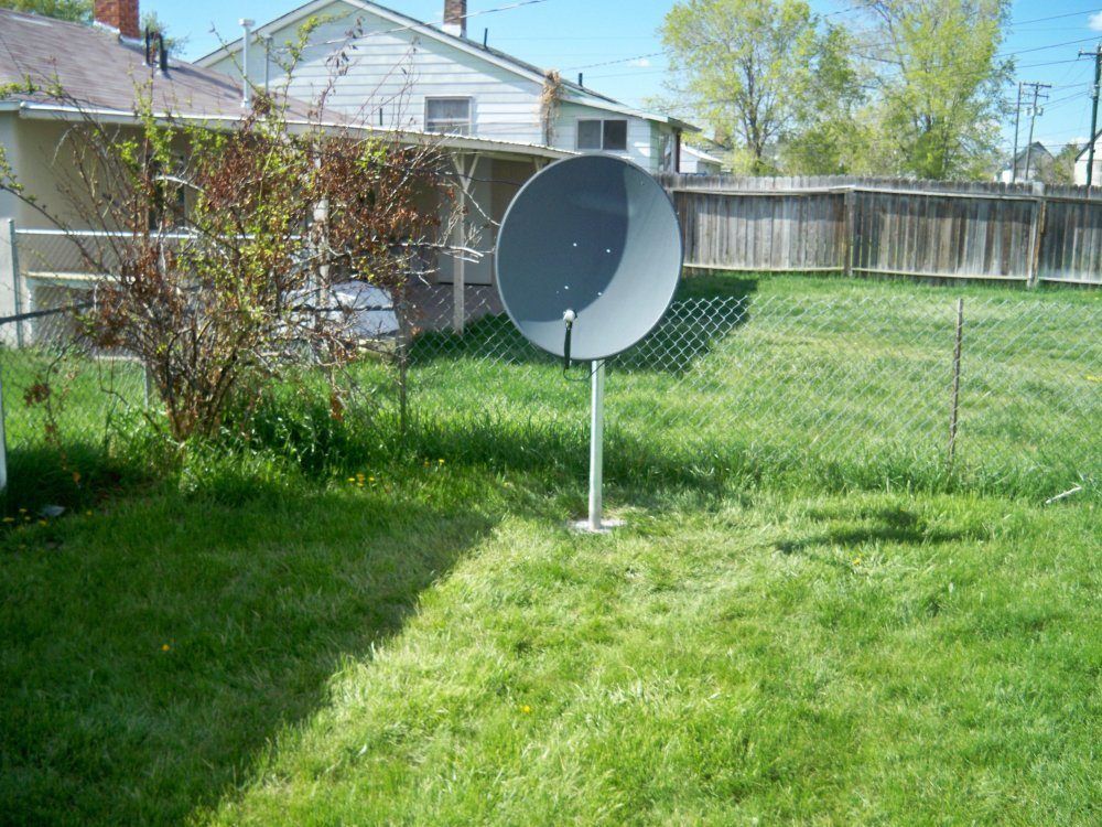

So as you might have saw my picture I sunk a fence pipe them put cement down it. Yes the pipe got hard but it move a little. I cannot explain a little. It seems more secure one way. The base in the ground it hard and does not move at all. Did I fook it up? I'm pretty sure it is not in a windy spot. But I do know when the wind hits. It might move. ANy other ideas?

Like I said. The base is solid. 100 pounds of concrete for the base. the base is sturdy. Just when I take my hand and move the pipe at the top back and forth. I could be over doing it. Since I will put the dish on it this friday. But when I move the post on the top. It goes back to center on the level. Plus I was not going to put the dish on the top. I was going to lower it down. Worst case. I put a stationary or 2nd dish on it and plant another pipe for my motorized dish.

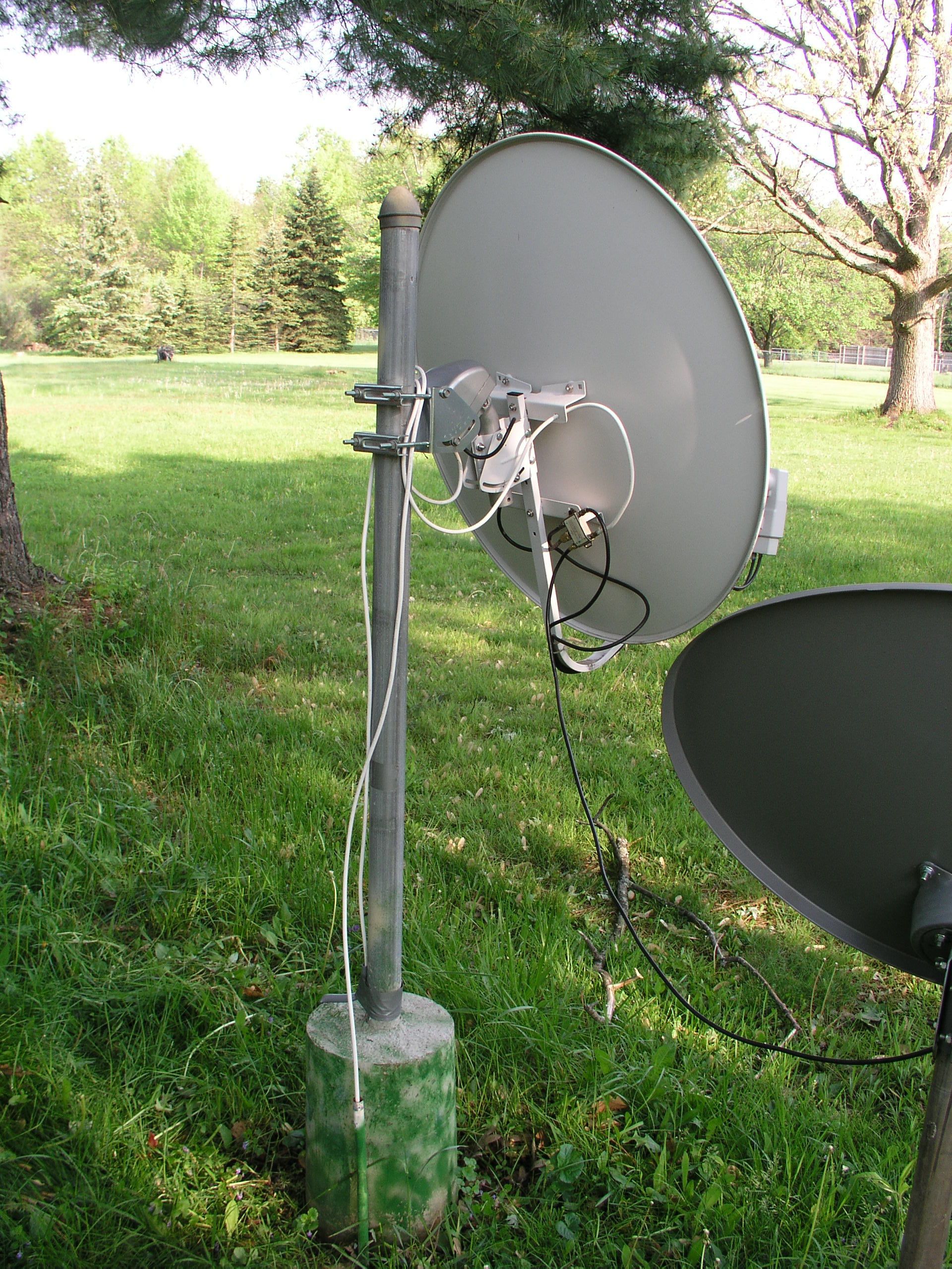

Pics of what i did.
This a pic of mine. The dish is only mounted 37" above the base. No movement.

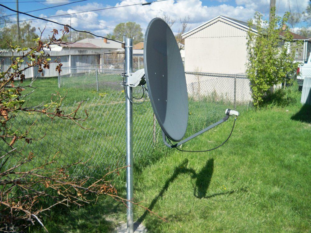

Well I got the dish up and wire ran. I was going for higher signals but I get like 30 on rtn and the signal jumps up to 40 and all over the place. Sigh. All the settings check out. Not sure if it was the dish or something else. But it is watchable. When I get a sec I might tweak it a little more. See if I can bounce it up to a stable 40 or something. Anyway here is some pics.

Hi ussexplroer and the group, nice and clean install! Love the thick lush northern lawn. Looks like the poll you used is at least 2 inches in diameter so I'm surprised you had any flex. Maybe the steel the post was made from was from a recycled car spring ;-)
What dish it that? Looks like winegard grey to me. 90 CM ? How does it do on other satellites? Sometimes a bouncing signal quality indicates a tree branch blocking some of the signal. How is the view under the bottom rim of the dish looking up at the LNB? Any branches?
