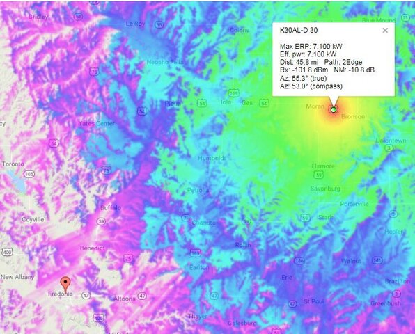

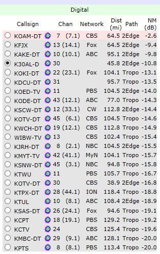

Lunch might be doable.
No luck for K30AL here. TV Fool showed there might be a chance for reception, but it's 2-edge at 46 miles and -10.8 dB.

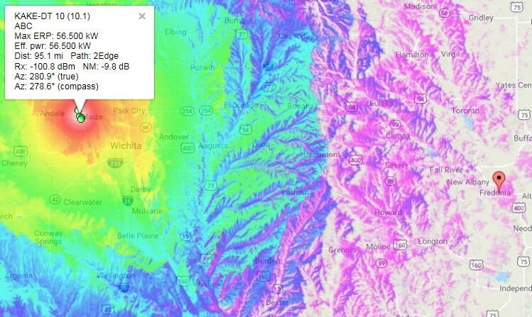

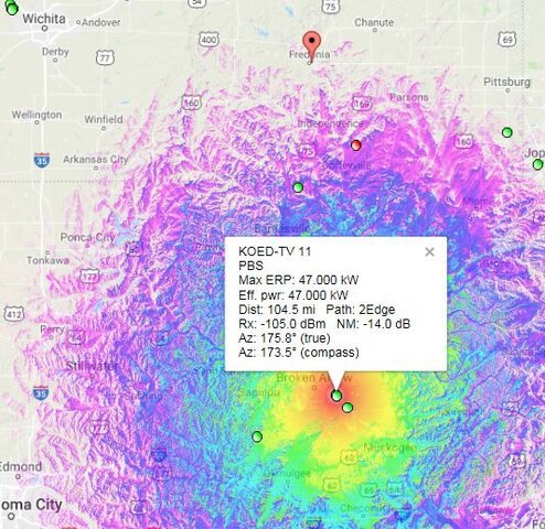

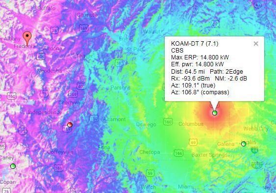

A few snippings of the coverage area here with a modest 25' antenna height.
25-ft.JPG K30AL Snipping_25ft.JPG KAKE-25ft.JPG KOAM-25 ft.JPG KOED-25ft.JPG
