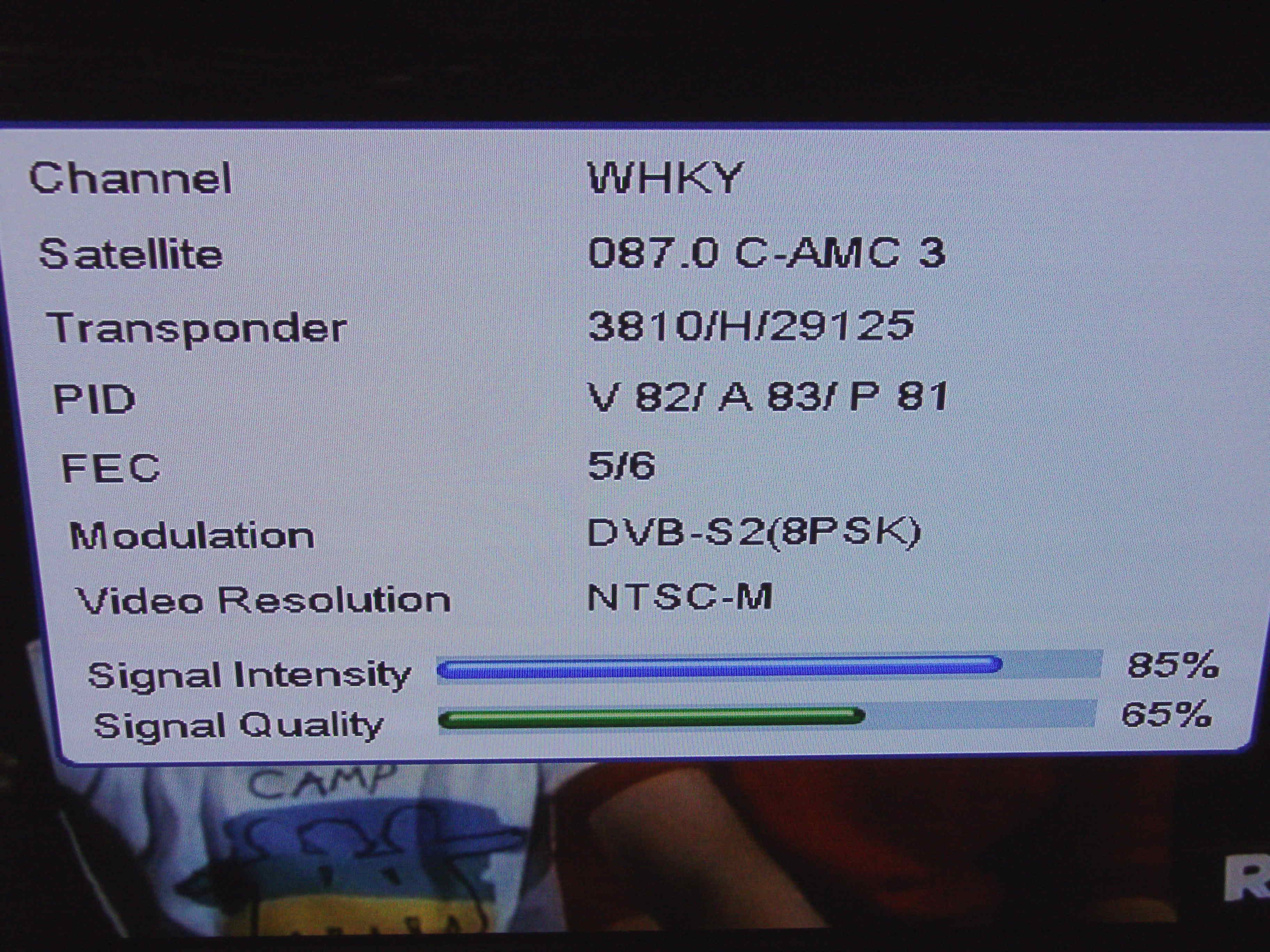

FINALLY got the RTV 3800 mux on 87W with the 6 footer
Mr Tony
Nov 17, 2003
4,154
17,578
Mankato, MN
was just goofing around with the 6 footer seeing what was new on 87W (or rather what was left) and on a blind scan I locked the 3800 mux.....first time ever. yet when I watched the channel I got no signal on the Manhattan.....then I remembered on the AMC7 mux (4160) you have to change the frequency up like 5 to 10 and they come in. Changed the frequency to 3810 and BOOM signal came in
So now I can get both RTV muxes on the 6 footer.....sadly most of them are the same program (RTV East or West if they are on the west coast). Too bad Metv and ThisTV are leaving soon...was kinda nice to have them there ;)
So if you cant get the 3800 mux with a SSO/Manhattan......do a blind scan to see if they will come in...then change the frequency by 5 or 10 up from the "should be" location...ya never know ;)

Yep that is what I do on some feeds on the openbox, and yep the rtv mux on ses-2 is one of them.
This MUX scans in using my Skybox S12, but no signal. I then hookup my Openbox S9 or Optibox Anaconda and this MUX has a signal above 80%. It's the weirdest thing.

I'm gonna try that asap. I was thinking my dish was mis-aligned (which it could still be), but being able to collect signals would help refute that.
I just did this on my Skybox S12 and am now receiving the 3800 (now 3810) MUX with a high signal.
For some reason the Weather Nation, IPTV, UT Feed MUX plays great on my Openbox, but scans in with a very low signal with no picture on my Skybox S12.
glad to hear its working for you too. Even 3805 brings it in

I know it does it on both the RTV muxes on 87W (the 3800 one only...4080 is fine) and on 137W (4160 mux)...havent tried any others yet.
Do a blind scan and see if they scan in. They will scan in at the right frequency but then after that you have to change it to the "new" (+5 or +10) frequency for them to come in
