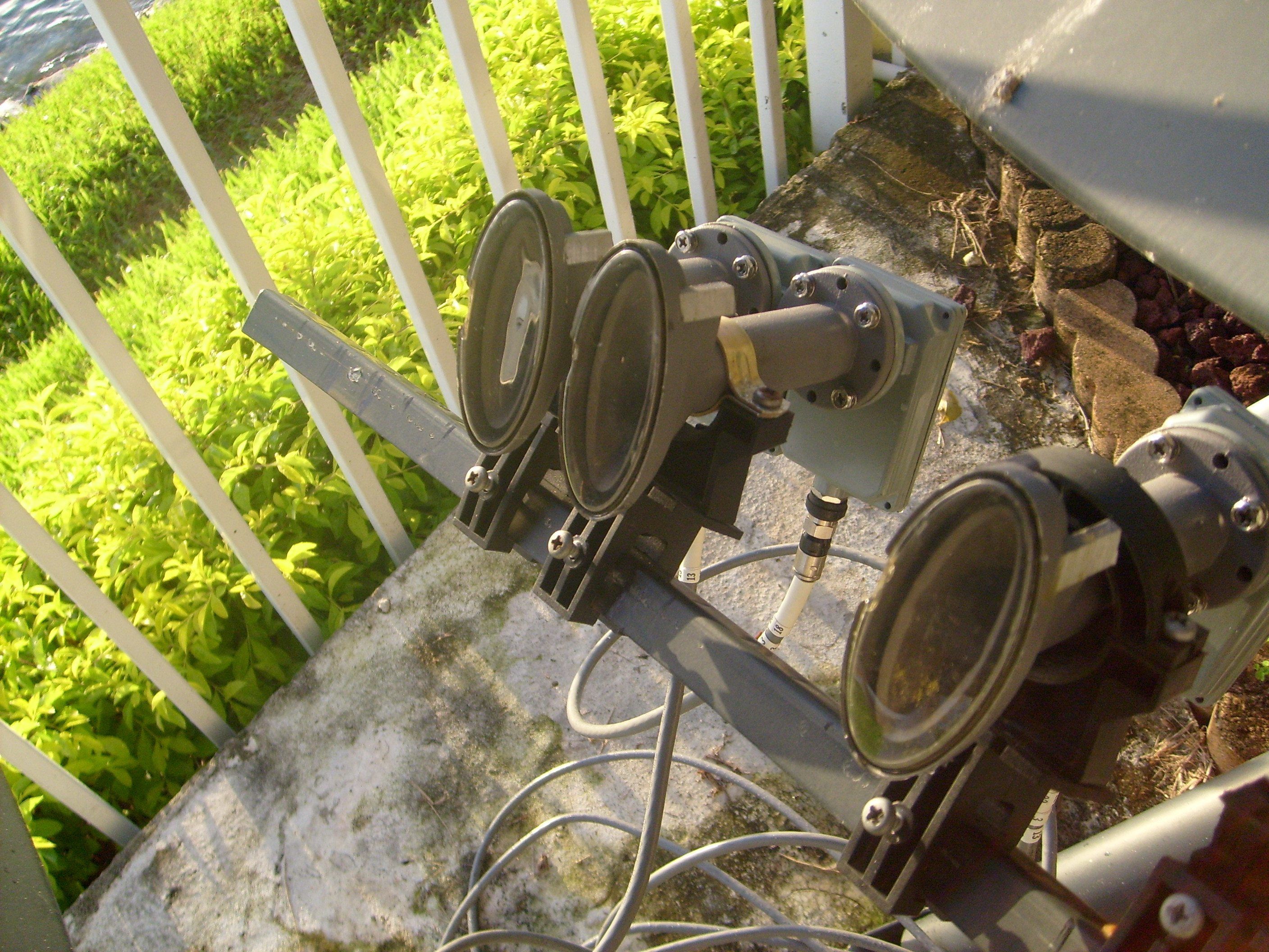

I have 2 degree spacing working very well on the T90. Had to try alot of different LNB's. But these work great; Eagle Aspen P870 FSS Stacked LNB.
Jerryt, I assume that both the stacked LNBs and the squeezed feedhorns are from Superdishes. Sounds like a great idea, no need for dual output LNBs since they are stacked, and they seem to allow for 2 degree spacing. Other than E-Bay, is there a good source for these FSS stacked LNBs and the squeezed feedhorns?
Only Ebay. $9.00 currently.
In Europe we usually use the Alps rocketfeed for 2 degree spacing as you can see from pic.
They cost around $2 each.
Jerry
Do those LNB's fit into the LNB holder that comes for the T90?
