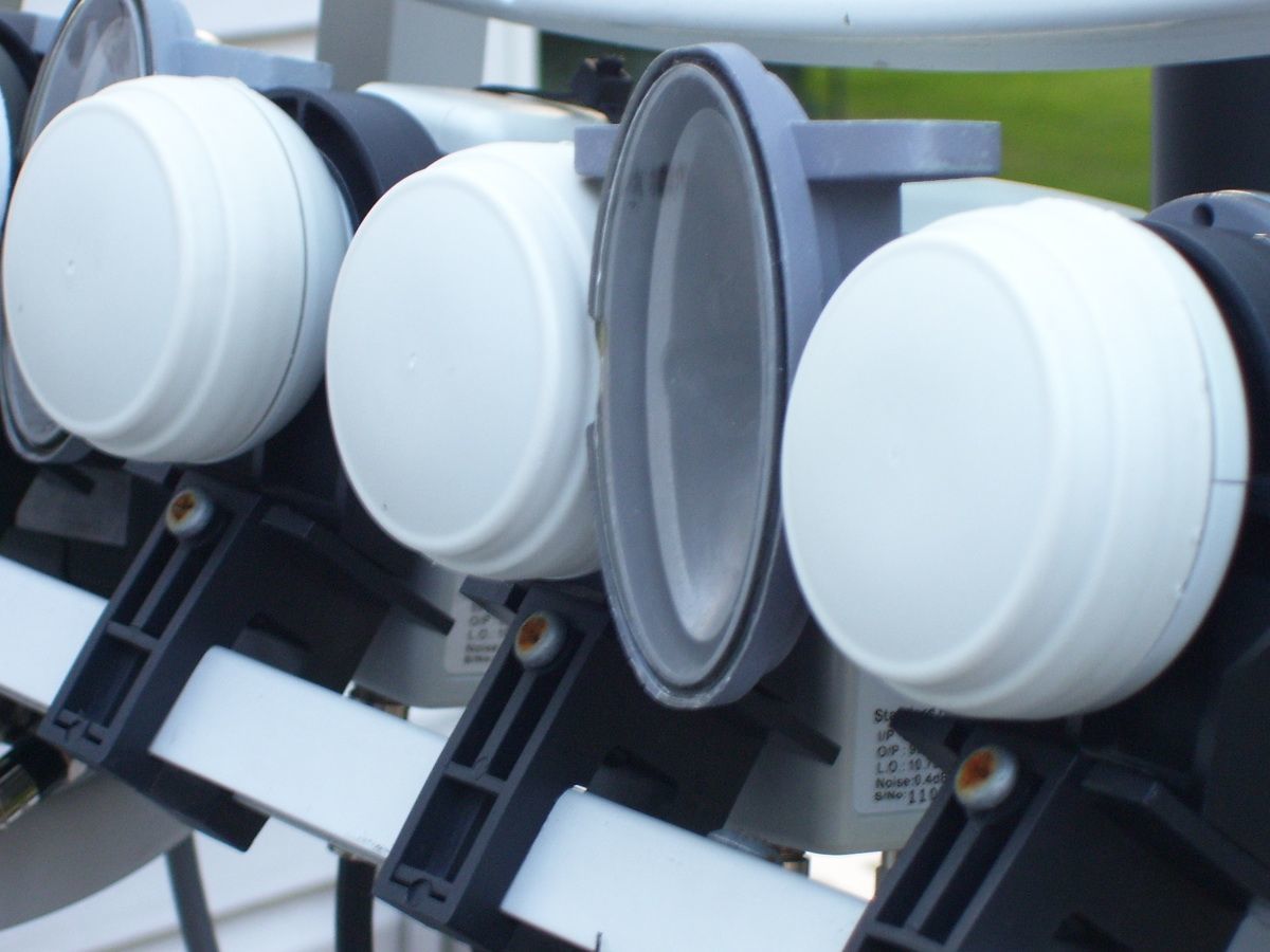

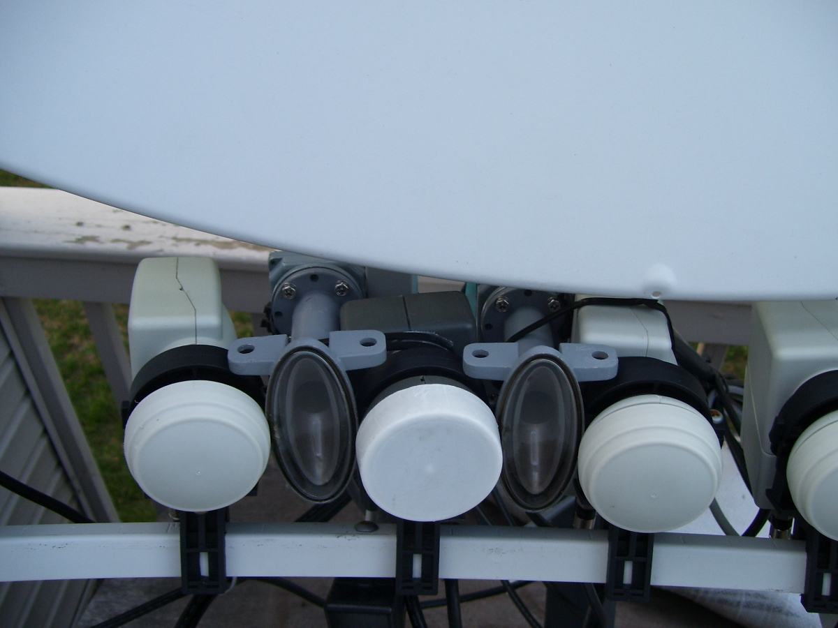

So I tried to slip a LNB in between 85 & 89 where I already had LNB's set up. These stacked units have slots to mount to a dish and they caused issues. So I figured "lets put them on top". The LNB is a 2 piece. Took the 4 screws off and flipped it 180 degrees. The skew would be the same as the LNB itself doesn't change. Just the flange does. Now the mounting holes are on top.
Slipped that in between 85 & 89 and let the mount rest on top of the other LNB's....BAM...80 on 12180 TP.
Now stacked technology is different as the H transponders are "stacked" on top of the V and the polarity is vertical. This allows you to hook multiple receivers to one output since they are the same polarity. The LNB LO is 13850. So I changed it and scanned vertical only which makes it quicker. The vertical TP's (the normal ones) are pretty much the same but the normally horizontal ones go backwards. So it scans the normally V from low to high (with the weird frequency) then scans the H (on the V side) from highest to lowest. So I scanned AMC3 and got pretty much everything I wanted at very good signal levels. So 12180 is now 15280
Then I tried G11. Took the screws out again and flipped it. Since the only thing V I could find was 12080 slipped it in there and bam 75

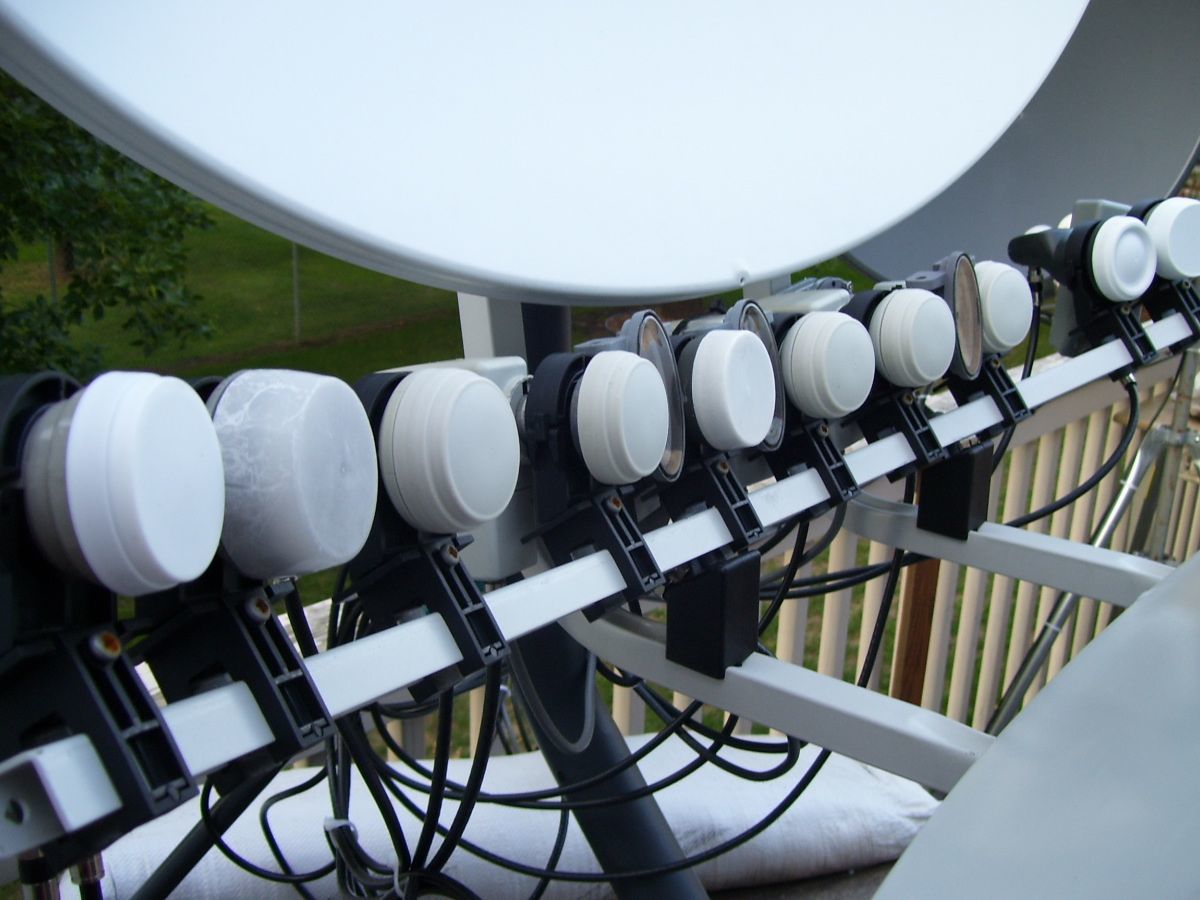

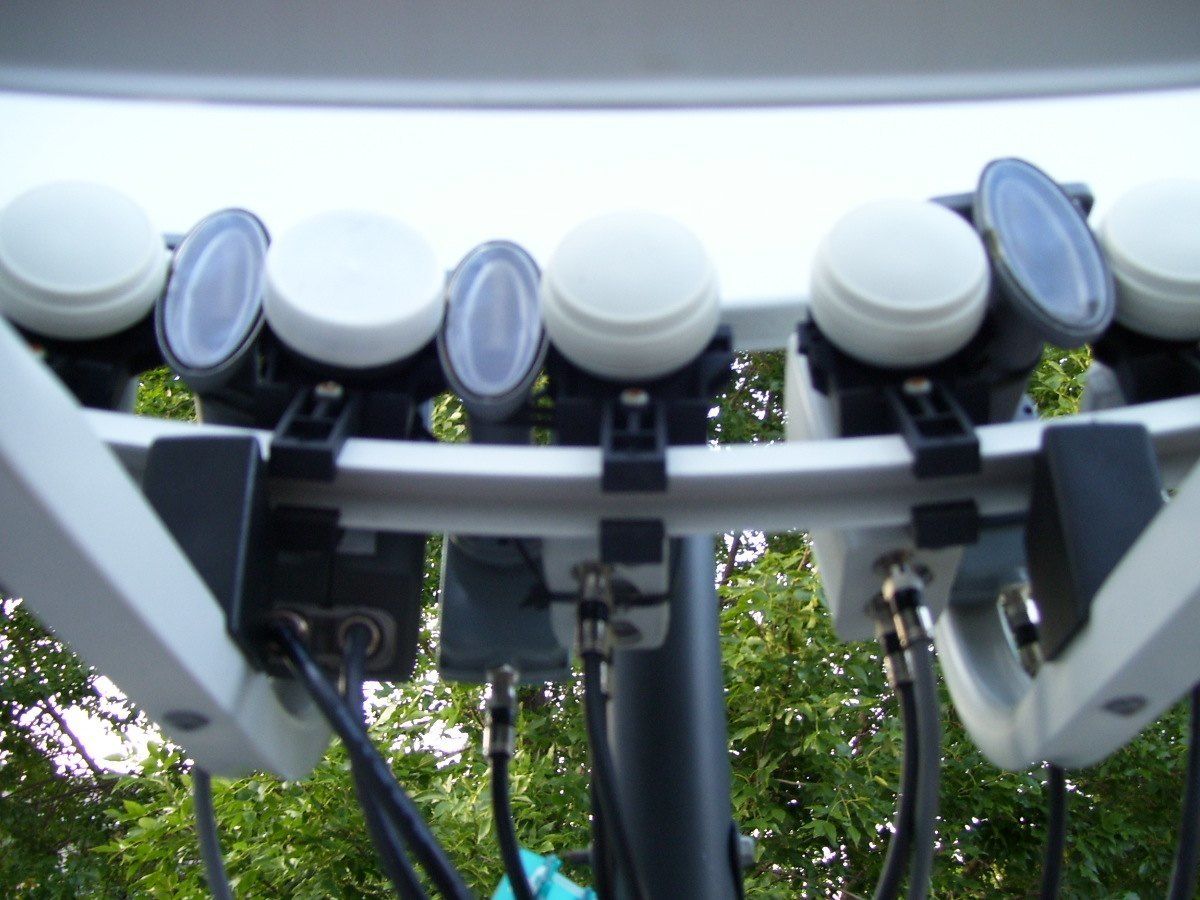

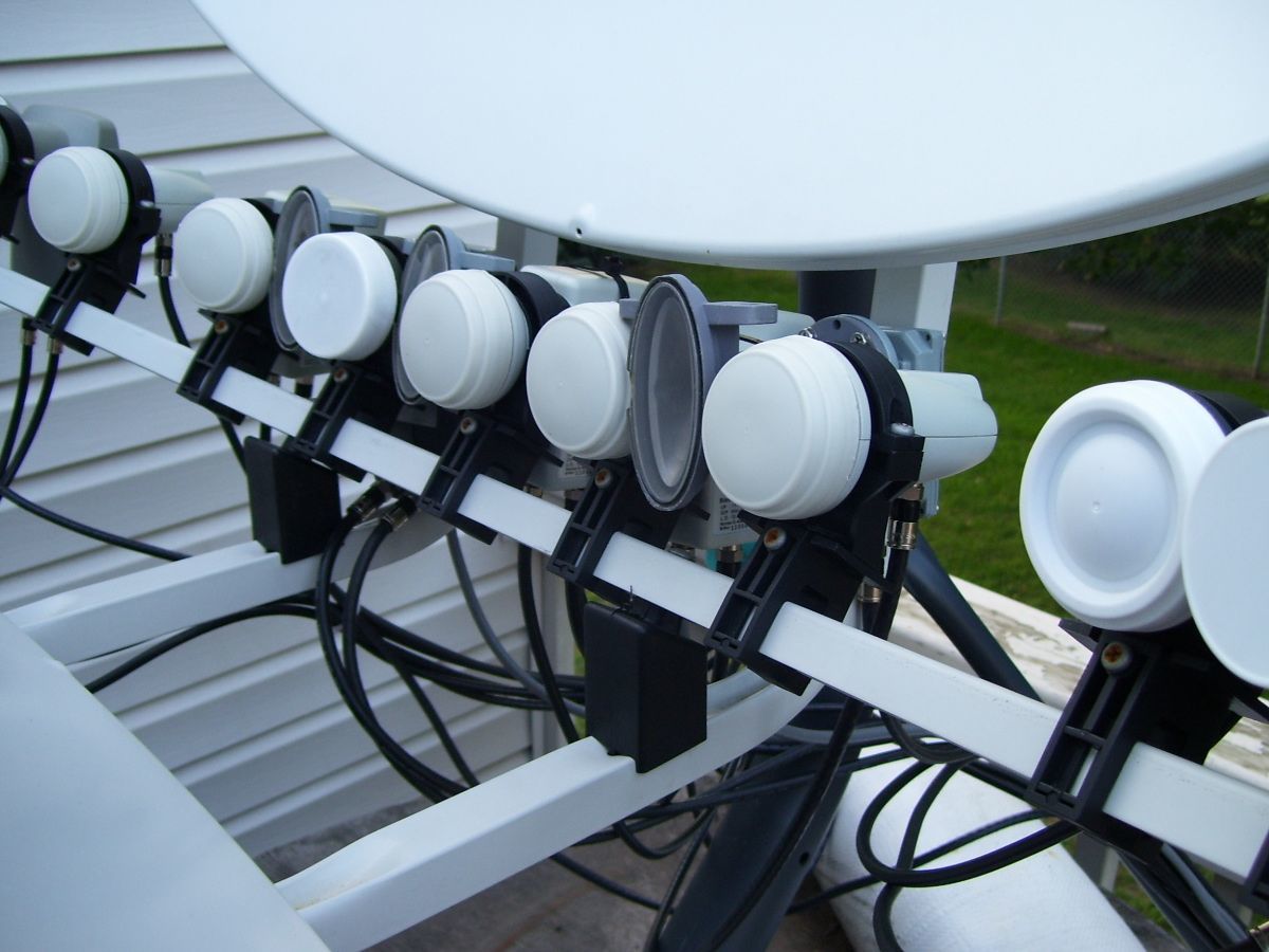

first two pictures are all of them
3rd is closeup of 85/87/89/91/93

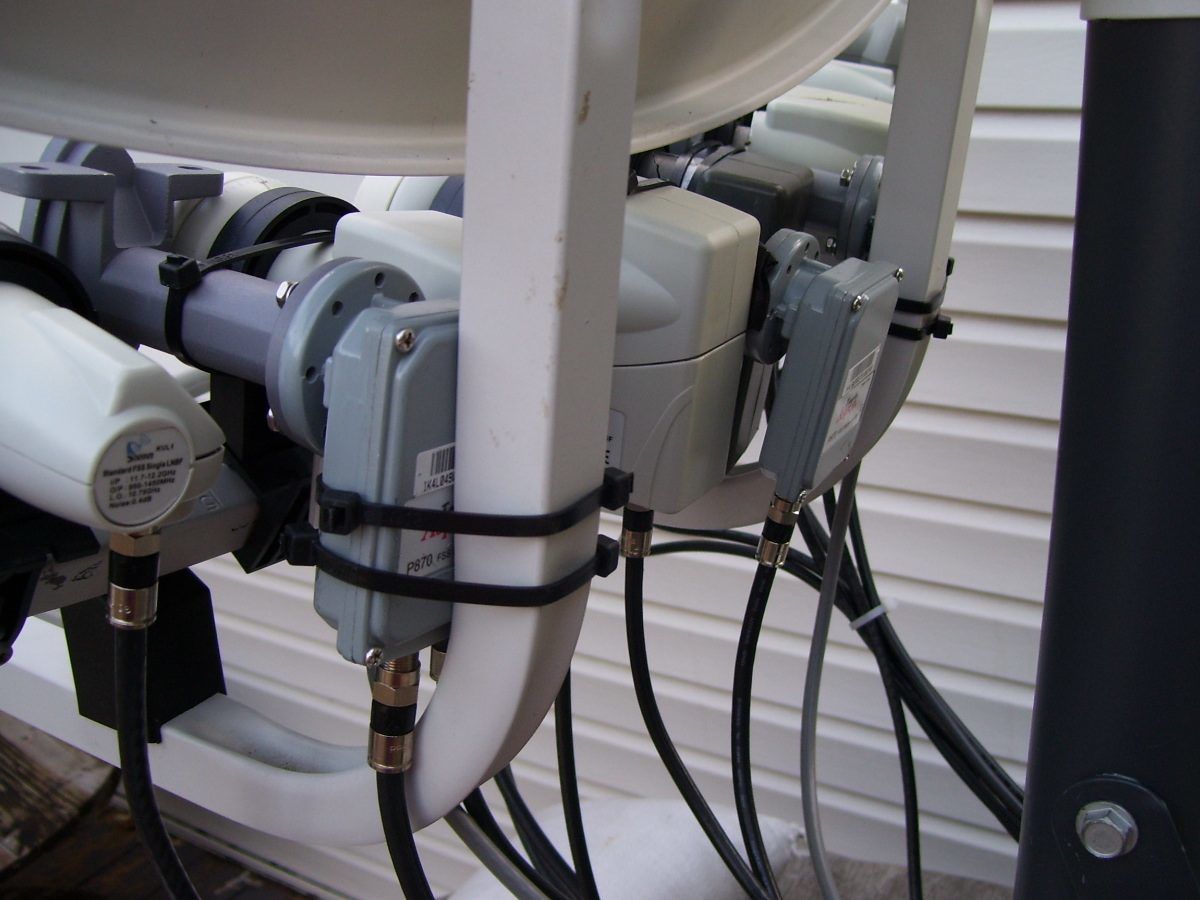

4th shows most fo them

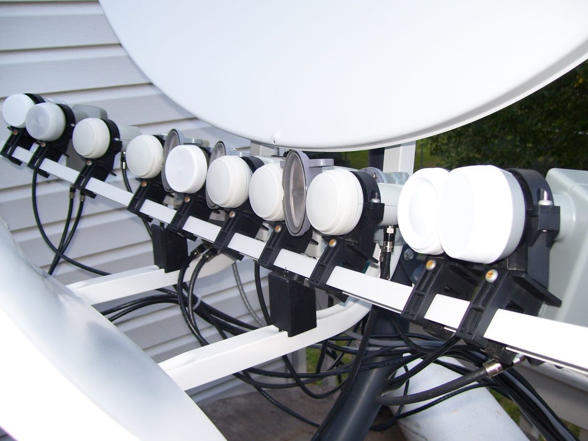

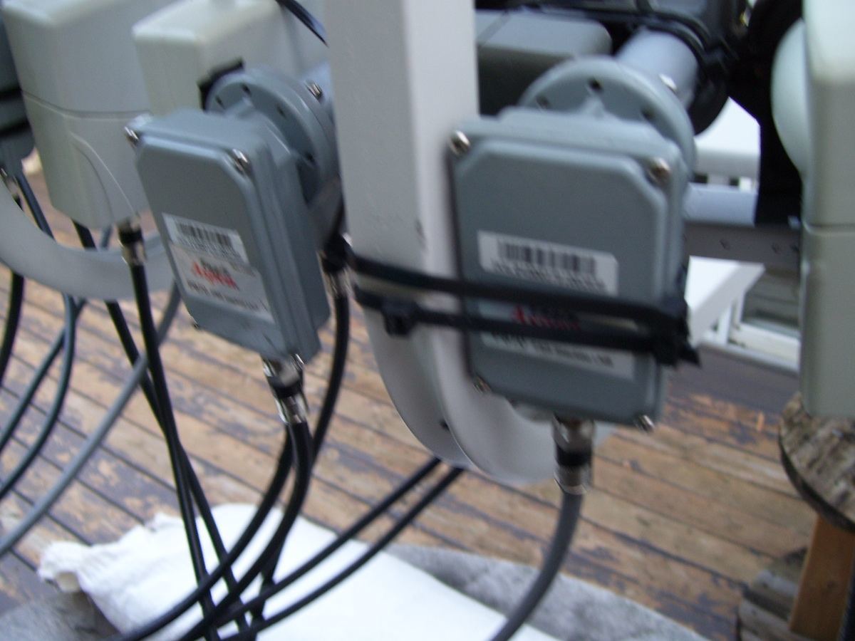

5th shows back view

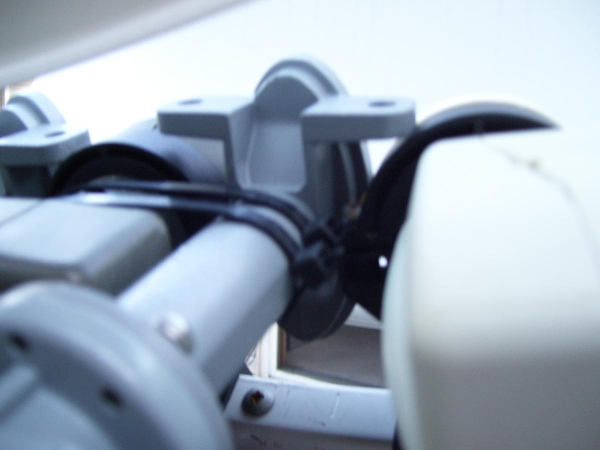

6th is below view
7th is closer back view
8th is closeup of how the bracket rests on the other 2 LNB's

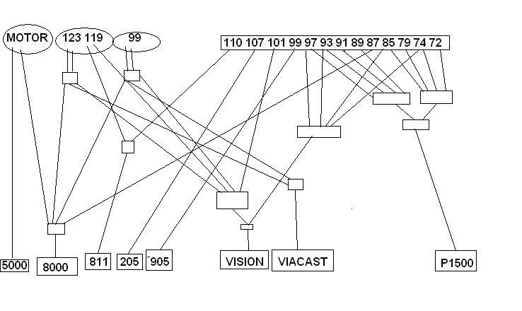

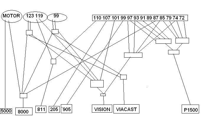

Seriously, though, have you drawn a schematic that we can all see? Pretty please?
oof. Most of my "schematics" are just hand scribbed drawings on notebook paper while I sit at work :)
Let me see if I can draw something up and scan it in. There are lots of switches & wires running under my deck but I know where each thing goes (thats the scary part). The original drawings didn't work out for various technological reasons but I probably have a few hand scribbled drawings around

OK...here is a really bad paint program of the setup below so I'll try to describe it.
4 dishes outside. 30" motorized, 36" dish at G10/119, 6 foot C-Band dish at 99 and the T90 with LNB's at 72,74,79,85,87,89,91,93,97,99,101,107,110
3x4 multiswitches on 123 & 99. 99 is H only due to using an old LNB that gets one polarity at a time :)
Coolsat 5000 runs the motorized. There is a dual KU and a DBS LNB up there.
Coolsat 8000 has a feed from the motorized, 123, 99 C-Band and 87 (since it can decode AC-3 through the box)
Dish 811 has 119 & 110
Starchoice has 107
4DTV 905 has 99
Viacast 2000 has 123 & 99 C-Band. The box is simple (10 tp entry max) so it's limited on what I can get
Pansat 1500 has 8 LNB's via 2 4x1 diseqc switches and a ecoda 22k switch (which can pass diseqc commands). 8 LNB's are 72,74,79,85,89,91,93,97
Visionsat also has 8 LNB's via 2 4x1 diseqc switches and a ecoda 22k switch. 8 LNB's are 74,85,93,97,101,119,123,99 C-Band. Since I can only blind scan on port 1 of diseqc switches (known issue) 74 & 85 are on ports 1.
so there ya go....schematic current as of...oh right now (it could change in 10 minutes) :)
