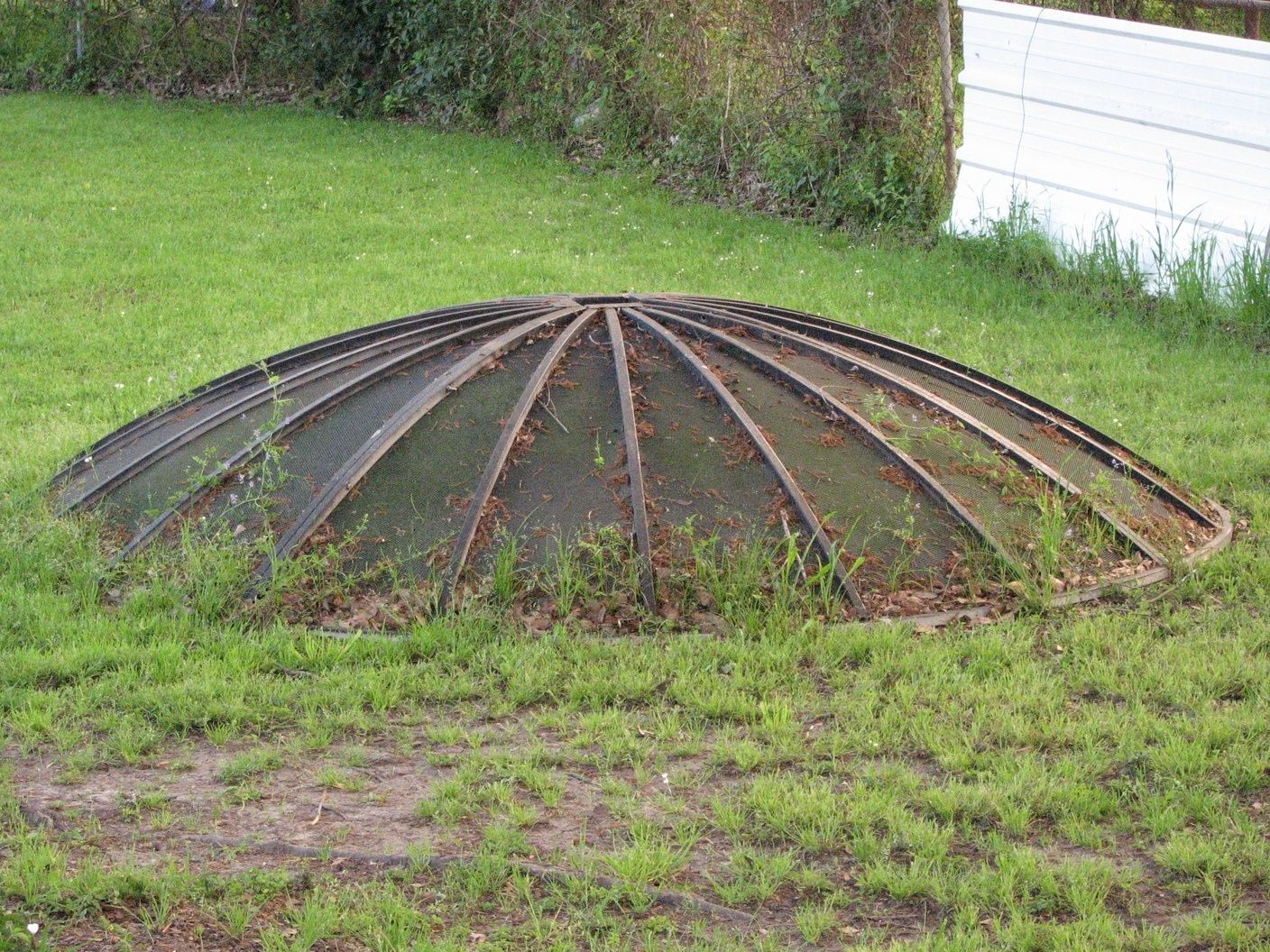

Ok, so I've been struggling to get a Cband dish up now for a good while.
Struggling with finding someone to do the labor that is.
Long story short, I pretty much have someone lined up to do the labor for me this weekend coming.
I'm putting up a 10' mesh dish, it's pretty light, I can lift the four panels all at once when it was in a disassembled state. Once all the other stuff is on it though I'm sure it's going to be pretty darn heavy. Anyway...
I'm also putting up one of those little 6' dishes that were on sale last year for $80.
I have a Gbox to move the 10' dish with. I do not have one for the 6' dish.
I also have no idea yet how I will connect the Cband dishes into my system but that's down the road still.
My dad purchased a pole, I think it was 21' long to begin with and he had them cut it to fit in his van. The longest that would fit was 11 1/2' and that left the other piece being 9 1/2' long.
I'm thinking that, and please correct me if I'm wrong, that I need a minimum of 6' of pole sticking out of the ground so that the 10' dish will have 1' of clearance under it. I would prefer that it have more clearance but, I'm worried about having enough of the pole in the ground to survive a hurricane.
On the 11 1/2' pole, if I leave 6' sticking out of the ground then that means I will only be able to put 5 1/2' in the ground. Is that enough? I was thinking that the hole will be like, 16" around and my dad estimated it will take 16 sacks of cement, each sack being 80lbs. That would be 1,280lbs of cement on that pole.
Would this be strong enough to survive a category 2 hurricane? (sustained winds of 110mph)

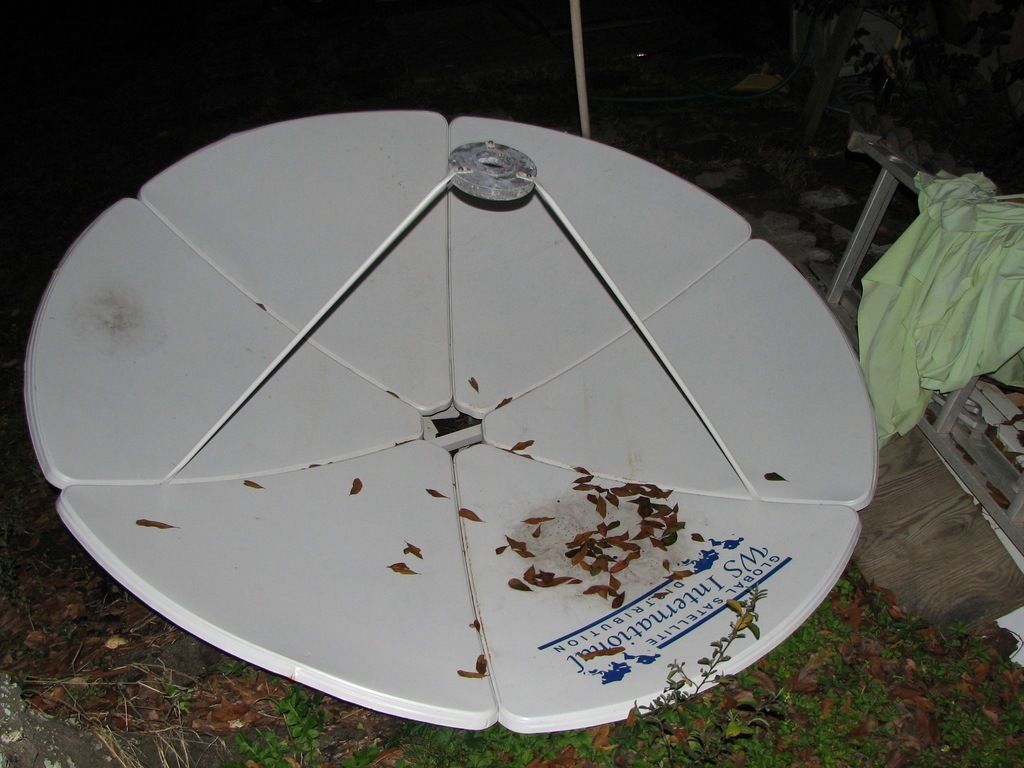

Next up is the 6' dish. See the attached photo..
The pole for it is 9 1/2' long. My concern with it though is that it is solid vs the mesh. So in a storm it's going to have more pressure on it than the mesh would.
BUT, the thing is very flimsy and it's already bent in several places on the edges and to be honest, I think that the first tropical storm (max wind of 73mph) we get here, that thing will fold up like a cheap suit and it will go into the trash pile at the curb. I have no faith in that dish at all to withstand a storm.
Anyway.. So let's just ~pretend~ that it would survive a storm. If I put that pole 4' in the ground, leaving me 5 1/2' out of the ground so that the dish should have 2' of ground clearance, would that be deep enough?
Also. I do not have a device for moving the 6' dish, yet. Eventually I will but for now I think what I would like to do is point it at one satellite and leave it there until I can get another Gbox for it.

Yes and yes, on the pole-planting Dee. Should be plenty in the ground for that size dish, with the concrete added in. I have a 10' that has about 6' above ground, and it has plenty of clearance between dish and ground when its on 137W, which is rare. If you have to mow under it, you may need to remember to park it on 87W or someplace higher in the sky so you don't bump into it. Or just weed=eater under it like I do. (its hard to do damage to a 10' with your head while running the weedeater). Trees probably won't be a big deal, there's not that much on anything west of 123 that isn't scrambled on c-band. Wind-loading, not sure about hurricanes but I remember reading someplace that above a certain dish-size , the wind-loading is about the same for solid vs mesh, can't recall the formula right off for it though. You'll pick it all up quickly once you start assembling, if you had an old analog receiver it might make aiming easier, but if not, an angle meter will suffice.
Good to see it going up dee. Let us know on the progress. Wish I could find me a good 10 footer but I think my wife would kill me.lol
1- I need a minimum of 6' of pole sticking out of the ground so that the 10' dish will have 1' of clearance under it. -
I think that will give you more than 1 ft clearance, more like two, minimum, with the actuator attached.
2- 5 1/2' in the ground. Is that enough? -
I'm not a engineer but think the pole will survive, Check with the manufacturer for "Wind Survival" of the dish.
3- Solid vs mesh. So in a storm it's (solid) going to have more pressure on it than the mesh would.-
Not necessarily true. Mesh is effectivley closed in a strong wind. Many car grills are so designed to generate more airflow over the car (drag reduction) at highway speed.
4- leaving me 5 1/2' out of the ground so that the dish should have 2' of ground clearance, would that be deep enough? -
See answer for 2-
