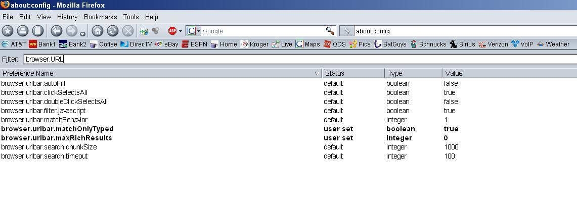

With the final rel v3.0 this 'about:config' method worked for me to achieve your stated goal; WITHOUT any needed additional plug-in etc.
see attach screen cap

Double check the about:config edit and then restart your session. You can also turn off your browser's URL memory feature; which enables it to remember anything you entered previously in the URL bar.
