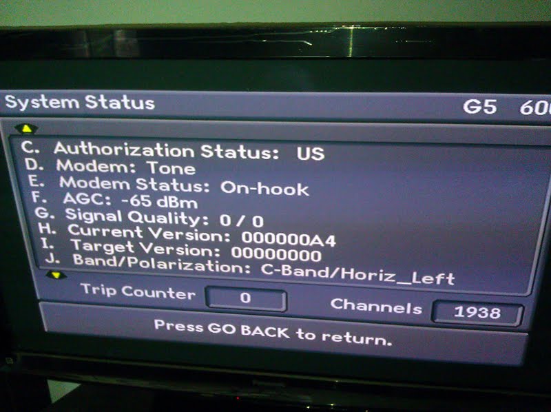

Once this is done this is what you will notice....
nothing different except that whenever a picture is FTA it will actually show up on you TV and not some gray screen saying...
"MISSING RATINGS CEILING INFO"
I bet it took you all of like 10 minutes or less to do this too!
