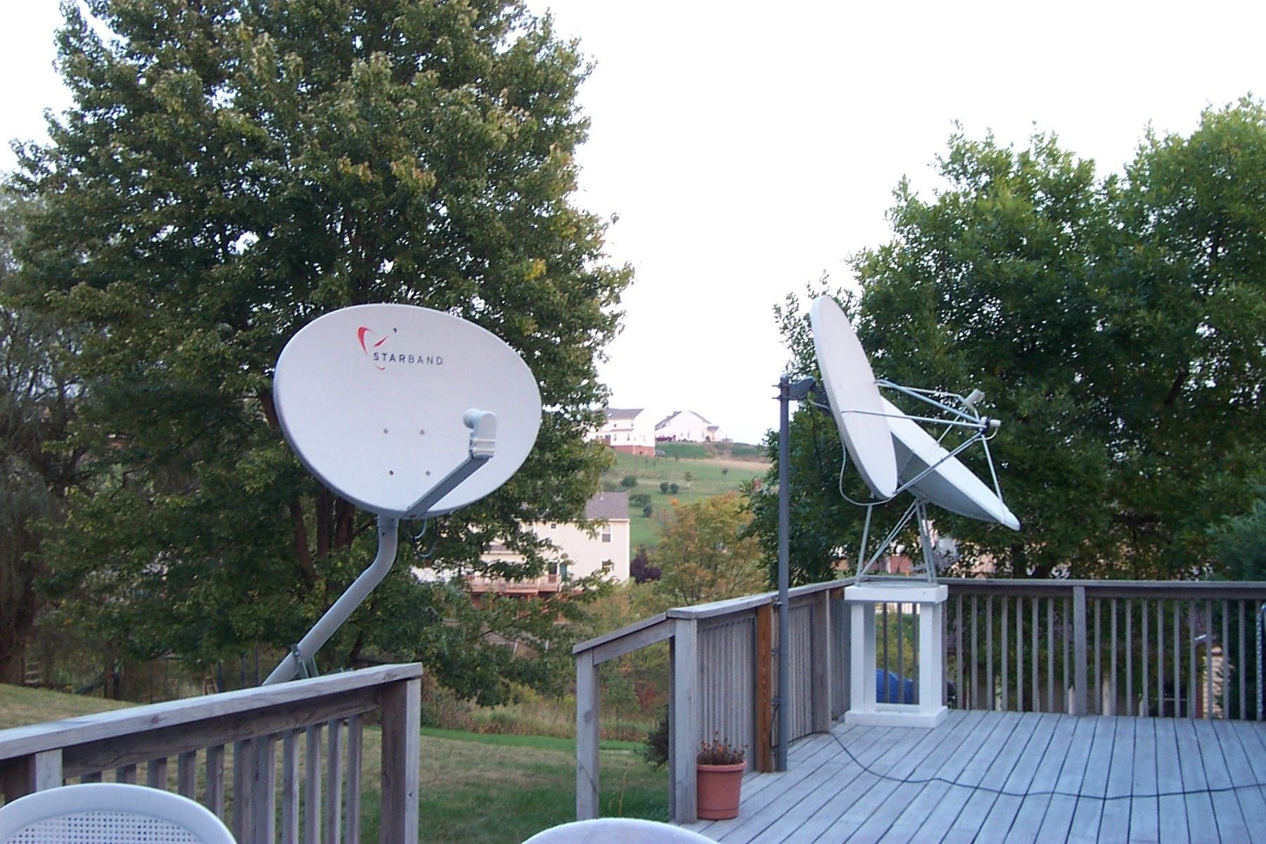

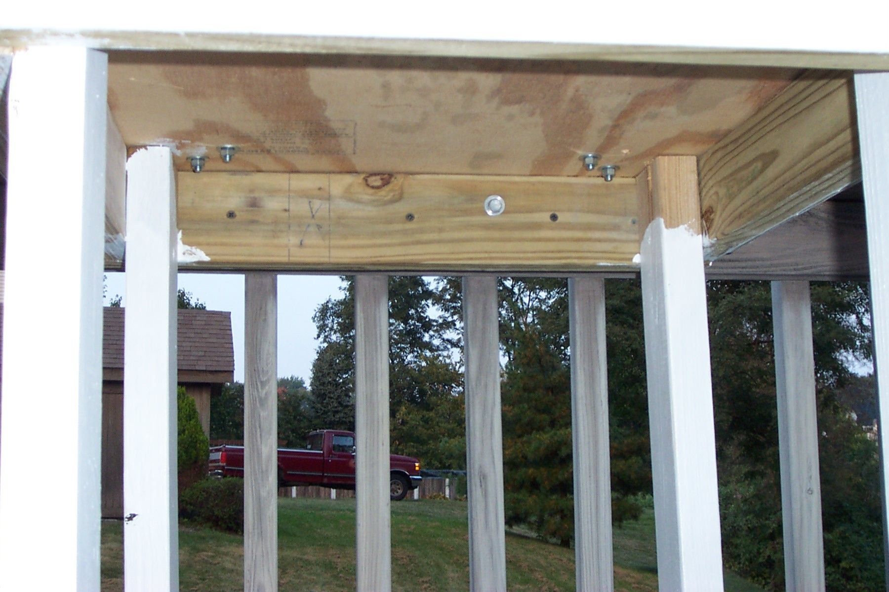

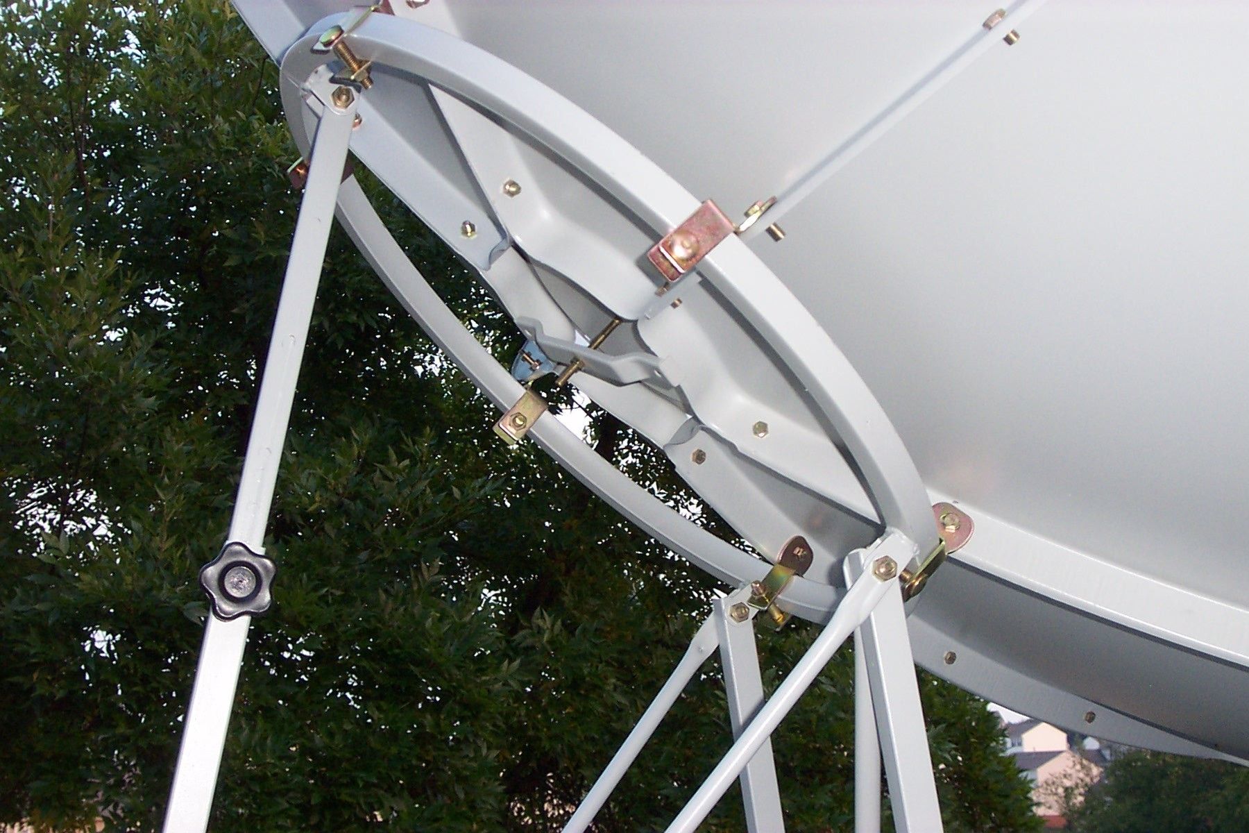

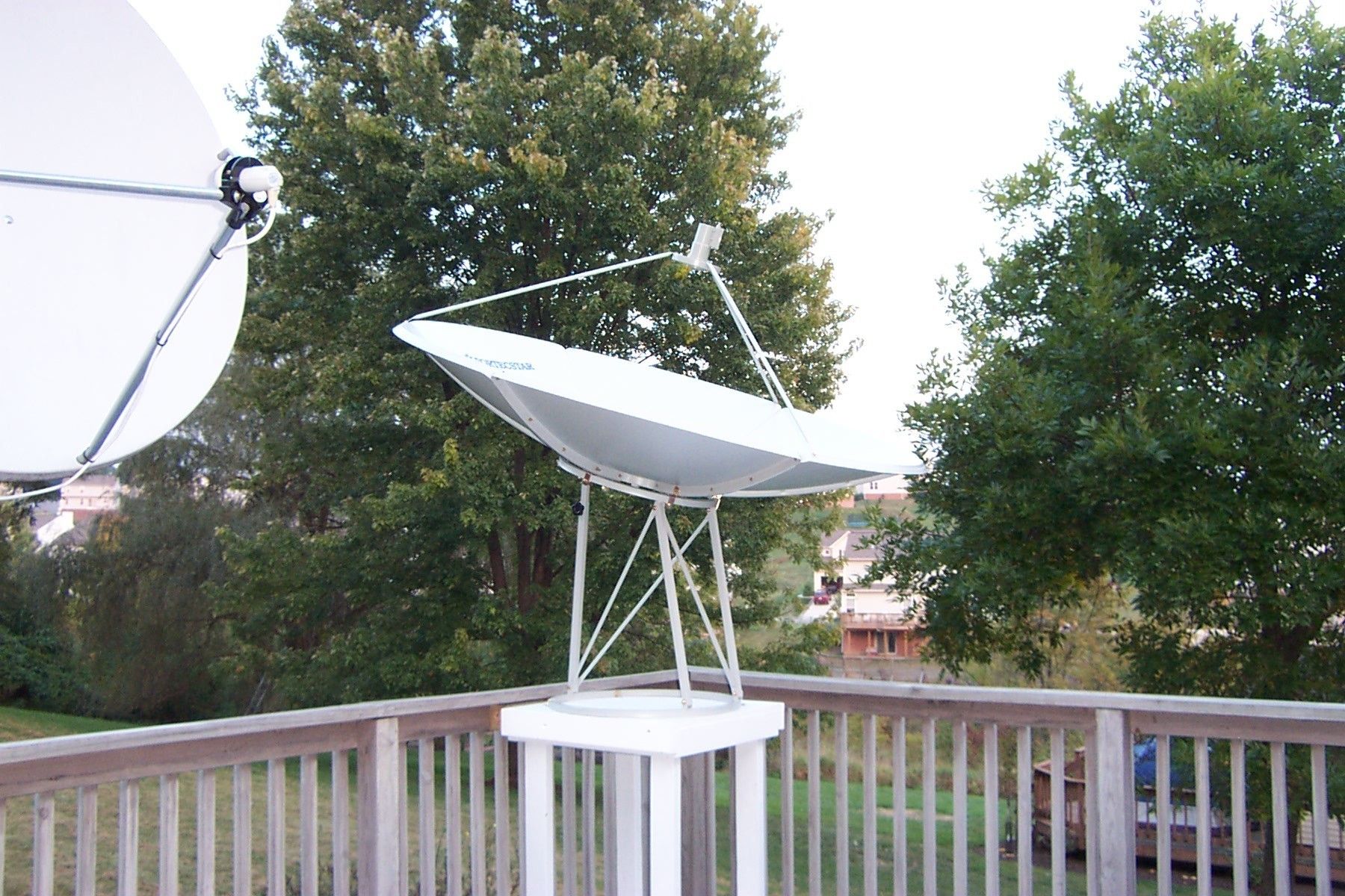

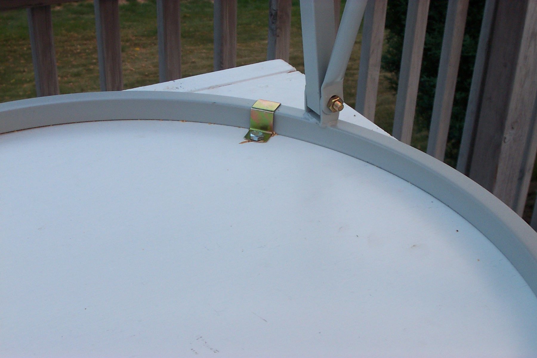

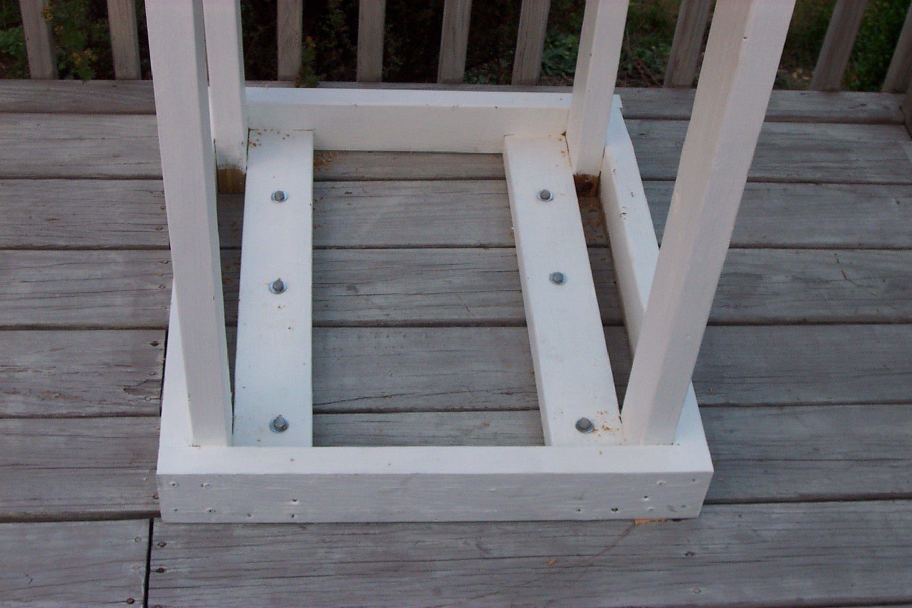

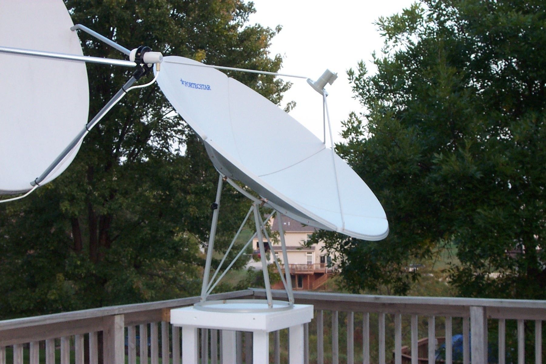

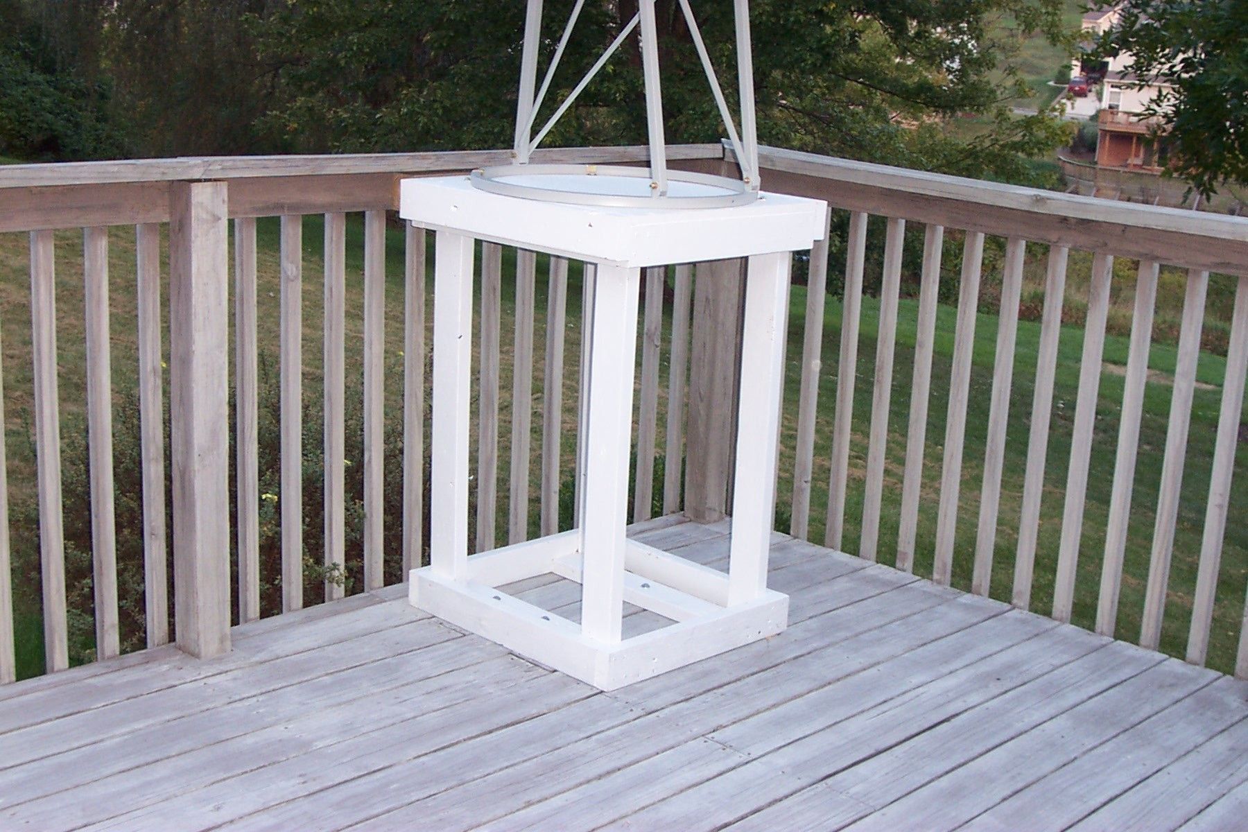

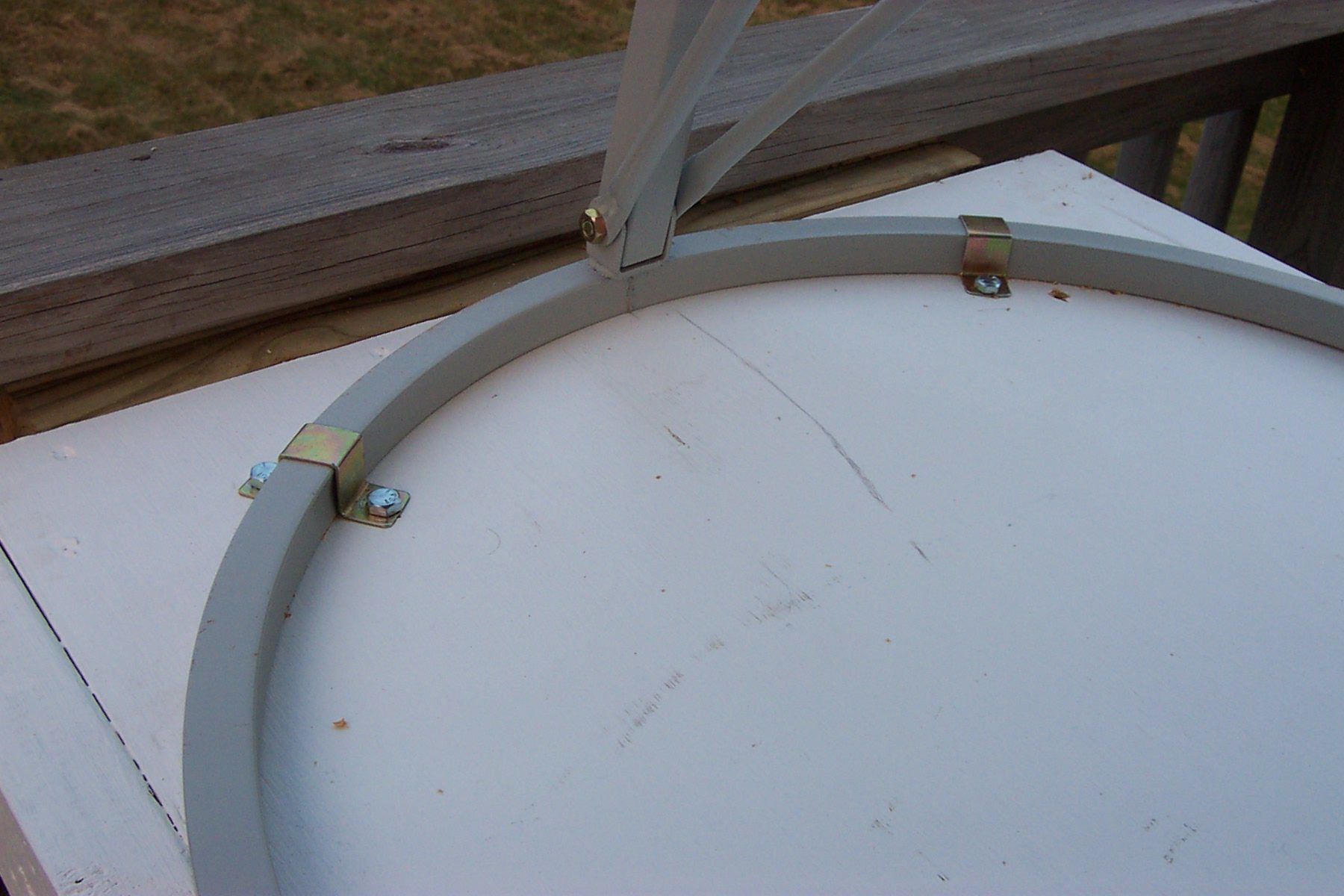

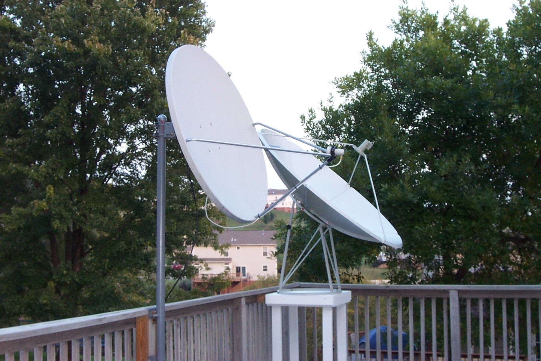

Tonight I secured the stand to the deck using lag bolts on both the bottom and back side. My wife and I then lifted the assembled dish and mount onto the stand and secured using the brackets supplied with the dish and 1.5" bolts, washers and nuts as shown in the pictures below.
The stand measures 27" X 27" and is 40" high, so that the dish overlooks the top of the house without having any LOS problems.
I also like how easy it is now to get under the dish to make adjustments and it saves a lot of room on the deck which my wife likes.

I was going to say maybe throw a bag of sand on there as weight but the way you have it bolted down I dont think its gonna move :)
looks well done . im going to make up a metal stand for mine similar to the stand the dish rests on.the round ring but the bottom is going to be larger but square .the top of the stand will be round to match the bottom ring. i was thinking of trying to make a pole mount
similar to what sodem sells. or get my son make it up at work at the foundary where he works as a welder making stuff up.
The stands looks really good. You have good handyman skills. I would add one diagonal brace between two legs of the stand to give it more regidity and prevent torsion.

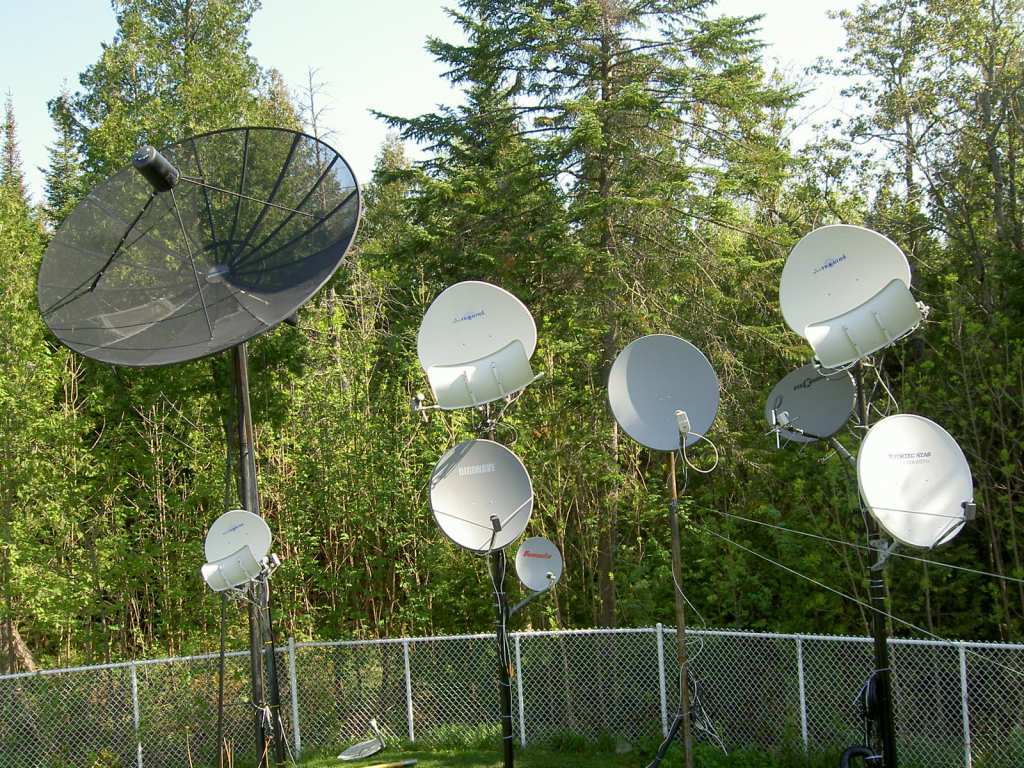

I made sure my stand was perfectly level on all sides before securing the dish onto it. I am sure a telephone pole would work if level. In fact, I found a picture yesterday of a man who has all his dishes fastened to telephone poles. I will attach this picture later today when I am at work.
Dave
Those are poles, but not telephone poles - at least not the wooden ones that we have around there. The ones we have around here are a good 1.5 feet in diameter at the base.
I was just trying to show that wood could be used as an alternative. I even seen pictures of dishes just propted up next to a wall using no mount or pole.

This support is short and made from pressure treated lumber affixed in both vertical and horizontal positions. I think some diagonal braces would help ensure very little movement in this short stand.
Phone poles are tall and heavy and frequently move with wind (not a LOT of movement, but they do move). The wood in a phone pole is not pressure treated (at least not like 2x4 lumber - you can tell as it splits easily), and it's vertical, which gives little resistance to wind sway. An old phone pole with 3-4 cables tied high on the pole and tightly to the ground would probably make it sturdy enough to mount a dish to.
