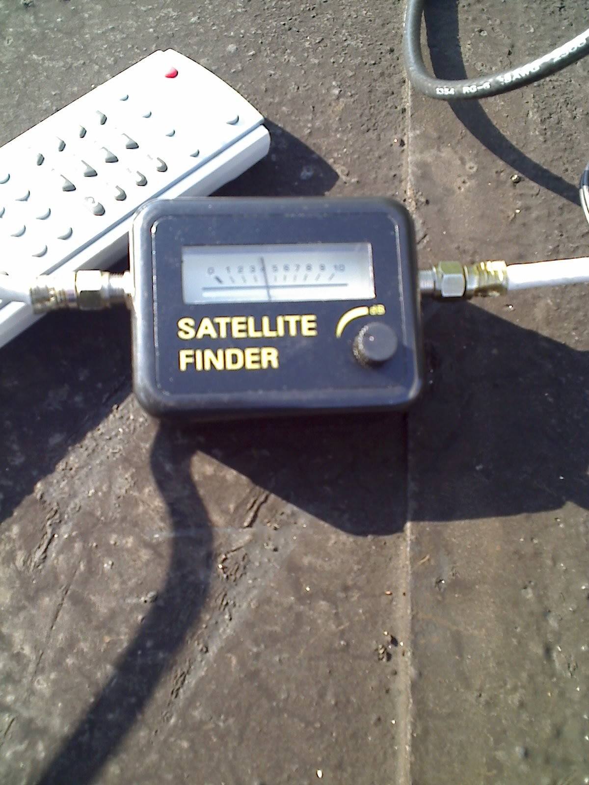

Another question, if I leave my satfinder attached, should the receiver get quality?
Do I need to remove the satfinder to do the blind scan?

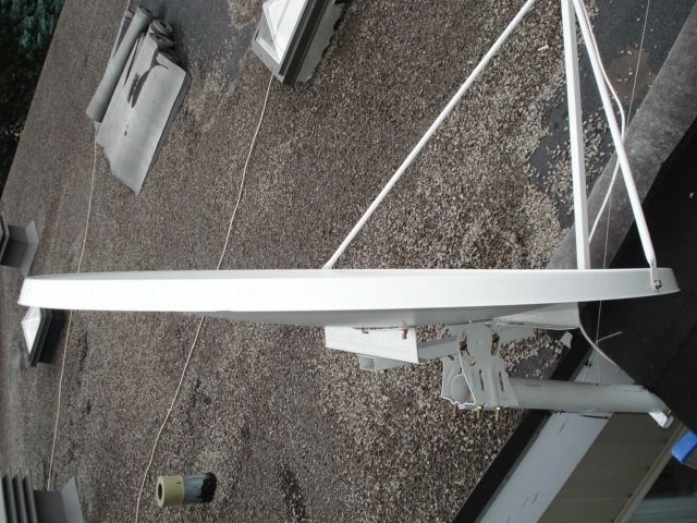

"Eyeball" your Dish, looking at the Rim, does it look warped, like a potato chip?

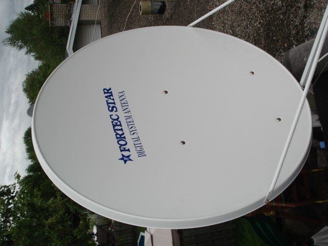

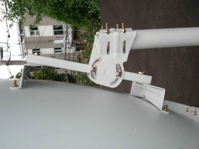

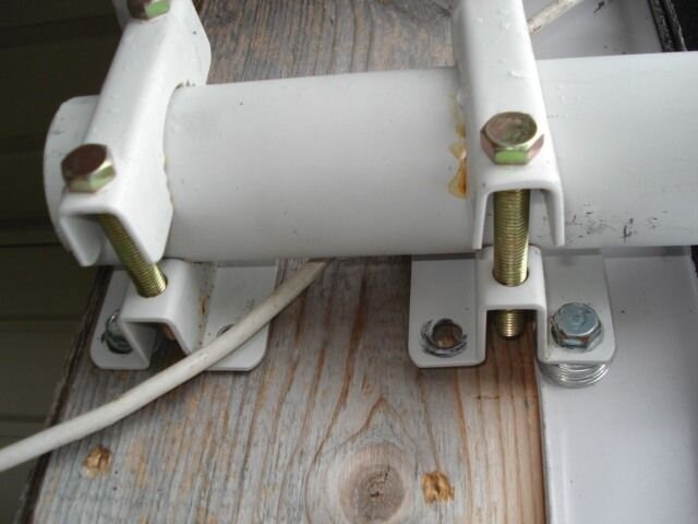

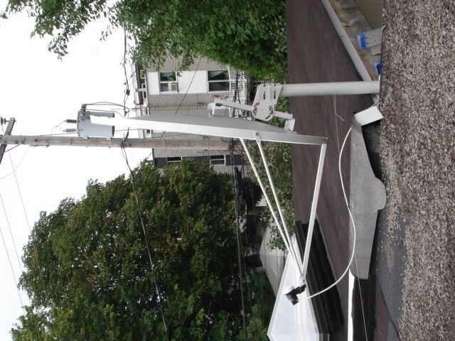

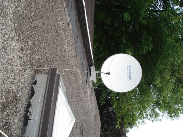

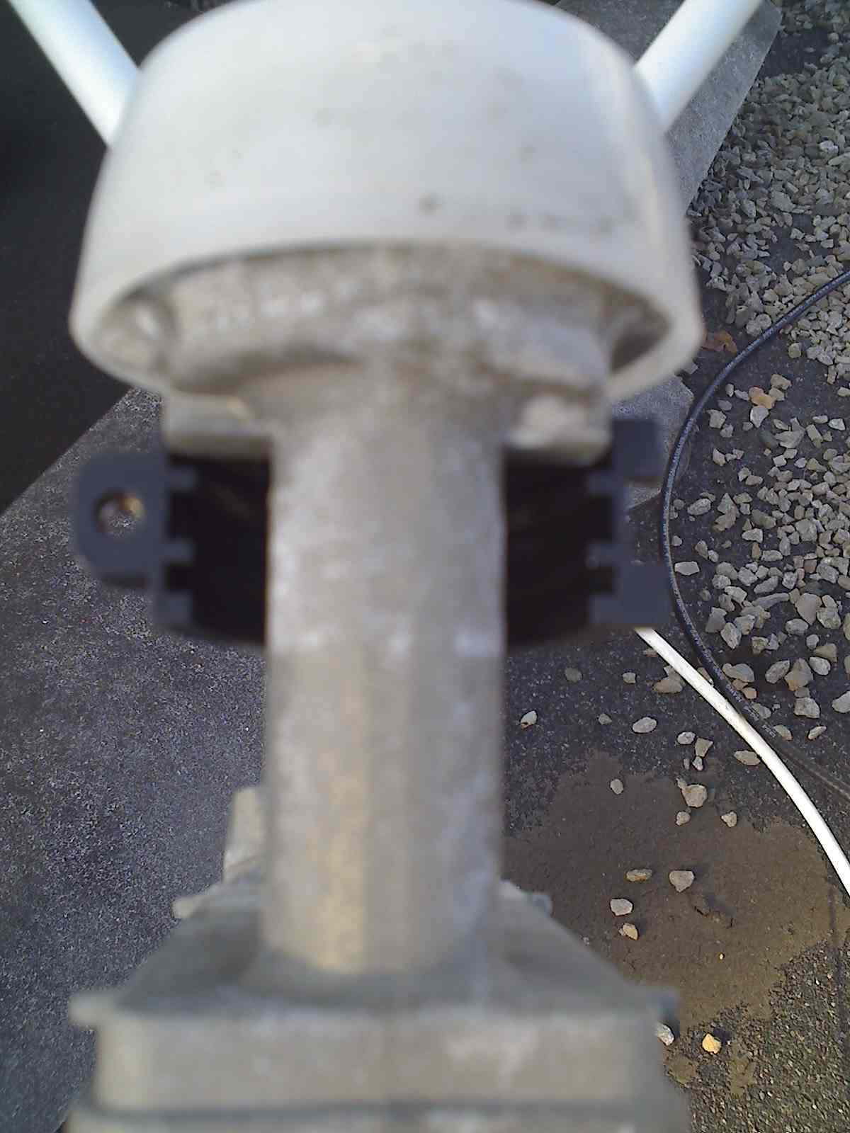

some pics of my setup
Hi Lak7, The dish is new and I find it very straight and not warped. Here are a few pictures of my setup. Also, I added a zoom of the skew I set (21 deg clockwhise when standing behind the dish).

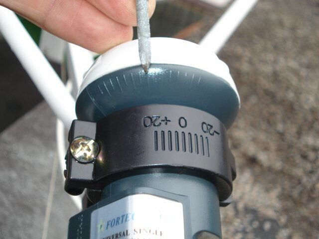

Do I need to skew a circular lnb? I thought I only need to skew a linear lnb.
You do not need to Skew a Circular LNB, sorry for the confusion. I was asking about when you swapped out the Circular of the Linear.

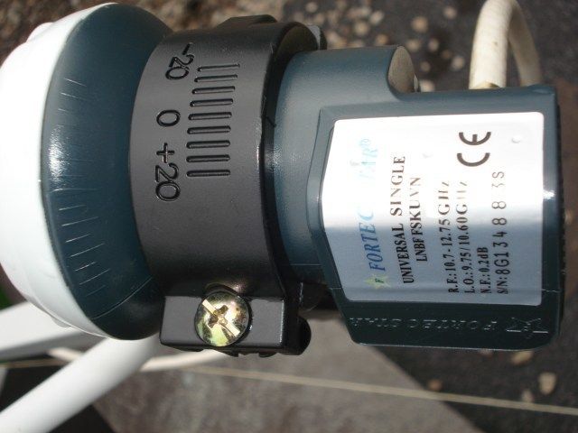

Dishpointer.com shows 91 West with a Skew of 16.3 for Montreal.
You are right. I need to set the lnb at 16.3. I did test all 360deg using my old cable and sat finder. But now I will do a blind scan at 16.3 and with my new cable.
Thanks again, your answers are really fast!

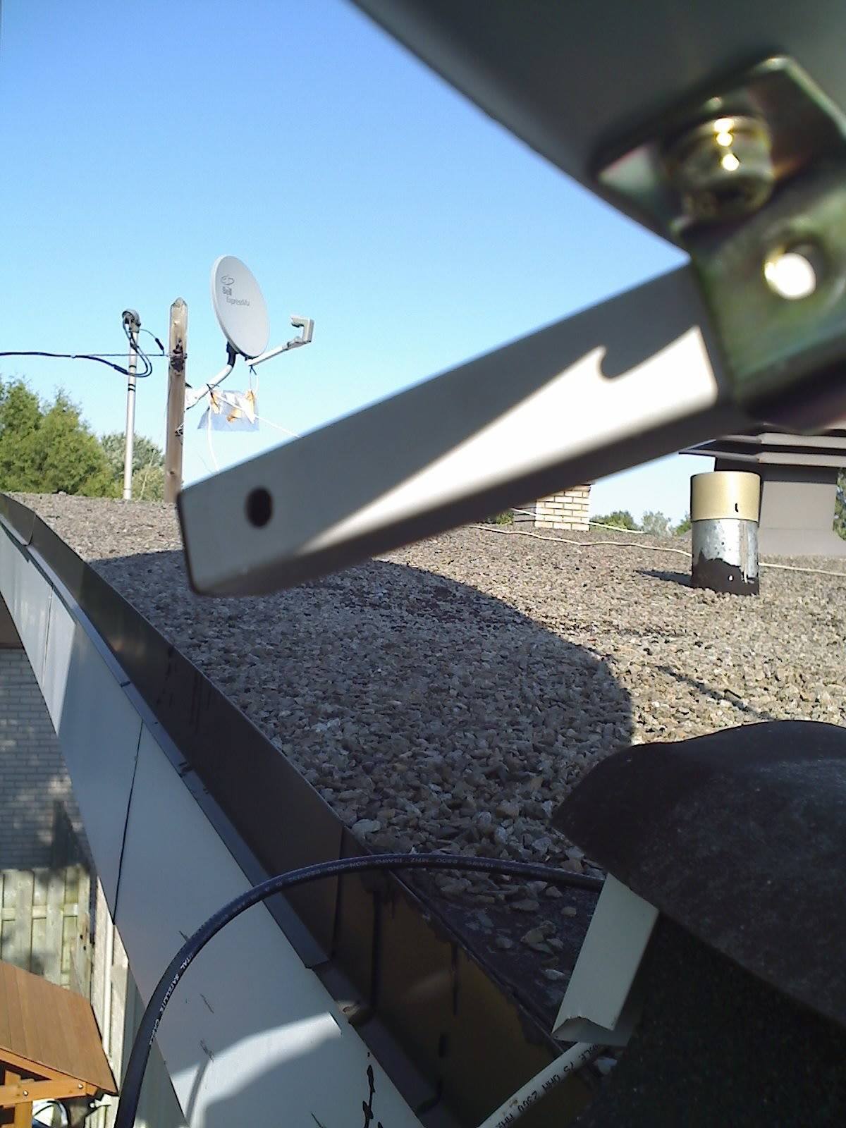

I looked at it on the roof and you are right, it is slightly curved. I dont know what to think of this yet but I will think of some tests to do (maybe try to bend it a bit). But even this I dont know if I will get much better results.

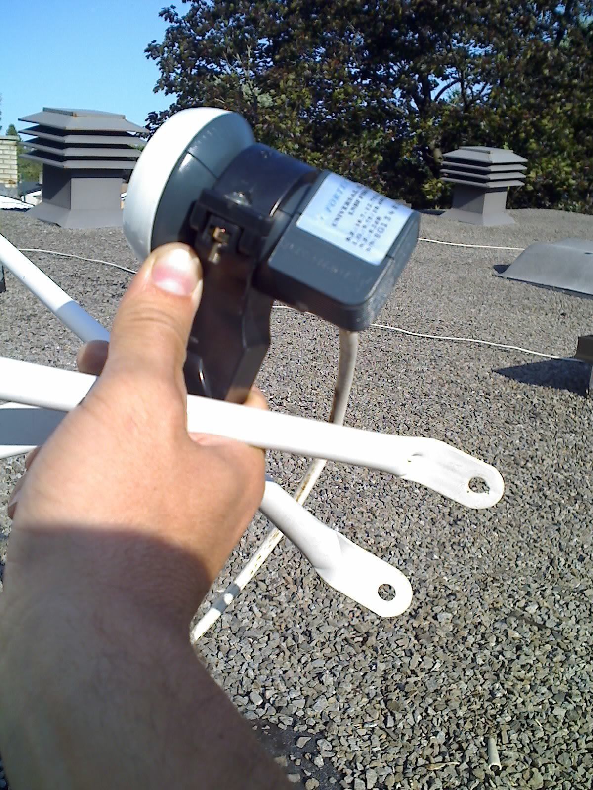

Today I tried with a second lnbf I had. I removed the plastic moldings and I inserted it in the lnb holder and put back the plastic cover and screw. See the attached pictures. I still get only 38% to 58% signal as opposed to 93% to 100% on my smaller 18inchs dish. Today I did not touch the alignement. I tested with my new cable.
Do you think that the lnb is improperly installed and this would explain the poor result?
Otherwise, this would mean my antenna is the problem?
Thanks. Hopefully I will sort this before the snow comes.

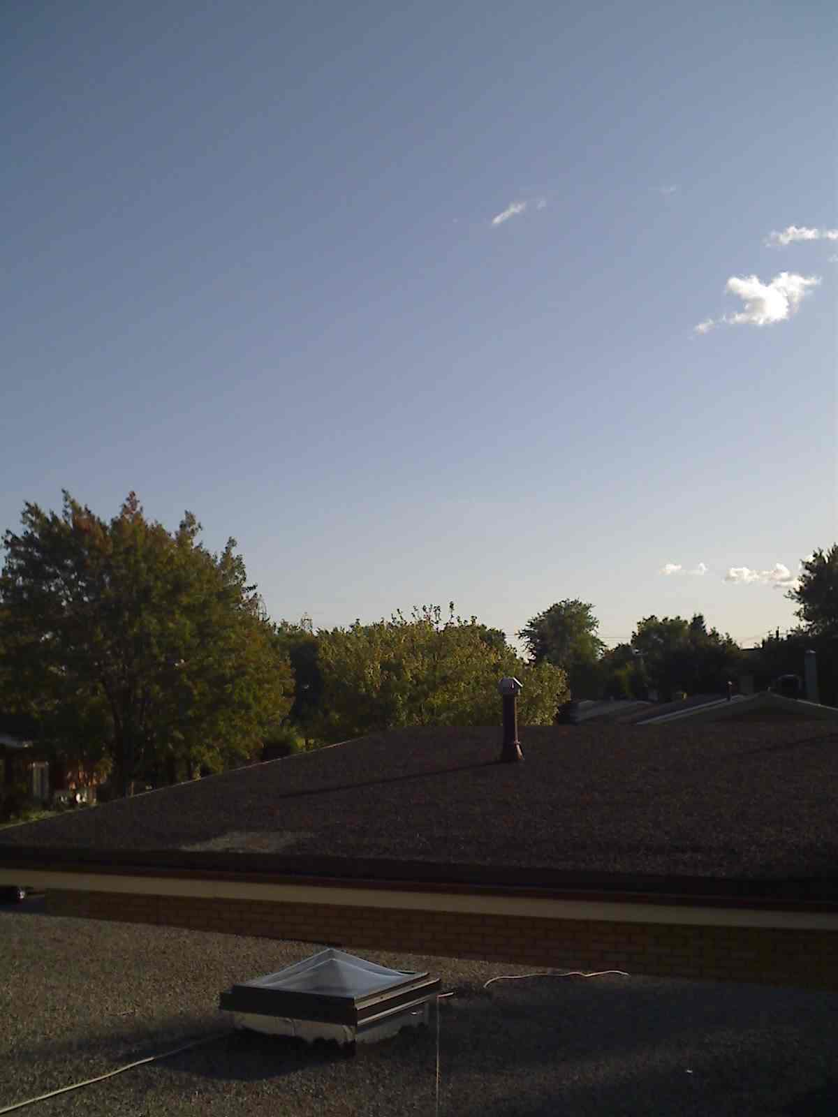

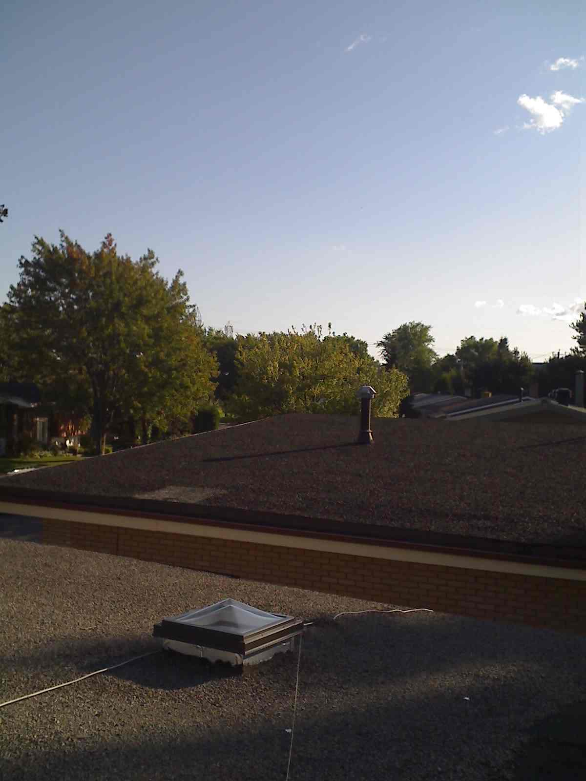

PS: the two last pictures are the line of sight of my antenna. One is taken from the mid upper part of the dish and the other one is taken in the center of the dish. The line of sight looks clear enough.

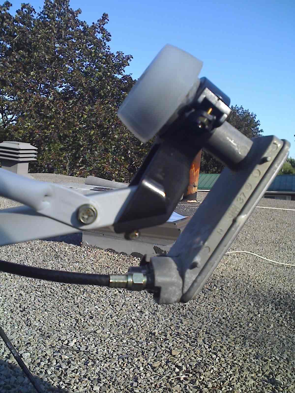

Hello again. I made progress. I finally got quality out of my linear lnb.
Finally, after so much waiting...
(with circular lnb and Nimiq91)
Here is the thing though, I started to push slightly on the corner like LaK7 recommended and I was gaining only 1-4% quality to a max of 25% around. Then I unscrewed the lnb and tryed to move it around holding it in my hand. Then I was able to get a 75% quality but around 4 inches ahead of the lnb black holder! Weird.
(with linear universal lnb and Galaxy17)
Then I changed my lnb to univ and I tryed to get something. I was able to get signal (look at the picture to see how weird location I had to hold my lnb). I got quality but it was going erratically from 0-35% up and down but it very rarely stays in place.
I did blind scans (2-3) holding it with my hand but after the entire scan, I could not feel my hand and right foot.
I tryed to get anything when I move the arm close to where it should be and I cannot get any quality at all.
What next??
Thanks.
