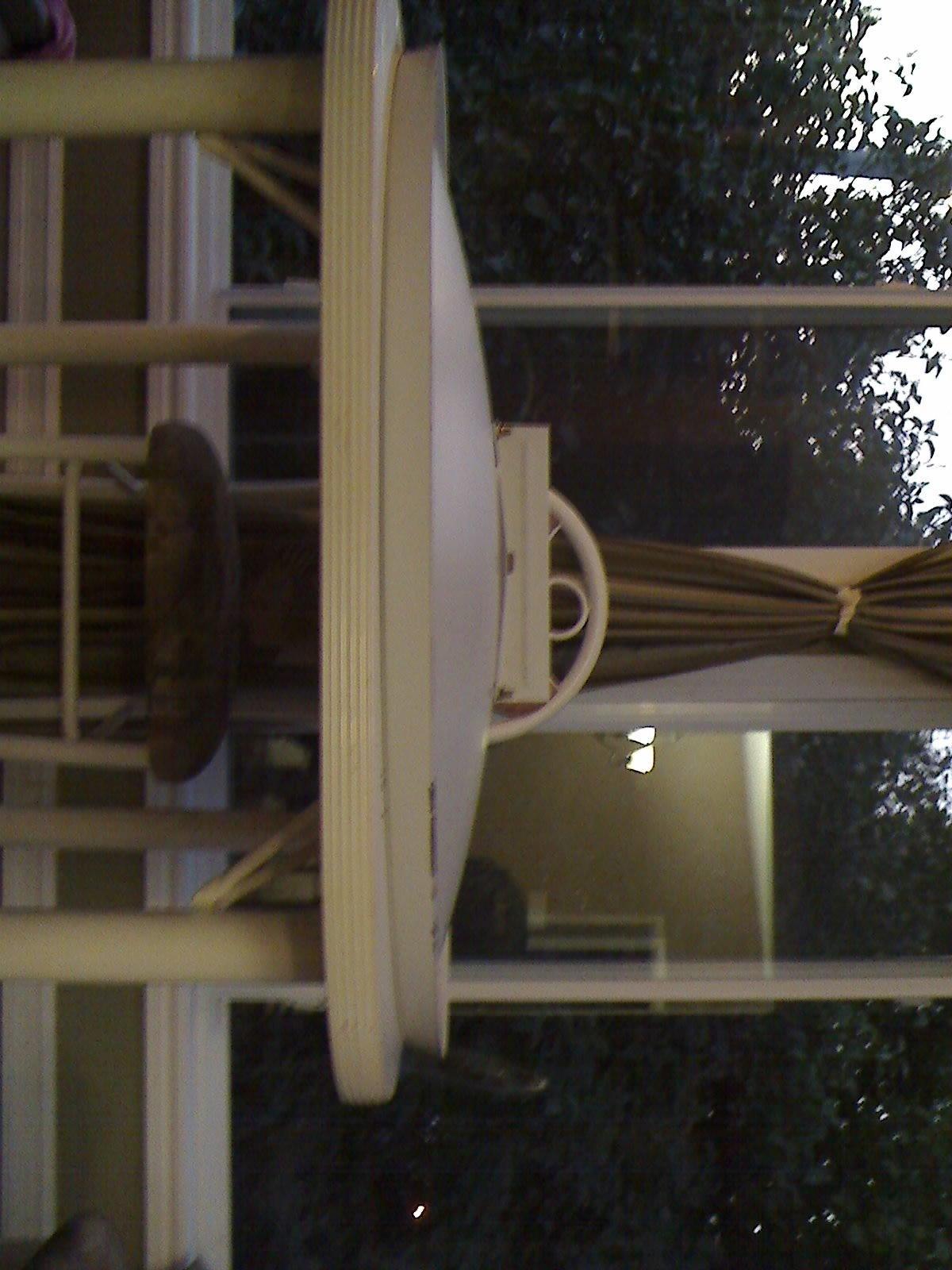

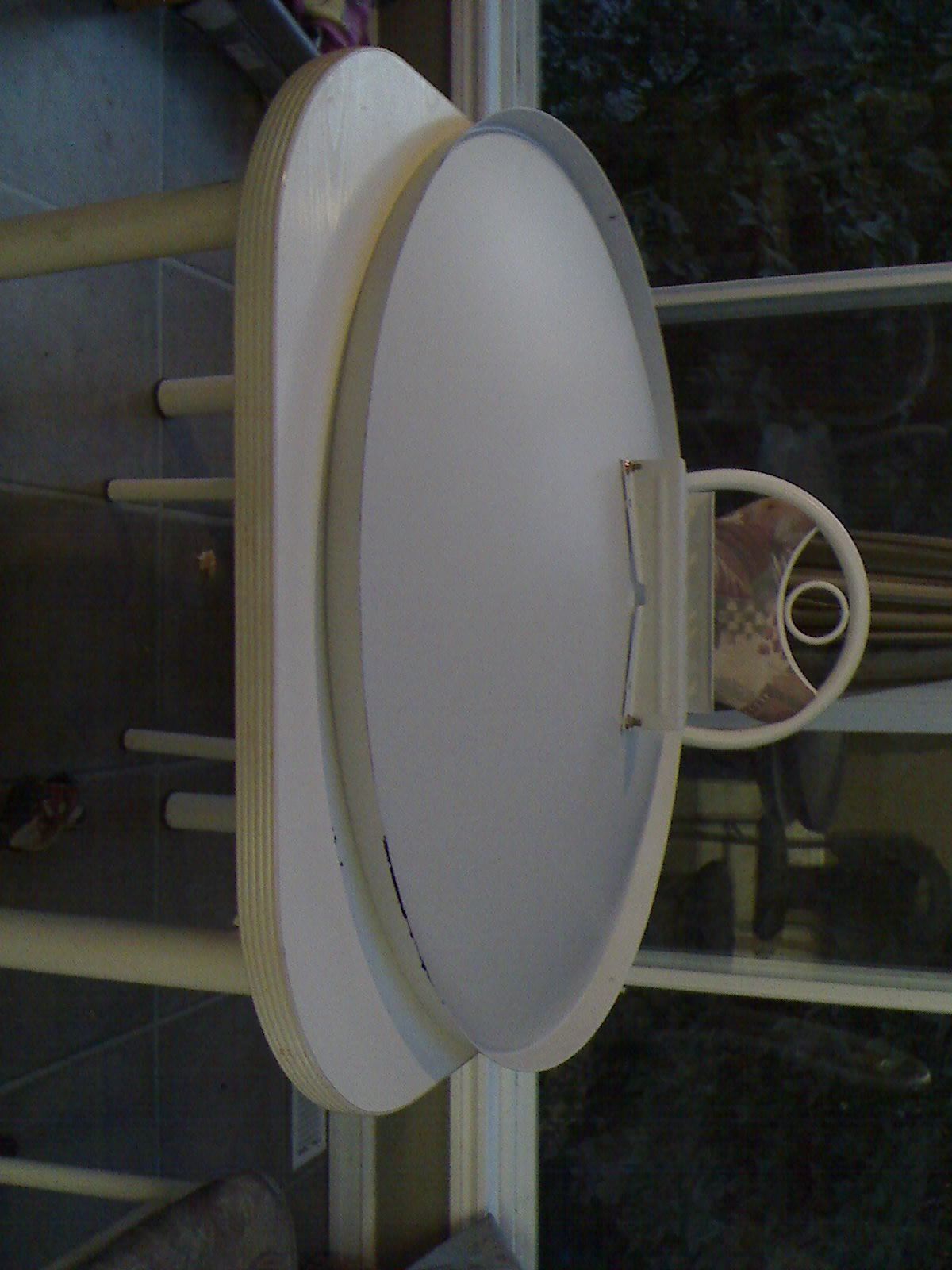

I'd take the Dish apart, lay it face down on a known flat surface - is it warped?
It is straight and new, I carried it from the store to here with care. I got snapshots for you but I could not find anything wrong with it, I even rotated it a few times to look if I could see a wave but nothing.
Now, I measured it. It is really a 100cm and looks like the picture:
Fortec Star Satellites
Thanks again hope you can think of something else.
