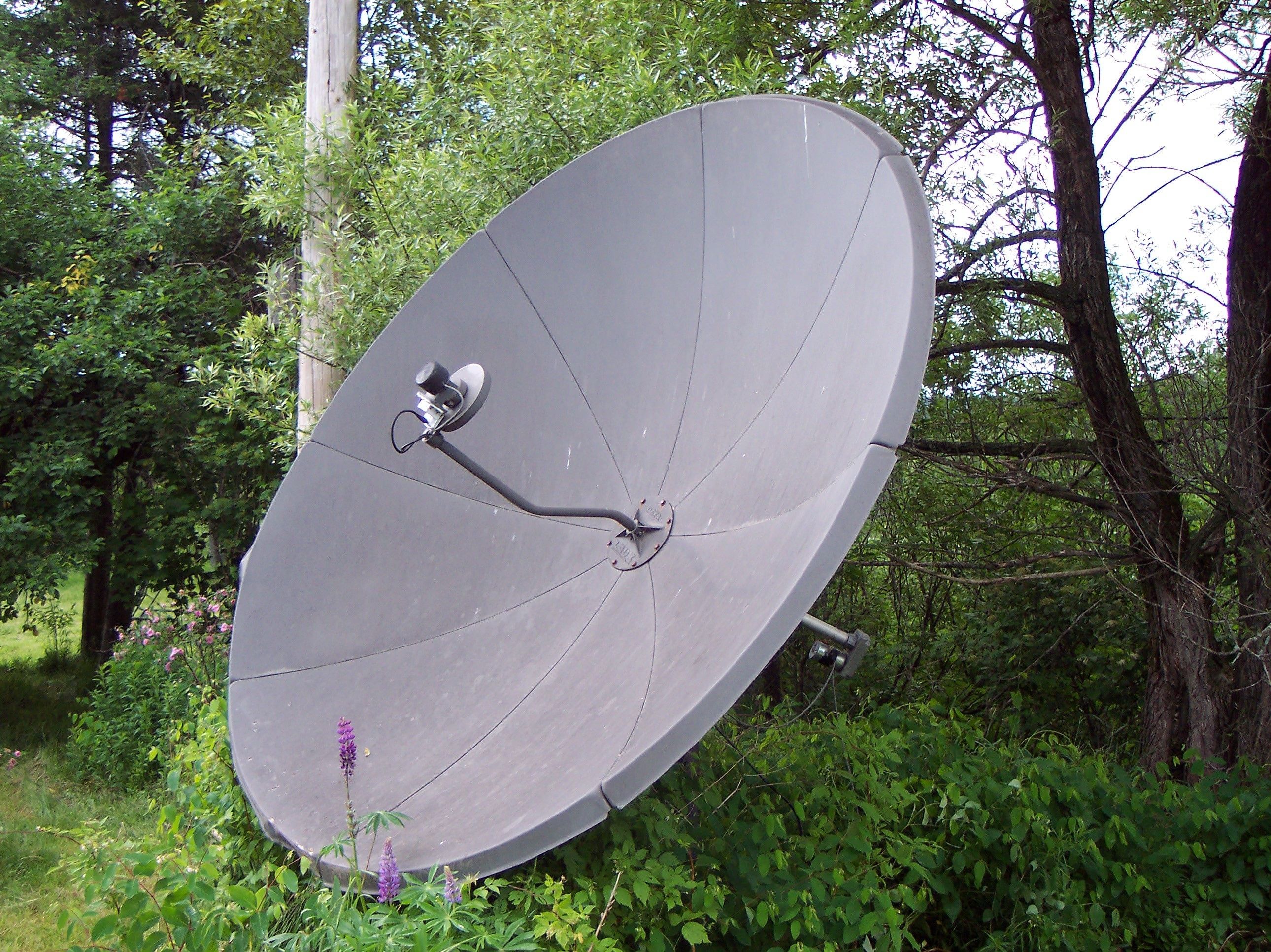

Here's some pictures of the dish. I couldn't get any of the receiver or anything. She wasn't home at the time. Let me know what you guys think. :)

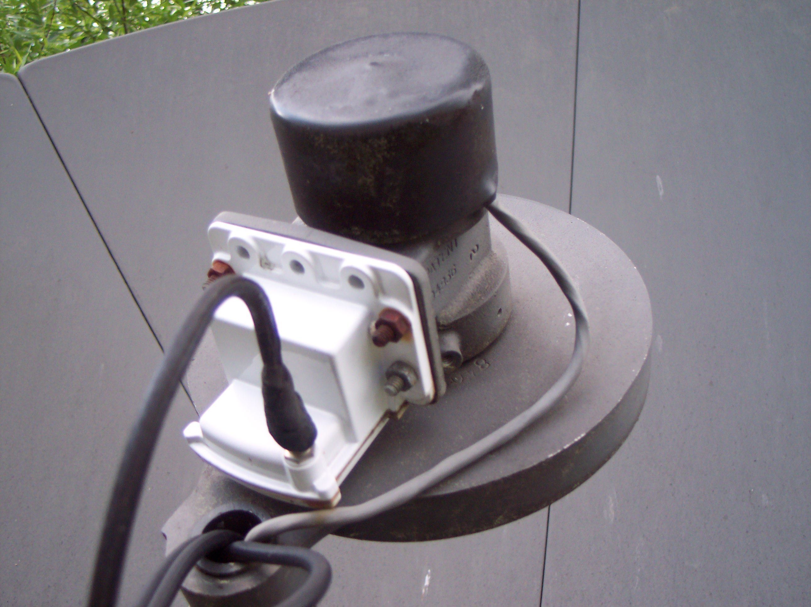

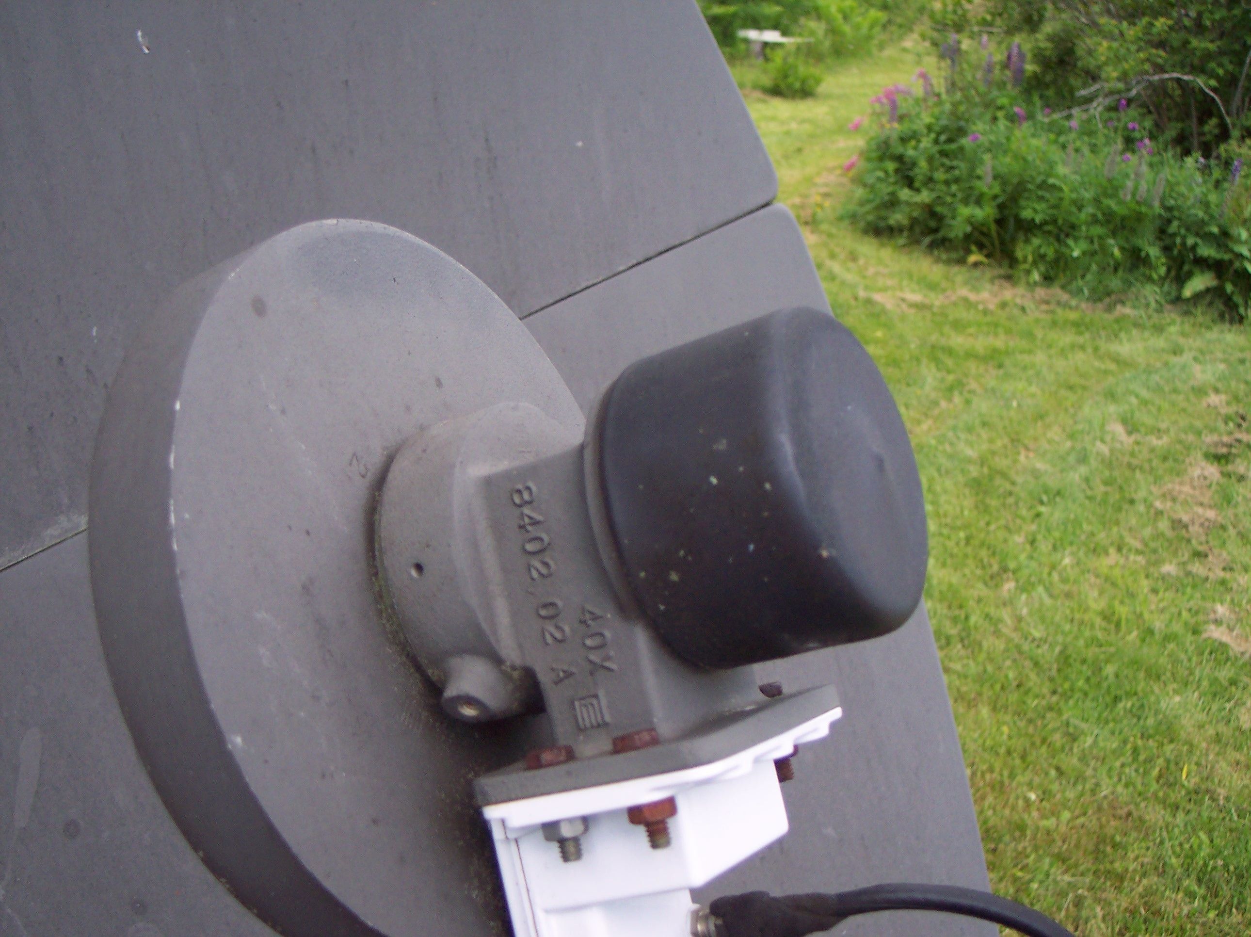

Here are some more pics. Does it look like the BSC-621 LNB will work with this dish?

have you checked the dish to ensure that its still "round"? it looks pretty bent on the one side. you'll want it near perfect for ku reception
I haven't checked yet. I was going to when I took the pictures, but I didn't feel right doing much without her there. Honestly I think the camera is exaggerating the bending. It doesn't look that bent in real life. I was thinking I might be able to pound it out with a rubber sledgehammer and a piece of wood?
I use my camera for my eyes. The camera can see better than I can, and I had a similar ding in my Birdview, but it was the other direction. Out instead of in.
The only thing that will tell you how far out is the string test. You might be able to take the ding out, but it will have to fall in place almost perfectly.
Your camera is your friend!
Otherwise, it is a pretty nice dish!!
Fred
Fred
Would that small of a bend cause that big of a problem? When I first saw the pic, it scared me, you're not helping. :p How much of a bend can be in the dish and it will still function correctly? It seems to be just that one area that is a little out of whack. Do you think it's still worth the $50? I'm gonna go back tomorrow and do the string test. Basically you put one string across the dish and one going down, and see how far apart they are from each other in the middle?
That is correct. I would put one string on top of the dent, and the other at 90 degrees from that. That will tell you how bad the warp is. Then I would try the strings at another point that doesn't involve the dented part. That will tell you if it is an isolated warp or not.
Myself, I wouldn't pay $50.00 for it, but that is just my opinion. Others might have a different idea. Dishes might not be as plentiful as they are in my neck of the woods.
If you can get it free, and can take out the warped section, or beat it into place, then it might be worth the trouble.
Again, it's just my opinion! Take it for what it is worth.
Fred

How much do you think that bent section will affect the signal? I think I might be able to pound it back into a mostly normal shape. I do believe that it was in use after the dent was put there. Her husband used the dish up until his death, and he also put the dent in there, so I assume the dent was there when it was still in use. This is the first and only solid dish I've found in this area. $50 isn't much, I guess I can take the risk. I'm always on the lookout for dishes now, so maybe I'll come across another one. Hell, I'll just collect them and keep them in the garage, or put them in an array, each pointed at different satellites, boy my neighbors would just love that. :D
Fred

The skirt around the dish is messed up in two places, but I can't see any actual trouble with the reflector surface.
You are there, so your opinion is better.
Looks mostly cosmetic, to me.
If you should decide to replace some of the rusting bolts, just remove every other one, clean, prime, and paint , then put in new hardware.
For a second pass, do the same to the remaining parts.

That's a nice looking dish. I notice a couple of things I'd look out for.

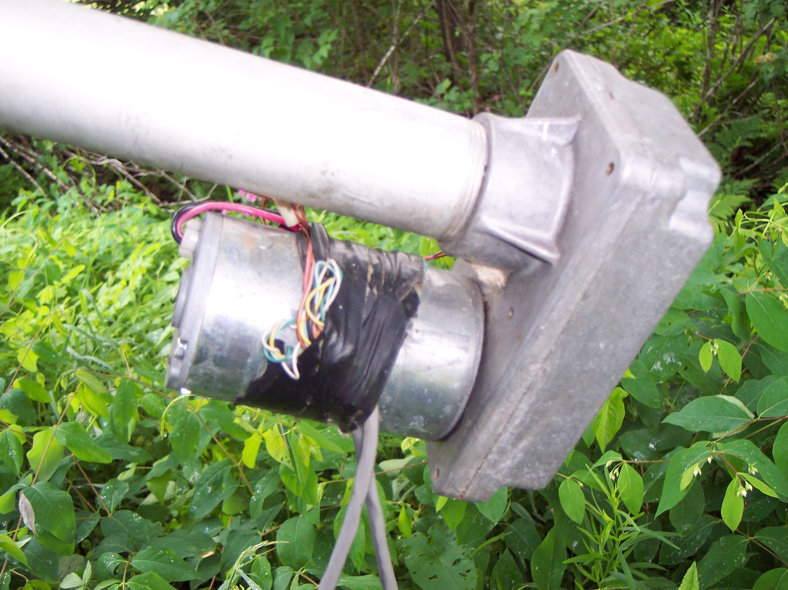

(1). That damaged petal in photo #2 appears to be the result of an actuator failure that caused the dish to fall into the post. Not sure if you can repair it but it shouldn't affect the overall performance very much. May make the focal point odd shaped and off center.
(2) The materials of construction may be so that it is not efficient for Ku reception. Some early dishes were for C band because Ku was eight or so years away. If it's constructed from carbon impregnated roving or cloth, there may not have been the effort to make sure that gaps were kept to a minimum. Any gaps of voids in the carbon will reduce the dish's ability to reflect the Ku microwaves.
Neither of my concerns could be answered until the dish is optimized, so I'd install it and see what happens. You can't really tell until you give it a try.

i thought it was a good looking dish needing some attention...

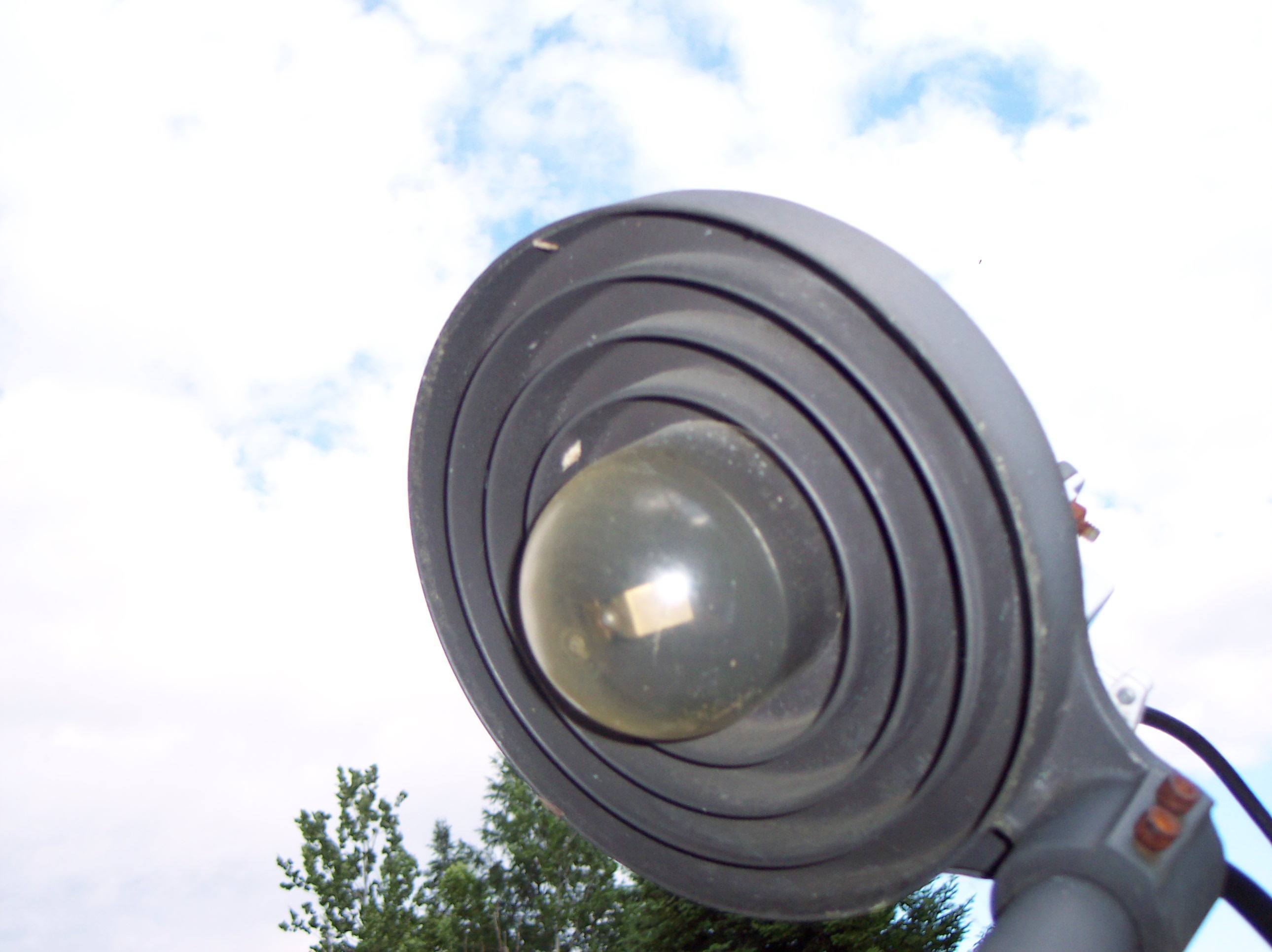

but you notice the feedhorn , the way its up there you would have to adapt anything you change it to. most likely you could just remove the center and slide a newer one in. you might even have to remove the scaler and have it machined so a need feedhorn will fit it. that shouldn't be a problem. I just couldn't tell if the old one would remove. i did like the bubble dome on the bottom side lol makes it look like a light.
like mentioned above you would have to "optimize" and it looks like it was setup for c-band only . You might have to tune (push / pull each section untill you have the best shape for ku since it has a lot of sections to adjust. probably have to string every section.
this is a big dish and might take a bit of time. it will probably be worth the effort . but also don't be scared to examine a few mesh dishes , they have very good reception. i know some of us like the solids (I have two mesh dishes a 7 1/2 fter & 10 fter) both have good reception. plus the advantage of a mesh is they are light.
around here most mesh dishes are being let go for free. another thing to consider, i'ld say most of the 4dtv equipment was on a mesh dishes , so you might find one of those when looking for a mesh dish , i know i found two (of the 4dtv receivers) when i got my 7 1/2 ft dish.
don't feel like 350 ft run of coax is going to be impossible but you also got to realize the longer the run the more signal loss you have . if the run is going to be long another type of coax might be needed. it would be best if you can keep your runs as short as possible. i have runs of 100 & 150 and my next project is about 200 but i would have to test anything longer for good reliable reception. i perfer to keep it in the 100 ft range.

I took the strings and did a string test. From what I can tell, the dish seems to be off about an inch. Would that make much of a difference? I'm not sure if I did it right, but that's what I came up with when measuring where the bends in the skirt were. Seems to be ok in other places around the dish.
The bolts actually aren't too rusted at all, so that'll be fairly low on my priority list. I just want to get the thing working first. What type of paint should I look for for this dish anyway? Thanks for the reply, I appreciate it. :)
So the BSC-621 won't just slide in there? I was hoping that'd be the case. :( yeah I thought the bubble looked different.
I was wondering if it could be removed also. There's gotta be a way to remove it, it'd be completely idiotic if it wasn't replaceable. Hopefully it won't be too bad to replace it.
Do you think the panels will bend easily enough to get it perfectly aligned? I did the string test where the panels were bent and one one that wasn't and it seemed to be only 1 inch or so off. Will that make that big of a difference with the KU-Band reception?
Hmm, interesting. So that's what happens when an actuator fails. That's gotta be one of those "oh sh*t" moments. I think it may be able to be hammered out. I'm wondering if the actuator that is on there is the one that failed. :(

How the heck can I tell what type of material it's made out of? It seems like solid steel to me.

So the BSC-621 won't just slide in there? I was hoping that'd be the case. yeah I thought the bubble looked different.
i suspect it will just slide in, but thats just it. until you try we can only guess. i agree it would be idiotic but take a look at that scaler its bolted onto the buttonhook arm. to replace the scaler you would have to weld or adapt another to it. most dishers are easier than this and just bolt on at the scaler.
I think you will get it to work. with a bent or damaged dish you will only know when you get it home. string each petal and see how the shape is. from what i've seen its not to bad. mine looks like the surface of the moon with all the hail dings i have in it lol.... but if you don't get it to get the ku reception you would like it would still make one heck of a c band only dish. still lots of stuff up there to point a stationary (or motorized) dish at :)
