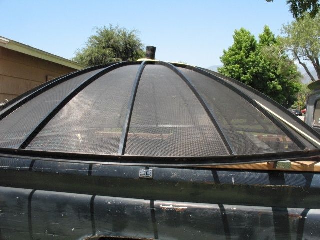

Picked up the dish

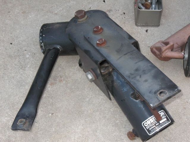

I picked up the free dish today in Long Beach. What a job, my back and shoulders hurt tonight. the dish was easy enough to get to with a small step ladder, but being so close to the beach everything was rusted. Had to break each bolt holding the dish to the positioner and the positioner to the pole. It took about an hour just to get everything loose then had to wiggle the dish itself around for about 20 minutes just to get it off. We cut the cable and used it to lower it off the balcony onto my truck below. I left it in one piece as I figured I'd have to go through the same thing to take it apart. I'll post some pictures after I download them off my phone. So there was a GI Videocipher 2 2650 receiver, remote and the positioner control unit.
We cut the pole off at the bottom, 4", 1/4" thick steel, took 20 minutes with a sawzall. then had to unbolt it from the supports on the side of the house, that was heavier than the dish and I had to leave it there until next weekend and cut it in half as I only need half the length, but I'll keep both pieces, may come in handy and I can always weld it back together with a inner sleeve.
I need to take almost everything apart and remove the rust and either replace some parts or prime and repaint all the steel pieces. The positioner motor arm looks like it shoud be replace even though it still works. Leaking oil out of the gear case and rusted everywhere. Also need a feedhorn cover, I really don't want to leave it exposed. Has C/KU both. That's about all I can think of for now, but the project has just begun.:cool:

Thanks 172, I got the bottom support off the dish today, only 2 bolts stayed intact due to the rust. Took the buttonhook off and found the intermediate plate was complete rusted away, just pieces there that fell apart when i took it off. Some of the aluminum ribs are rotted where they were in contact with the steel, damn, just like a boat in the ocean. Galvanic reaction can be terrible when you're close to the beach. Looks like I'll have to replace the intermediate plate for sure and maybe a few of the ribs. Depends on how much of it has rotted away. The top and bottom plates are possibly still good enough to use, I'll be able to tell more after I get the rust and paint off them tomorrow. Too dark to work any more tonight. I'll try to hook up with you tomorrow afternoon for the covers anway and maybe get the pole from you. Thanks for your help.
