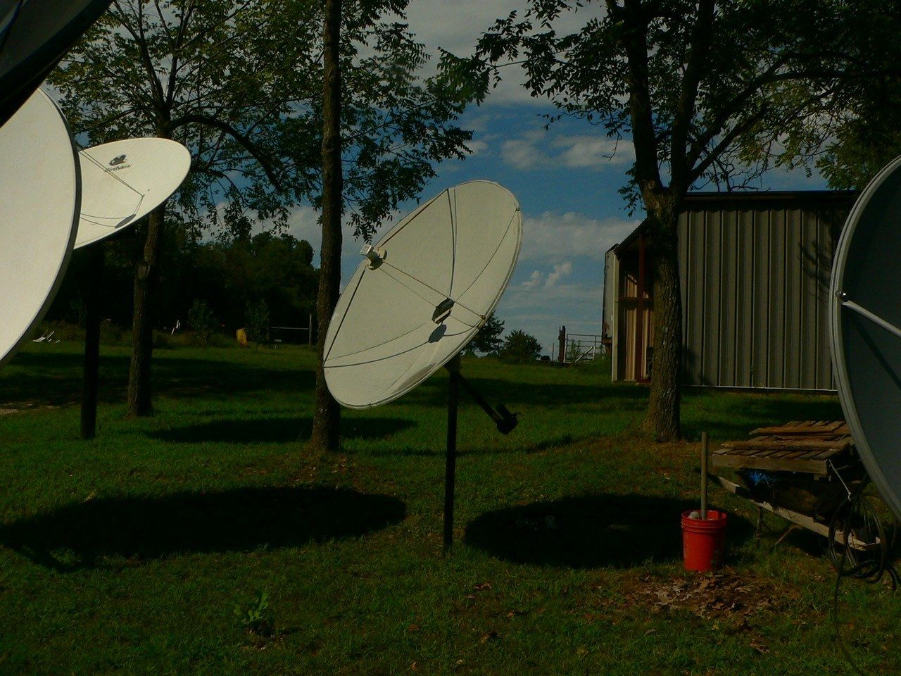

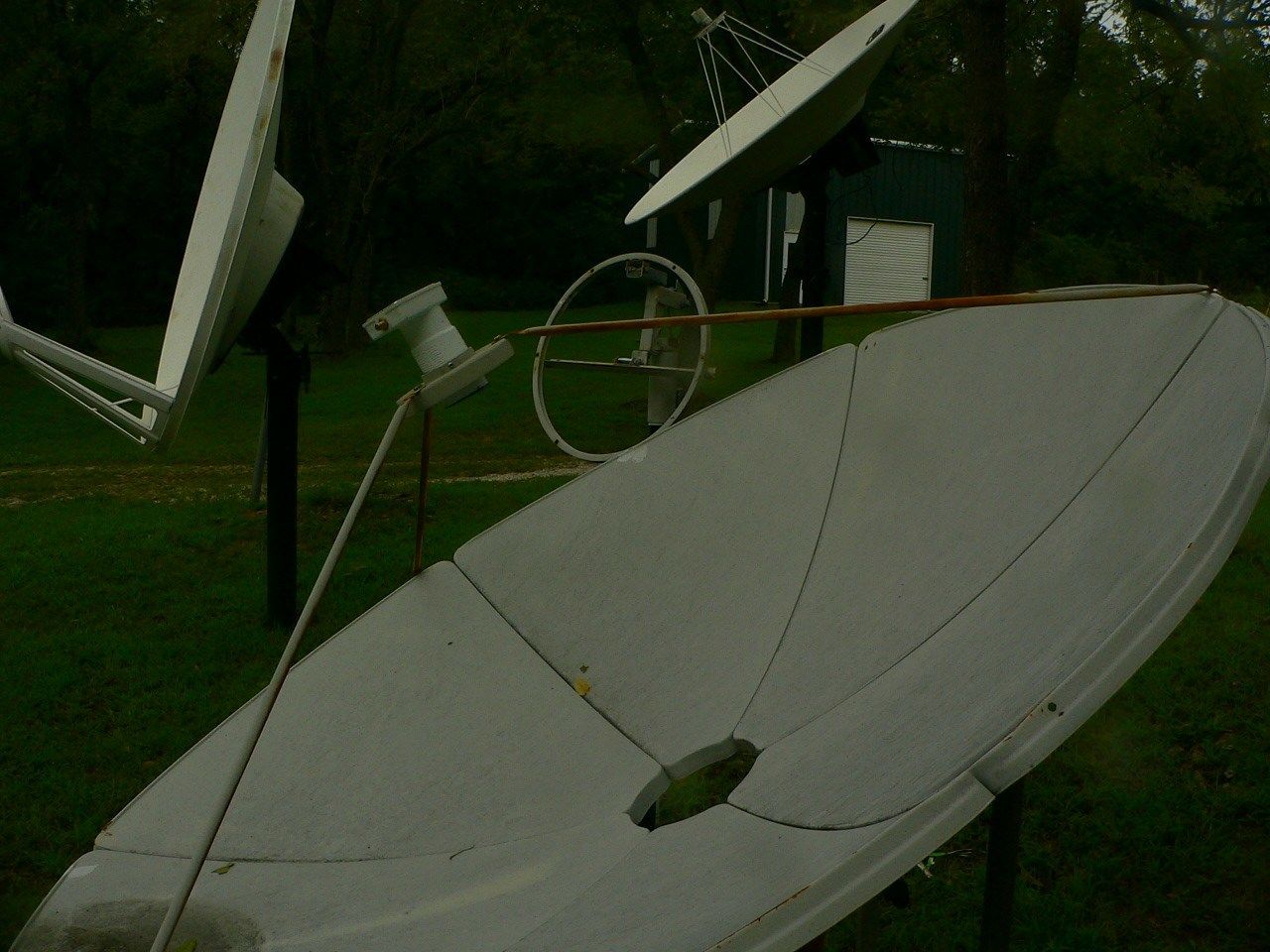

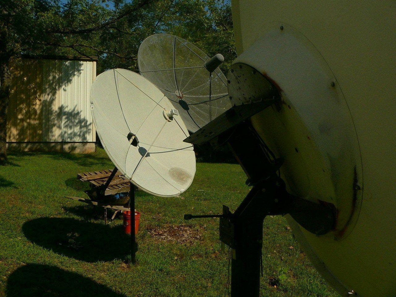

In the sat pile was most of the parts required to construct 2 of the 180 cm 6-petal stamped steel dishes, one on a fixed base, and a pile of pieces that at one time I was reasonably certain had been a polar mount.
So last winter I assembled one of the dishes, attached it to the fixed stand and used that setup to discover that a box of used 9 C-band LNBs I bought at a garage sale, were all bad.

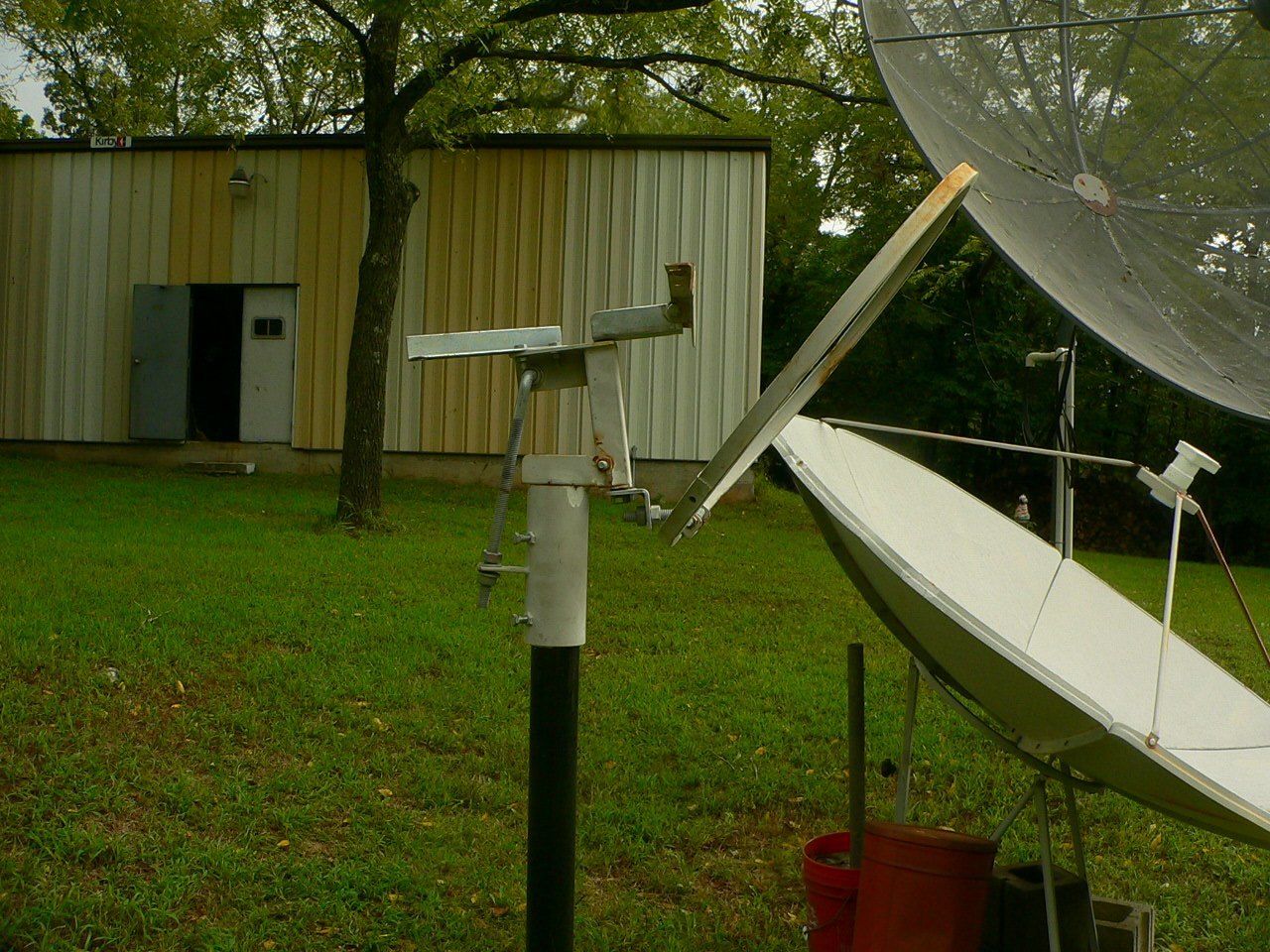

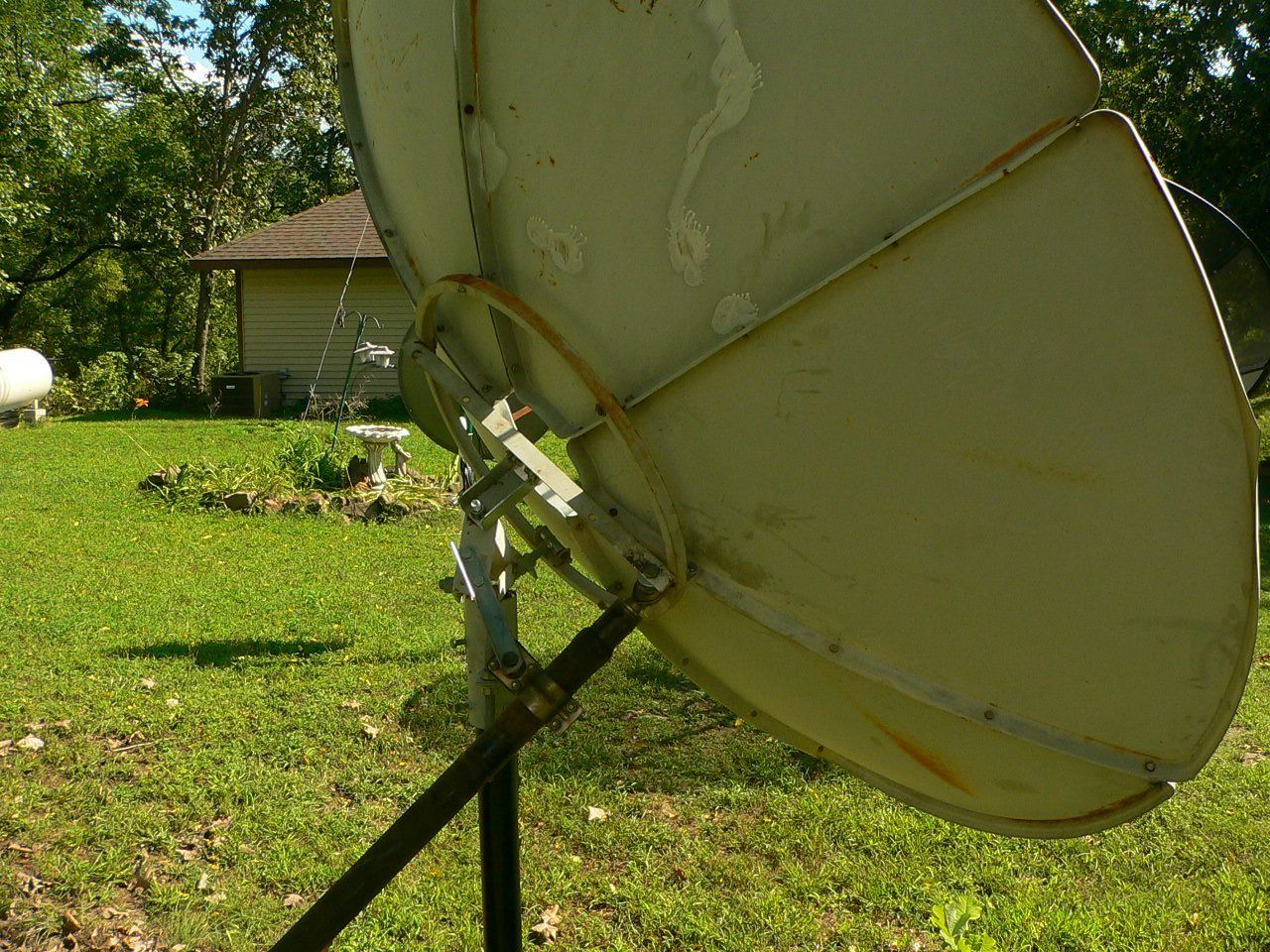

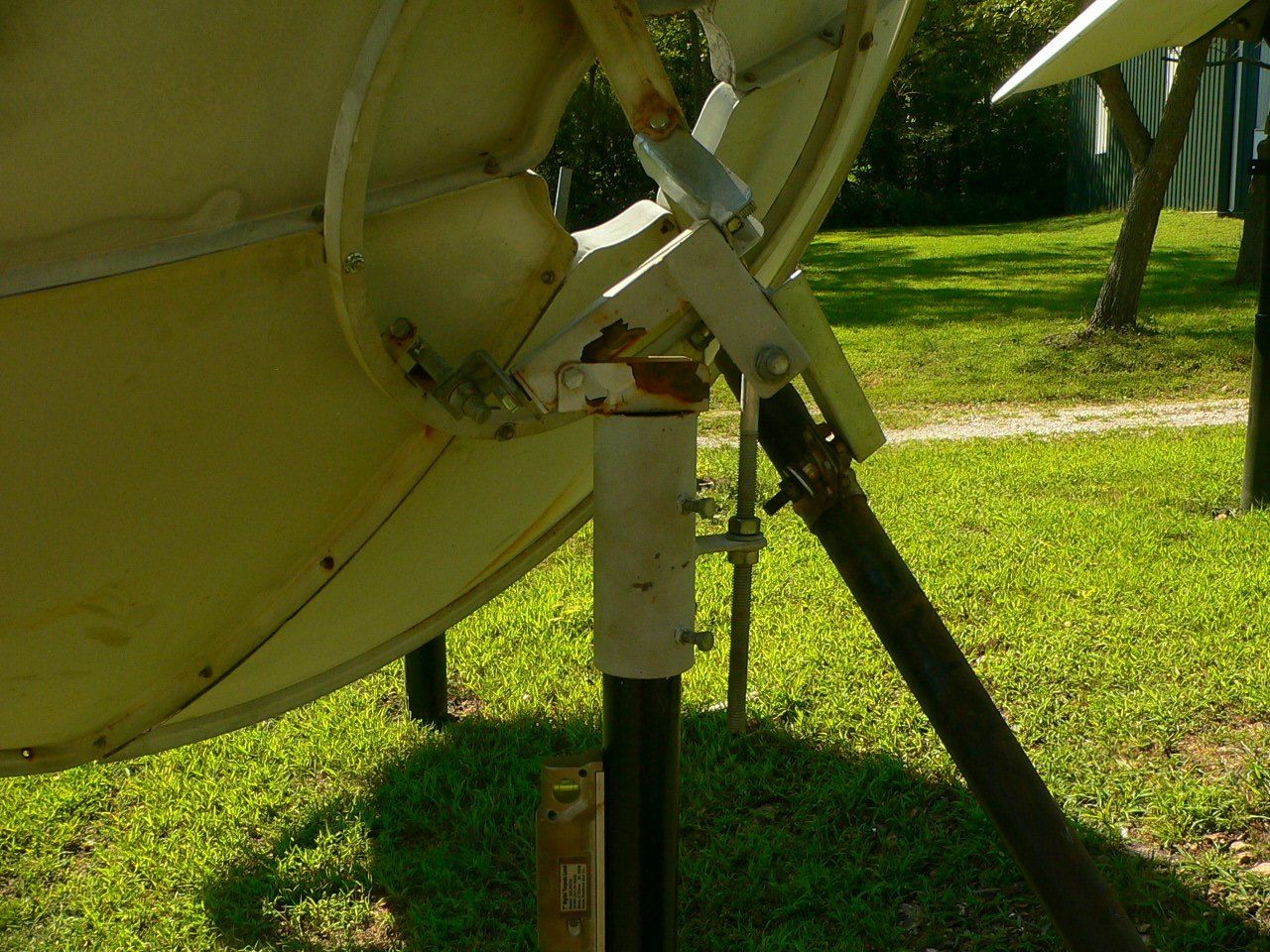

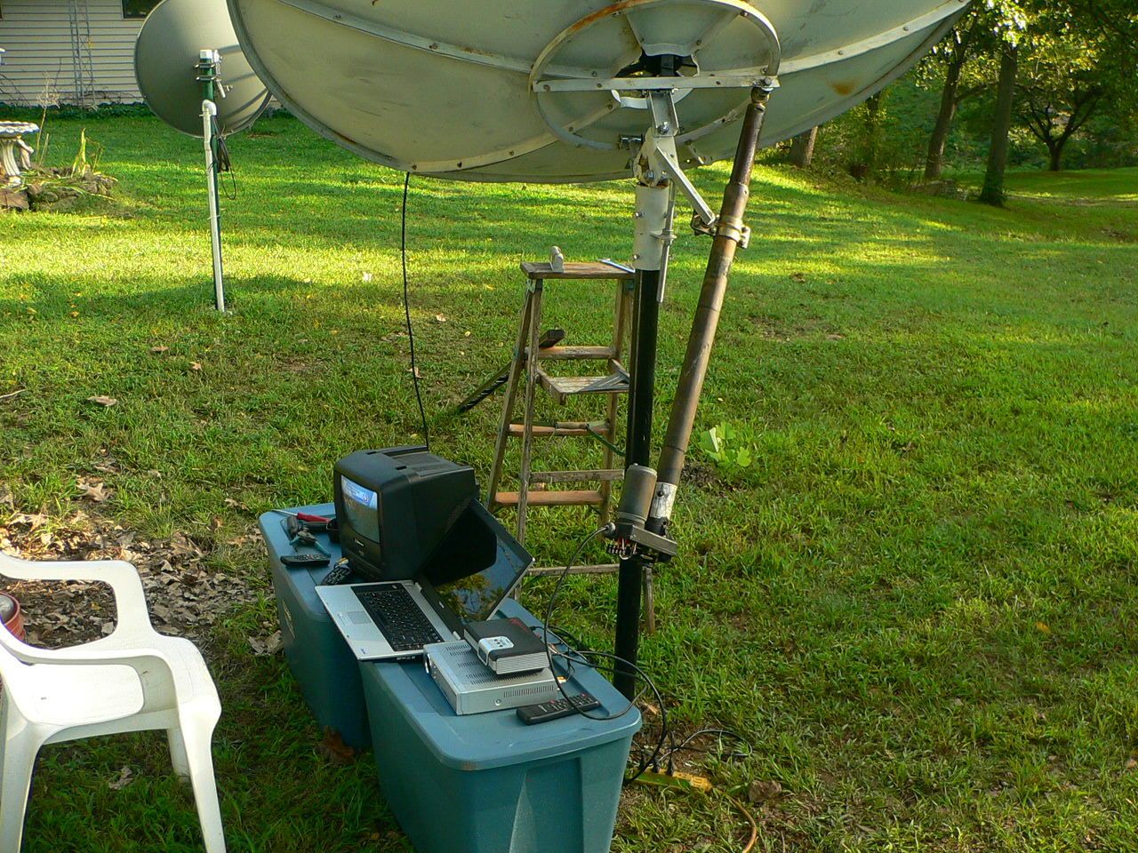

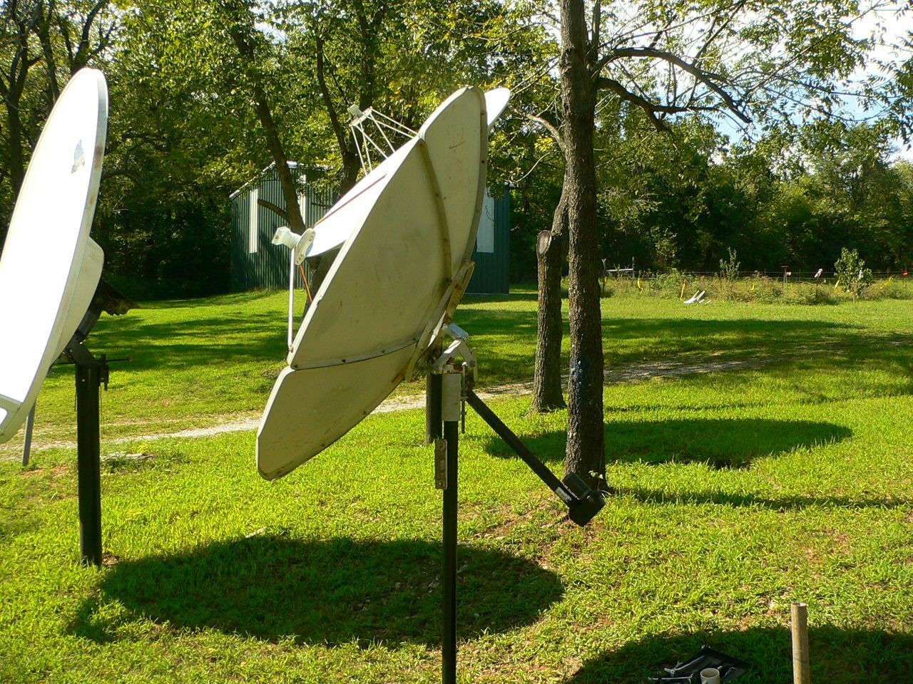

After looking at the pics Robby posted in his great "$69.99" thread that gave me the motivation to assemble my polar parts pile into a mount.

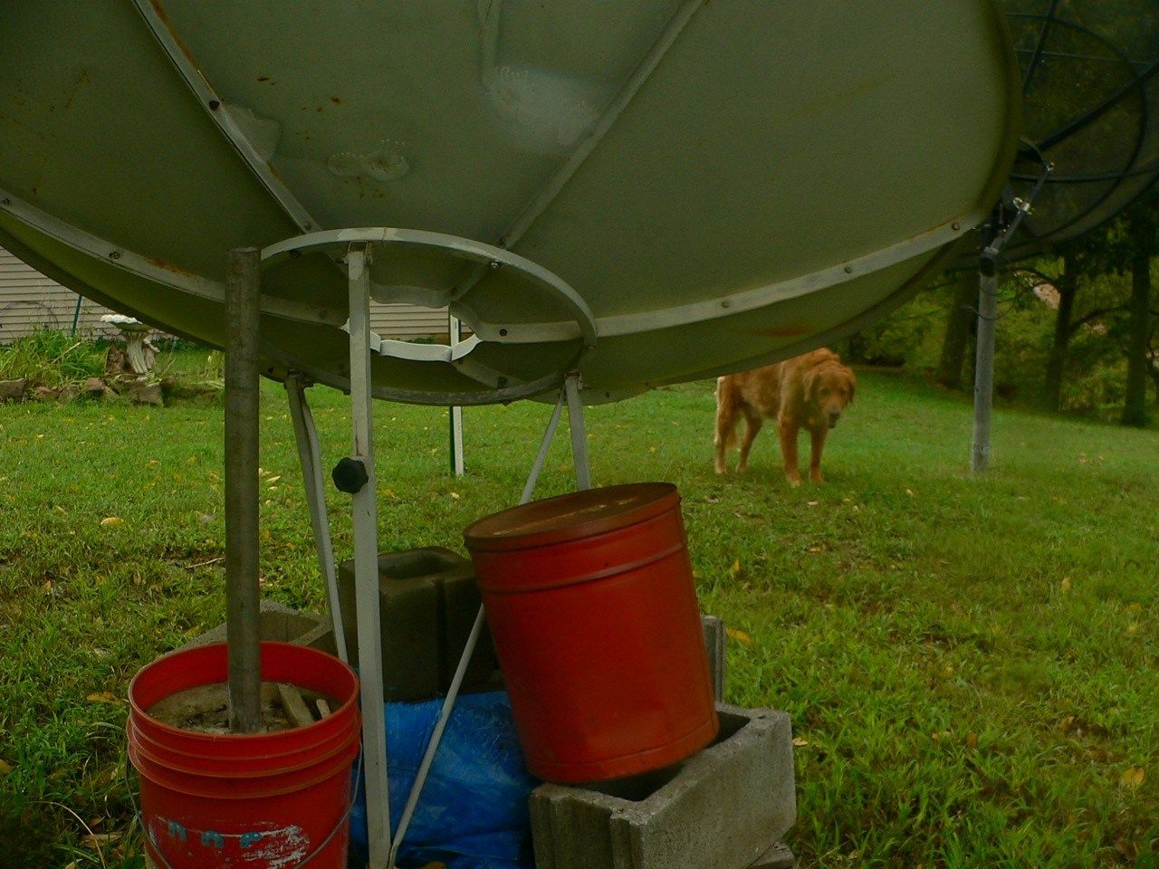

I see he has listed the mount diameter of his new deal to be 2-5/8"? This one was 2-7/8", so I mounted it on an existing planted 2-3/8" OD Sch 40 pipe I had, and used a split piece of 2" PVC for shims...........perfect fit. That pipe would probably be a little wobbly in a high wind, but could probably cut a foot or so off it and it would be fine.
Haven't had much chance to tune it yet but I was pulling in the usual suspects from 91W and 99W before I had to shut down the other night.
