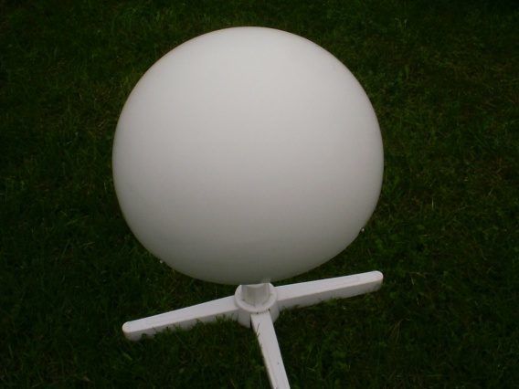

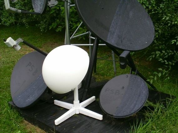

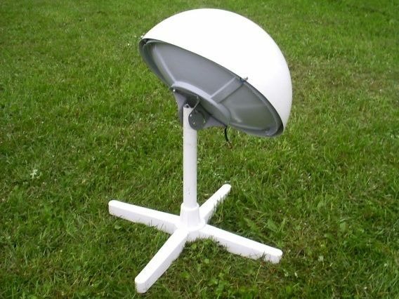

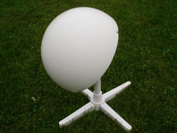

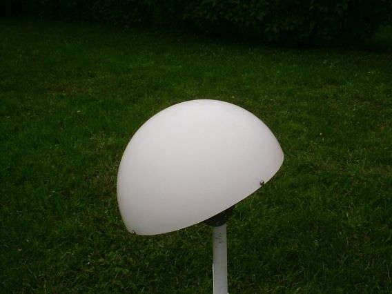

What with the rain today I had a chance to work on a pet project! The Free-Dome!
Its an 18 1/2" (3 1/4" deep) Prime focus dish with a radome protecting the dish and LNB, right now I am using a DBS LNB but hope to add a Linear Ku LNBF when ever the rain stops!
I plan or removing the LNBF cover to compensate for any signal loss caused by the radome!
Pictures below! Maybe an idea for folks that are not allowed a satellite dish (Or another satellite dish!
I also plan on working with an inverted dish to make a Low Pro version!

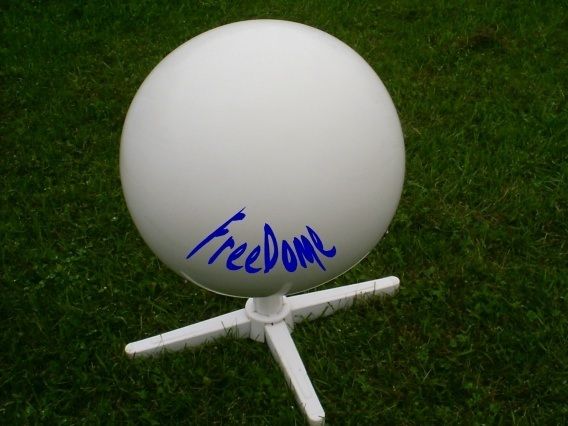

free dome
I have seen a dish like this in florida being sold. I like the idea because you could put it on the ground.
I also hope that the radome will keep the worst of the Minnesnowta winter weather off the dish!

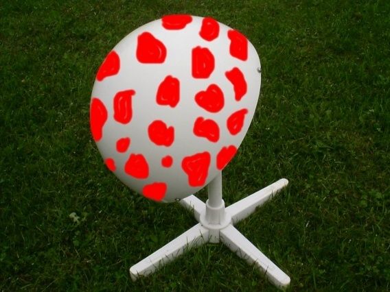

Fungi Dome
WyldCherry said:
hehe that looks like one of those white capped mushrooms
Fungi Dome!

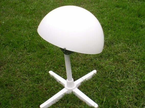

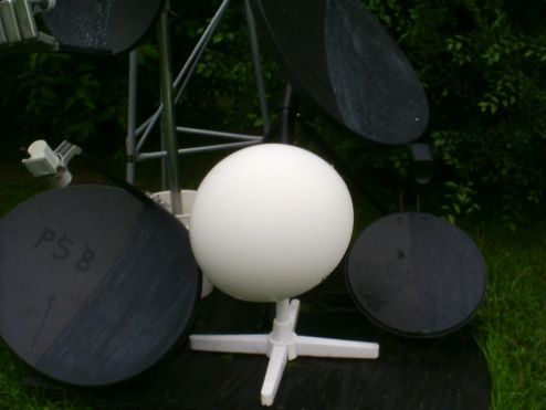

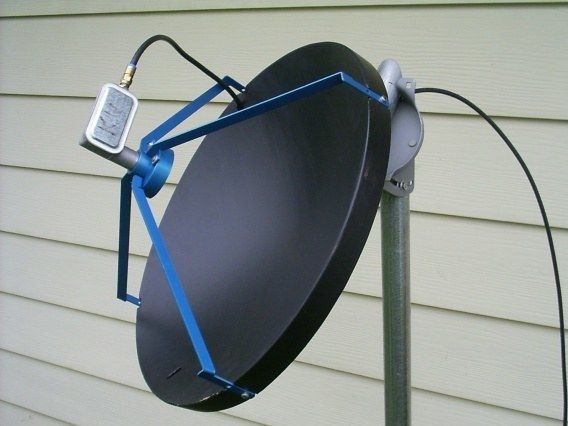

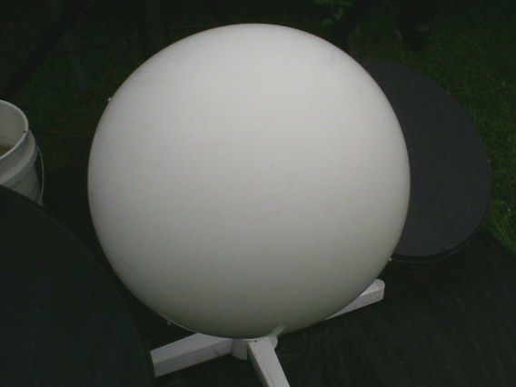

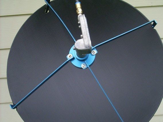

Adding some more pictures of whats inside the FreeDome! Including a linear LNB. I am getting Linear signals now but just started so I will post my results later! No skew needed as the dish is on a Poor mans H to H mount :D
One or two of the pictures are not actually a FreeDome! See if you can spot them! I also raised the elevation to show what it would look like in southern states!
VERY cloudy today!
GBN on AMC 6 65% signal Quality.

Perfect candidate for Rain Shield! Without a product Like Rain Shield, your signal will drop faster than the raindrops during a storm!!! Your LNBF cap shouldn't need to be removed ..... Interesting that they chose a prime focus. Seems that on that small of dish the loss would be quite high from the LNBF shadow!
They? This is not a real product! Rather a mix and match of components I botched together :)
The dish is designed for DBS signals so the LNB shadow is not really an issue, I have since switched to a linear LNB. With this design you have no choice but to remove the LNB cover (and indeed feedhorn) in fact its sawn off :) then fit the LNB into the blue feedhorn!
Starting to get some half decent linear signals now!
Every little helps :)
Nah! The dome is also sawn down and I even managed to drill a hole right through my finger when drilling the 4 holes that keep it in place!
Even the stand is from an old fan, have a few of them as they are EXACTLY the right size for DBS dish :)
