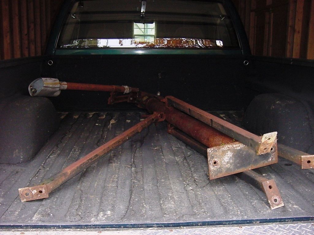

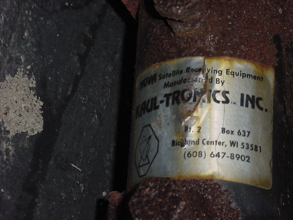

You never know what you'll find along the road. The other night I spotted a small cardboard sign that said "free scrap". The actuator motor caught my eye. As I was slowed down to see what it was I was shocked to see a rusty Kaul-Tronics polar mount for a Bud. :eek:
Excuse the dark photo, I left it in the truck to take to work to get it apart for cleaning for future use. This thing is ridiculously heavy.

Nice find, great that you saved it from the scrap man.
