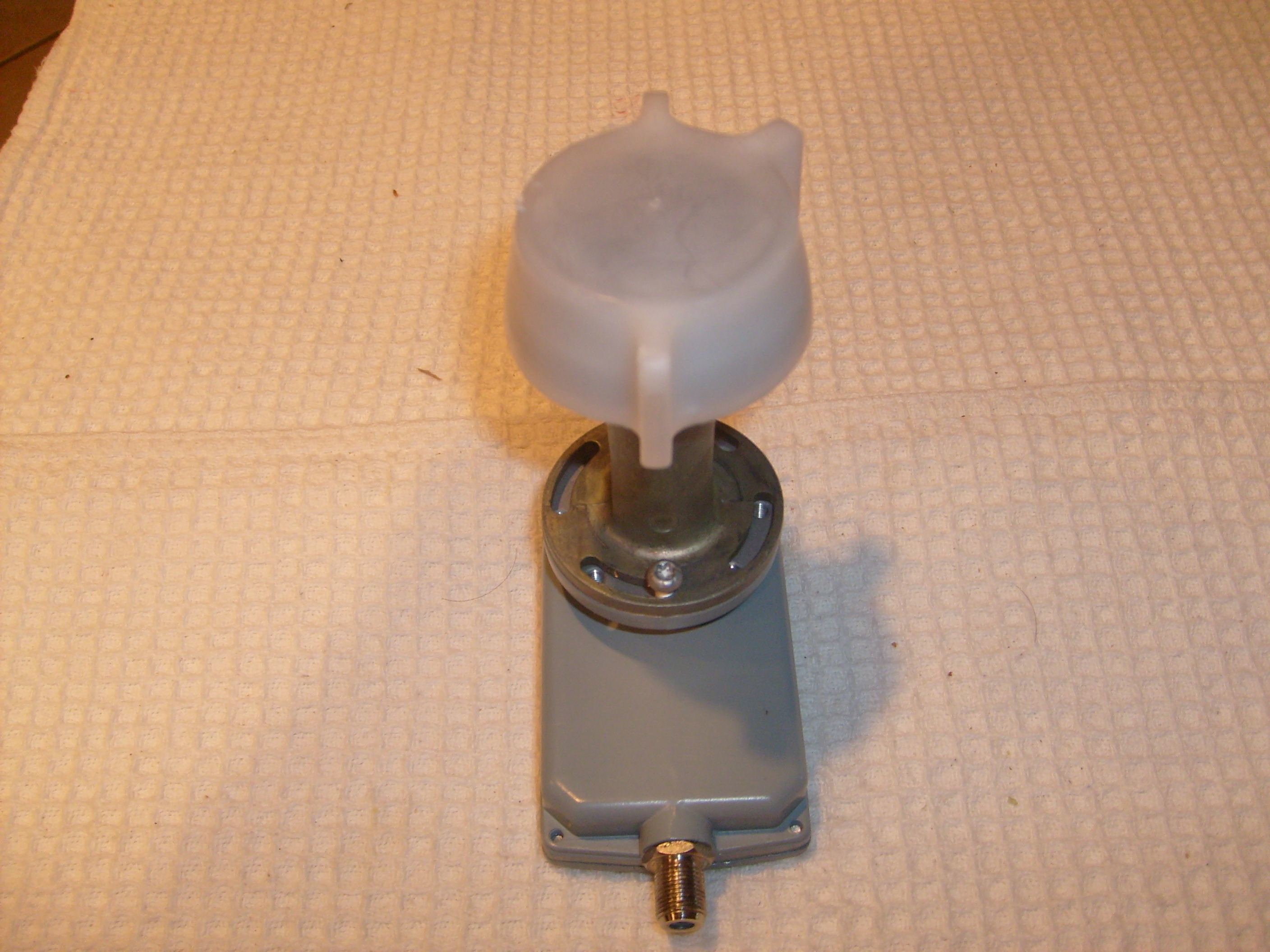

I was playing with a Dish Pro FSS Stacked lnbf from a Superdish I got a few days ago. Hooked the unit up directly to a 76 cm dish pointed at 97 W and receiving good quality using a DMS 0.3 db bullet type lnbf. When I substituted the bandstacked lnbf, I had to wrap some padding around the throat to enable proper fit to mounting bracket. Used these settings on receiver setup: LNB Type--Single Stack. LO freq.--10750/10175 Ghz. 22 Khz--Off. DiSecq-- Off. Then selected strong transponder like 12177 or 11991 - a vertical tp at any rate. No quality level reception. Tried skewing or rotating the lnb and moving it in and out to find focal point, but no luck. Now I understand these lnbfs may only have 0.7 or 0.8 db noise capability??

From the photo it looks like you've got the feed mounted at the correct angle with respect to the LNB - that shouldn't change. Are you feeding 18V from the receiver (set to H, even though you are receiving V)? These LNBFs are kind of power hungry. I can't think of a lot left to check if substituting another LNBf works. You may just have a dumpster-grade LNB.

- are you sure you have the actual LNB with "FSS" on the label?
- are you sure you reattached the feedhorn properly?
- if the feed horn is rotated on the LNB out of its proper orientation, it won't get signals. It has two detent positions.
