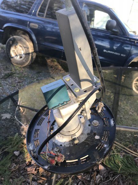

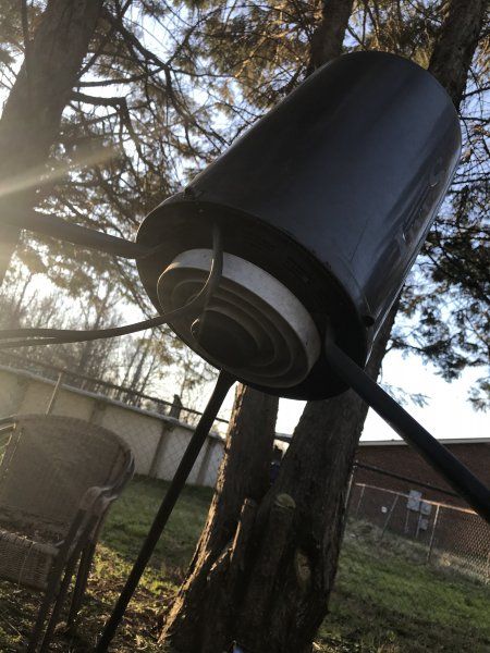

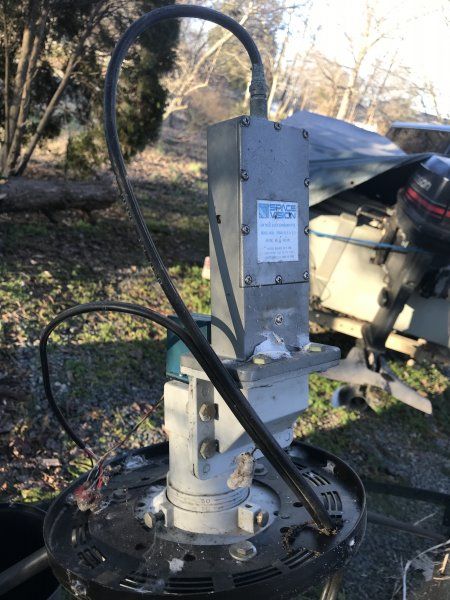

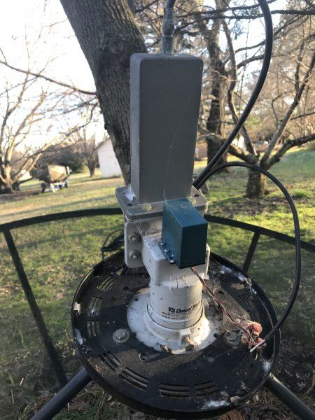

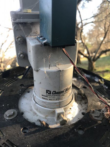

I attached photos of the current setup for your viewing pleasure.
Thanks in advance!
Thanks in advance!
That Titanium LNBF will work perfectly for you. At the moment, I'm using the exact same one on my SAMI dish. Just be aware that it's a single output, so can only be used with a single receiver. If you ever think you want to add a second or more receivers, you MUST purchase the dual-output version of that LNBF. Also, use the SATGUYS SAVE code in the checkout basket, and you'll save 15% off the price!

I second this. That LNB has fantastic performance. It's all you need; the receiver does the rest :)

Yes, that's the newest dual one. You'll be able to use two receivers, OR with a switch, more than that. As for receivers, there's all sorts of them. If you just want a good one easy to use, there's the Amiko Mini H265 available here: Welcome to Michael Electronics
As for dish movers, they are really limited right now. Either the Titanium ASC1, OR you'll have to find somebody that has a Vbox or Gbox that's willing to sell one to you. They just aren't available new anymore in the USA except for the ASC1. There are NONE integrated with FTA receivers.
