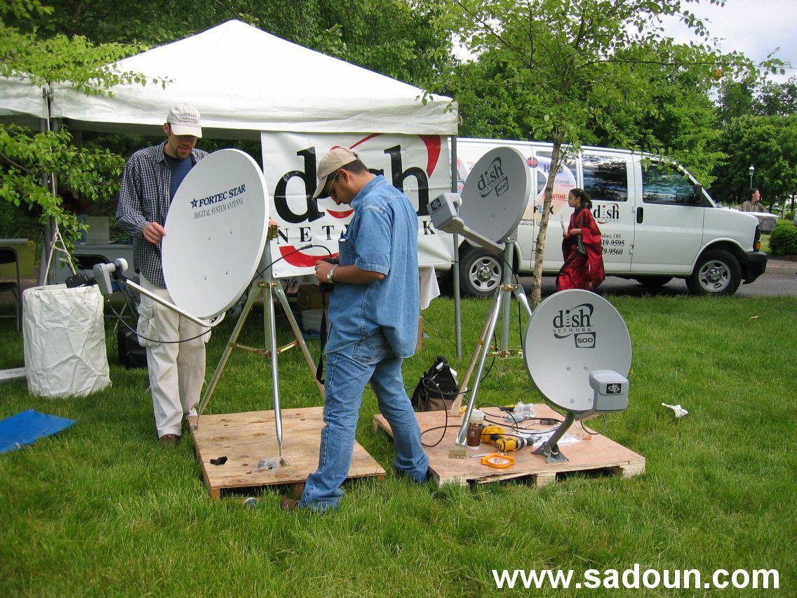

Fixed dish is the easiest, but if you are staying for a longer stay, a motorized dish can be reinstalled in less than an hour. We often demo motorized systems at events and usually can have the dish set-up and tracking in less than 20 minutes.

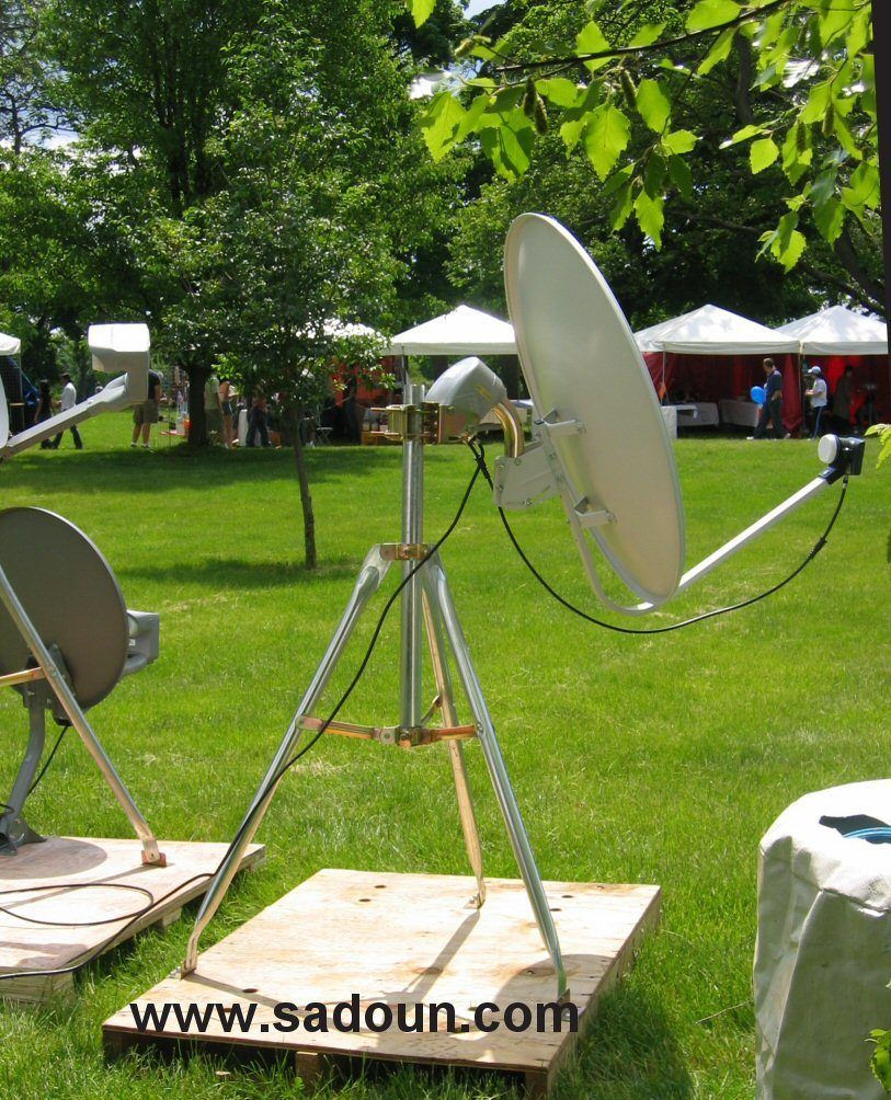

I have seen RVers with a tripod mounted Sadoun motorized system that can be placed on the ground away from the RV where a clear view can be obtained. As others have stated, getting the full arc once you have a plumb pole isn't that hard.
NO, I have no connection with Sadoun, but if he wants to reward me for giving his products a plug, I won't object!
If you mark all your angles and just put them back to the same mark each time,once you get your mount plumb,you should be in buissiness.

Here are a few pictures of our setup at the Columbus OHIO Asian Festival a couple of years ago. We demonstrated a motorized setup and our Dish Network International programming (we are an authorized Dish Network and DirecTV dealer).
