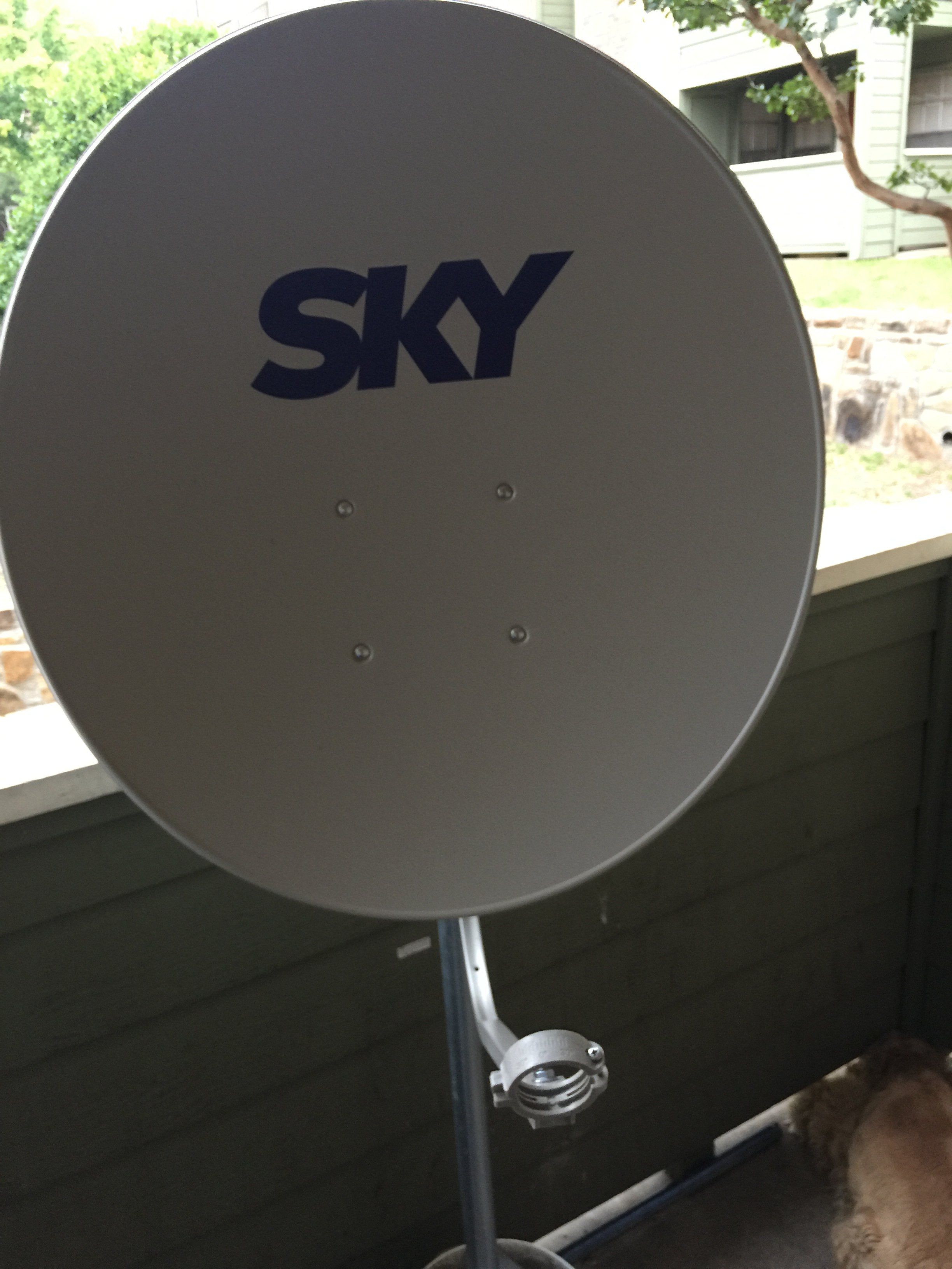

Thank you for the info,I have a 32 inch offset dish ,I can't go higher I live in apt :( any Adeia ,do you think I can get any signal with that and what kind lnb I should use ?

Zoom in and move the marker to your dish position to see possible obstructions, LOS, etc. If referencing dish size, that's big enough for most.
Antenna height doesn't mater when the 'target' is the size of a medium bus and 23,000 miles away.
Hopefully, a southern facing balcony?

For 'installation', this may work on a balcony, Pole 'planted' in a bucket of cement

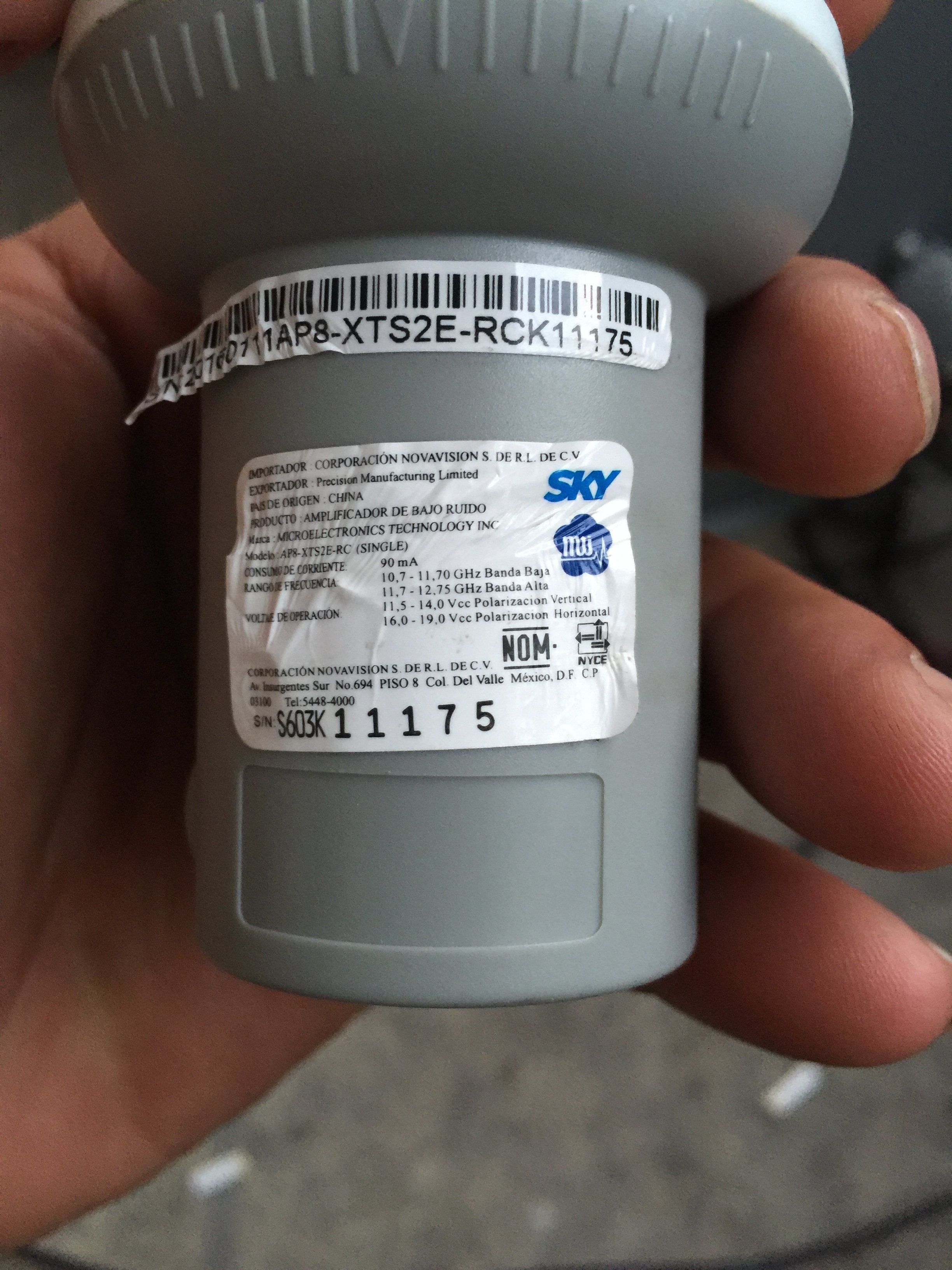

image.jpeg image.jpeg This is my dish size and the lnbf that I'm also using ,do I have the right lnbf?
My balcony face south east so I'm good with that....I purchased the lnbf link that you posted,hoppelly with that I can get at least something..thank you for you help...since you are expert on that,maybe you can give me more Adeia ....
That LNBF in the picture will work.
It's a Universal with L.O 9750 & 10600
You can program as a Universal and the 22Khz setting will likely be unselectable. That's OK as the 22 Khz is used to select which L.O. automatically.
OR
Program it as Standard, and program the L.O. to 10600
Select 22Khz and set to ON
This setting will then NOT scan the Lo Band (10700 to 11700) which is not used for domestic satellites. Only the 11700 to 12700 band is used domestically.
