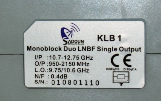

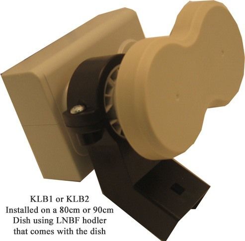

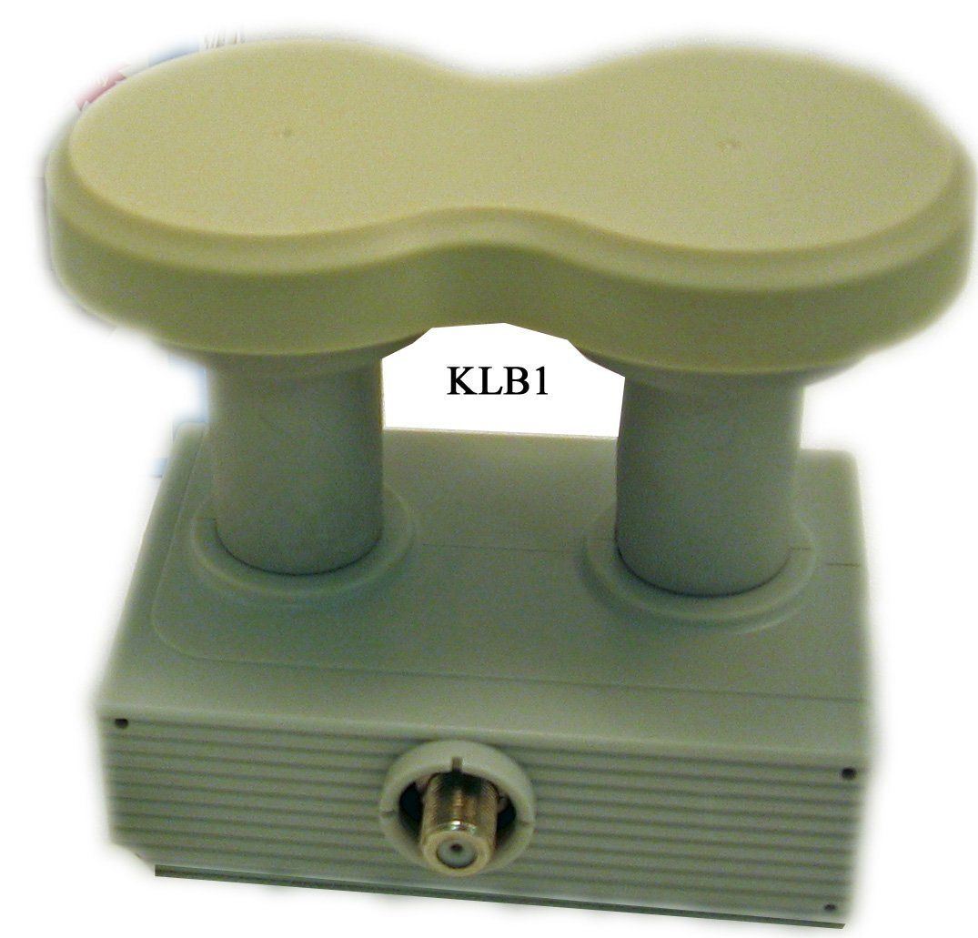

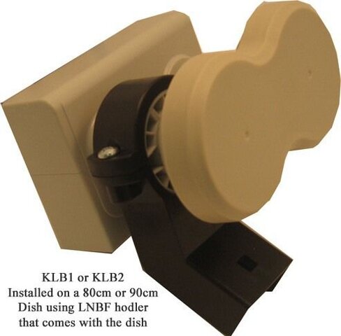

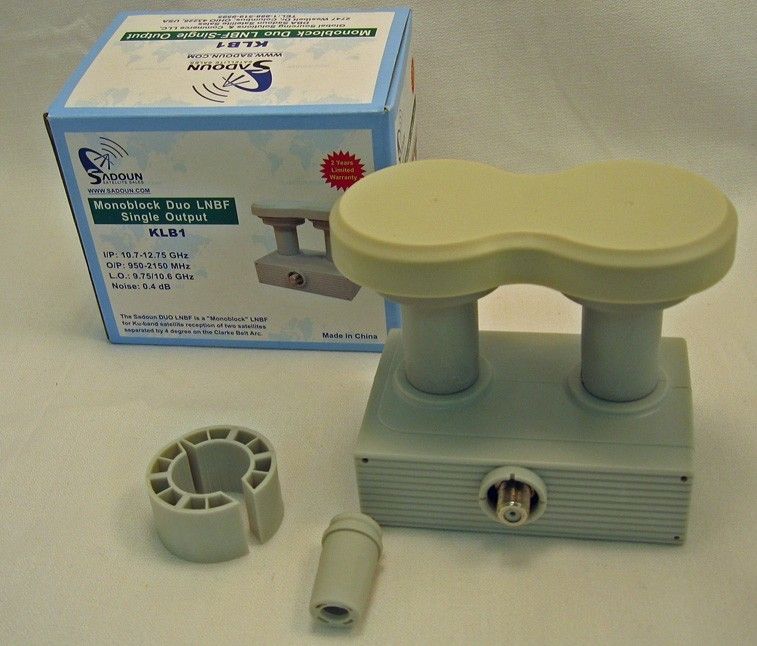

Sadoun KLB1
You could also consider the
Sadoun KLB1 Monoblock Duo LNBF 4 Degree Single Output Linear KU 0.4 dB

I have one kicking around here. It works pretty good. The only drawback I had was you couldnt skew each LNB separately so you are trying to find the best of both sats

If it was a standard LNB with a 22k switch it would be awesome...but being a Universal it hinders the multiple dish setups
I wonder if the Sadoun KLB1 scalar rings are a bit too close for the 4' dish... It is soooo close with the two regular LNBs, like LAK7 says above the two bullet LNBs with the proper holder would likely be perfect. I was suprised though when I installed the second LNB and went down to the receiver and kabang.. there was the G26 transponder. Didn't really do much tweeking to get a decent signal and split the difference. There is a difference in skew between the two sats but if the LNBs were perfectly aligned it may not make that much of a difference. I tend to like to fabricate things but if my holder gives out or doesn't work out I might consider trying the KLB1 I am sure it would work.

The monoblock is designed for a 76cm-90cm dish. I tried mine on a 90cm dish. I think the 120cm might not work
