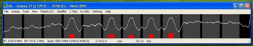

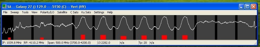

Looks like they are transmitting to Galaxy 15 now.
SR looks to be 20000.
I can't lock any of them.

If I read your sweeps correctly there is no signal on 21. I was wondering if it was shutbown on T7 or if it quit working as well. Do you remember any signal there recently?
They moved Galaxy 27 to 45° East. So there have been no signals from 129° West for a few months now.
The signals are on transponders 8, 10, 12, 14, 16 and 18 vertical, and on transponders 7, 11, 13, 15 and 17 horizontal.
