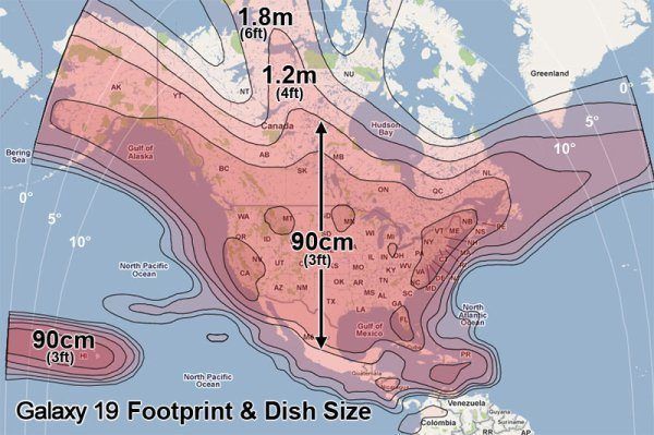

I have no signal on Galaxy 19 several days ago. I am in Ontario Canada.
Yesterday, I came out to check my 36" satelite disk using my Satlink (electronic satelite finder). Autoscan of Satlink found 13 TV channel at the current position of the disk. No improvment by moving the disk around to find better signal.
As autoscan found some TV channels, I believe that my disk position is OK. And with this thread, I found that I am not alone thus this satelite must have problem. Signal might be too weak to reach Canada???
Galaxy 19 Ku-band has one of the best coverage footprints in North America, including most of Canada.
I drilled a hole through the disk holder when the disk was well aligned. This hole is drilled trough the up/down plate, left/right holder and the stand pipe. The holes of the plate, holder and stand pipe are still well aligned. I did try to find better new position by moving the disk around (up/down and lef/right) to find better signal but cannot find better signal using my Satlink! As the autoscan can find some TV and radio channels, my LNB must still working well. So what else can I do?
