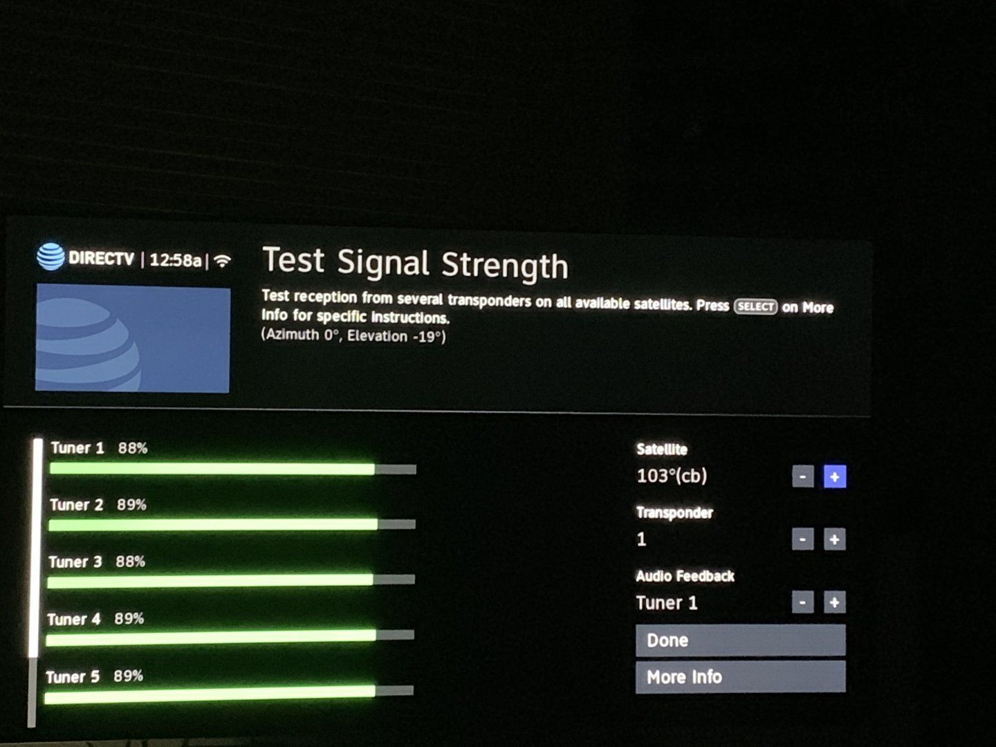

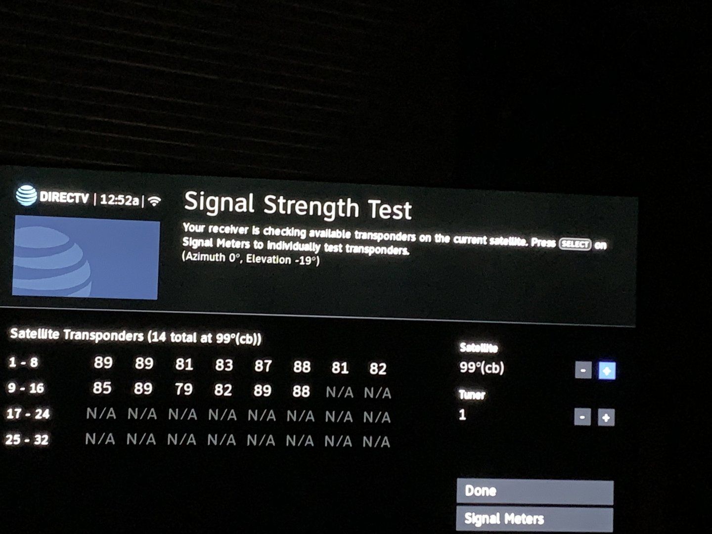

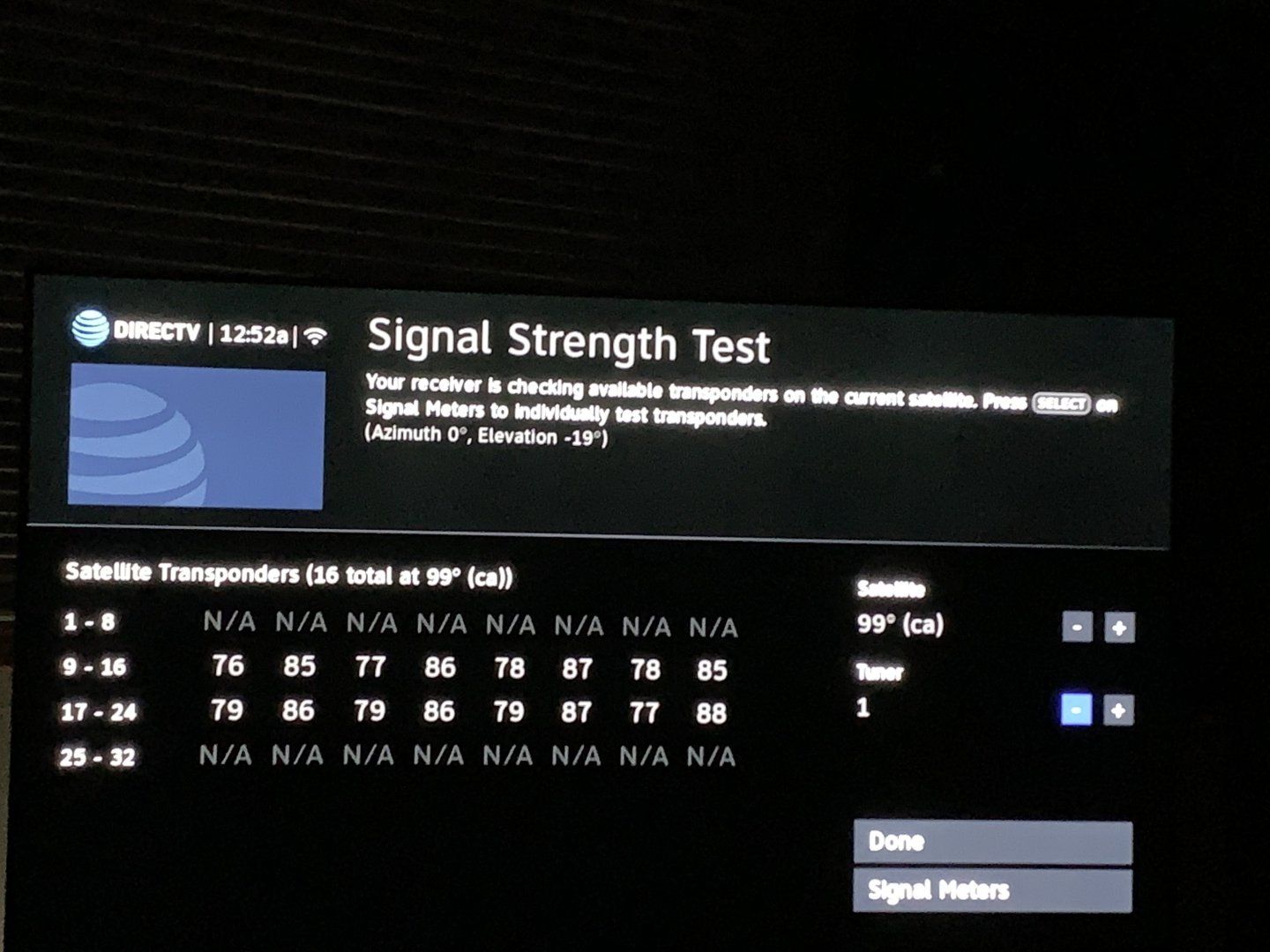

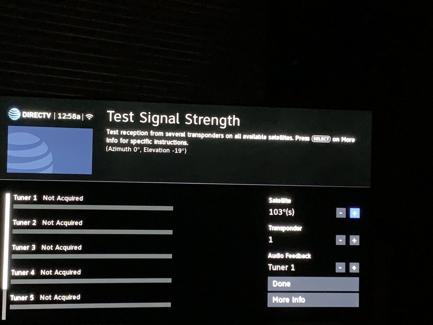

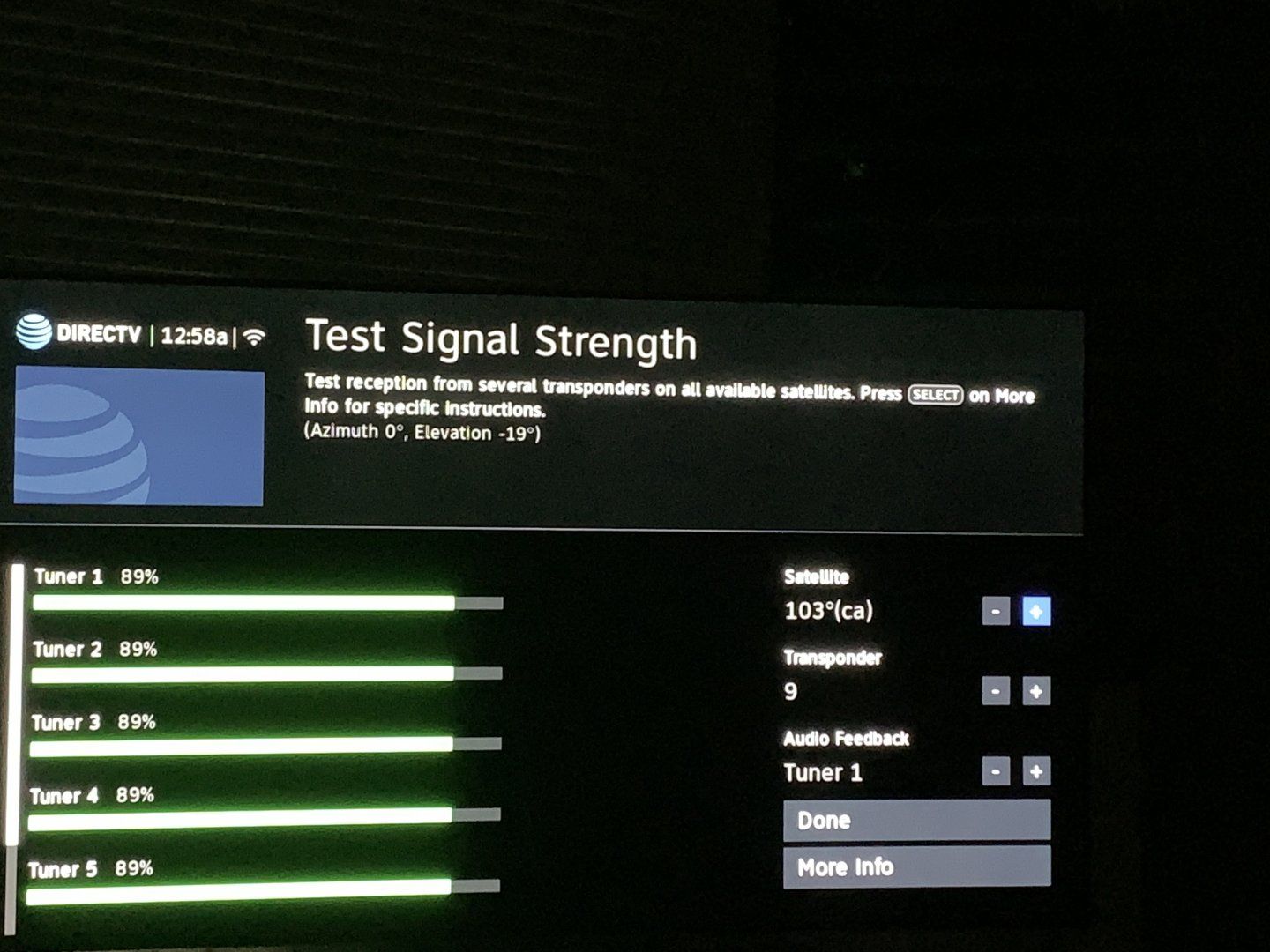

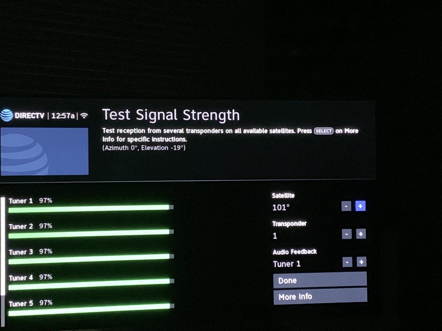

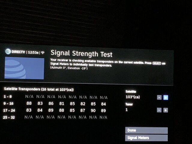

I'll check the signals.

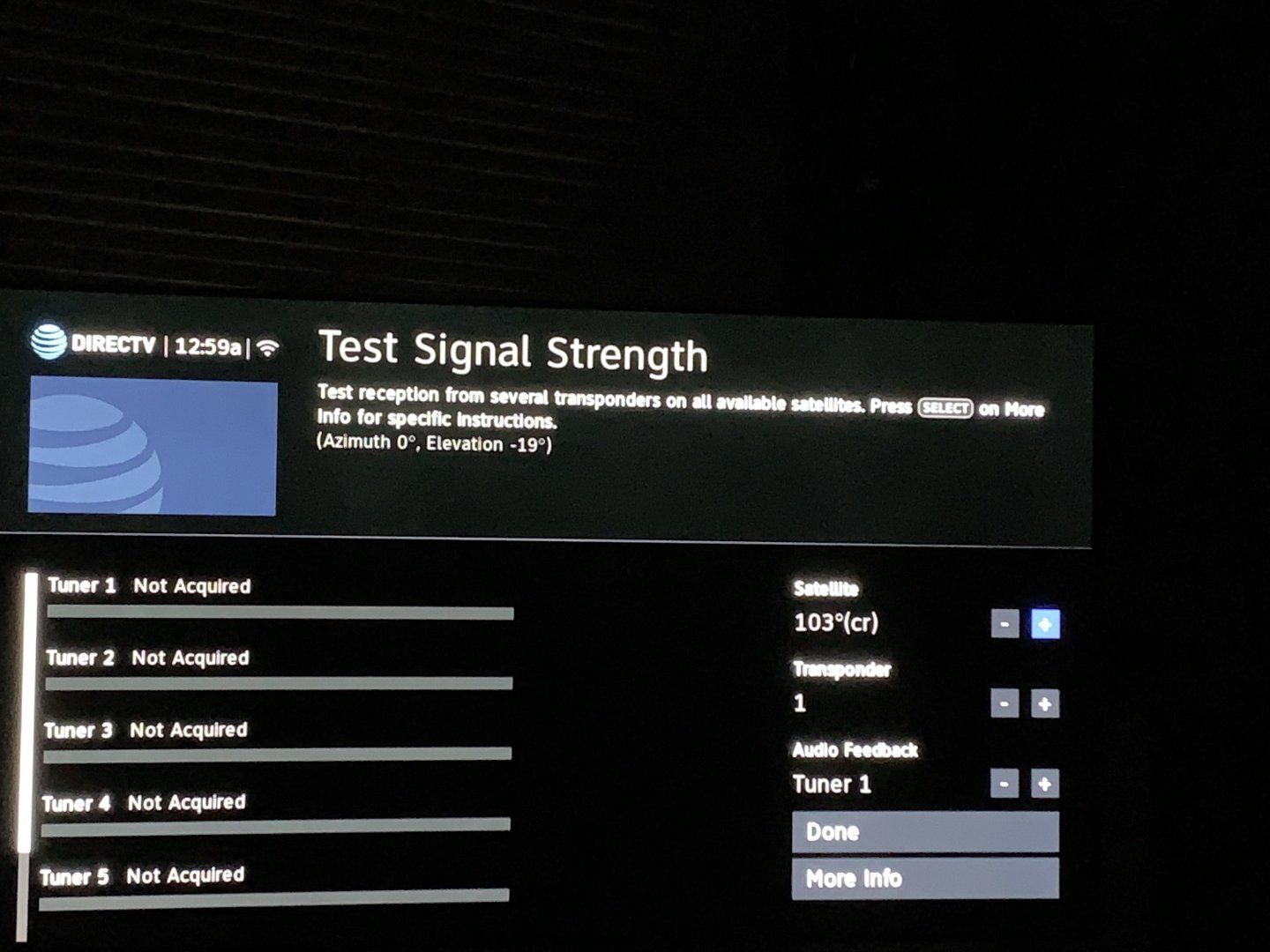

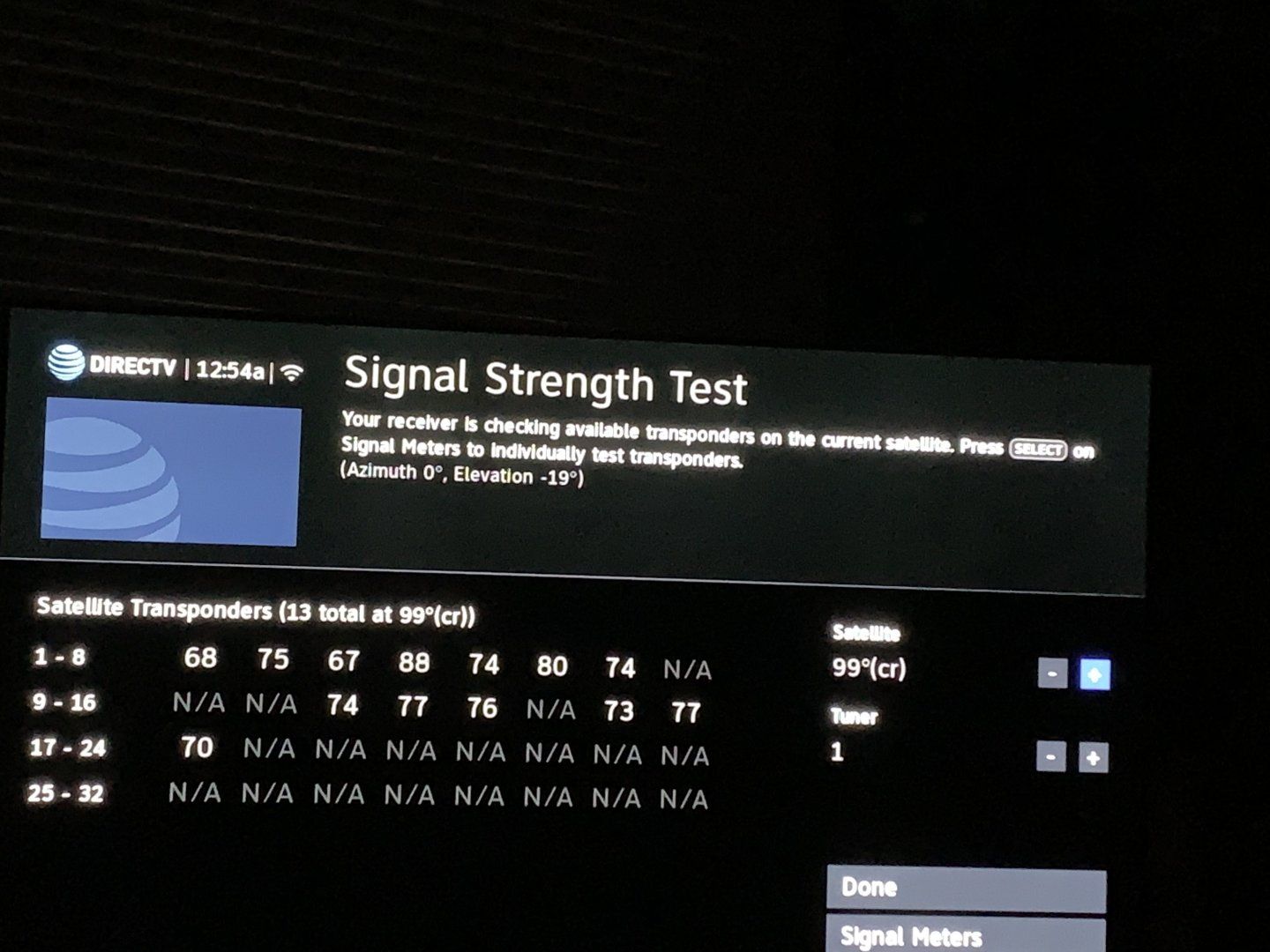

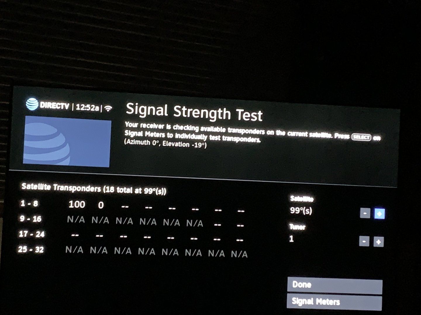

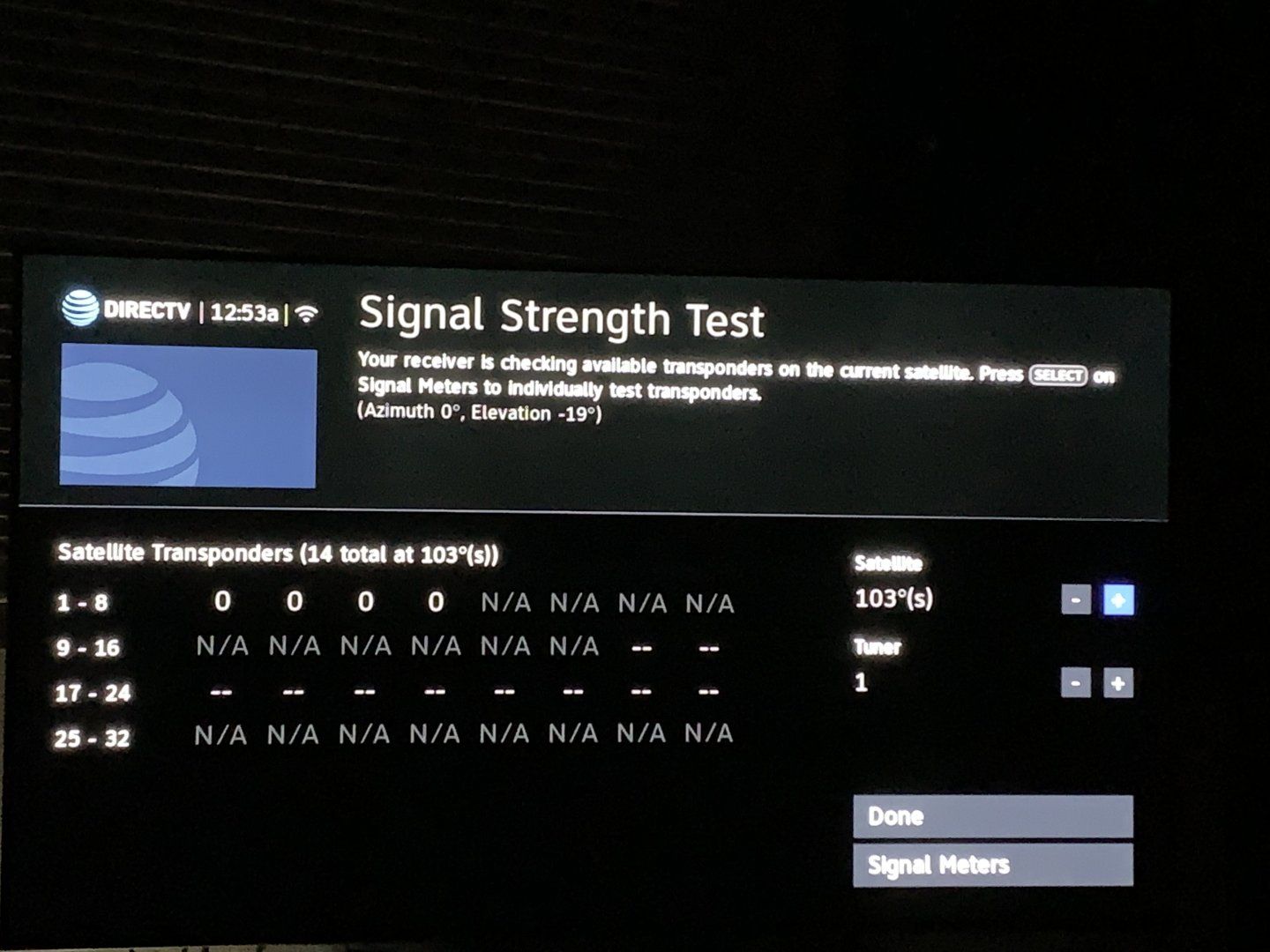

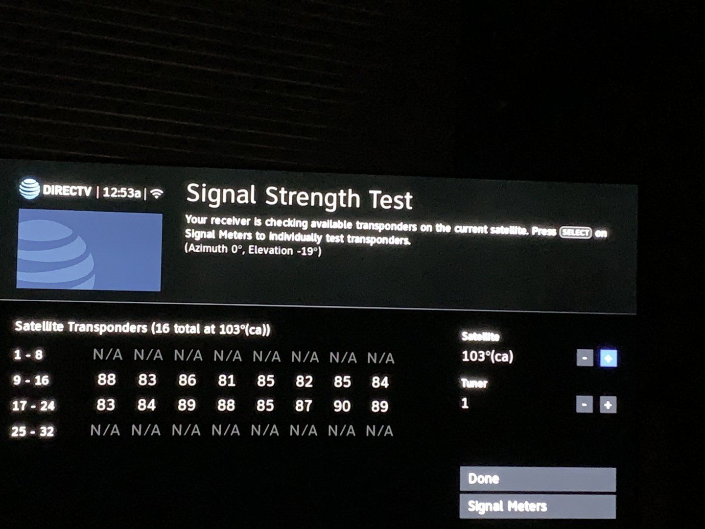

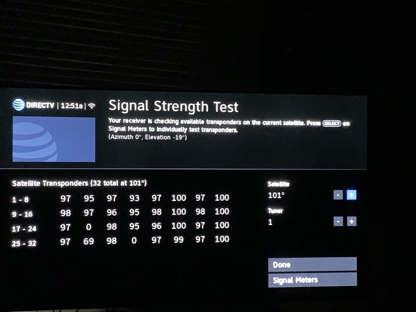

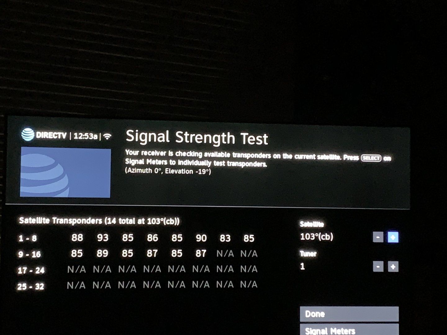

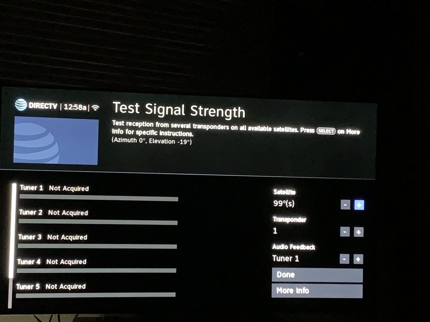

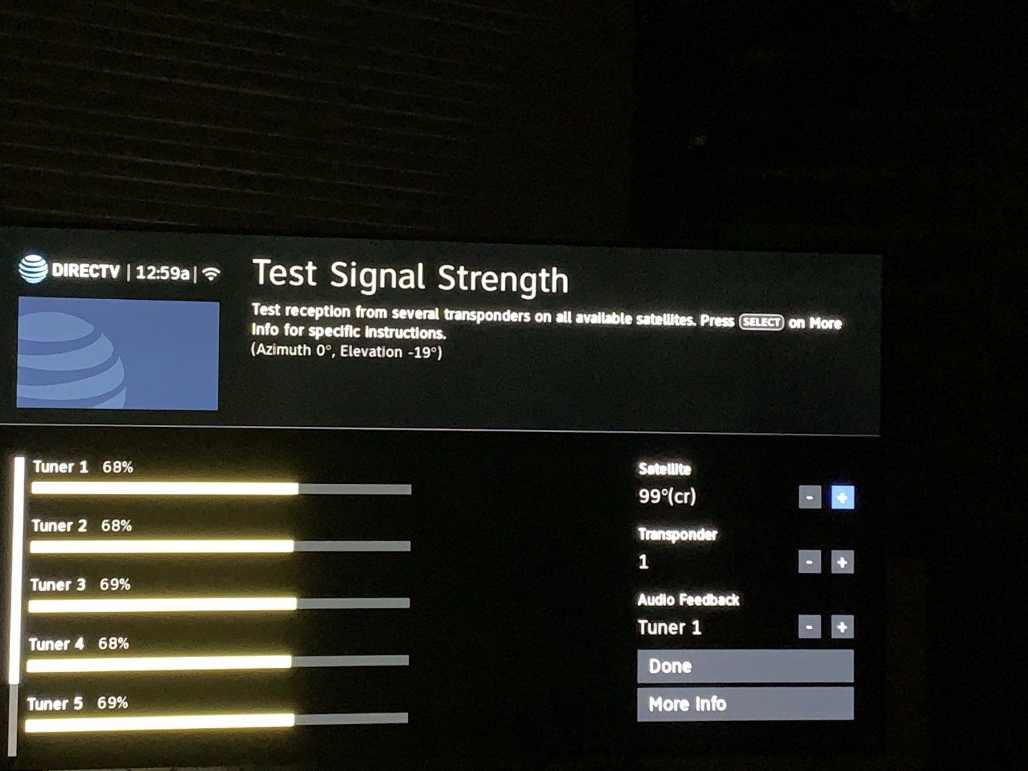

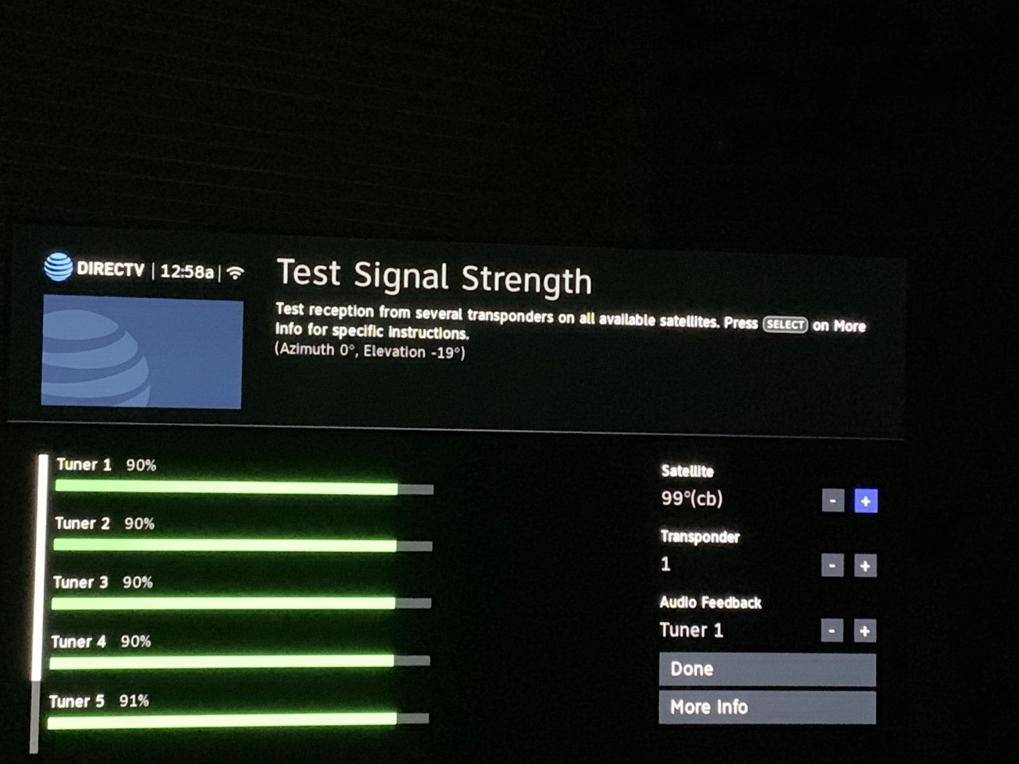

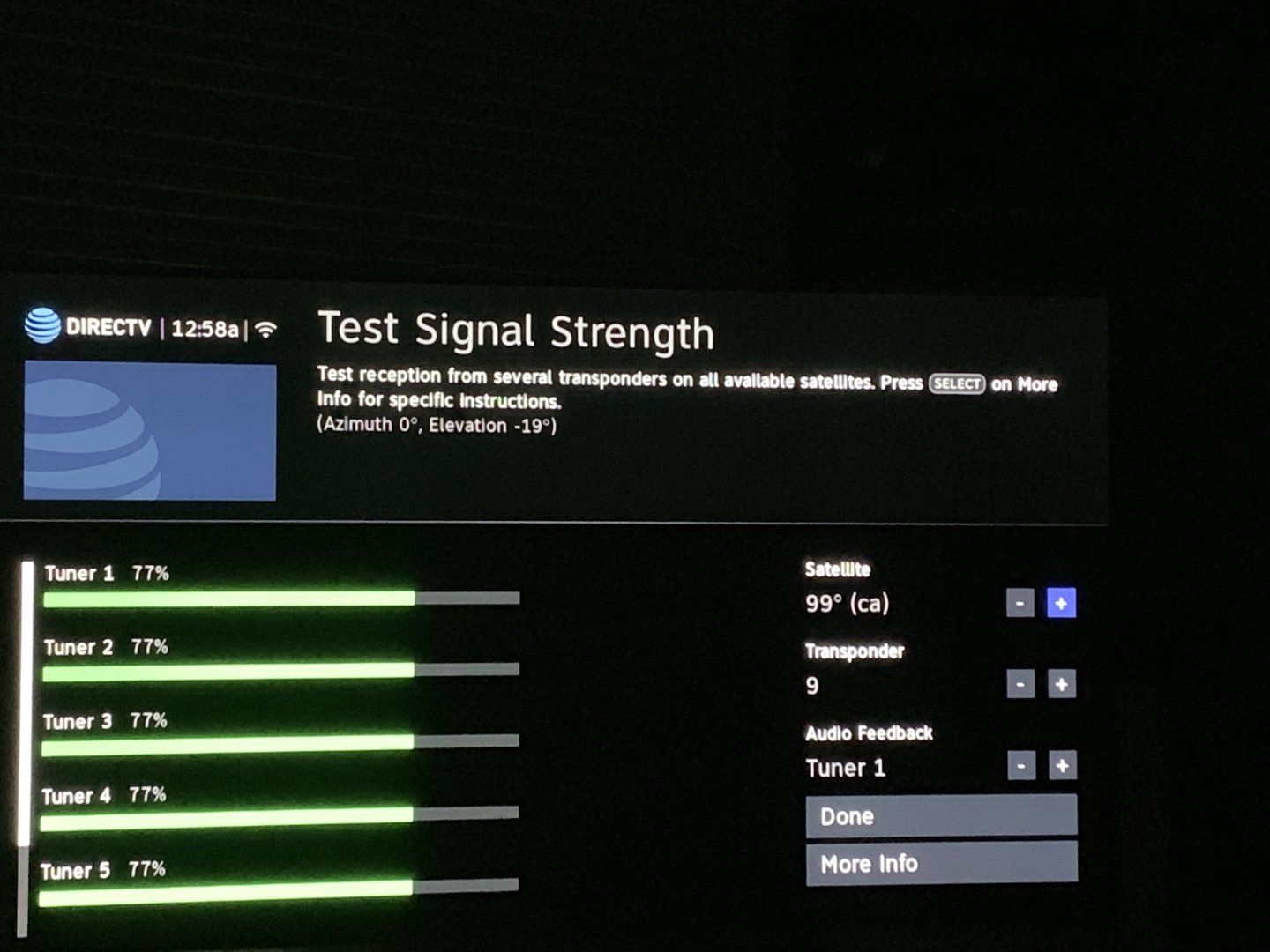

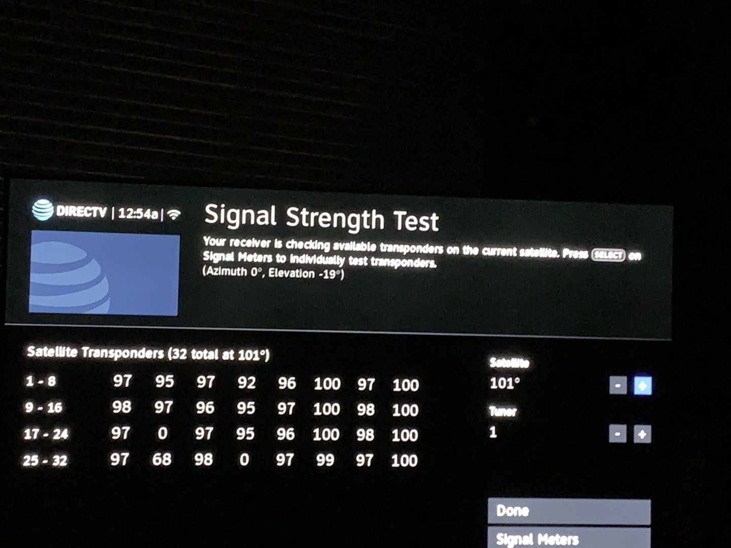

Here are the signal levels:
Here are the signal strength

Signals levels are ok. 99/103 could be peaked but I doubt that is your issue. I wouldn't go nuts until you get the replacement box
