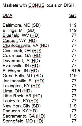

Dish does spot beam the NY and LA locals. They do now offer a DNS service that is LA local and uses separate feeds/transponders as others have suggested. Dish does have a handful of other markets that are CONUS that you can "Move" to if you're Ok with getting locals from there.
Below is the list I have of the Dish CONUS locals. I have not verified the list recently, but I have used Jacksonville, FL and Bluefield, WV on 77 as recently as last month.
