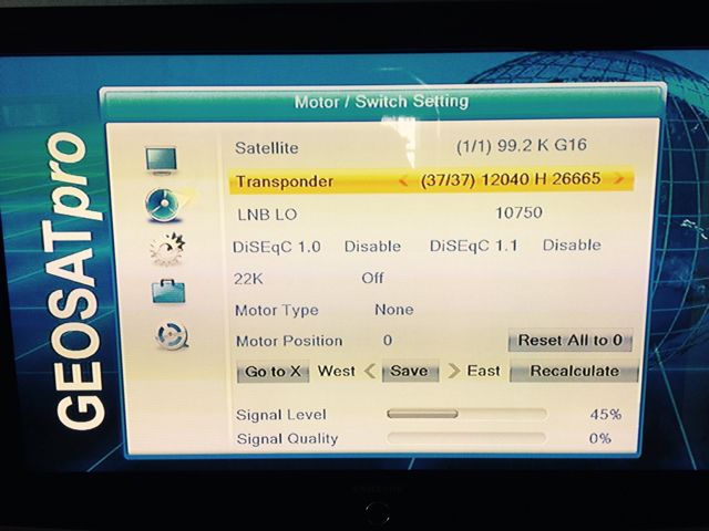

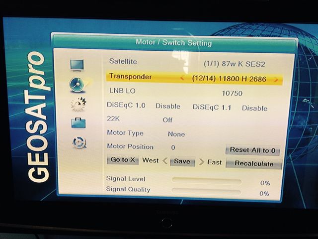

Those pics are my best tps in my area. I took the switch out and still nothing.
