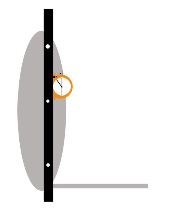

I picked up a GSP 90cm to try to get 30ºw with an elevation of 14º where I live.
I followed the instructions to reverse the elevation bracket so it will read 0º-20º
Question: What marks do I use? The manuals I've read say there is no way to use an inclinometer to set this dish, but I dumb and can't figure which pointer to use.
Since pointer 'A' goes to 65, upside down is that 0? And so would 50 be 15 ?
http://www.satelliteguys.us/fta-manuals/189795-geosatpro-90cm-offset-dish.html
see 'Z' special elevation

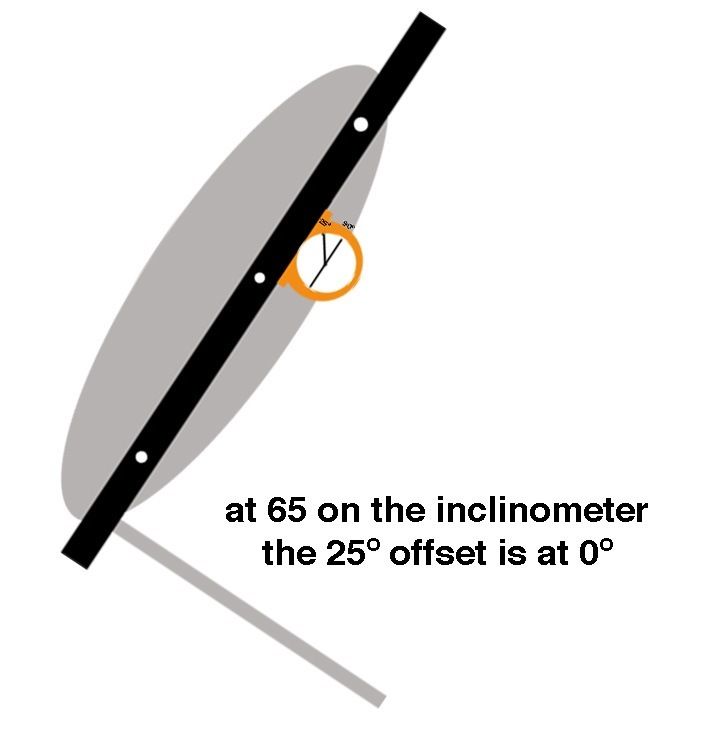

Here's what I was thinking. Since the offset of this dish id 24.6º, if I put a straight edge across the face and put and inclinometer on that edge, then if I drop the inclinometer to 25º that should be 0º elevation, right?
So then if I lift the dish 14º that should give me my mark. With 90º being my 12oclock on the inclinometer, 79º would represent 14º latitude. 90-25+14=79
Does that seem right?
that sounds right.
Approximately! Good math ...... :D
Tilt the dish top edge forward 10.6 degrees. (24.6 degree (offset angle - 14 degrees (desired elevation setting) = 10.6 degrees )

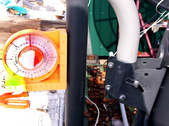

The problem is that when you invert the mount as in illustration 'z' in the above manual, the scale is upside down. That's why I'm left with measuring the angle from the face. (unless SatAV can offer insight into the 0 reference when inverted)

I think I got the same math (after rounding) 90 is the mark on my inclinometer minus 25 (24.6) equals 65 plus 14 equals 79 on the inclinometer
So yes a forward tilt of 11º(10.6º) (I'm not digital)
I did go the right way, didn't I?
Radar, not sure about the actual scale reading. I don't have a dish set-up at home with this configuration and don't recall how everything lined up during the testing.
So if my numbers are correct, inverted on the 'A' scale, 50=0 (on the horizon) and 35=15 (above the horizon)
