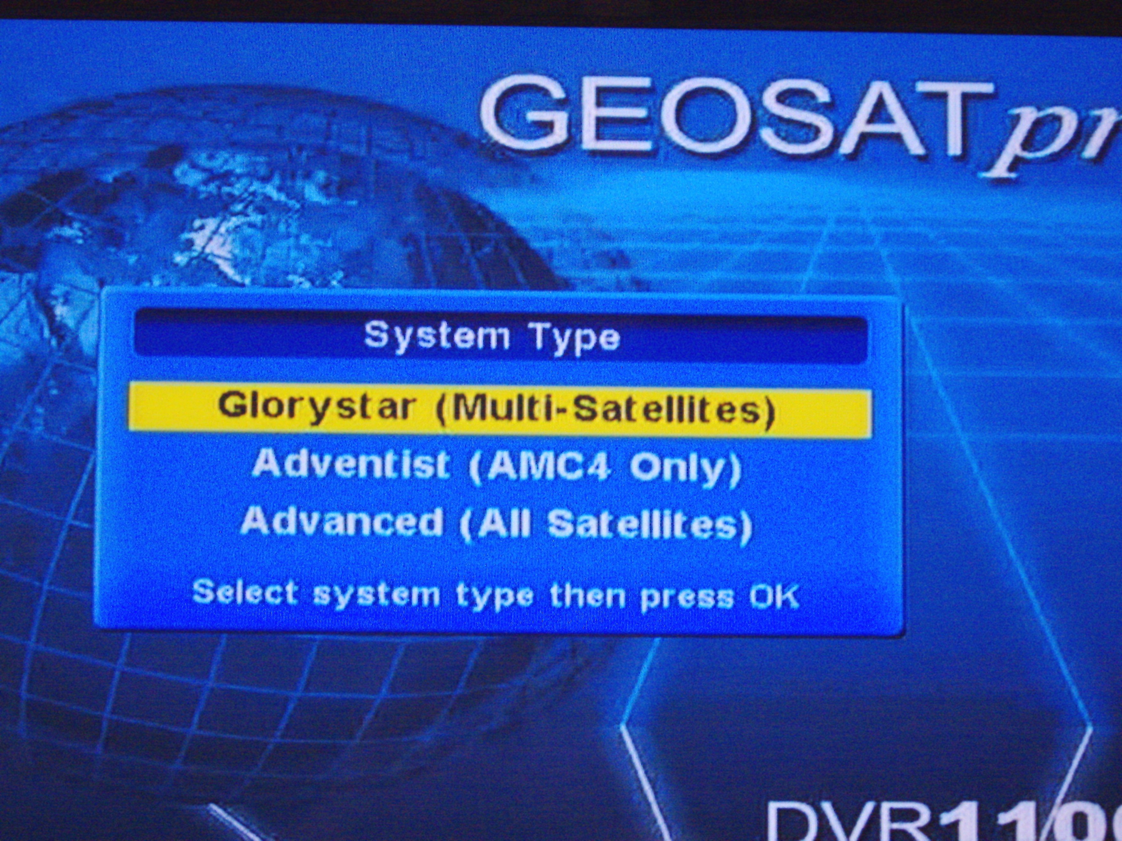

I am doing the review in 2 parts since the receiver caters to 2 groups. The folks who want it just for Glorystar setups and the hobbyist. First part is the Glorystar setups. I hooked up my cable and powered on the unit. It asks for your language and then you have 3 options depending on setup
-Glorystar setup (97 & 101W)
-Adventist setup (101W)
-Hobbyist setup (all sats)

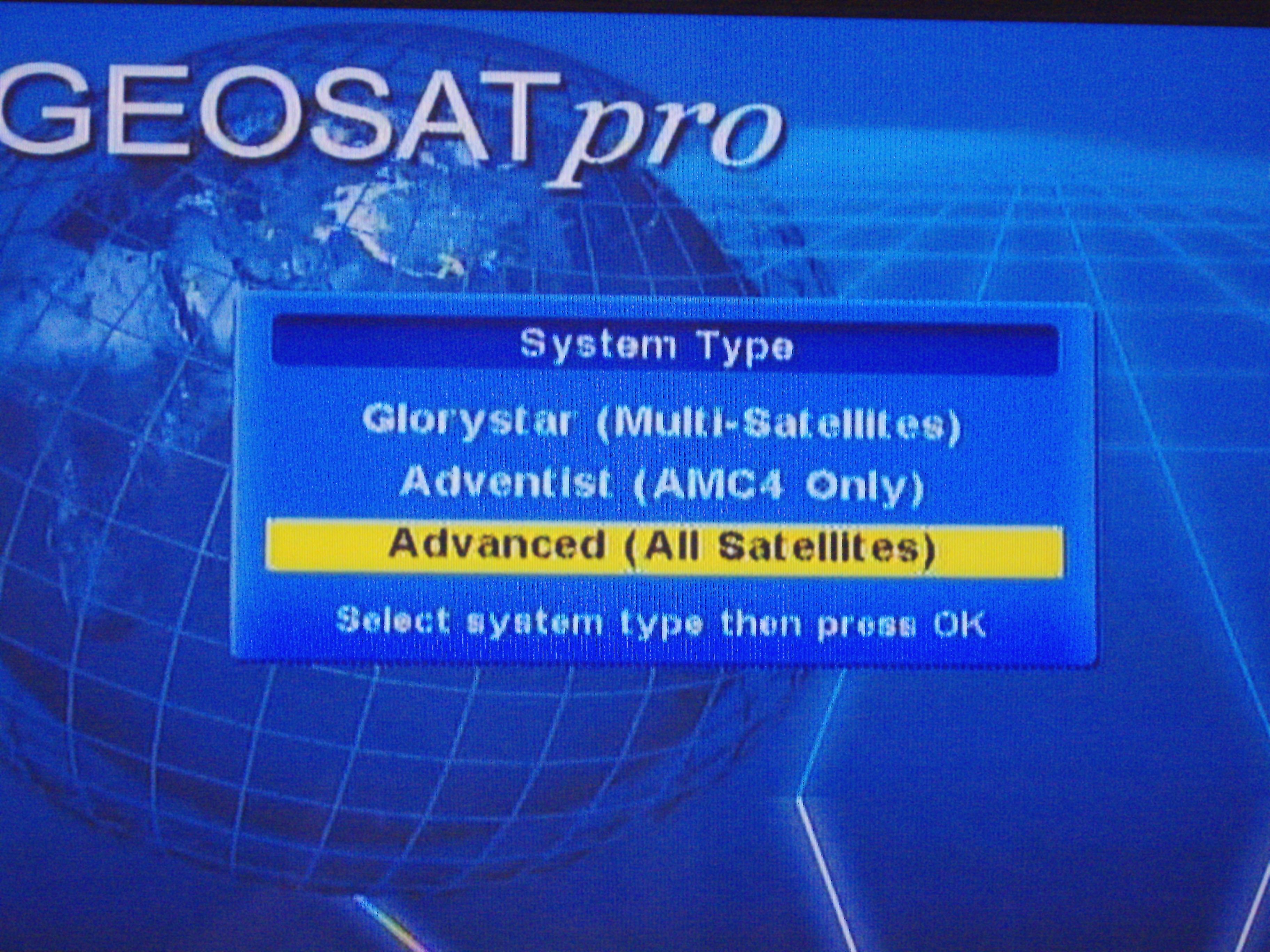

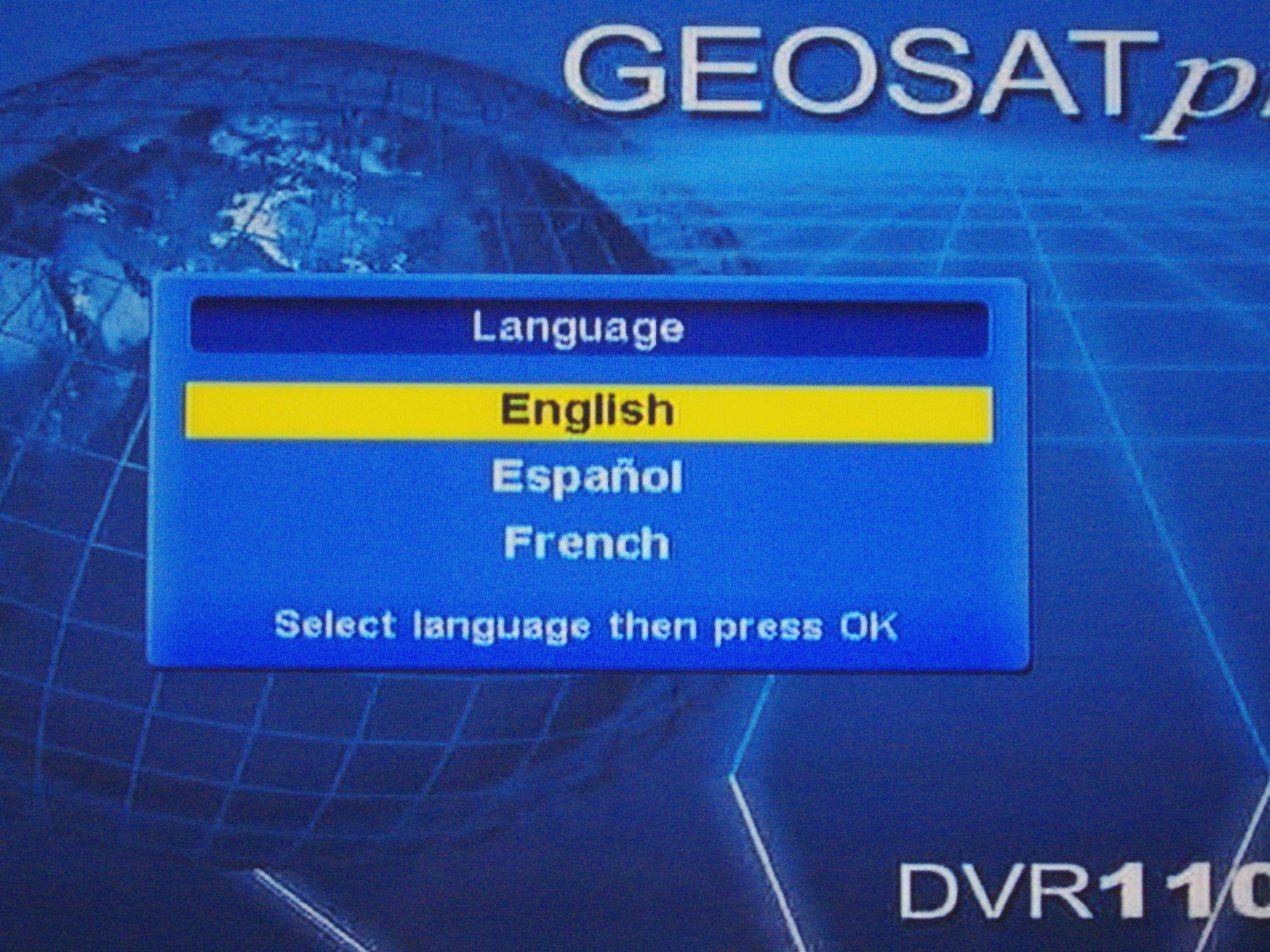

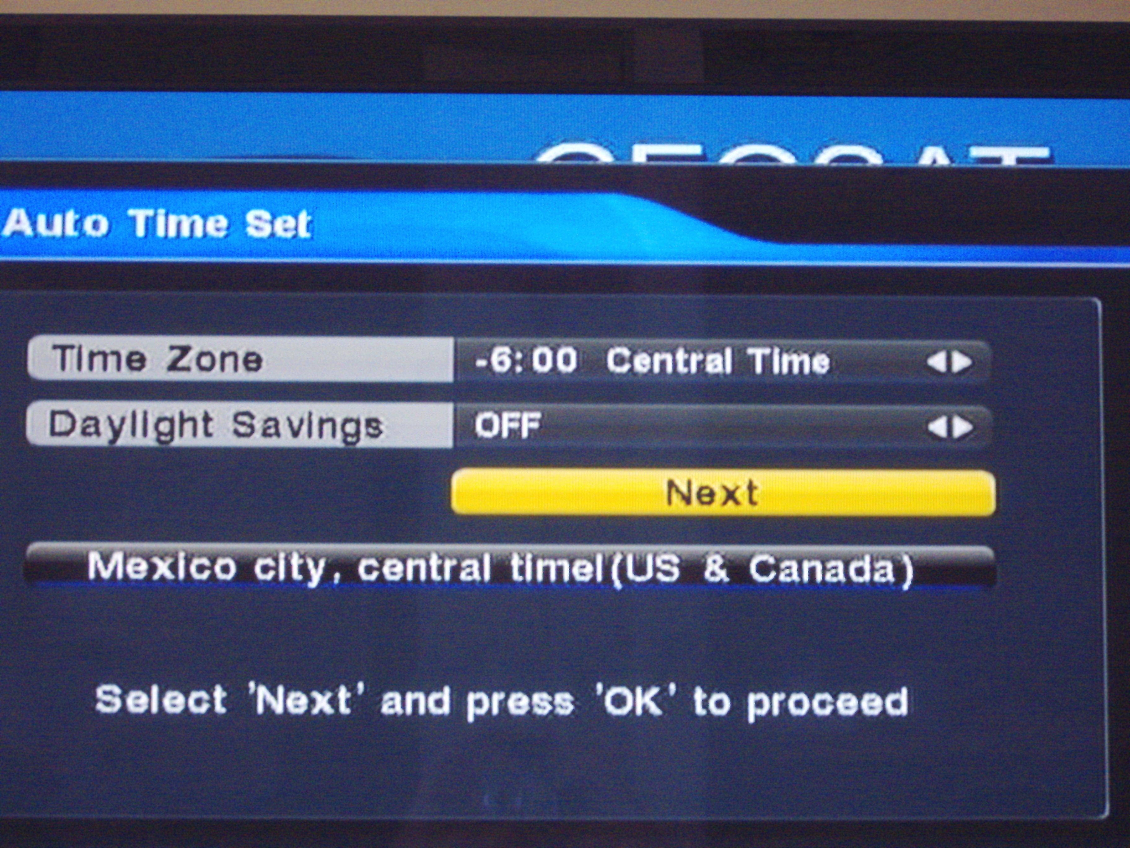

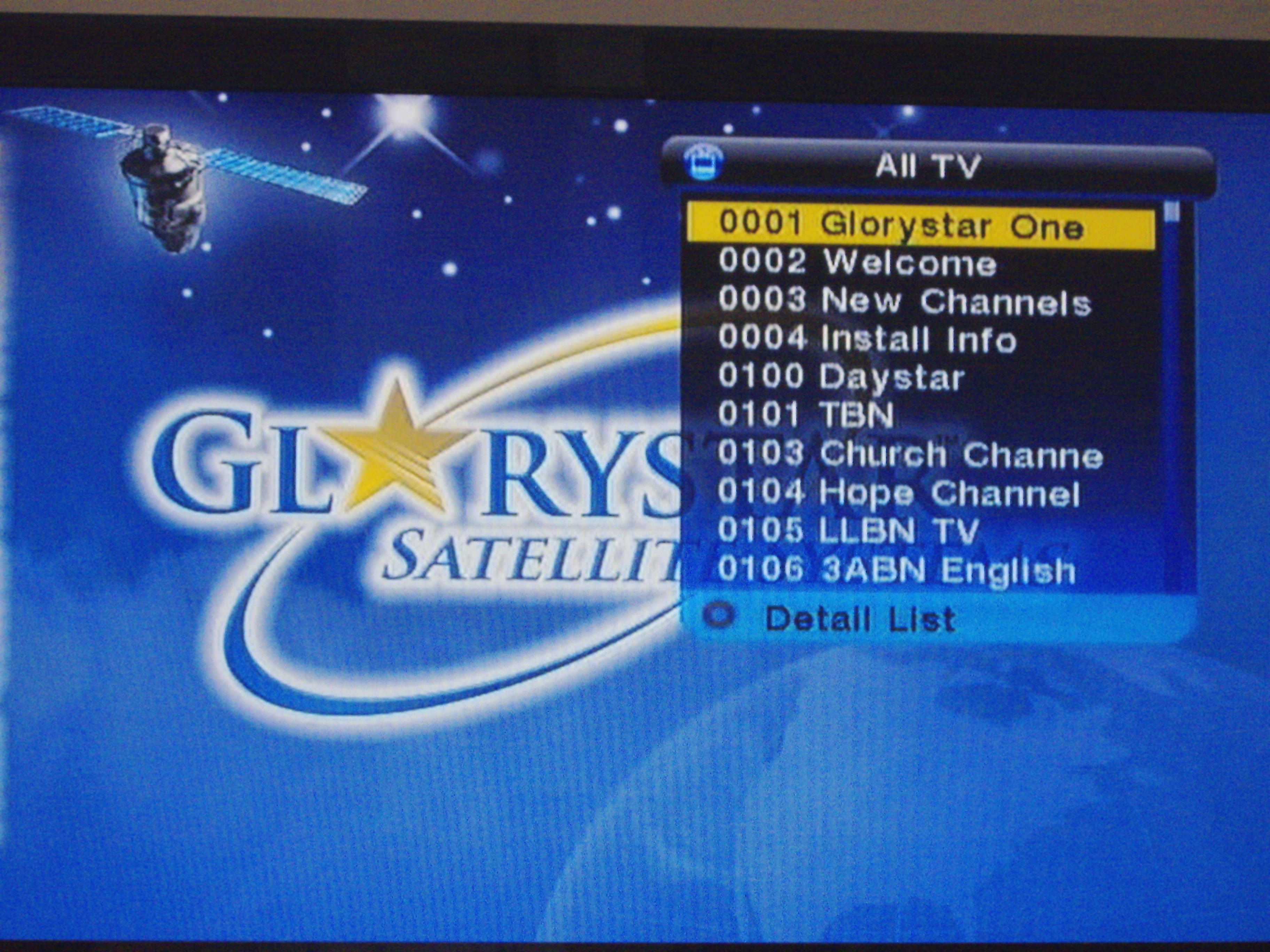

Since I had my dish pointed to 101W I said Adventist. It asked me for my time zone and that was it. The receiver automatically loads the Glorystar approved channels into the unit and sets the correct time. That's it. No loading channels you don't want. No looking up frequencies and scanning. Set it up and that's it. I then did a master reset which brought me back to the main setup. This time I selected "Glorystar" setup. Once again all the Glorystar approved channels were loaded into the receiver and the settings were also corrected to. It defaults to 22k on for 97W and 22k off for 101W. Since my setup is different I had to go into the menu and turn the 22k off for 97W which is rather easy to do. For the Glorystar and Adventist setups there are 4 default channels

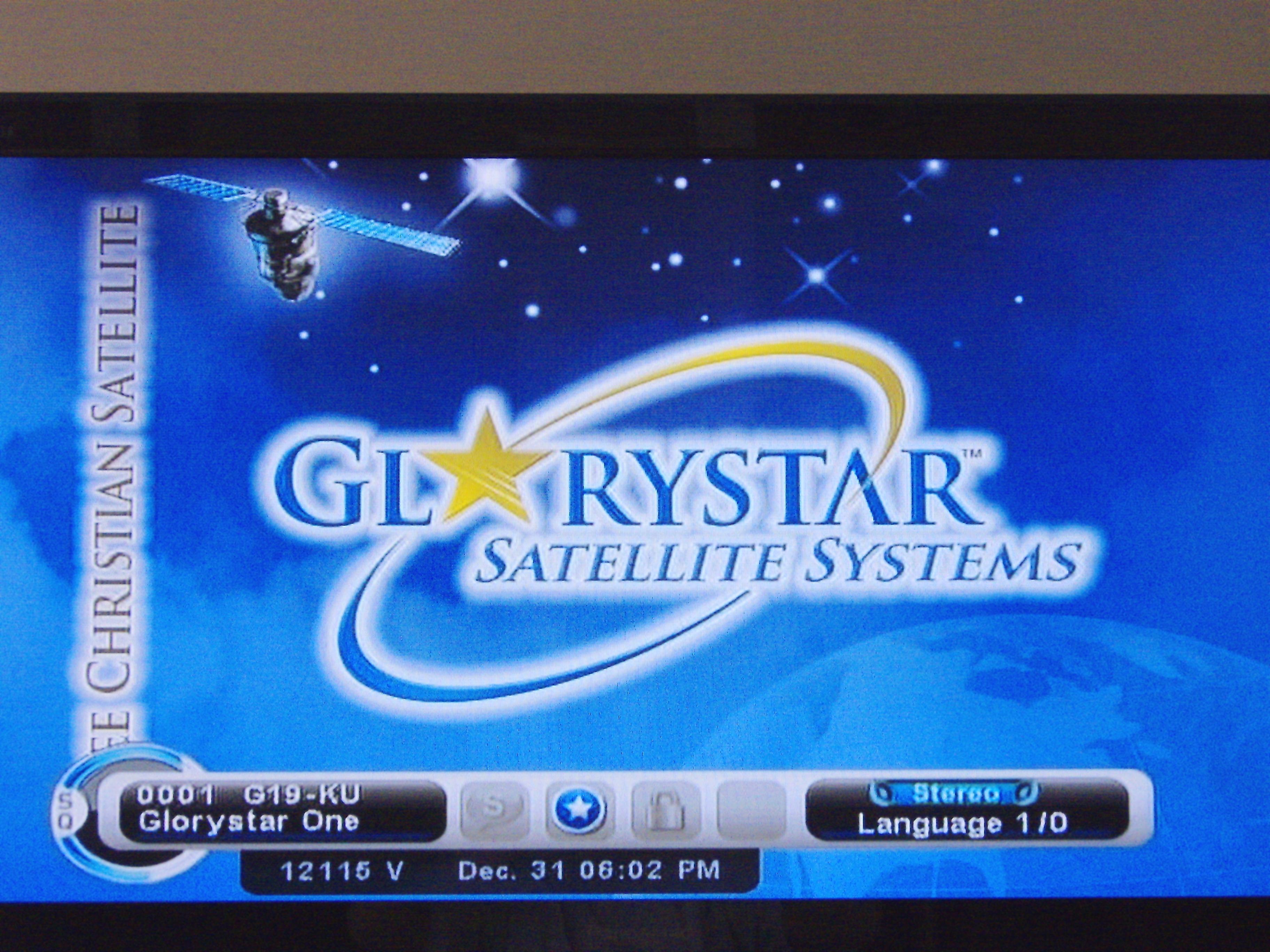

Channel 1 has the Glorystar logo

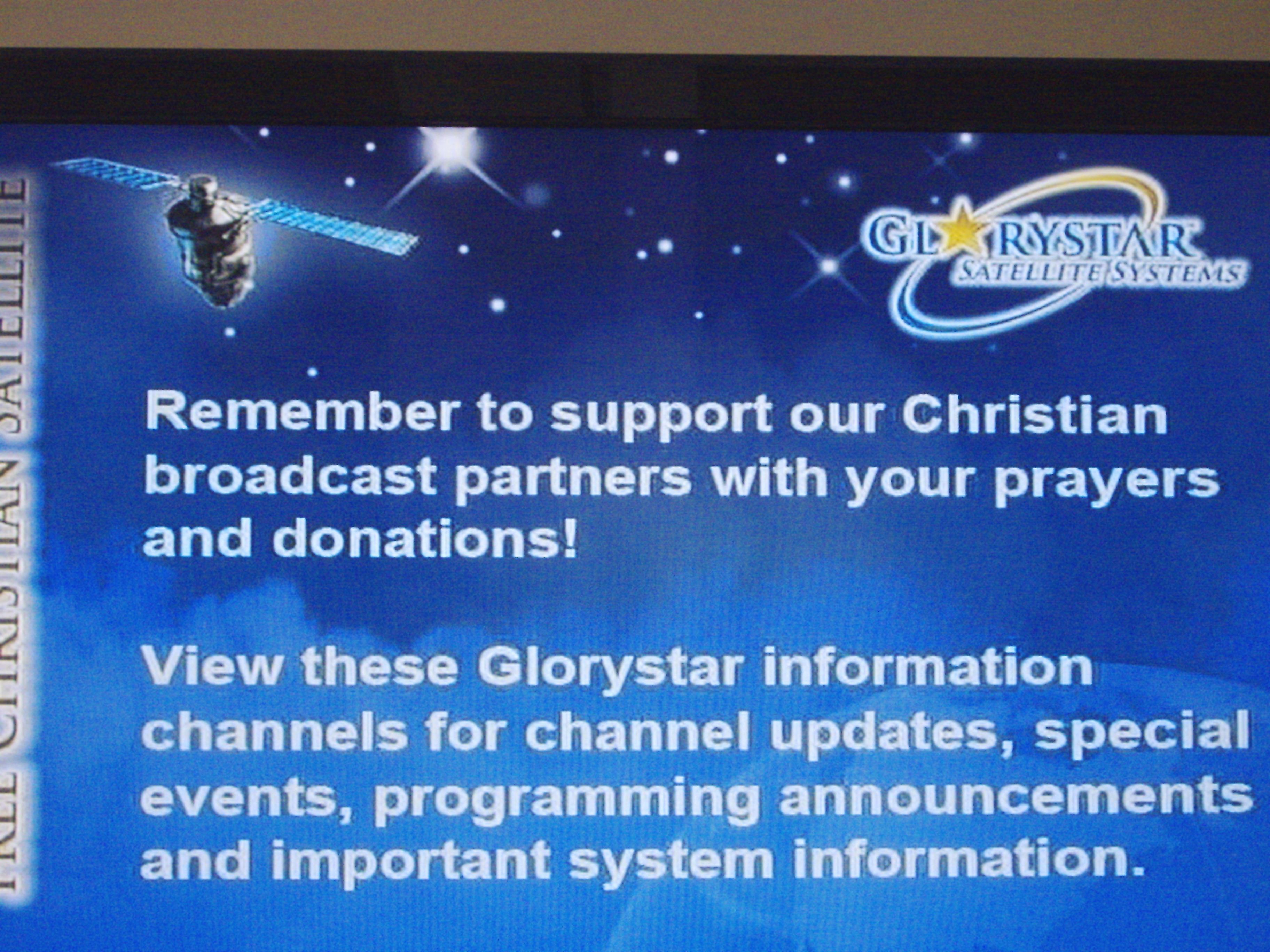

Channel 2 is a message from Glorystar

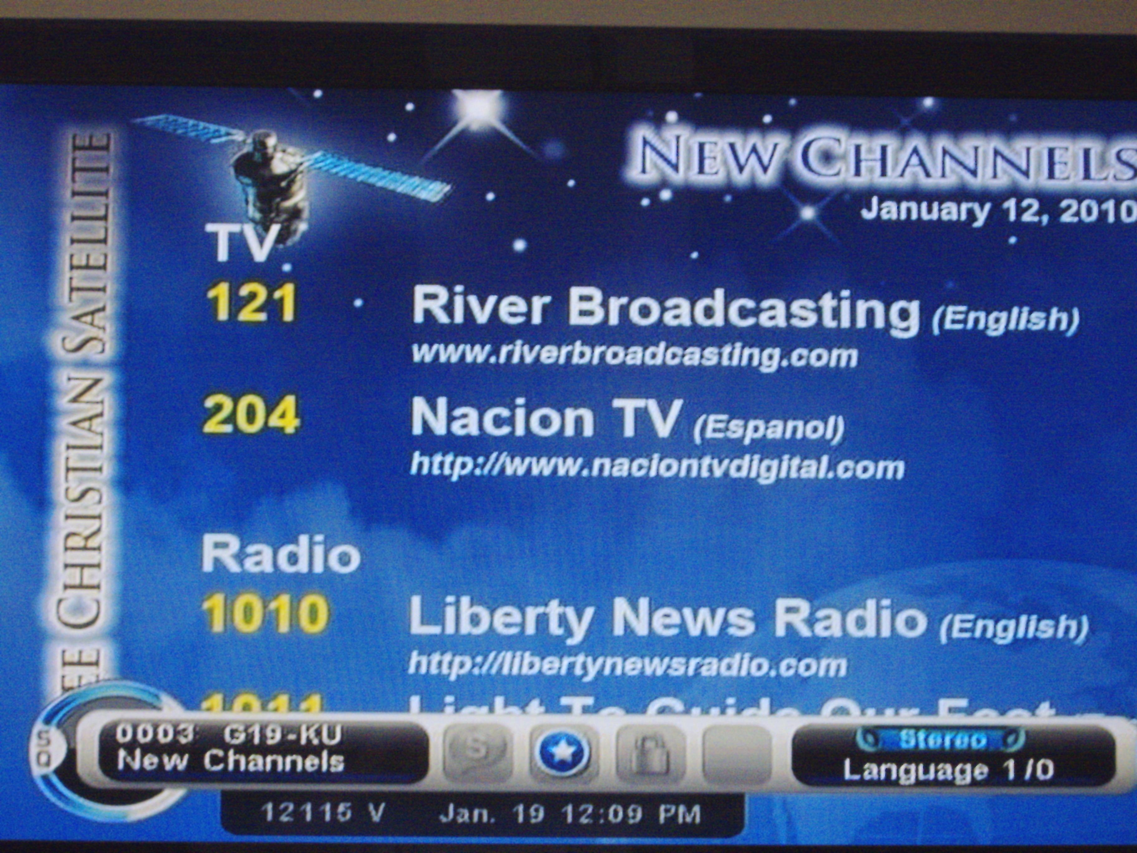

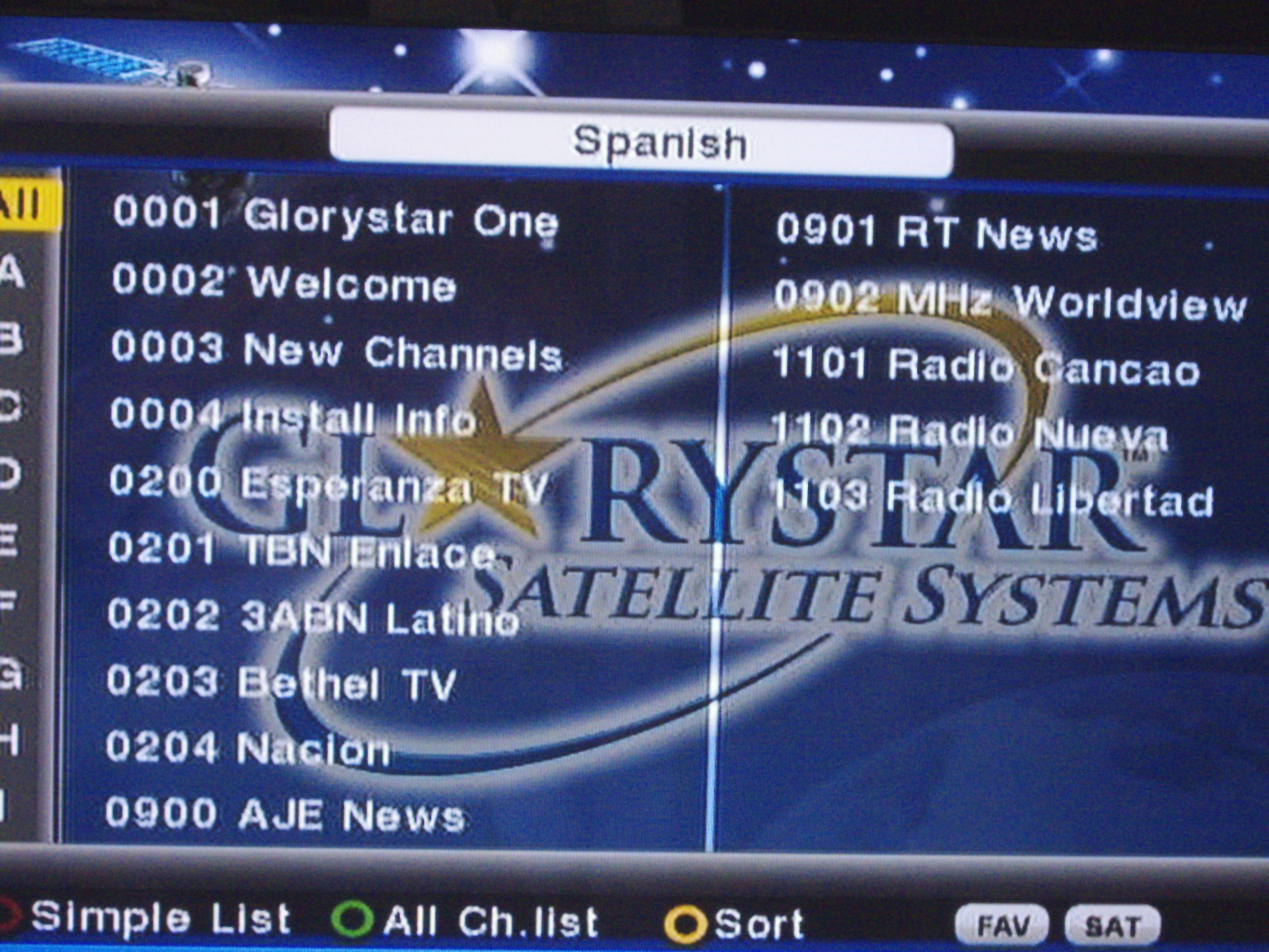

Channel 3 shows the new channels added. This is a great feature for the Glorystar folks in my mind.
Channel 4 talks about finding an installer

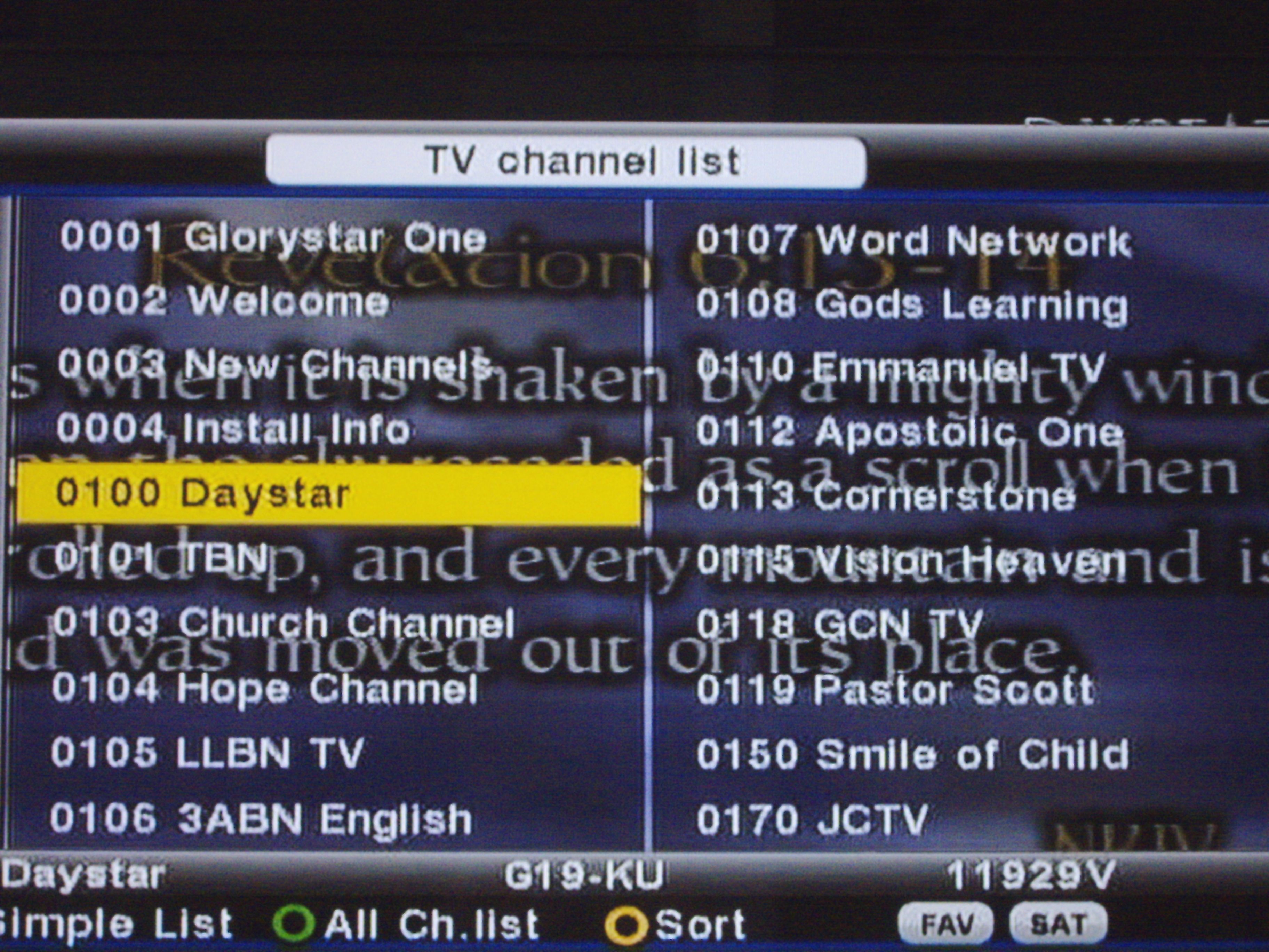

The channels start at 100 and the radio channels are at 1000. There is no TV/radio option which is a good thing. Just go to channel 1000 and there is your radio channels.

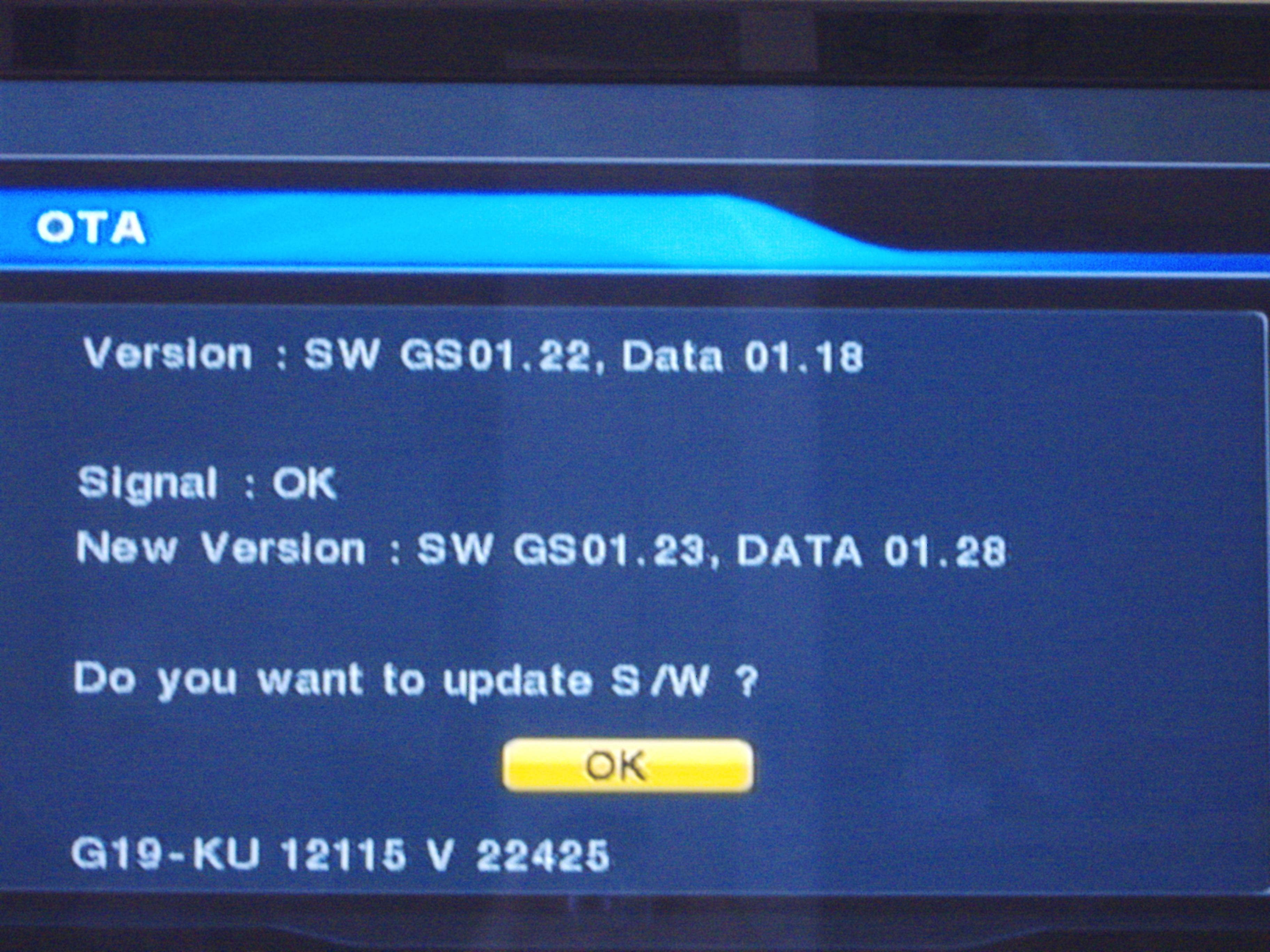

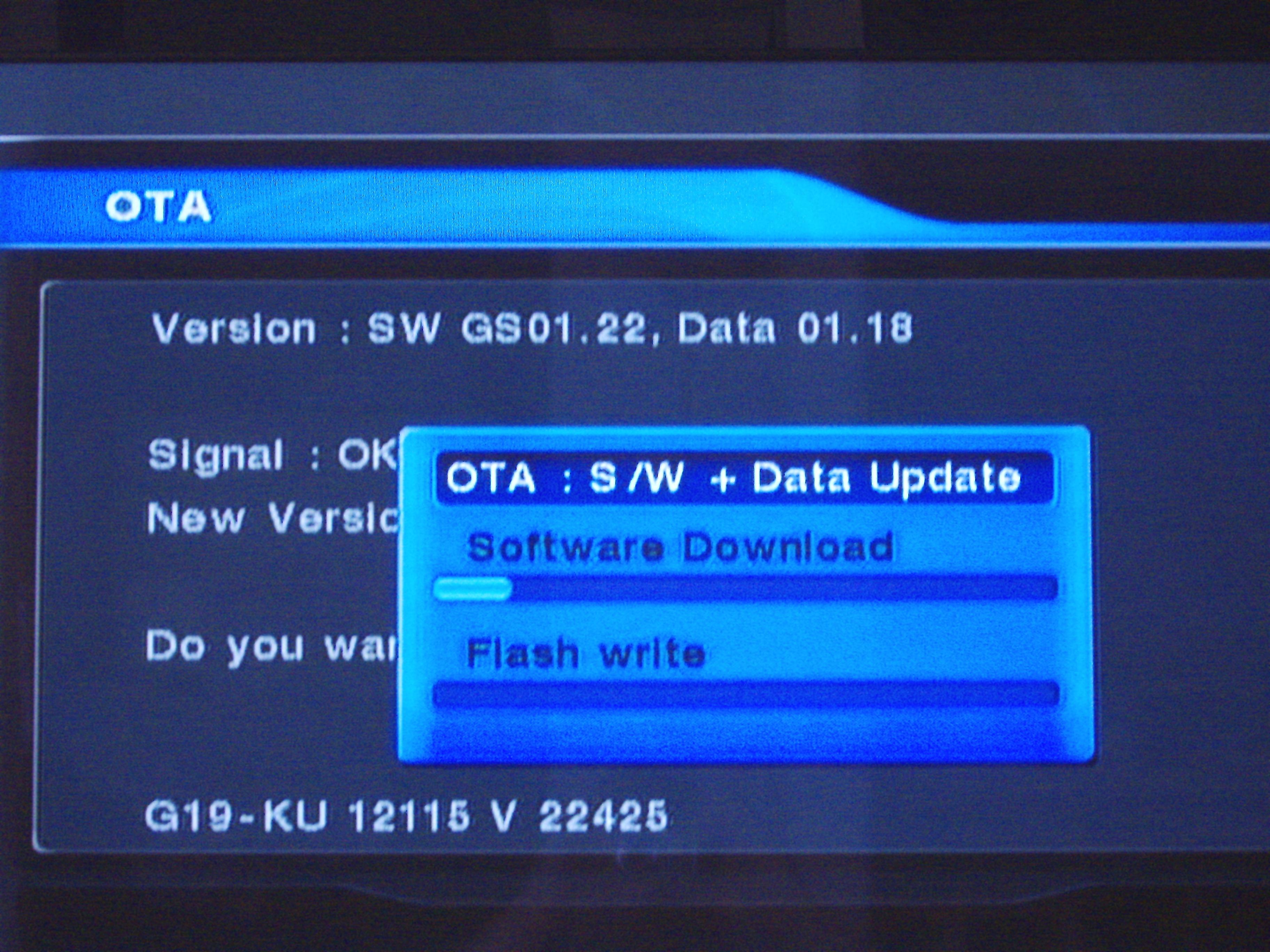

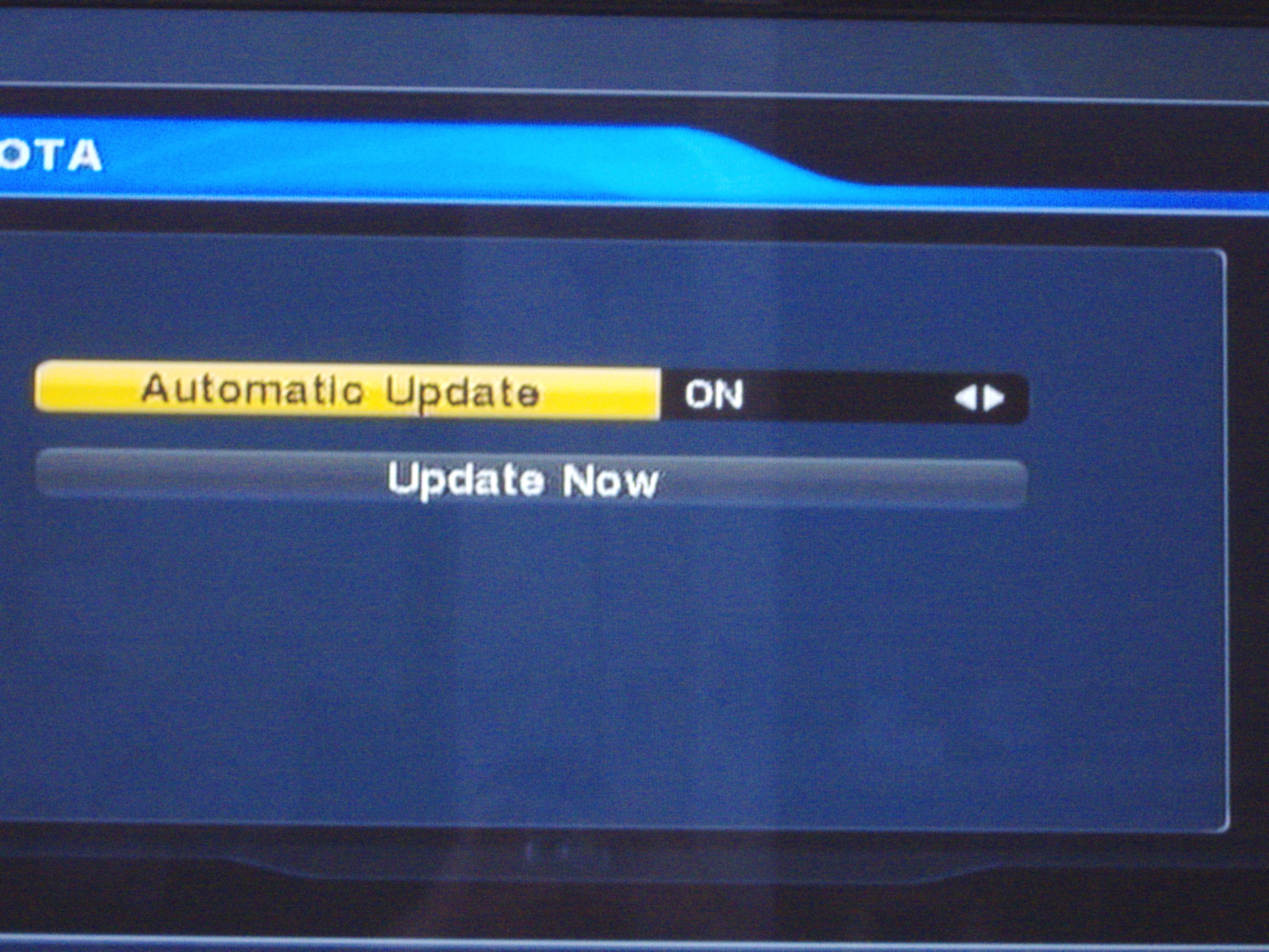

One of the neat things is if there is a new software out there you don't need to download it from the computer and load it into the receiver. You select OTA and it checks for new software. If there is new software out there you can download it directly from the satellite. I did update the receiver with the newest software and when it was done the receiver reboots. Said I had "Glorystar" setup and it downloaded the channel list again. Now the receiver does load a couple of the news channels on 97W but if you want more than that, you can go into the menus and rescan a transponder or the whole satellite. Just a note that if you reset the receiver and select Glorystar it will only load the Glorystar approved channels. You would need to rescan the other channels in.

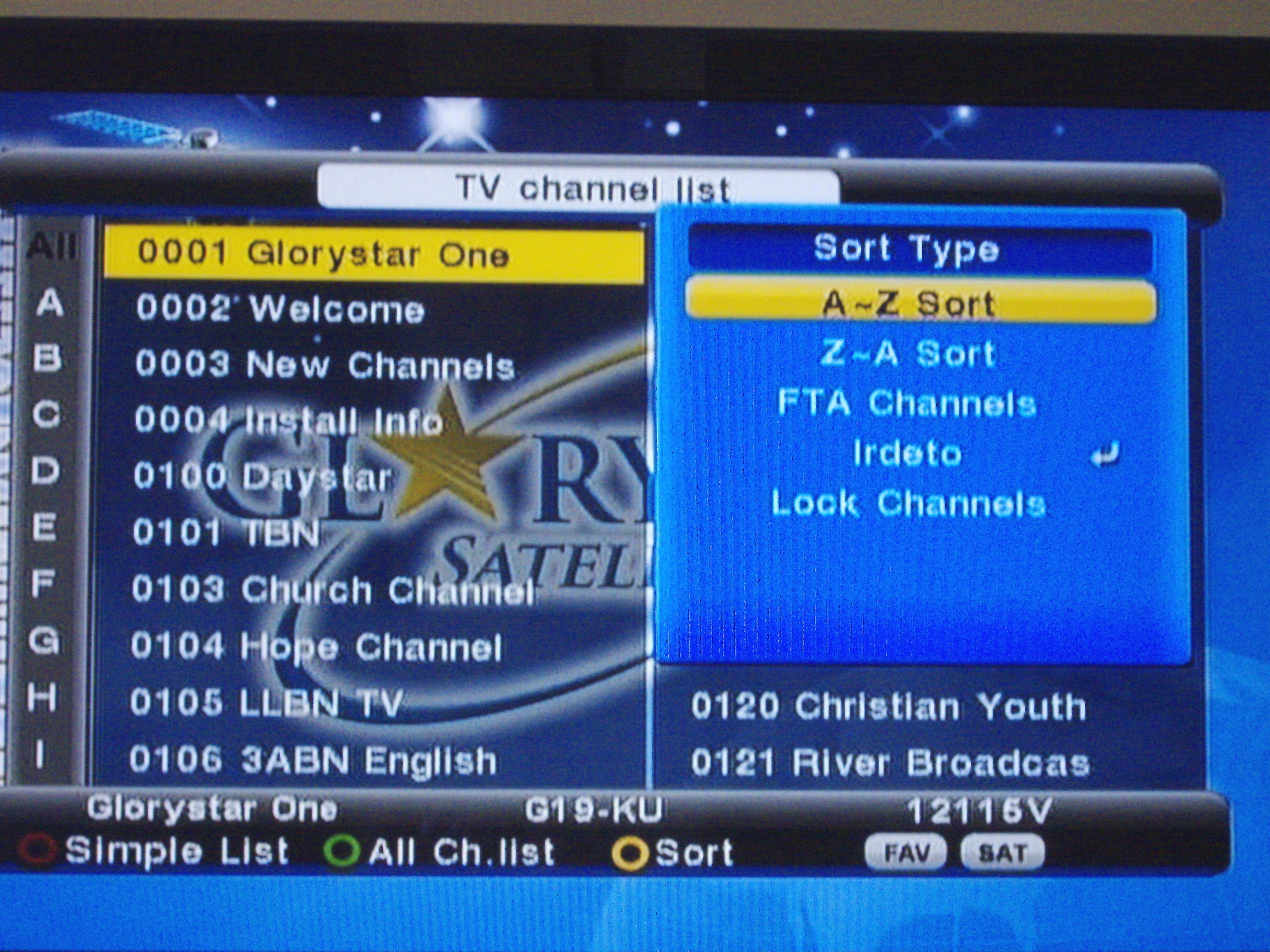

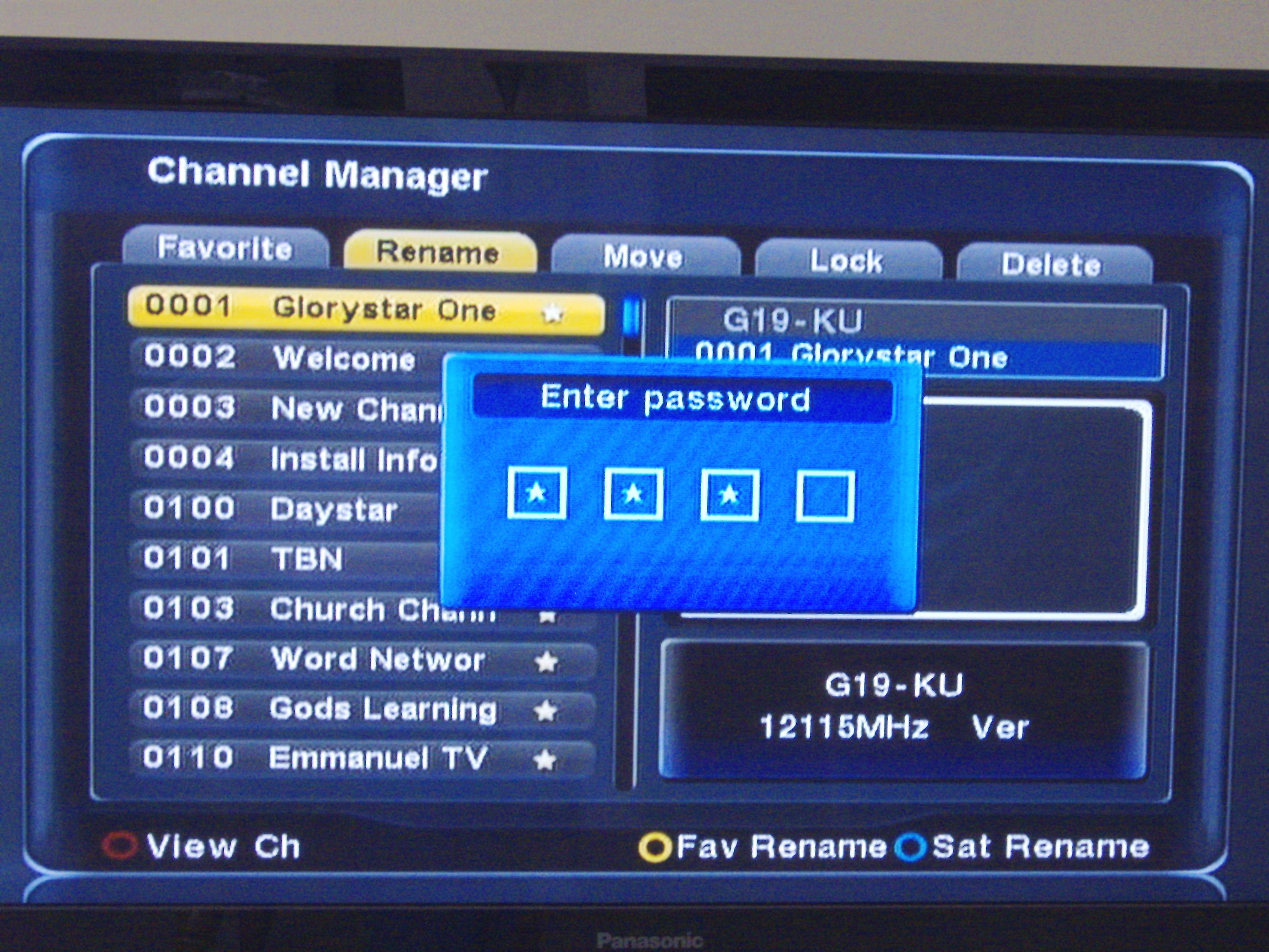

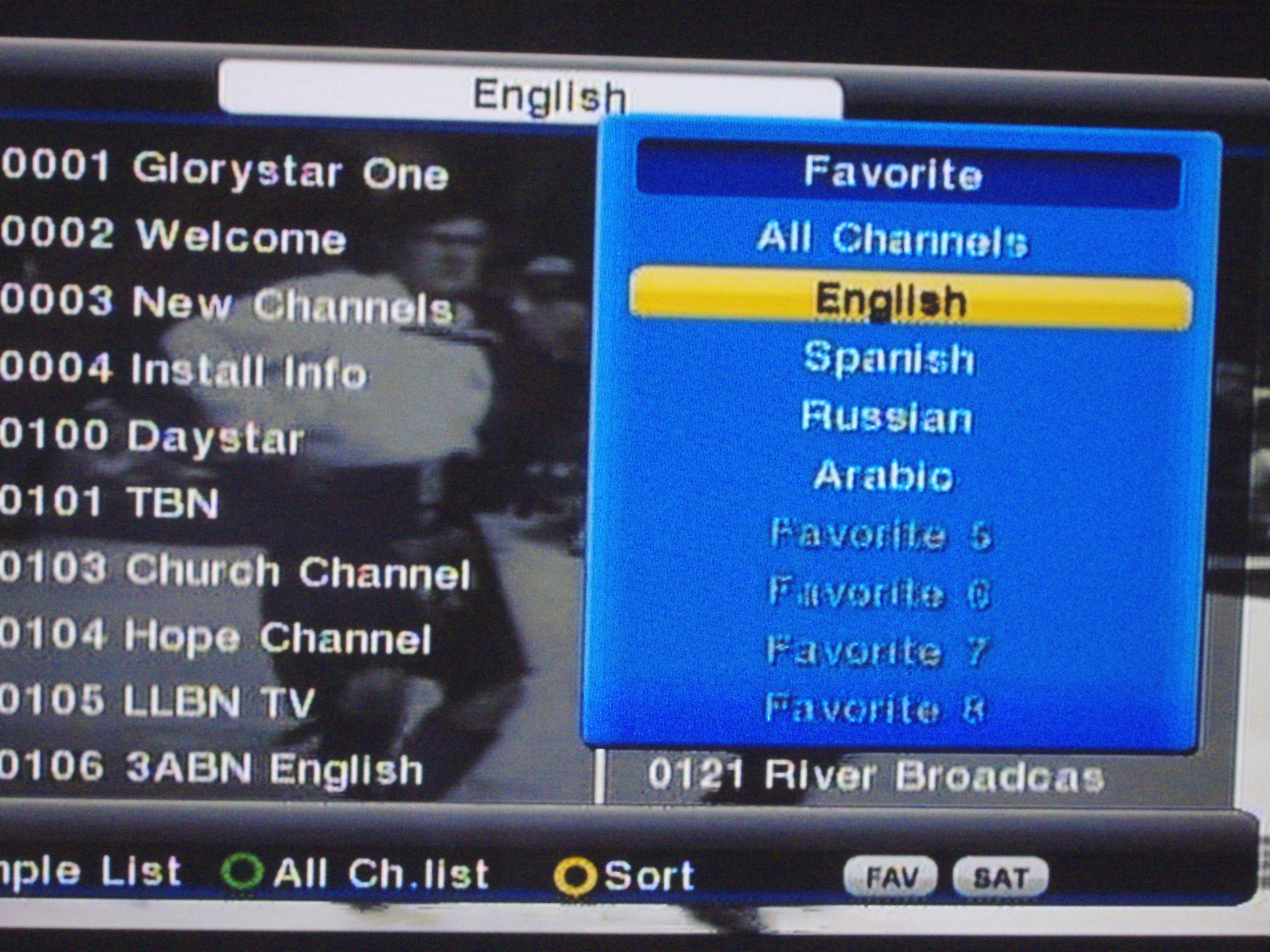

The channel list is thought out very well. Press a button and you have a few options. You can sort by a-z, z-a, or free to air only channels. You also have an option of having a "short list" of the channel guide. Normally when you bring up the channel list it fills the whole screen, you can press a button that shows "simple list" which shows 10 channel list in the corner. There is an option in the Glorystar or Adventist setup that allows you to set up a favorite list to show only the channels that have the language you want. So if you are like me and don't want any Spanish channels you can set up a favorite to show just the English channels. Other options are Spanish, Russian and Arabic.

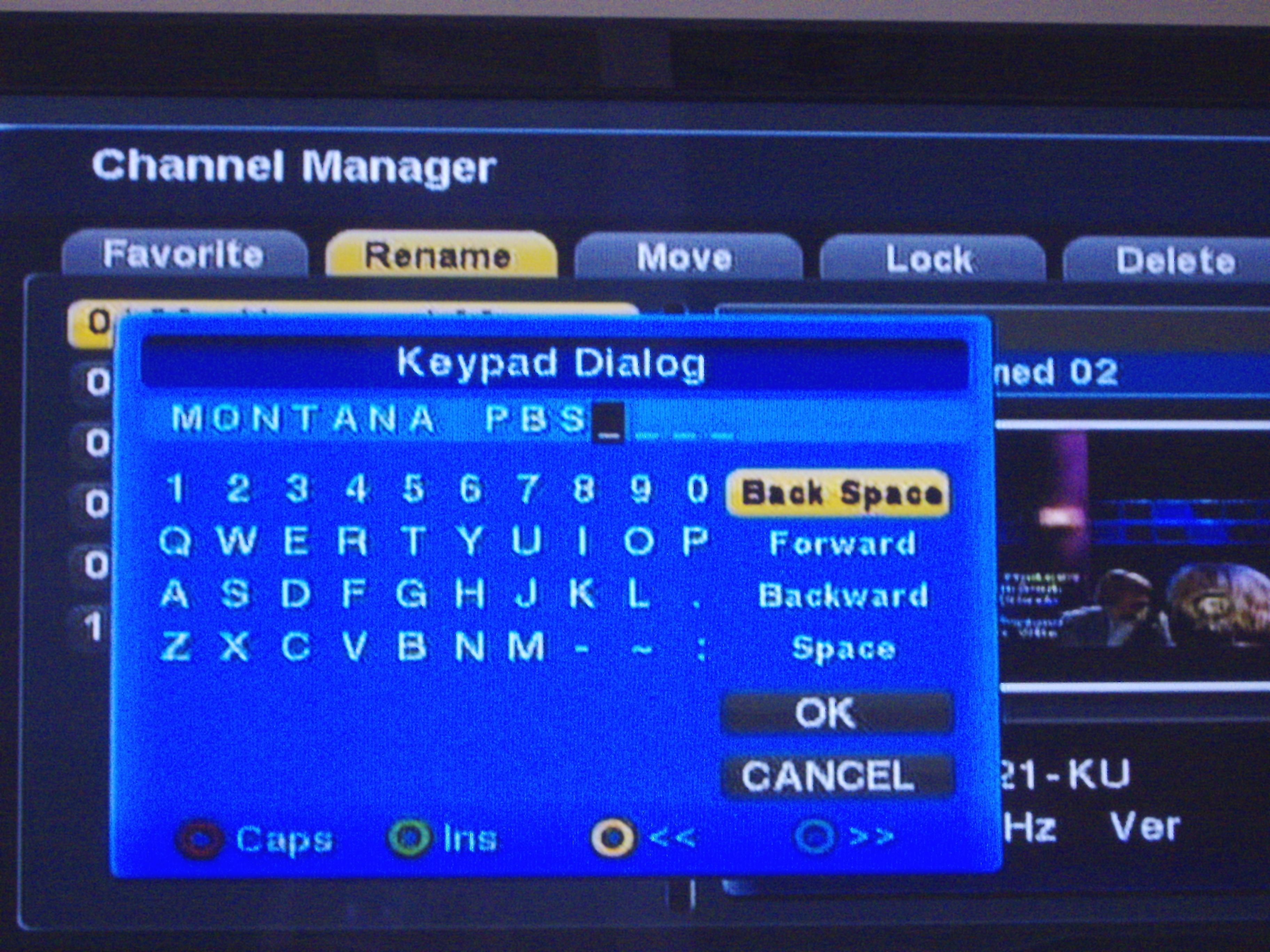

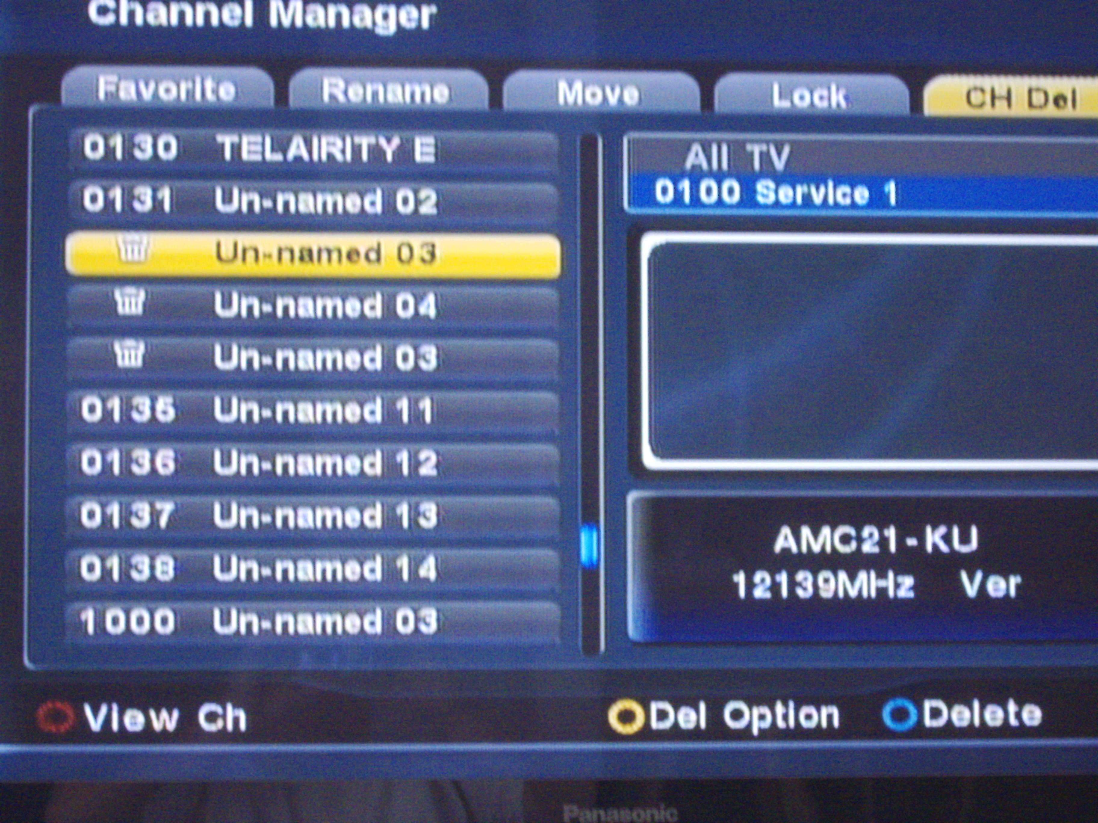

Editing and deleting channels is a snap. You can rename channels, move them, or delete by channel, sat, or transponder. I like if you say "delete TP" it will delete all the channels on the TP. But lets say you want to keep one (a good example is Russia Today. Its on a TP with a bunch of Arabic channels) you change the setting to "delete CH" and undelete the channel. One button deletes all the channels you want deleted. If you don't want to use the remote, the channel list is ChannelMaster compatible. There is a USB port on the front of the receiver for easy download and upload of the channel list.

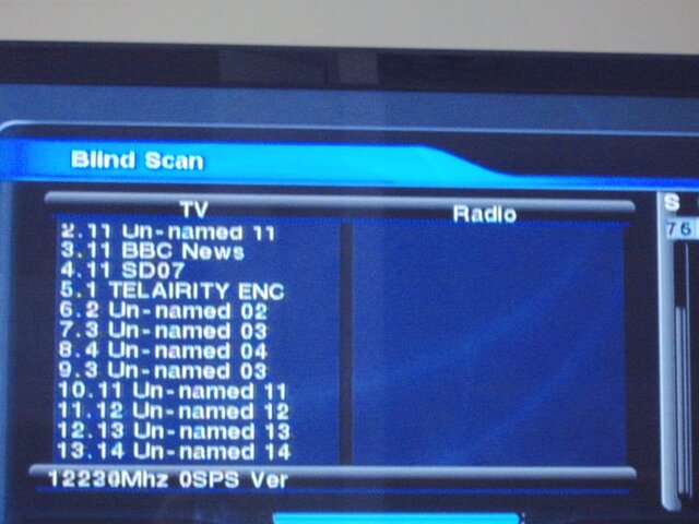

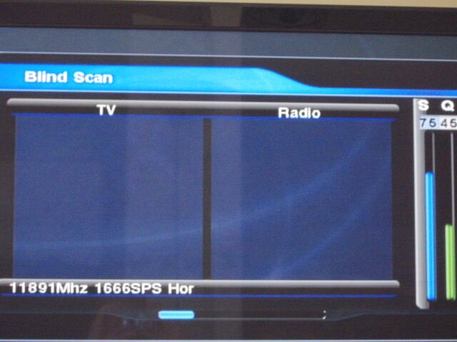

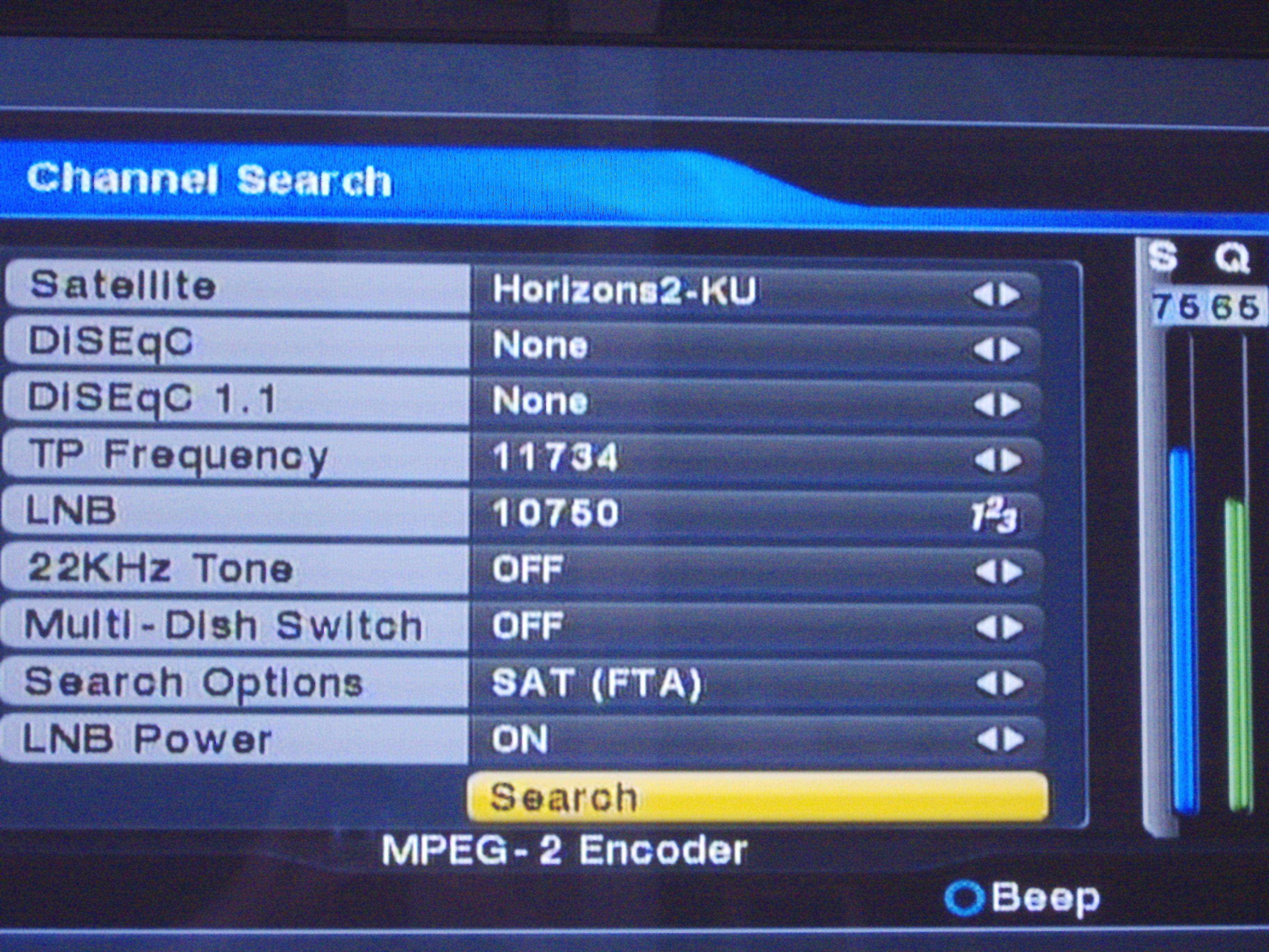

Now the fun began. The receiver is made for Glorystar folks but how will it work for the "hobbyist" who wants more than that? Did a Master reset and selected "Hobbyist" where I was brought to the main menu. I went to setup the satellites and it asked for a password. One good thing is you can turn this option off (to ask for a password every time you go into the setup. The satellite list is in order from east to west except for 97W. it's the 1st one on the list. The settings and options are very easy to go through. No hidden menus to change settings. If you go to the transponder frequency you press one of the color coded buttons for easy access to the TP list. This is a great feature as most receivers I work with you have to exit out of the dish setup menu to get to the TP list. You can add, remove or edit TP's rather easily. The receiver supports both Diseqc 1.0 & Diseqc 1.1 for the hobbyist who has a 8x1 or larger diseqc switch.

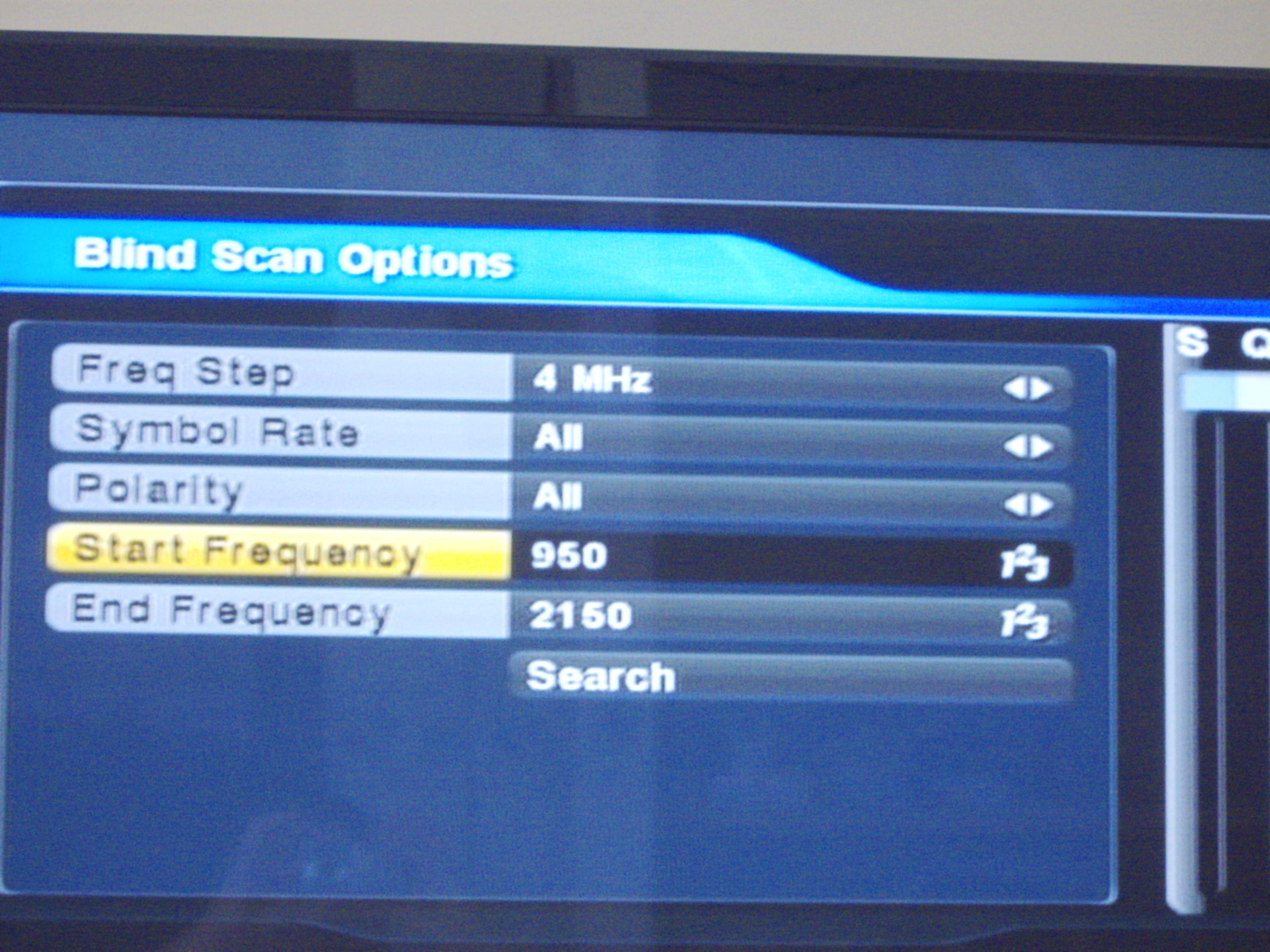

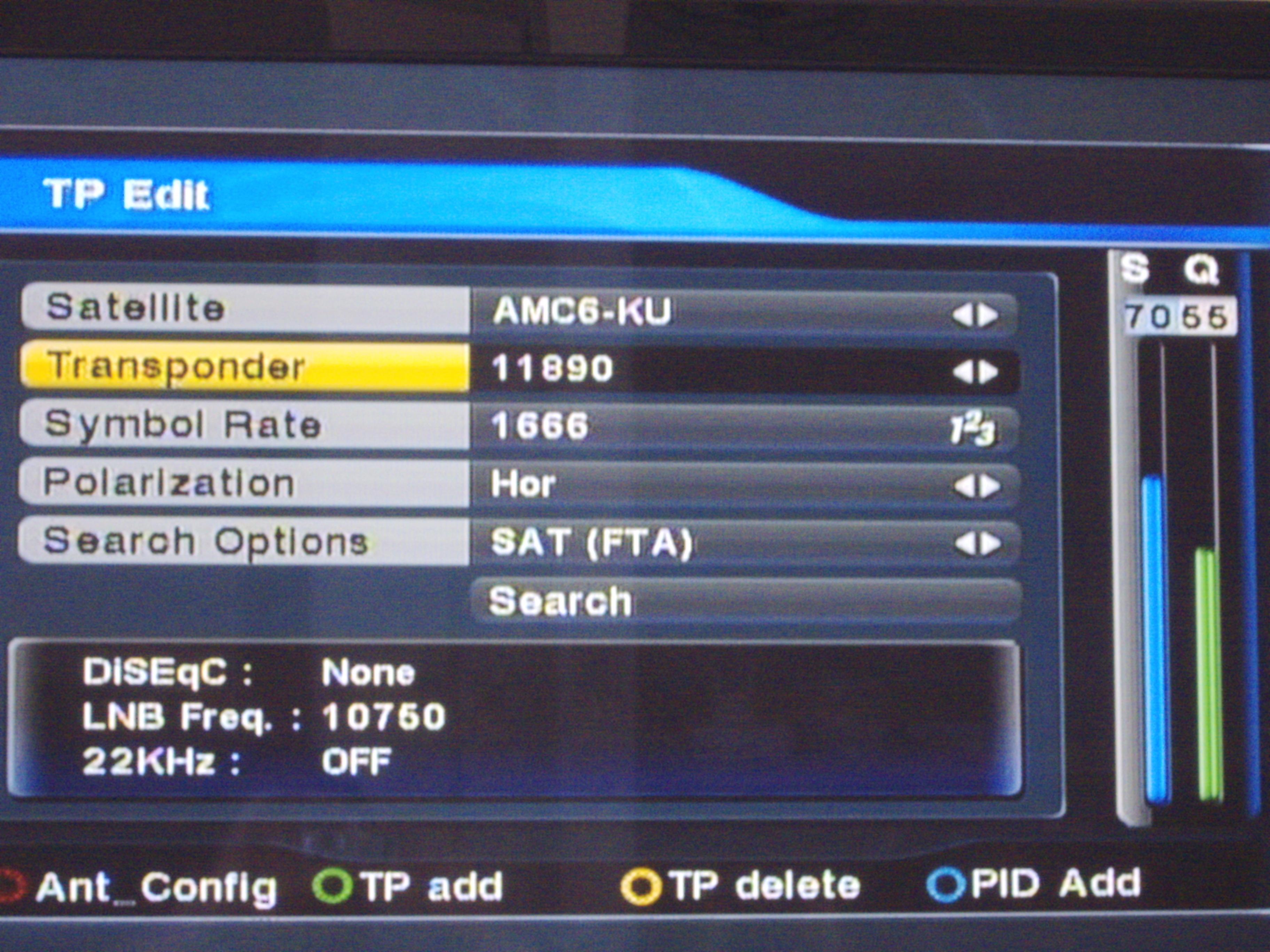

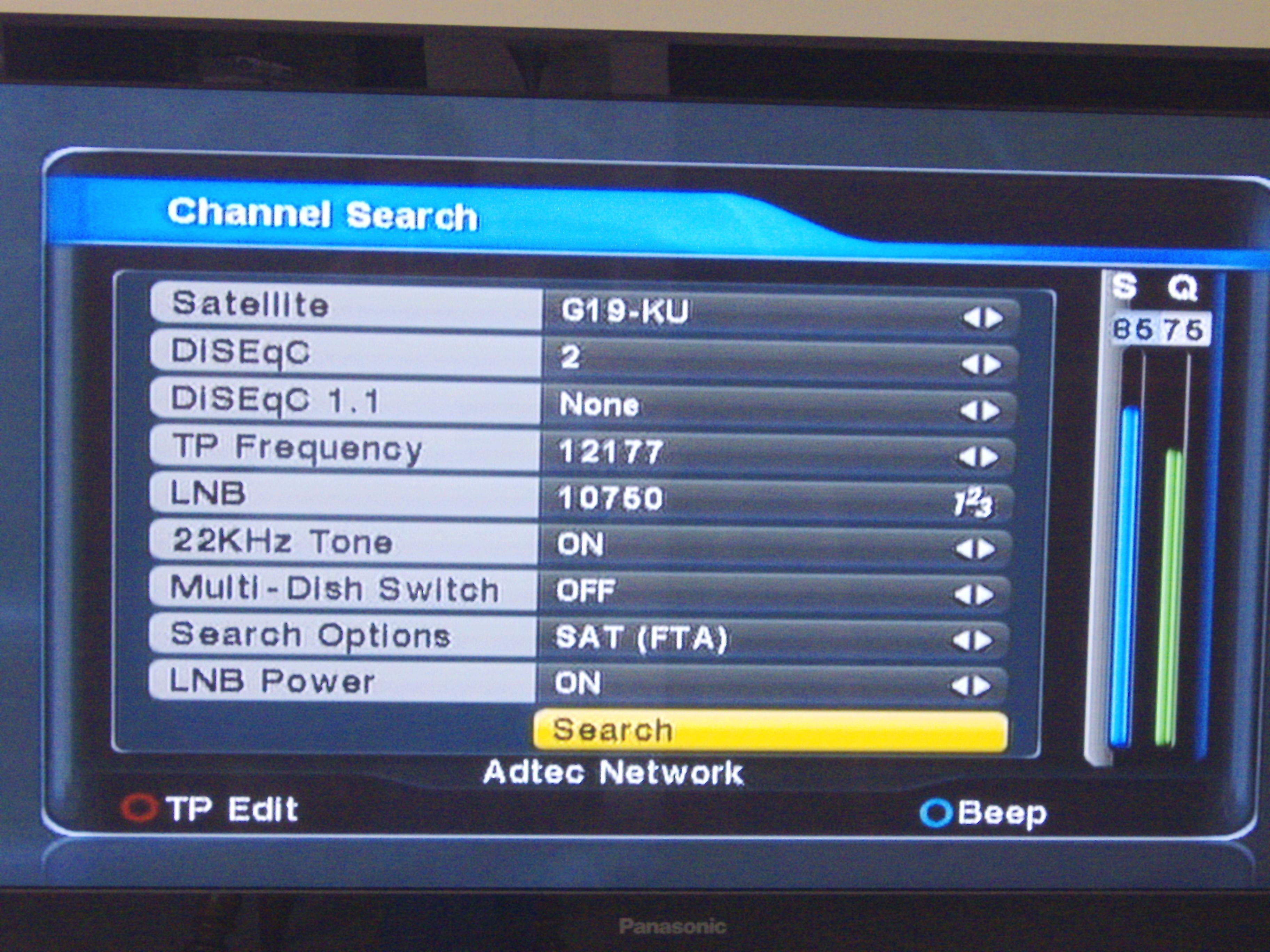

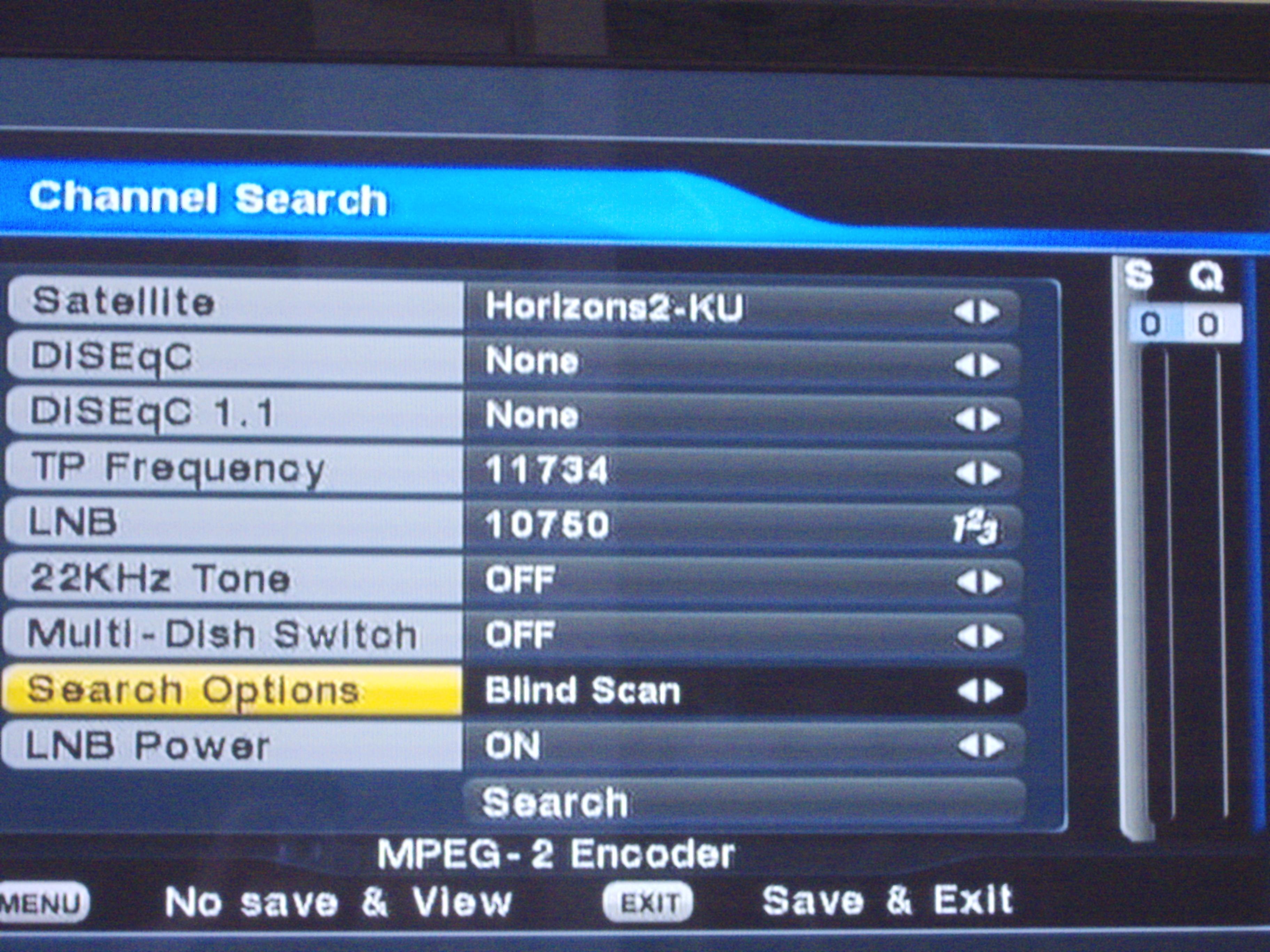

So I set up the receiver for a couple sats I have setup. The TP list is pretty current but I decided to do a blind scan. The blind scan has numerous options
Freq step can be set to 2,4,6,8,10. The lower the steps the more thorough it is but the slower the blind scan will take
Symbol rate can be set for under 4000, 4-8000, above 8000 or all. I leave it as all
Polarity…self explanatory
You can change the start and end frequency. It lists the frequencies by IF so it shows 950-2150. This is a minor drawback as a standard LNB only sees 950-1450 so you would have to change this to 1450 every time you scan a KU LNB. SatelliteAV is aware of this and has assured me they are working to change it so the default is 950-1450.

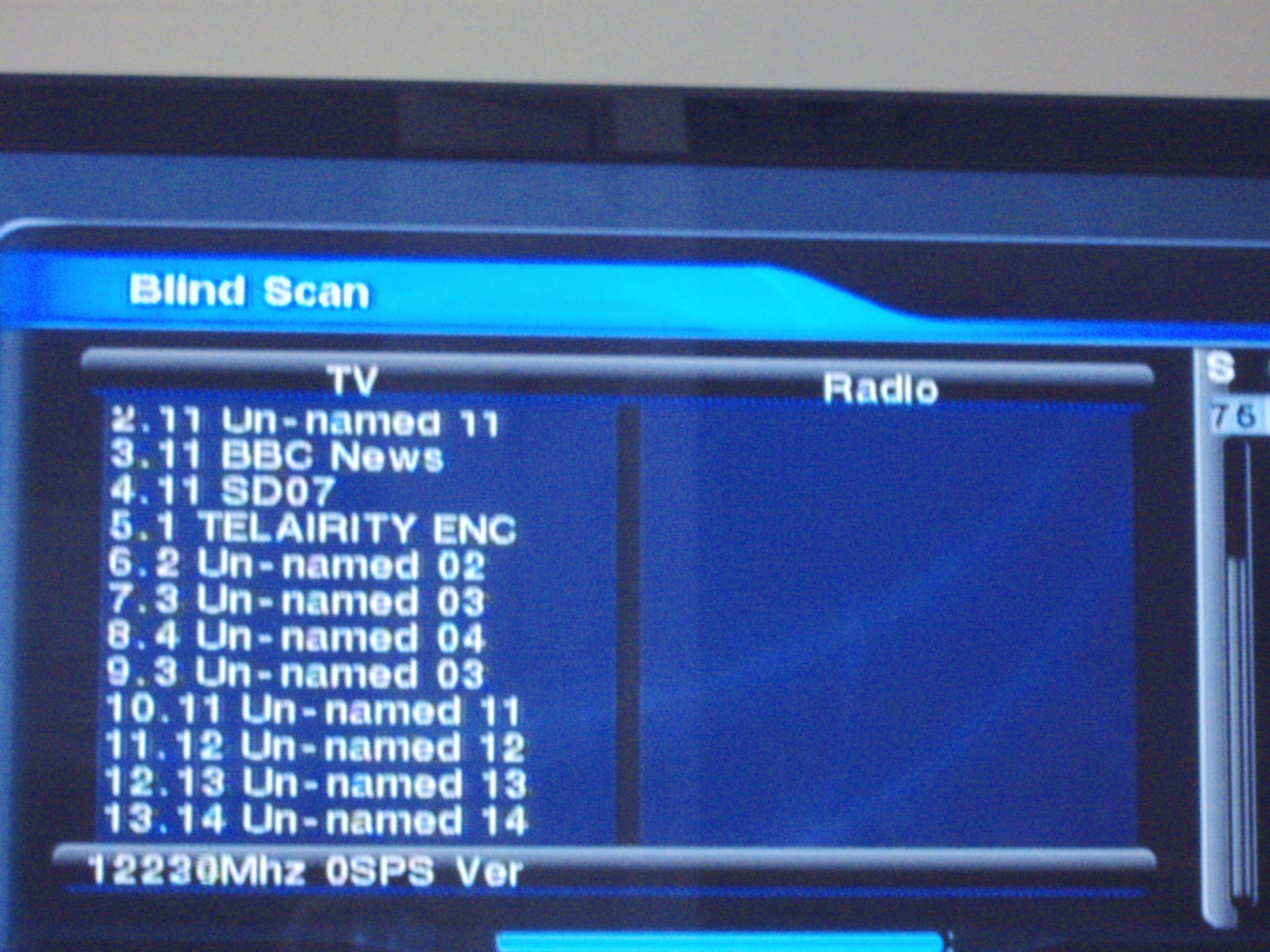

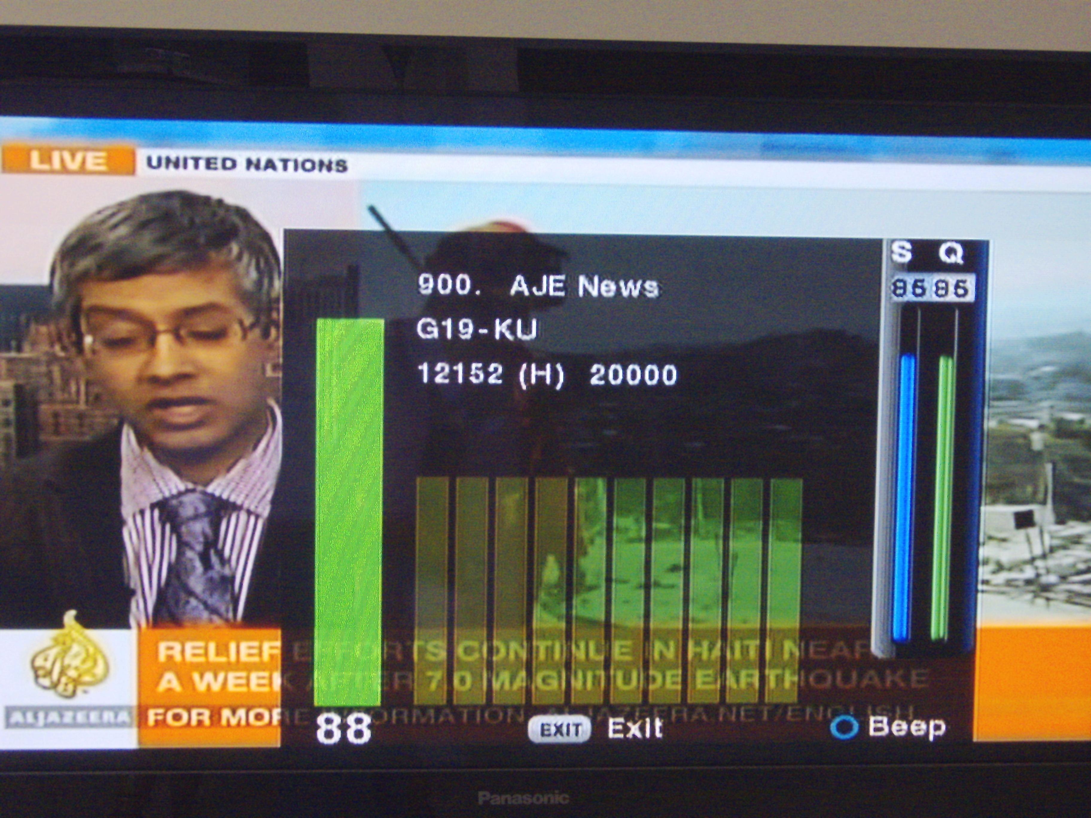

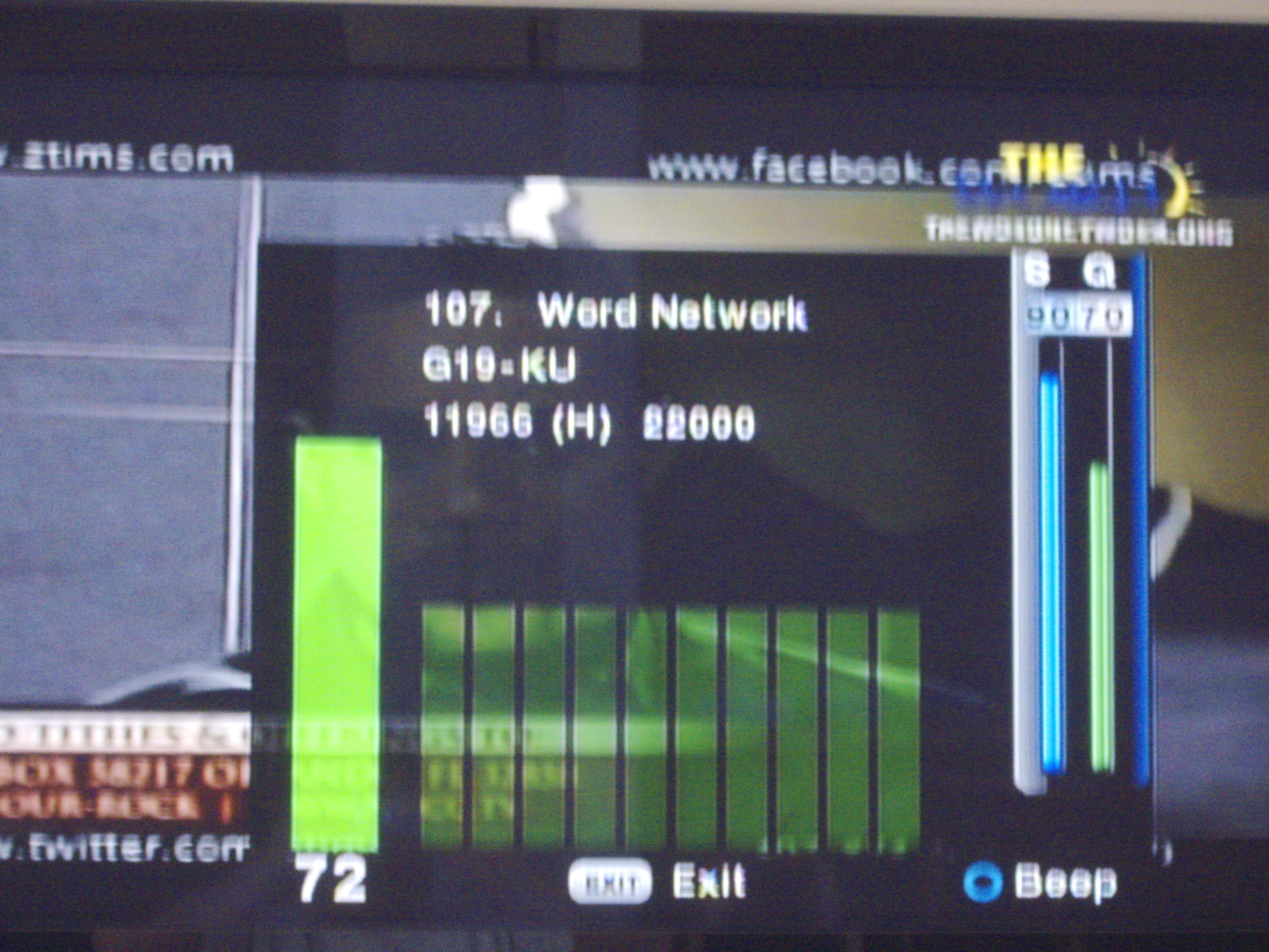

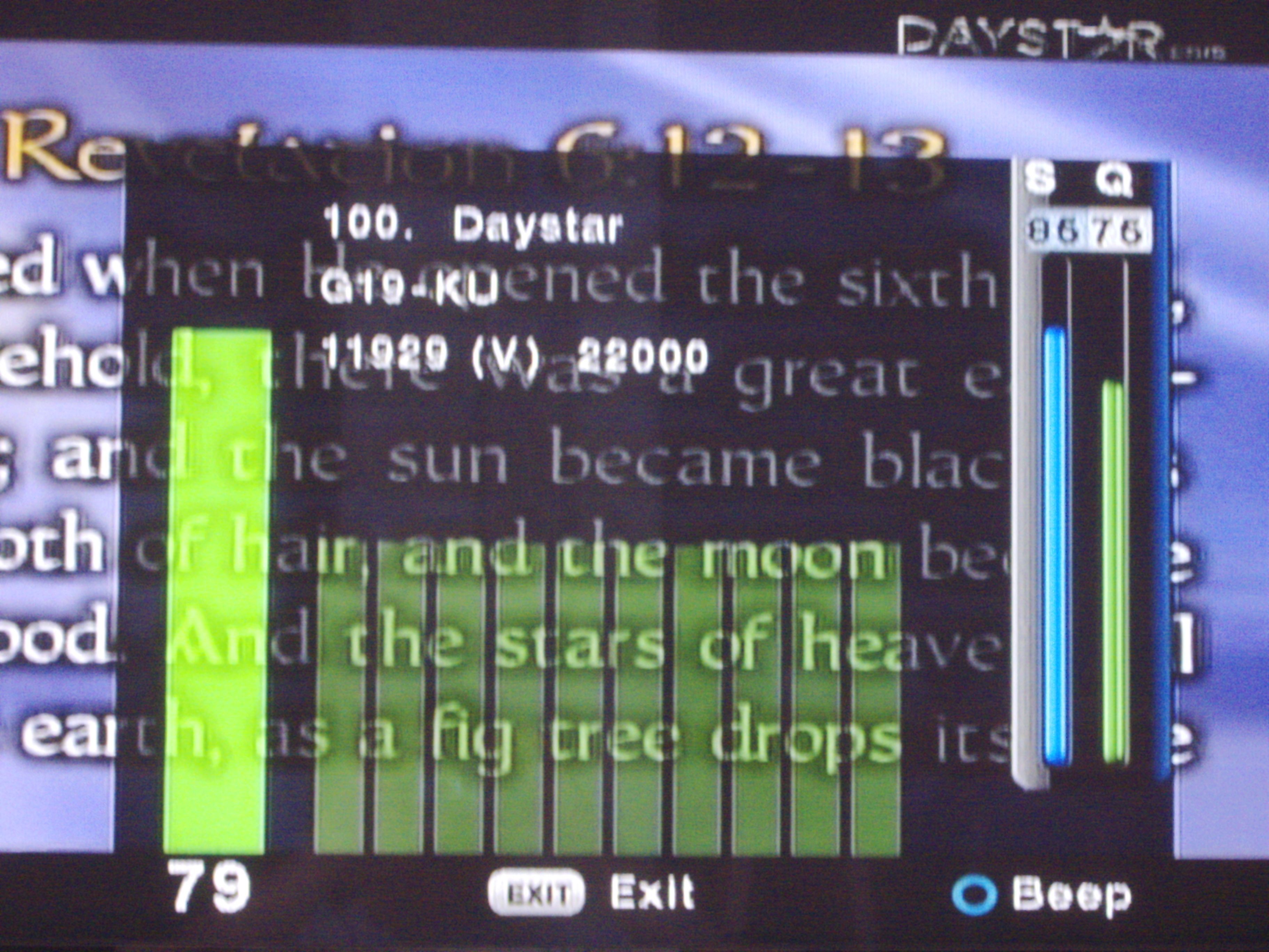

I blind scanned a few satellites with the settings at 6MHz and was very impressed at the thoroughness of the scan along with the speed. Now I'll tell you this isn't as fast as my Coolsat but it's a lot more through. A blind scan on a normal satellite takes about 45 seconds to maybe a minute longer than a Cooslat but the Geosat picks up TP's that the Coolsat misses. I tried the infamous KFTL on 72W which is at a 1666 symbol rate. Coolsat even on detail misses it. Geosat picked it up every time I blind scanned. It seems like the blind scan is like a bloodhound. It finds the feeds other receivers miss. It picked up KTEL on 79W with the s/r of 2170 no problem. I blind scanned 103W which has the funky skew. My motorized isn't compensated for that so normally I grab 1 maybe 2 of the NBC feeds and the usual others like Pentagon. A scan on the Coolsat brought 2 TP's, Geosat had 9. A few days later I used this to blind scan the C-Band arc for an update to thelist and was very impressed. It found channels that I had never seen before and apparently had been there for a while. The threshold of the meter is very low. Many channels that read low signal the other receivers will pixelate. I found a few channels that the quality meter was low but the Geosat played it just fine. I did notice one item when blind scanning (or any type of scanning for that matter). If the channel does not have a name the GeoSat seems to take a while to log the channel. I know the Coolsat takes about 5-10 seconds to log these type of channels. The GeoSat takes about 30 seconds. So when you scan in 125W it does take a while since most of the channels do not have a name. It logs them as Un-named 02, 03 etc. Even though the receiver does not do 4:2:2 or HD when you lock on a HD channel the receiver actually tries to play the channel. You get part of the channel to show up (just partial and it looks black and white and scrambled). The receiver will work with Dolby digital (AC-3) audio. Just hook up your audio decoder or Sonic Voom and you can hear the audio from PBS and other channels.

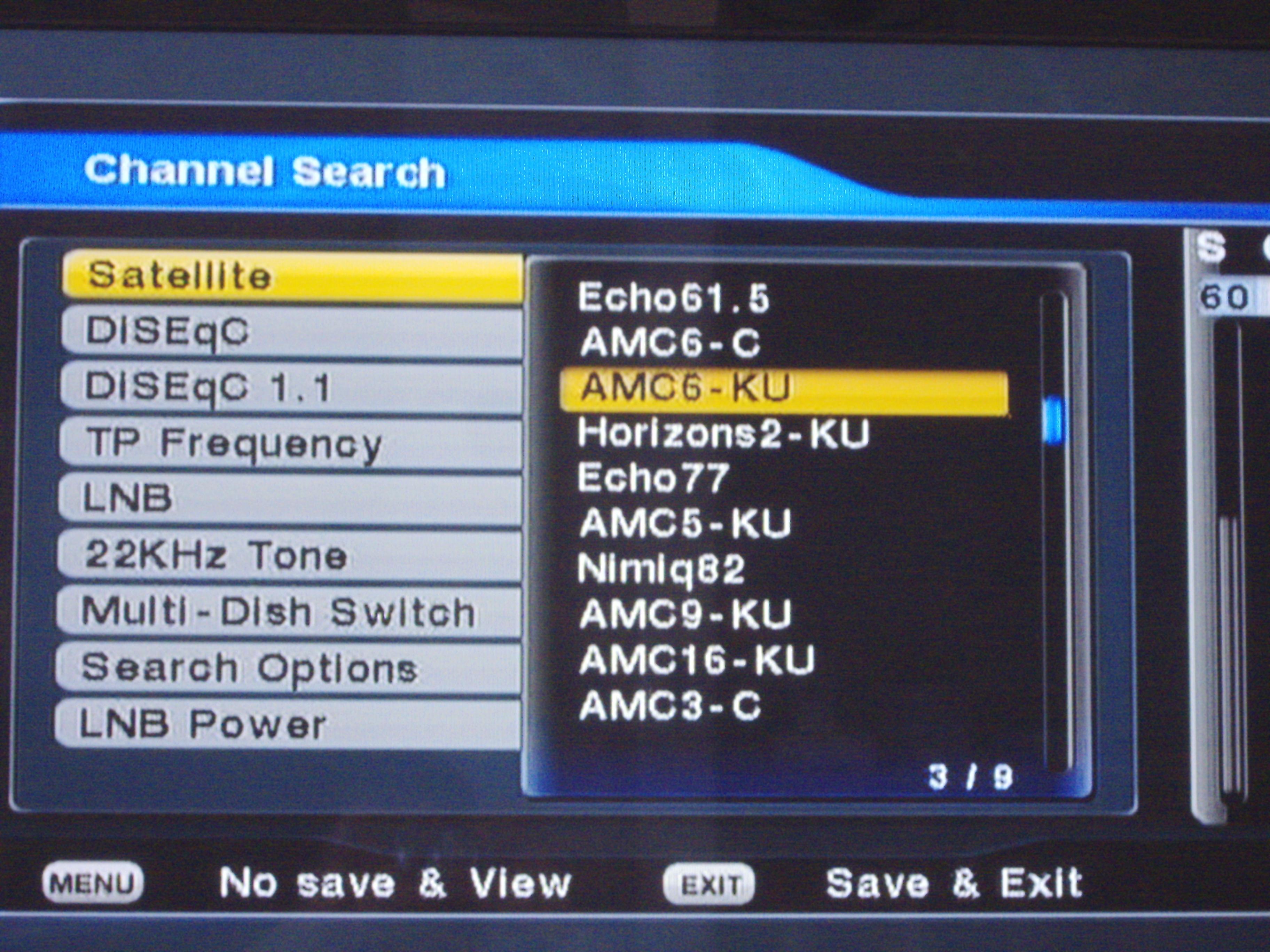

I hooked the receiver up to my motorized setup to see how well it works with a motor. I mean what good is a receiver if you cant motorize it? Well I am very happy that it works fine on both USALS and Diseqc 1.2. It is bang on even after numerous scans across the arc. You can even hook up switches for multiple LNB's and still use the motor which is something not every receiver can say. The meter is a very nice one. IN the right hand side it shows the signal in blue and quality in green. What makes it different is it also shows a bar graph if the signal fluctuates. This is great if you are aiming a dish. There is a beeper on there so you know when you are locked on the signal. Don't worry if you don't want that you can turn the feature off. As noted above, the channel list options are very easy to work with if you want to move channels around, edit channel names and delete channels.

Some of the reasons I love this receiver are the very thorough blind scan and the picture it puts out. As a feed hunter, I want to find all the feeds out there and not have a receiver that takes 10-15 minutes to scan a satellite. The picture through the component output is STUNNING! The S-Video/AV cables aren't too bad either
