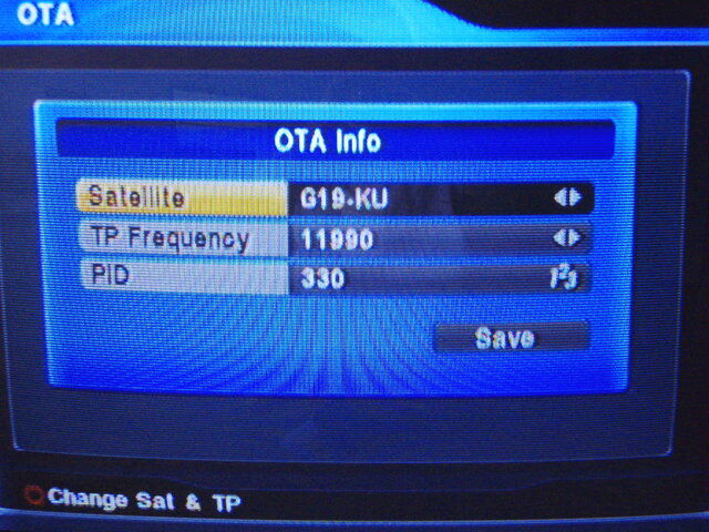

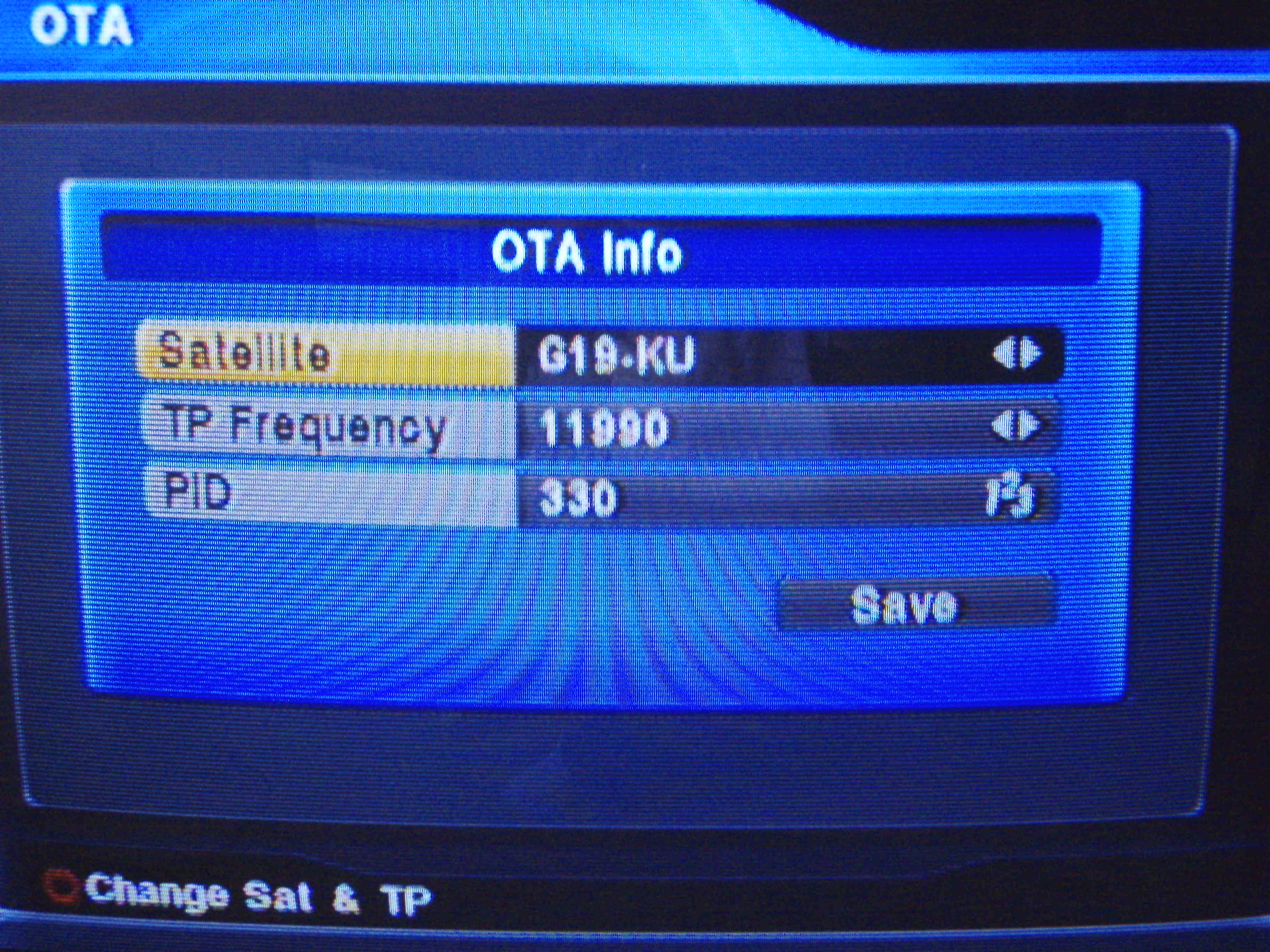

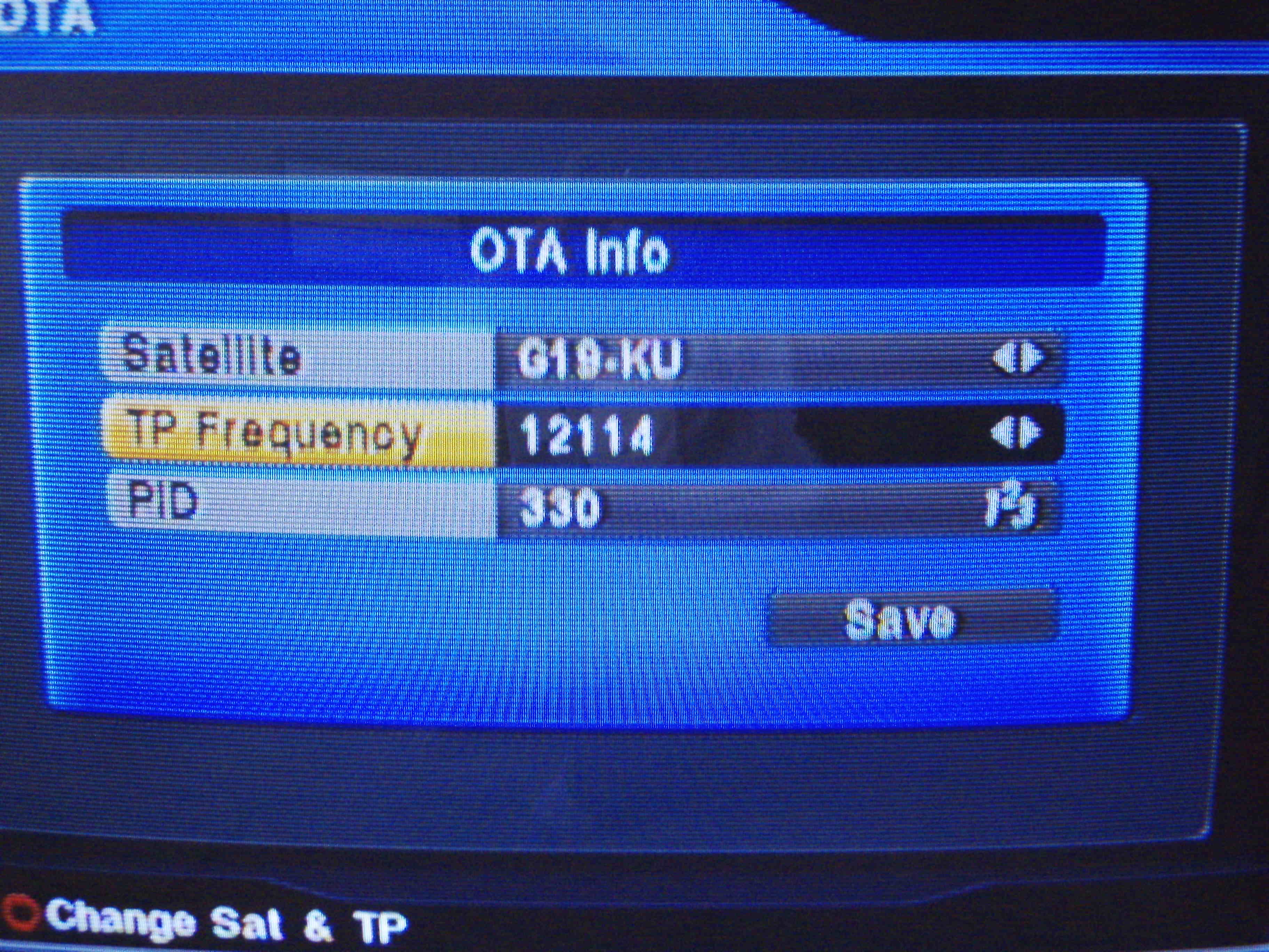

I'll try to explain better...when you got to the OTA screen it says "update now". In the bottom left corner there is a red button option. Press that and you get a popup screen. You can change the satellite, TP and sid to update the software. Per SatelliteAV the "defualts" are
satellite 1 (the 1st satellite in the list which is G19)
the 16th transponder (which unless you changed the TP info its 12115)
SID is 330 (dont change that)
you can scroll through the transponders to find the right one. It will only get software (on the 200) off G19 12115 TP

You're right, mine is a 1100c, thought they were the same other than the PVR recording. Using your info that the 200 has the update TP at the 16th position, I found on the 1100c it is the 1st position. So I deleted all the TPs except 12115, now in 1st position, and update is successful. I then scanned back in everything else and updated again, still ok as 12115 still in 1st position. Thanks, you helped even though not the same RX.
