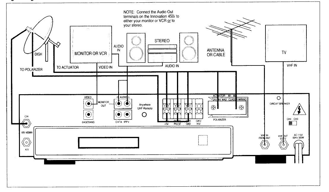

i am trying to hook up a 450i box i was unable to dl part 2 of the manual does anyone know do you run connect from acctuator to the +5 and pulse i believe you come in from motor to m1 and m2 any info helpful thanks
Here is a pic of the rear view out of the manual.
thanks much thats what i need assuming i can get it to work this box is analog i believe can i slave a coolsat 6100 onto it to pic up modern ch if so how would that be hookd to the 450i thanks
