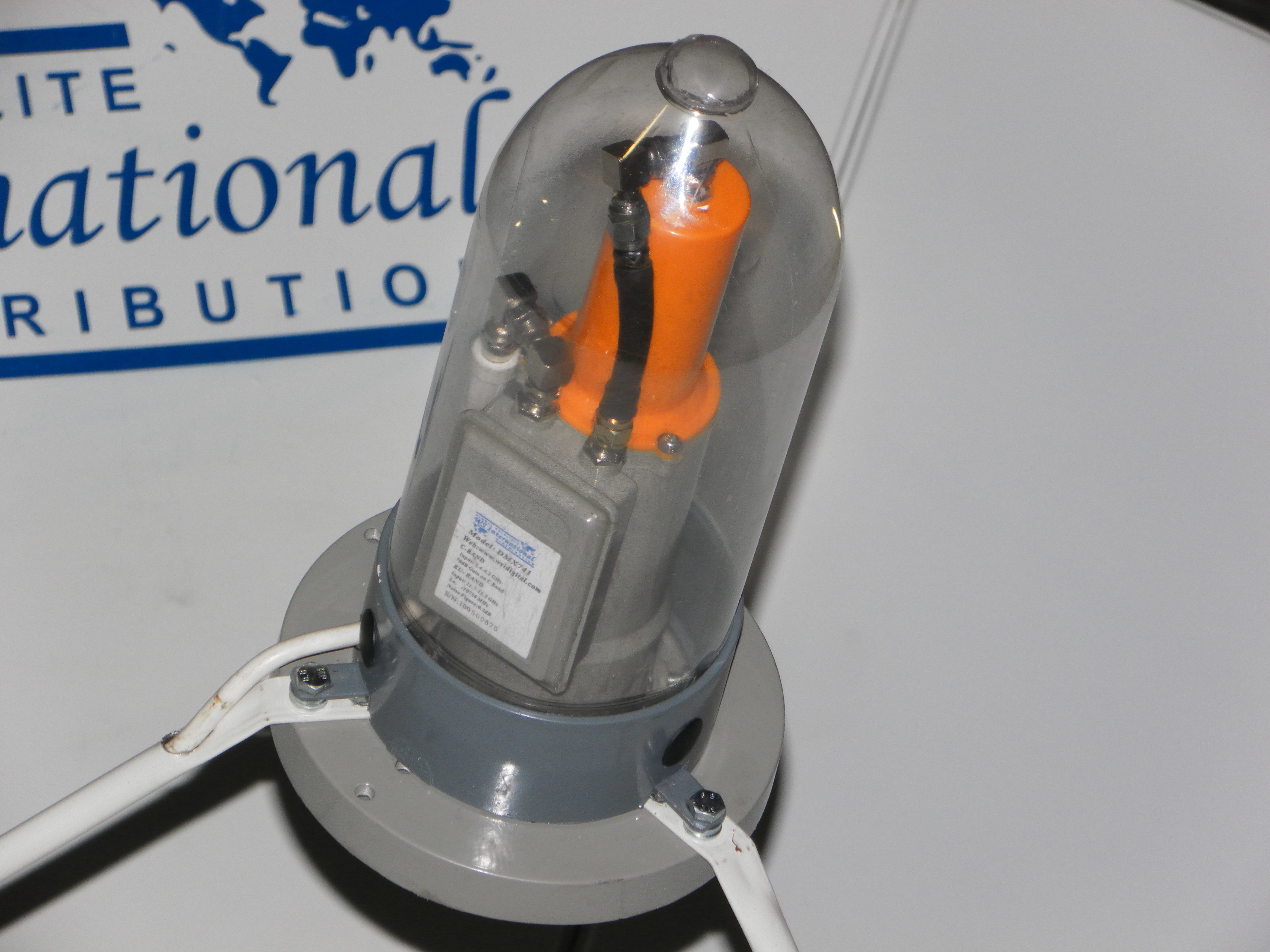

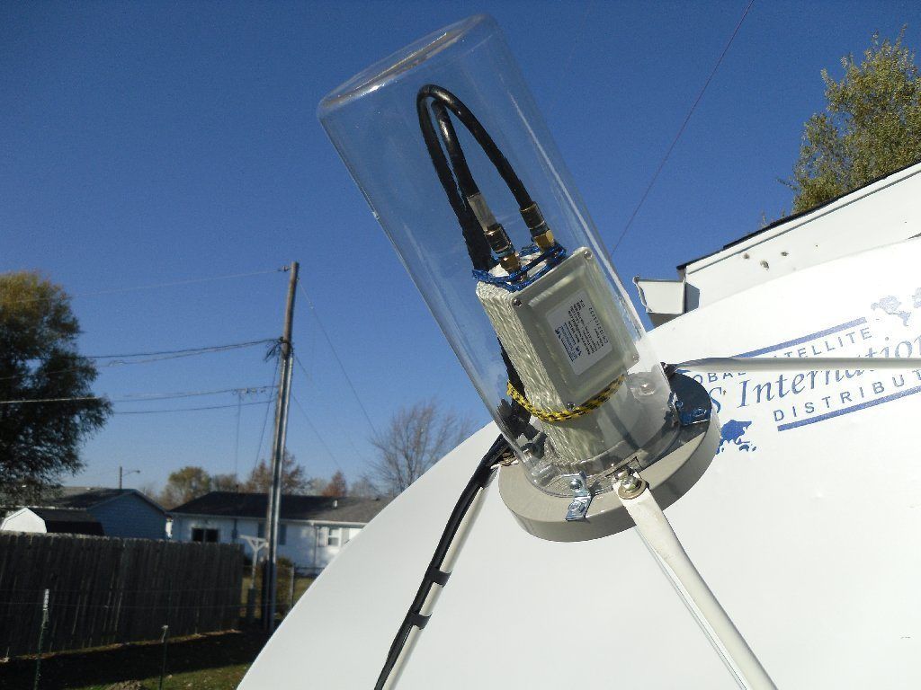

Hindu55 made one from a ziptie jar. It was neat. I copied the idea with a pop bottle.
Now that is slick! A see through cover for the LNB.
