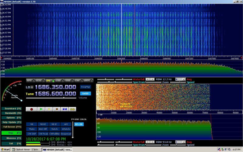

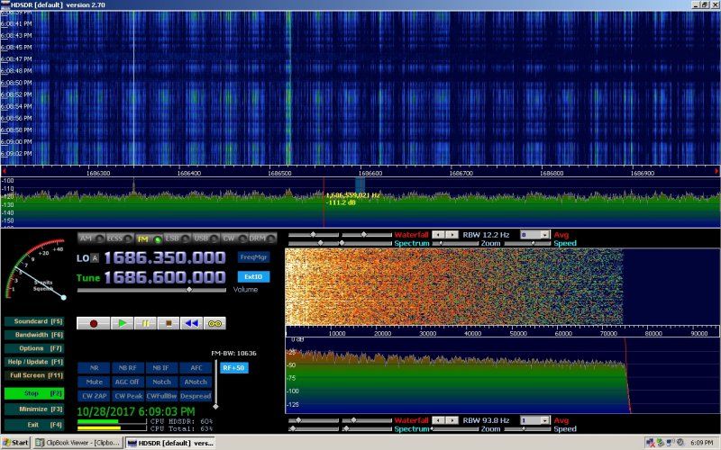

Got out I did some more tests today. The result was great. The first picture is the GRB on HDSDR with the RHCP feed. The result is better then the first as expected.
The signal level the first time was -114.5 dBm or near that, after the RHCP feed it's up to -111.2 dBm. This is a 3.3 dB increase in signal level.
I didn't measure the noise floor but would expect that it didn't change much with the feed polarization, though I do want to get a measurement of it, ran out of time.
Signal level should be near 16.8 dB above noise.
I did this earlier before I got the HDSDR info (if you look at the computer's clock)

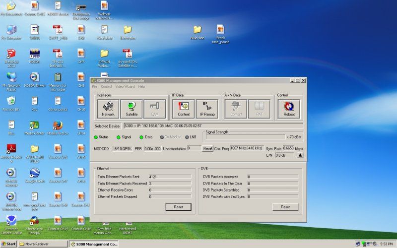

Hooked up the DVB-S2 receiver and have lock.
Some interesting items note though, The signal level is below the threshold of what the receiver expects so there is no signal strength indicator bar.
But the receiver is locked, I confirmed this by several ways.
1. Checked the manual and checked again.
It states by the green lights:
* Status – Turns green when the status packets are being successfully received from the S300 by the S300 console.
* Signal – Turns green when the receiver detects an input RF signal at the selected frequency. This matches Signal LED on the front of unit.
* Data – Turns green when the S300 has achieved data lock. This means that the receiver is able to recover all the digital timing from the input signal and is receiving a valid DVB transport stream.
Seems good there,
2. Checked by: Moving the dish from the satellite slowly and watching the packet error rate increase as the signal dropped down to 6.5 dB above C/N also saw the (DVB packets with Bad sync) rapidly increase.
Seems good there too,
3. Confirmed by: MODCOD 9/10 QPSK is what manual states it should be and the carrier is 1686.59 Mhz.
Yep, that's a match.
So I have signal lock with a 10' dish is SW Iowa on GOES 16 GRB RHCP.
C/N peaked around 9.1 dB and has about 2 dB margin, at least 1.5 dB min.
The only thing that bothers me is (and determined later) is the...

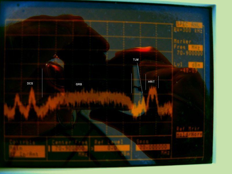

I just checked (without the LNA) and get nothing at 1694.1 MHz (HRIT). But it uses linear polarization and I have an LHCP feed. However, I do get a narrow band signal at 1680 MHz, whatever that is.
Remember that reception of circular with a linear probe or visa versa will result in an approximate 3dB loss. If the target transponder is near the threshold, this loss will attenuate it into the noise.
According to the docs, DCS at 1679.9 is RHCP. The combination of my Outernet patch and the reflection off the dish makes my receiving system LHCP. So I'm very surprised that I'm seeing DCS and nothing else?

I used my RHCP horn and could see HRIT (though weaker than the first time) I could still see it.
As mentioned before HRIT requires a 4' dish or less from what I know.
