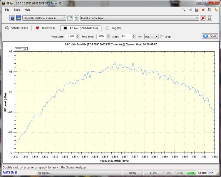

If you have EBS Pro installed please do a signal plot of the GOES 17 GRB carrier in high res. and send it to me in email or put it up here.
I want to see how it plots the GRB carrier with your cookie can feed, please do both polarization's on the plot.
I can tell you this, when I did a plot the GRB carrier over the 12 Mhz didn't look like that on your screenshot. It's making me think.

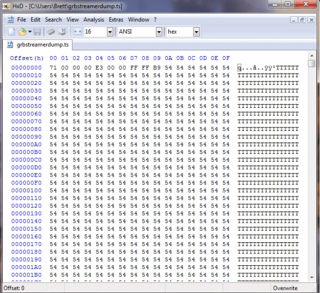

They are sending packets filled with the letter "T". No kidding. Below is a screenshot of a small section of a 4 GB recording I made. Aside from the BBHeaders and CADU headers the payload is entirely 'T'.

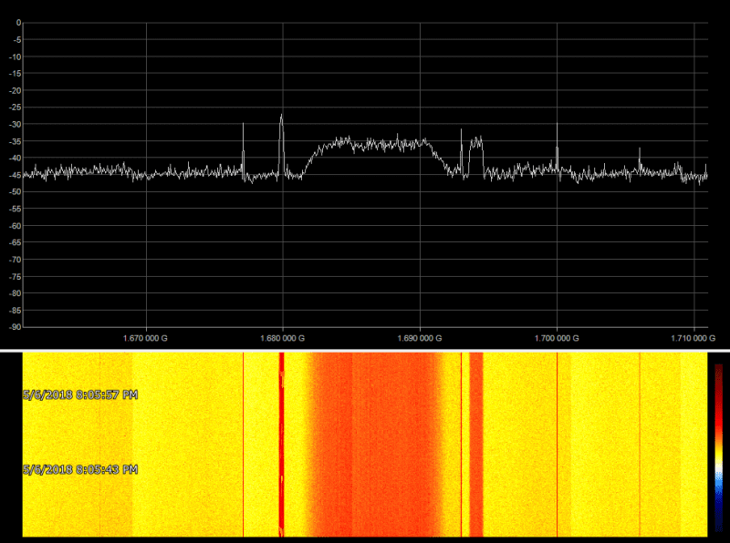

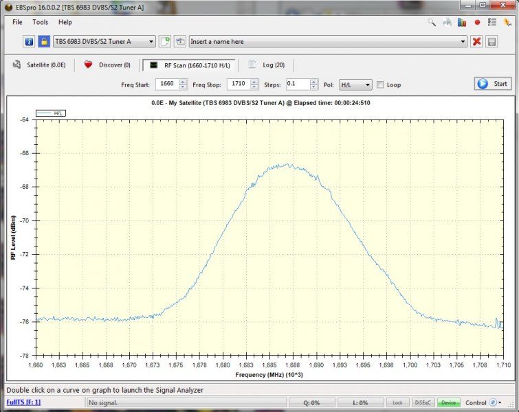

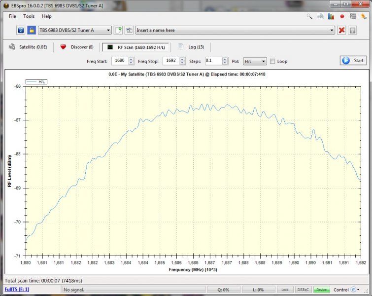

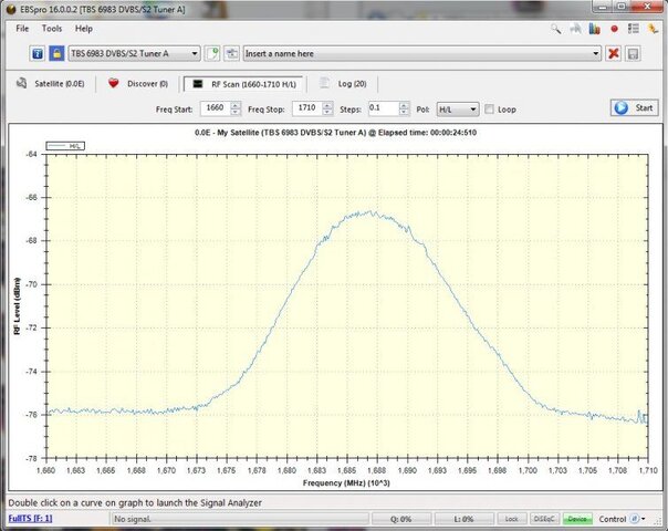

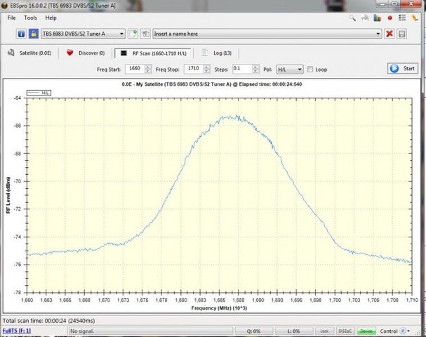

In my earlier post with the GOES-17 spectrum screenshot I used an AirSpy SDR running 'SpectrumSpy' from 1660 to 1710 MHz (a 50 MHz wide spectrum). That probably explains why it looks different than yours. But I will try 12 and 50 MHz plots in EBSPro and post the results later.

If you have EBS Pro installed please do a signal plot of the GOES 17 GRB carrier in high res. and send it to me in email or put it up here....

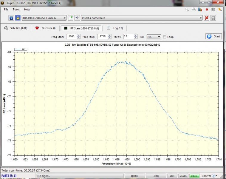

Here you go. I only did one polarization because its too late to go out to the dish and switch the probe cables. I did both 12 and 50 MHz spectrums. They certainly look a lot different than the AirSpy!
Thanks a bunch,
I figured that the SDR spectrum would look different then EBS, but I can compare what you see to what I see on the EBS display and it looks the same as mine on one polarization.
I don't want you to do any changes, by doing sweeps on both polarization's you should see the isolation you're getting between the two. Just have it scan both polarization's.
One more thing.. I can lock on RHCP or LHCP without changing a thing on the feed. I'm wondering if you can do the same. My signal quality is about the same on each though.
I don't want you to do any changes, by doing sweeps on both polarization's you should see the isolation you're getting between the two. Just have it scan both polarization's.....
Selecting the polarization in EBSPro does nothing for our L-Band setups. For KU and C Band it changes the LNB voltage, which signals the LNB to electronically switch polarities. My cloned replica of KWX's Cookie Can Feed doesn't do that :-) The only way for me to change polarities is to go out and switch the probe cables on the 90 degree splitter/combiner. I will try that sometime this evening.

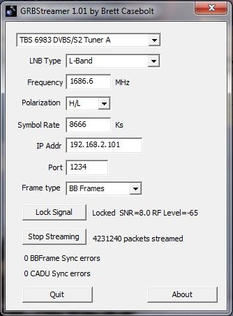

.... I started GRBStreamer at 3:30 AM last night and it was still going when I woke up. Over 4 million BB Frames and still going. Zero errors!

When the SNR is in the high 6's or above, I have to click the 'Lock' button and then reset the cable. About 50% of the time it will lock and then I click 'Start Streaming' and off it goes. Sometimes it takes a few cable resets.
Its the same with both of my DVB cards. The TBS6983 reported an SNR of 8.4 dB at night. Now it has dropped to 8.0 - 8.1. Over 5 million frames now and still going....
Here are some screenshots of the other polarity of the GOES-17 spectrum.
This signal is about 0.6 dB weaker. It took several coax resets before it would lock.
Mine looks the same in EBS Pro.

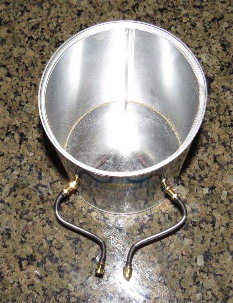

I'm almost positive its your feed. It took me 4 attempts to get it right. I have an extra "Cien en boca" can and I will make another feed and mail it to you. I'll test it here first to be sure it works. If by chance it still doesn't work on your dish, then my next guess would be your TBS 5927.

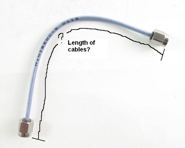

I can make the SMA M-M cables no problem.
What is the length that you made (from connector end to connector end)?
And the type of cable, I need that to match lengths.
The only cost is $6.25 for the cables that mount to the can and shipping.
Okay, I will reimburse you for that.
Also I recommend getting 4 rechargeable D-Cell batteries to power your Sawbird+ or another ripple-free DC power source.
I have 3 extra 4-D cell battery holders (I had to order a pack of 4 to buy 1). So I'll send you a holder too.
I have a usb power tube device that powers the Sawbird up fine. It's like a big battery, I had a picture of it when I showed my feed setup.
I don't think there's a need for the D Batts.
Remember my Sawbird had a mini usb connector for additional power supply source.
The cables can be any length, but they must both be the same. The cables I used for your new feed (in the photo below) are 10 cm each as recommended by KWX. All you have to do is screw the ends onto your 90 degree combiner. I will test this feed tomorrow. Meanwhile, please send me a private message with your mailing address.
EDIT: In the photo it looks like the 10 cm cables are screwed into female connectors but they are actually one piece (male to female cables). Also they are as short as possible to minimize the signal loss.

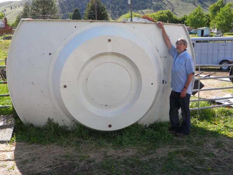

Would really like to give this 12' dish away. :) It will fit in a full size pickup.

As expected I am not getting near enough GRB signal with my 8' dish (see attached) so am searching for a 12' replacement. I saw your post about the 12' dish. I am in N. Central Florida which is a l-o-o-o-n-g drive from Montana in my pickup truck !! I have no idea what it would cost to ship the dish here (assuming you still have it!) and there would be additional costs to get it loaded for safe transport via trucking company for transport to N. Central Florida. I am about 12 miles south of Gainesville, FL near the little town of Micanopy.
