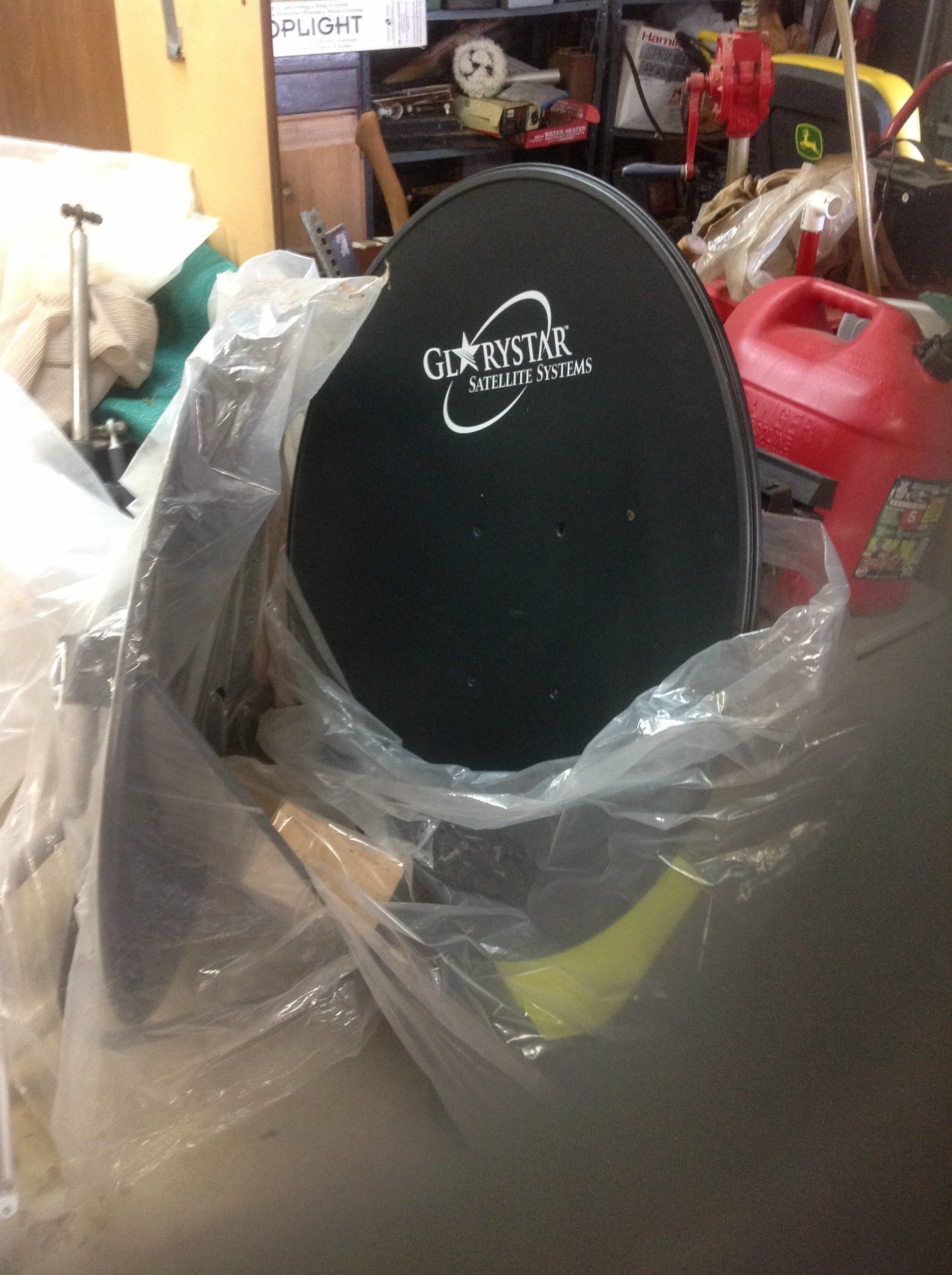

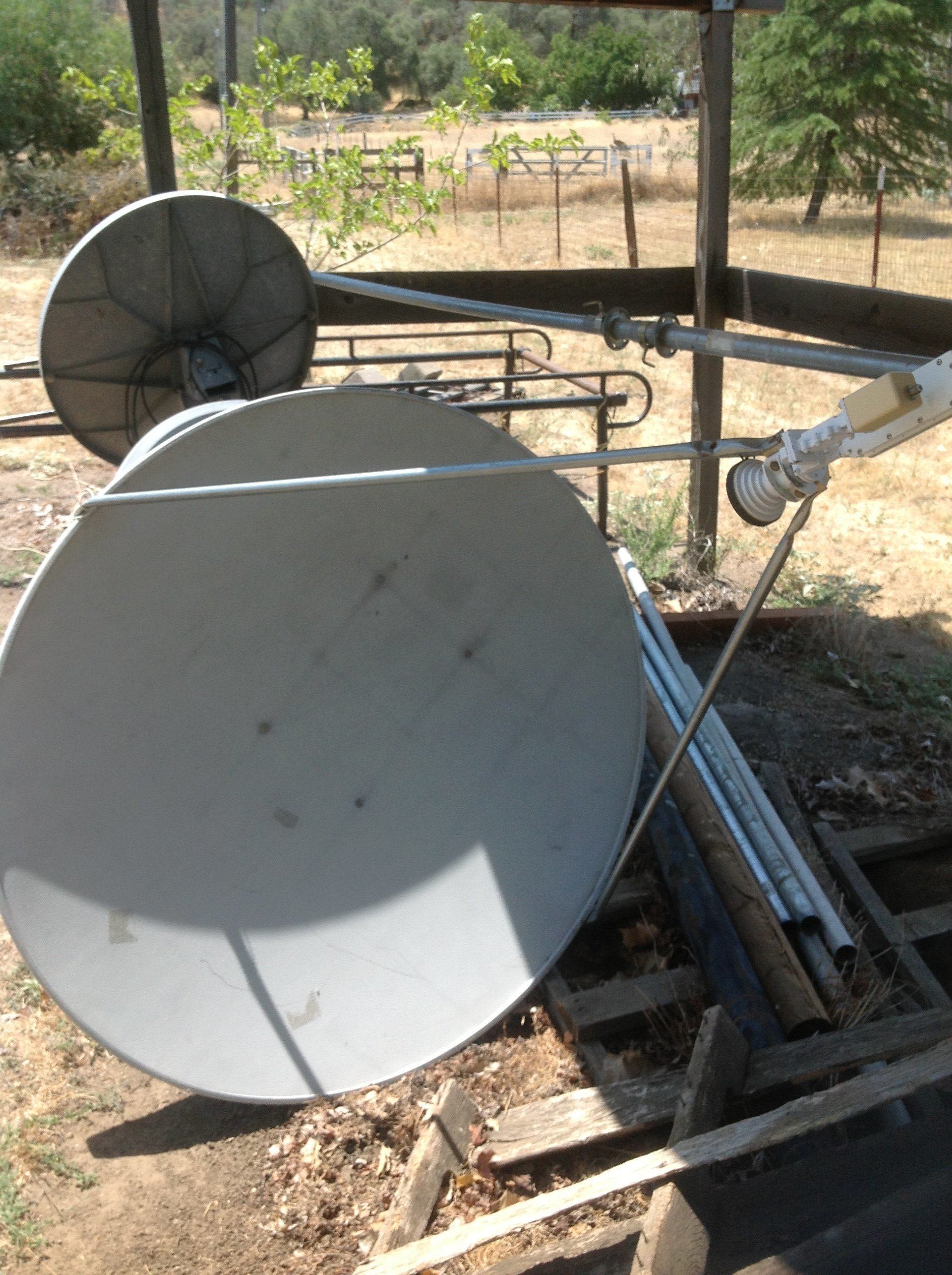

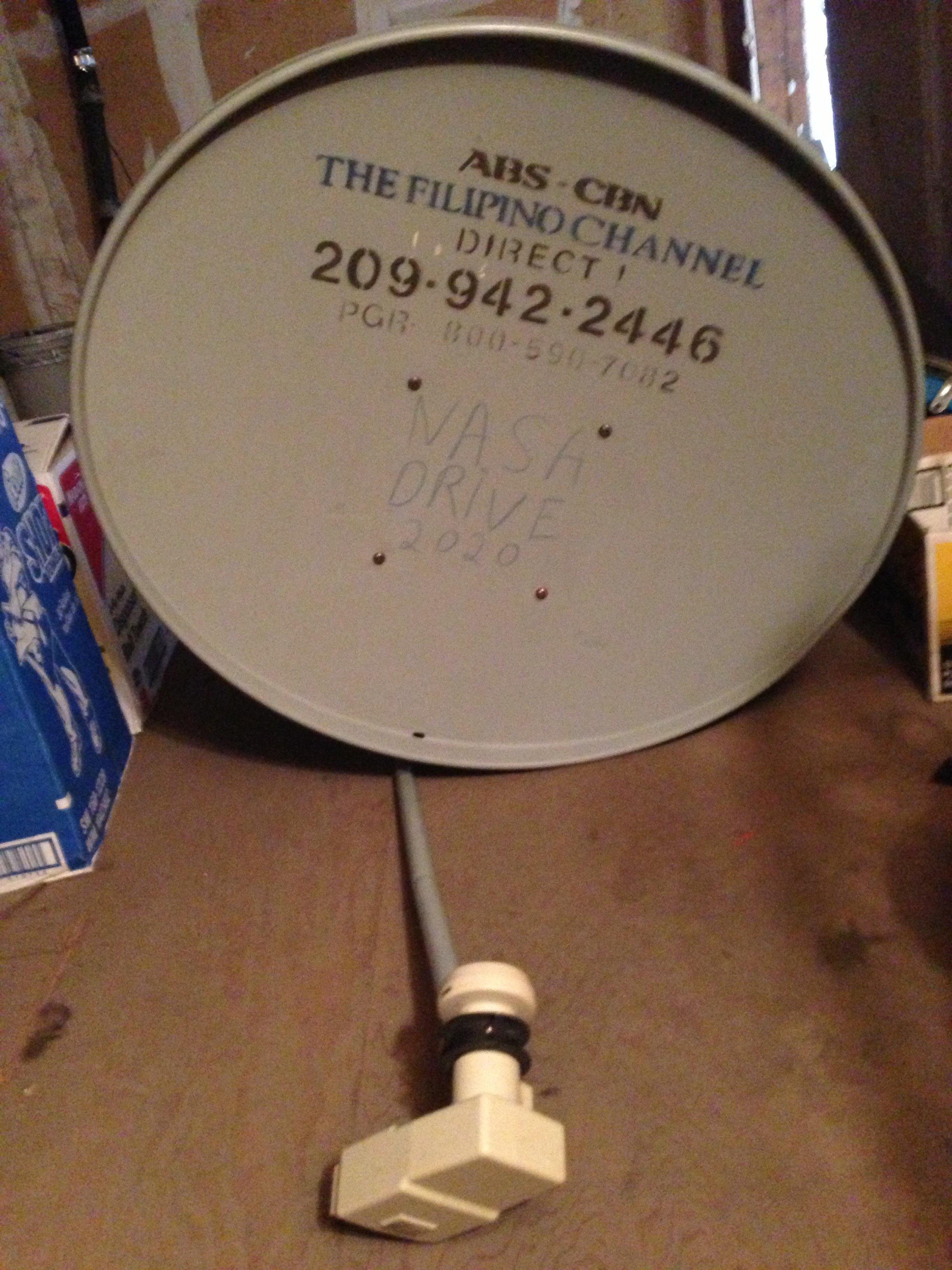

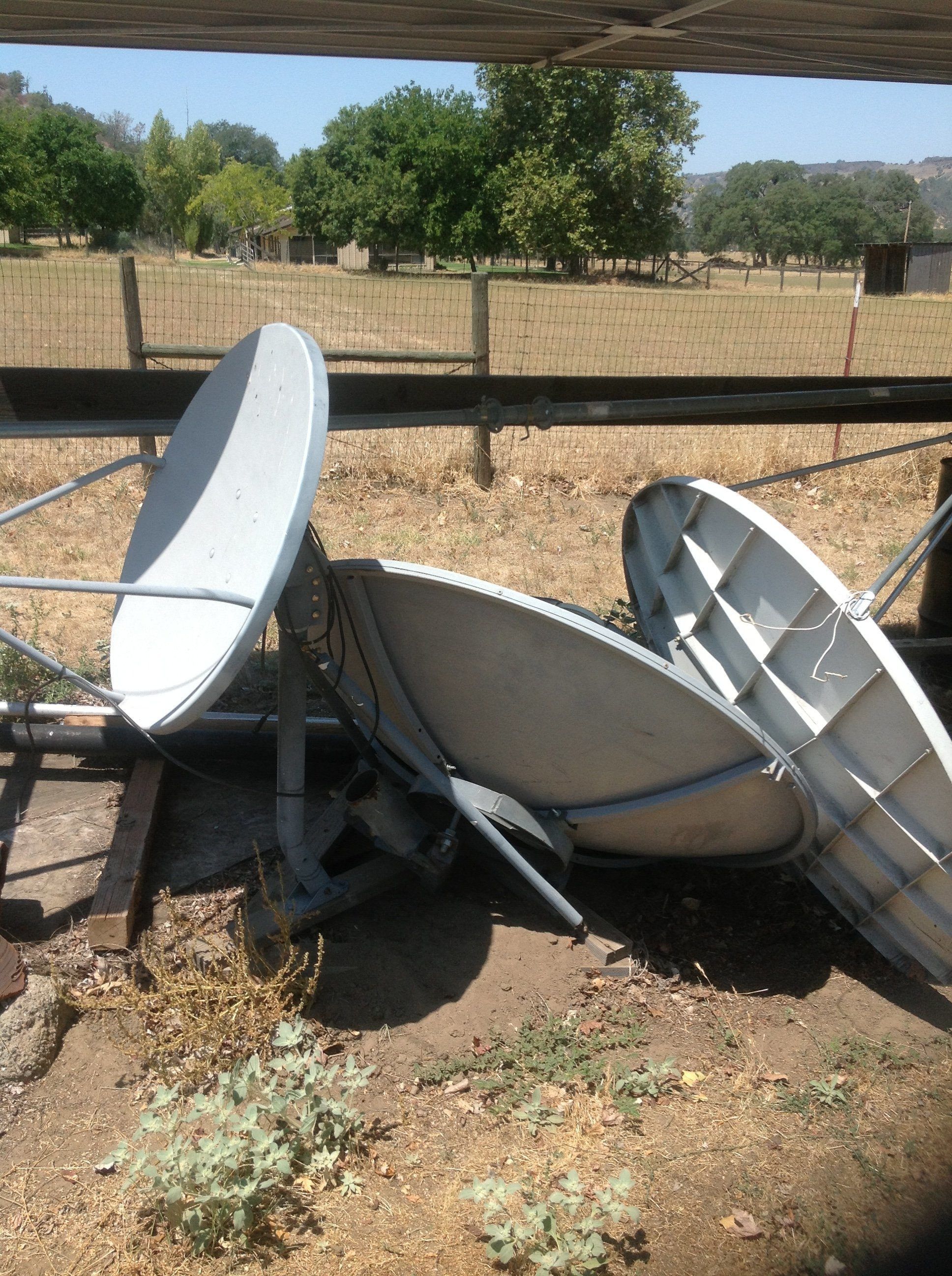

I think Merced is a hr drive from me. Two new Glorystar 33" dishes, a 5 ft CBand solid, and 4 ft KU band solid, and a 36"? ( didn't measure it) channel master I used for demos. Nothing over $50...
been cleaning the place up and hauling away the trash... I'm sure we can make you happy.

The Glorystar dishes will have a bracket to take any general purpose LNBF.
Probably the path of least resistance, and fine for 97 west, fixed.
