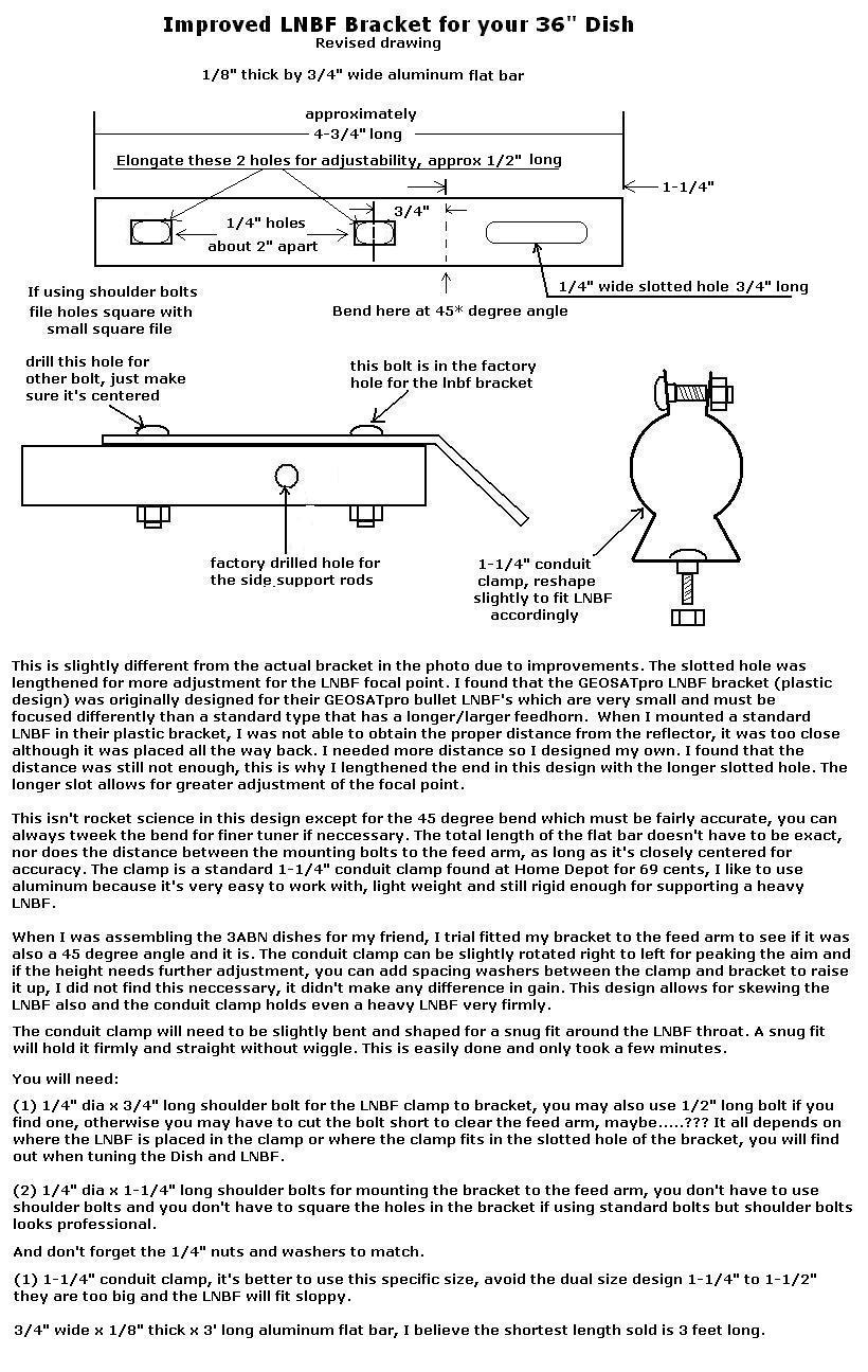

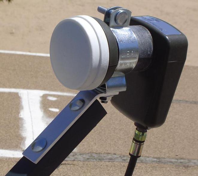

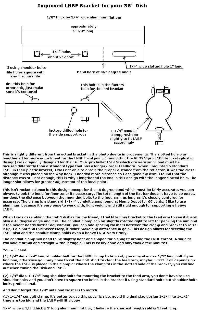

Hey, I'll have the pics up in just a short while, I just came down from the roof and cooling off in the house while I work on this.
Home made LNBF Bracket
Here is a photo and drawing of the LNBF bracket.
EDIT: I revised the drawing and posted it here, I made a few changes for better adjustment for fine tuning.

Damn, now I feel like an ass for making a stink out of the whole thing! :rolleyes:
McG - love the LNB holder.
I'd say that would survive the high desert temps, so long as the LNB did! :)
I don't see where the side arms attach, though.
And I sort of thought the original LNB holder is where they all came together.
Oh, maybe I'm thinking of the Primestar/ChannelMaster dishes...

Just read your document.
Very good and very comprehensive.
I now see the existing holes in the main LNB support arm, for attaching the side arms.
I wonder how far between your bracket bend and the original LNB bracket hole in the arm?
Those conduit hanger brackets are exceptional for LNB mounting. :up
Hi Anole,,,The dish in the photo is my GEOSATpro (charcoal color) that doesn't have the support arms. The 3ABN dish is light gray color, (no photo of it yet). Remember the small pic on their website? It's just like that. I would prefer light gray colors because of heat distortion and signal wave bending, I would only guess that it may effect the signal during the heat of the day. In fact, I have noticed a more stable TV picture image in the cool of the evening and noticable glitches during the daytime heat. The charcoal dish gets so hot that you can't touch it, the light gray stays relatively cool.
You could "Fleck Paint" it to match your roof though....:eek:
The 3ABN feed arm isn't square either, it's sort of oval shaped but uses the same lnbf bracket as the GEOSATpro and possibly the Fortec Dish. The 3ABN dish support arms attach very close to the lnbf bracket and still allowing room for attaching the aluminum bracket.
The bend in the flat bar bracket is almost on the edge of the feed arm tubing, not more than 1/16" beyond, the factory bolt hole is most likely the same distance as your Fortec, approx 3/4" from the end, just look at the plastic bracket on your Fortec.
The bend needs to be as close as possible to the end to maintain the proper height for the lnbf alignment/focal point. If you make your own bracket, just measure so that the bend is right at the end of the feed arm tube. You can also elongate the 2 holes in the flat bracket so that it can slide up and down for more adjustment ability.
My drawing is based on the 3ABN dish with support arms and the photo is to only illustrate the fabricated bracket, I don't mean to confuse you guys. Both dishes use the same basic dimensions such as the angle of the arm which sets the lnbf on a 45 degree slant, therefore the bracket will work on either dish assy. You will only have to drill one hole in the feed arm for the second bolt in the bracket.
