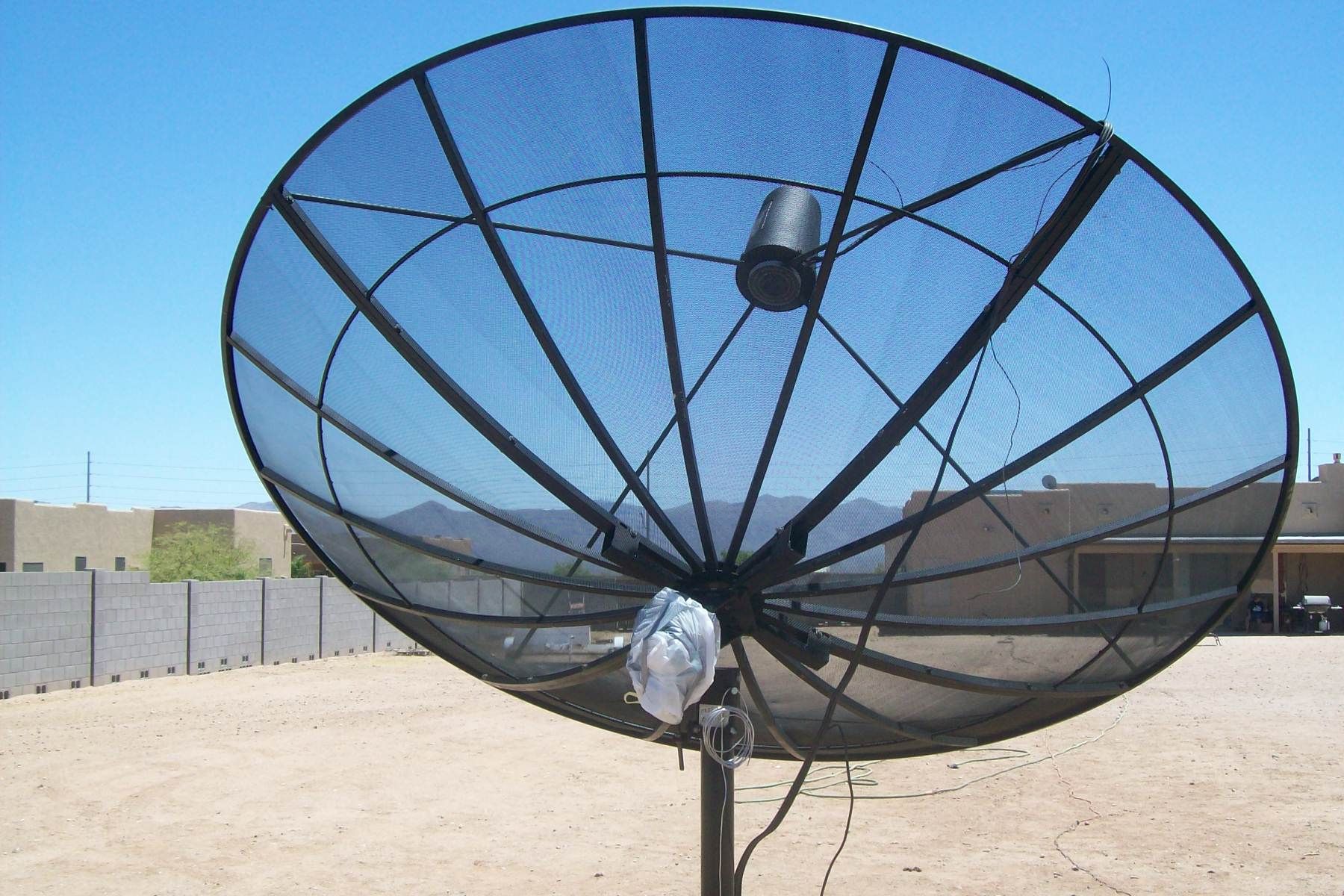

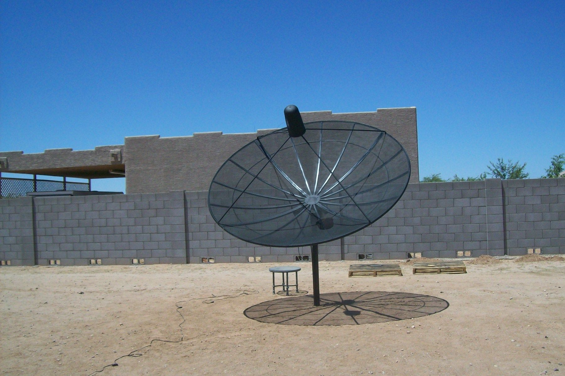

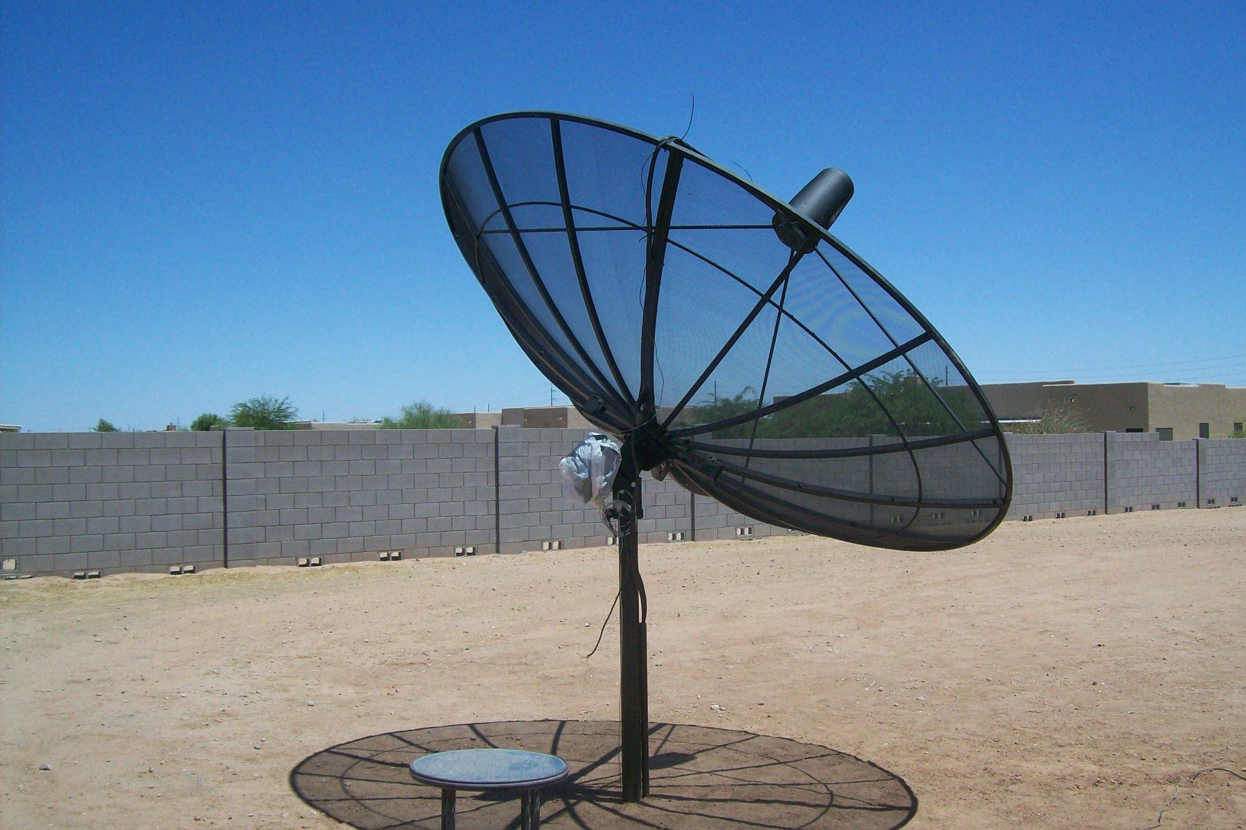

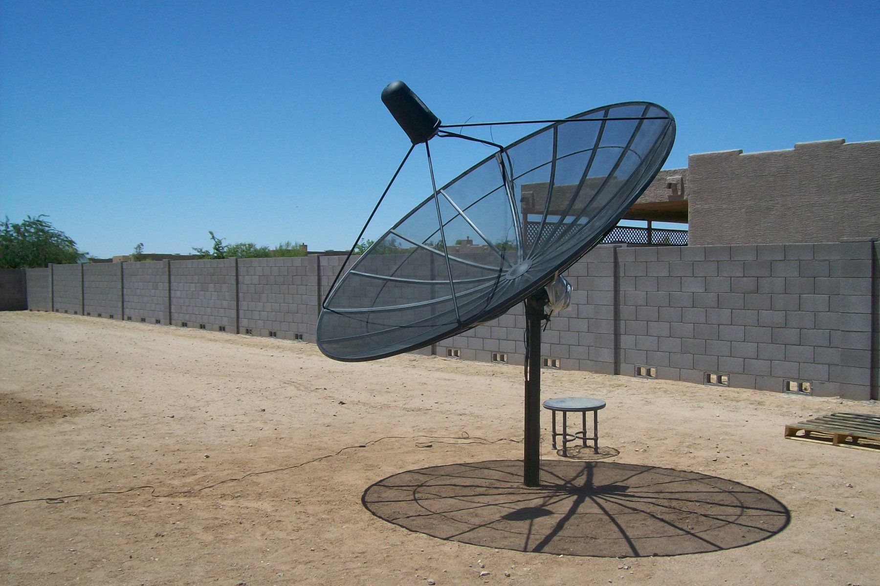

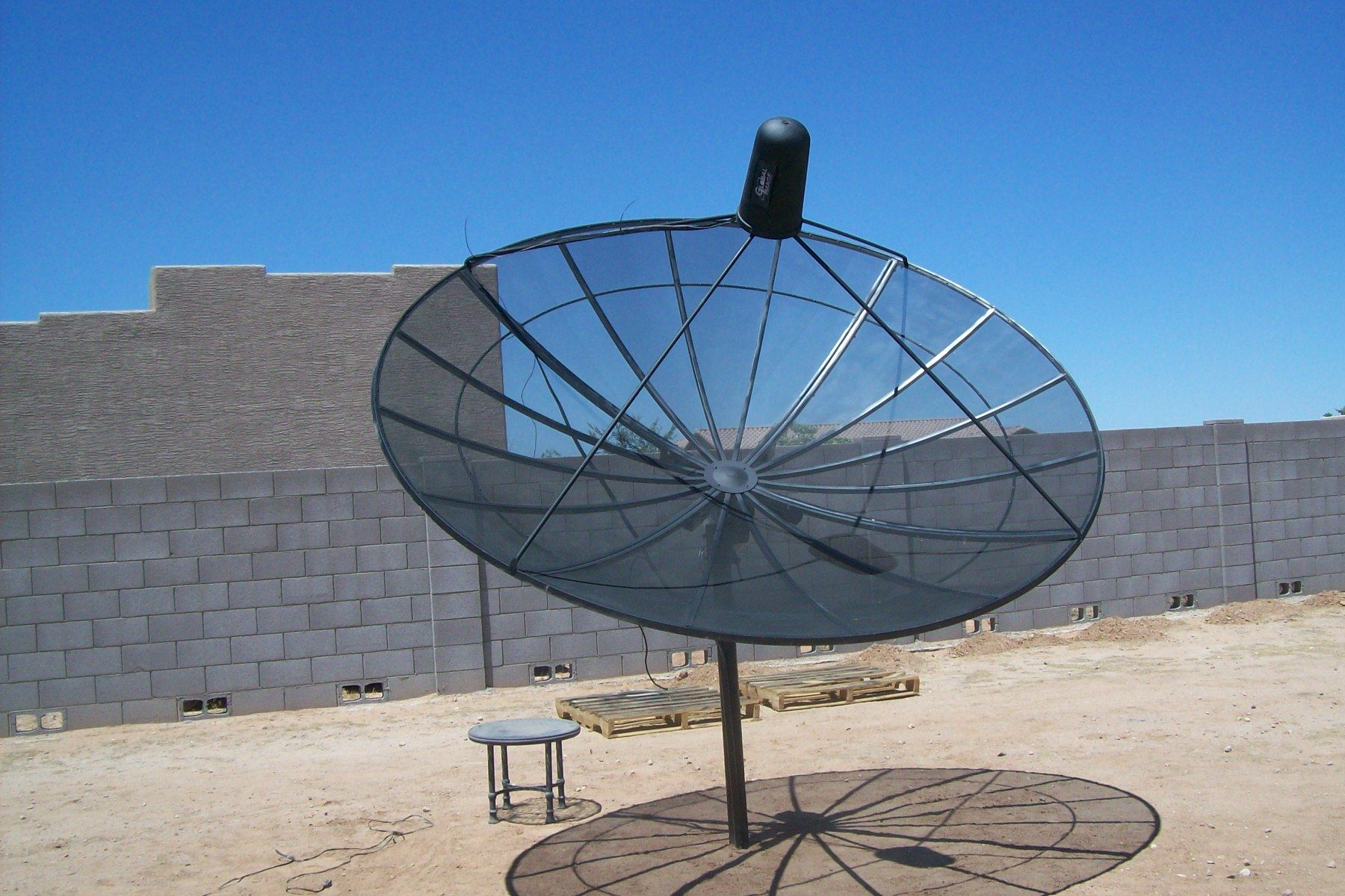

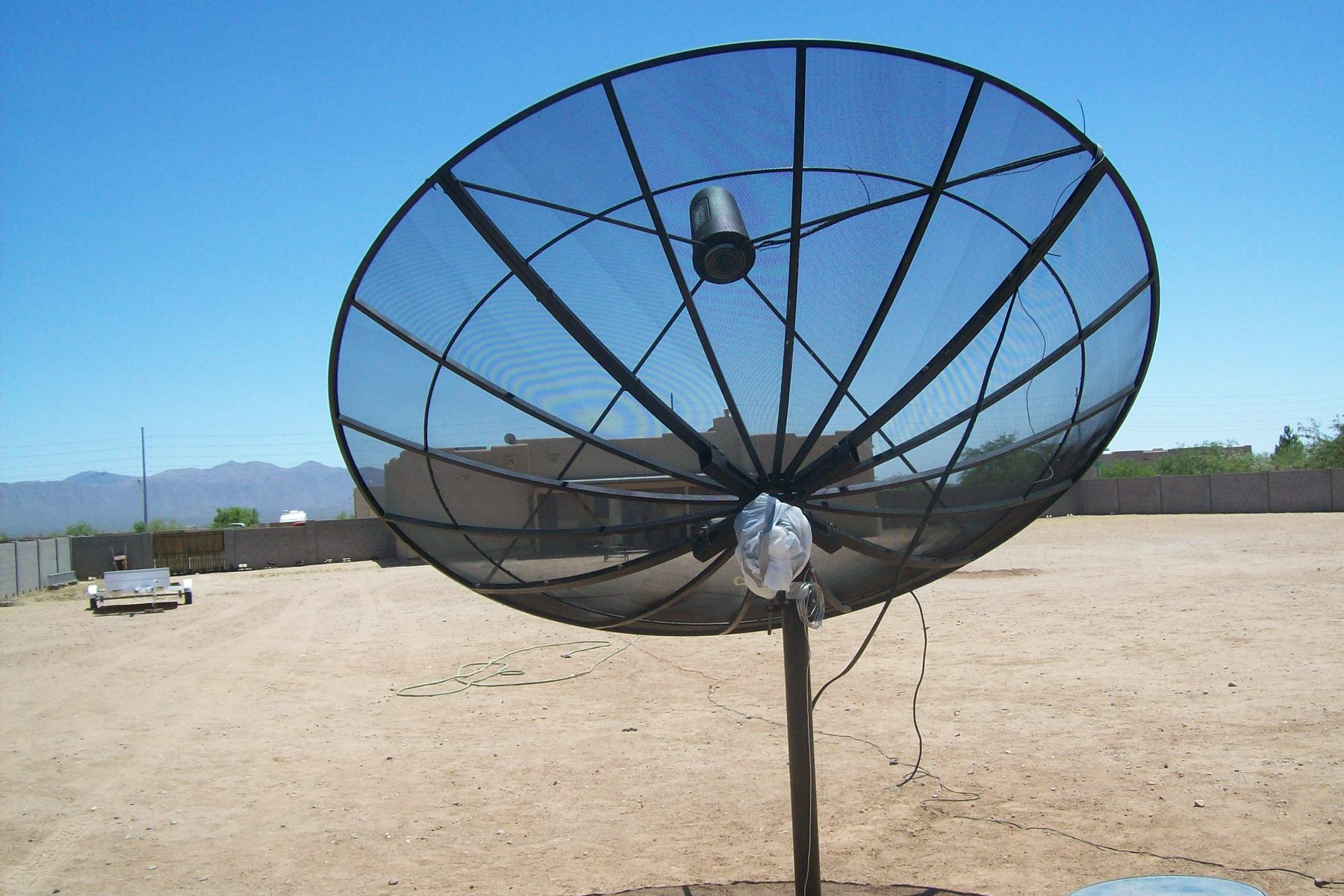

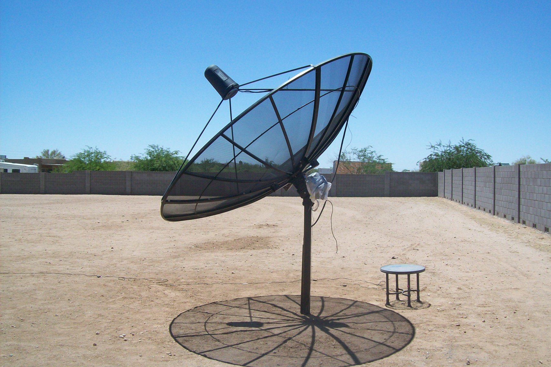

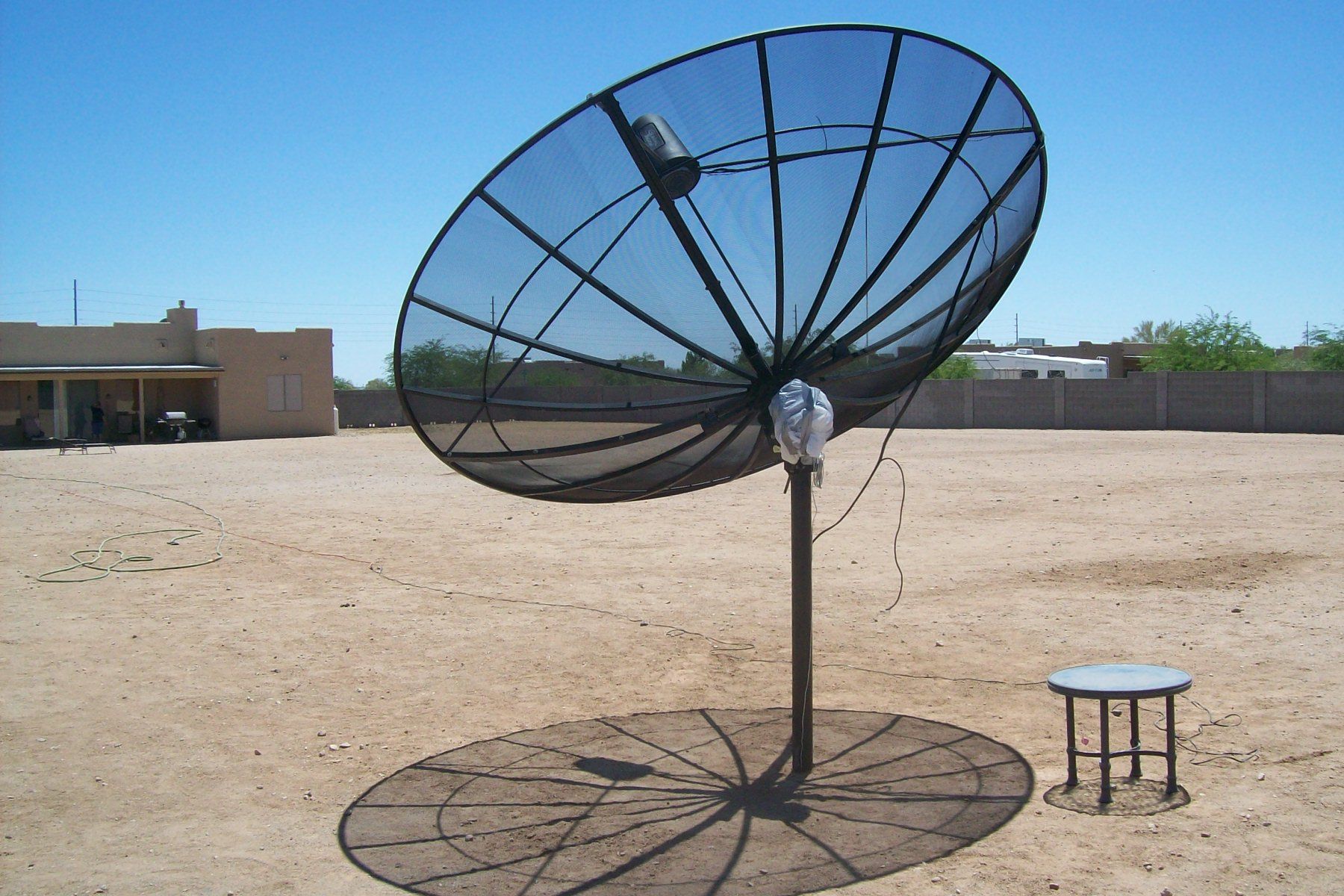

Got dish up this week and tryed the toshiba trx 80 to move and it moved about 1/4 in thats it.The unit blinks off when you hit west or east move sat and you here a clicking sound like its shorting out and comes back on. Must be doing some thing wrong with set up not famillar with this unit.Like to get this unit to move dish to save money for the new unit.I got a battery charger to move and moves east-west no problem .http://www.satelliteguys.us/c-band-satellite-discussion/171953-found-10-ft-dish-will-need-help.html This link will show lnb if i need new one or can i at least set up unit.Trying to find southern sat with no degrees scale on motor i will be looking in the blind.Ajak h-h motor.

It looks so lonely out there. Nice looking install. I would check your sensor wires for the motor and make sure they are hooked up good. Also might be the sensor itself.
Is it safe to say you may not like your neighbors or are you installing it in a prison courtyard? Other than that looking nice.
I took a 6v charger out and hooked it to the motor and it moved east to west and i think the receiver toshiba trx-80 is shorting out.When i hit move the receiver shuts down. If i had to go with an other way to move to ajak motor would a vbox work or any other ideas.Oh i live in an HOA and my wife siad some one was driving around lokking hard iam sure it not a B.U.D. head like my self admiring the cool dish no I dont think so. My wife said wait a little while and see what happens befor investing.

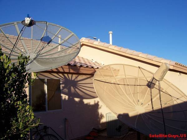

Here an old pic from 2006 when i had both the 6ft and 10ft up.
